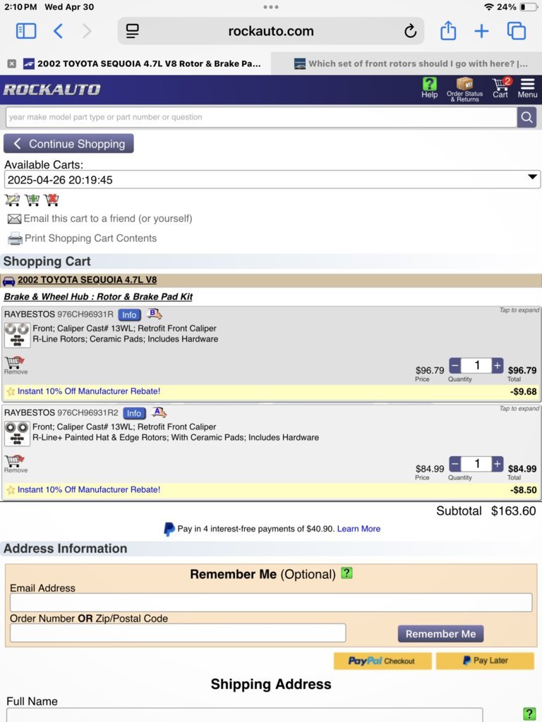

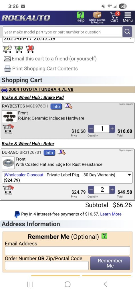

    I still think this configuration is better and or definitely cheaper
    It says 04 Tundra that was just to verify it would be 13WL parts.

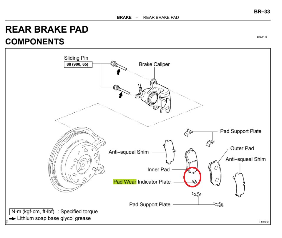

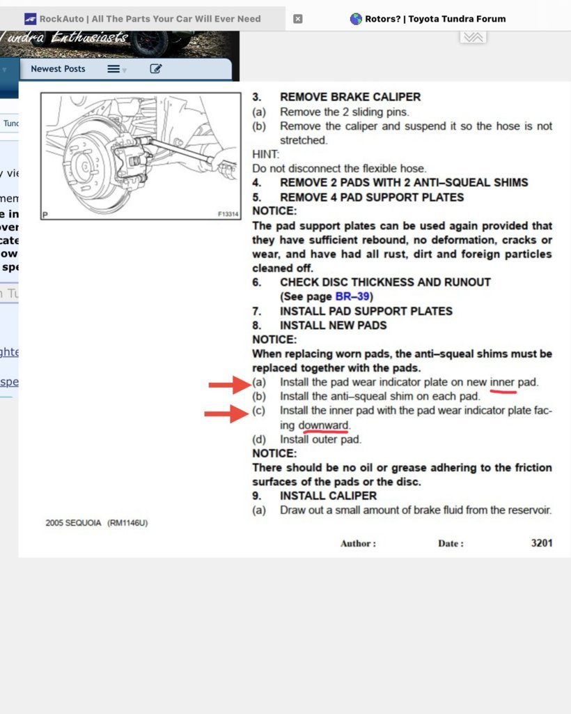

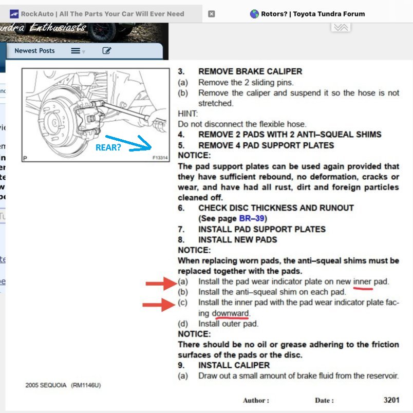

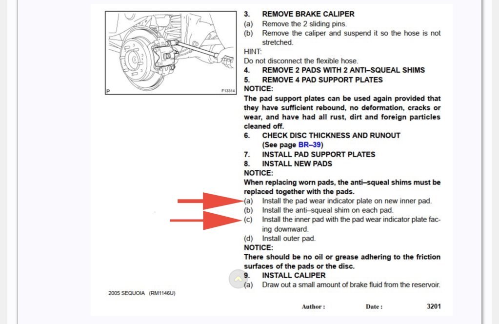

    I am doing the fronts, and sorry the picture i linked was me rushing. This is the photo I meant to link you.
    And I just want to say thanks for taking the criticism with stride, because I truely do trust and respect you and everything you say. If I don’t ask these questions and continued on with the repair it’d be one of those things that would keep me up at night lol. You are a treasure trove of good information.
    im sure im the one missing something here, or reading it wrong. These FSMs are written more so for mechanics and not the common person who just wrenching in their driveway. A lot of stuff on the FSM goes right over my head simply because I need it in laymen terms
    EDIT: god im such an idiot sometimes. Yeah Im completely wrong, thats the same exact picture, I just sourced it from a different __cpLocation so it had me thinking otherwise. My apologize … sometimes I just need to slowwww down a bit

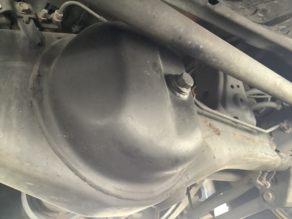

    This is a picture of my rear differential, it looks like I don’t have LSPV, correct? From my research it says it should be something attached to the rear differential and this looks pretty blank to me. (Unless the sequoia has it hooked up somewhere different. But I looked all over the rear braking system and couldn’t find anything out of the ordinary)
    sorry, I just have to ask to be certain. It’s always good to get a second pair of eyes on something.
  20. May 1, 2025 at 11:18 AM
    #50

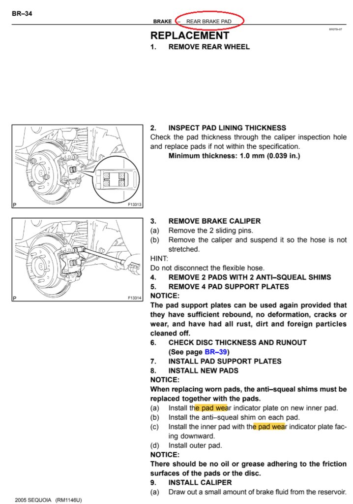

    Look at the header of the FSM section you're in, does it say 'rear brakes' or 'front brakes'?
    Here's why I ask.
    You see the handle of the breaker bar they're showing? If you look at the thumb of the hand, that looks like it's showing the rear diff in the background, making me think it's dealing with the rear brake, like ... note my arrow here (and see more text after the arrow)
    Stop for a sec and think about our vehicles. The calipers should be in these positions (more text after the picture again):
    Why is this important?
    All four wheels spin the same direction, but the caliper is in a different position.
    If you have the caliper to the forward position (as it is up front), you want the squealer to be on the outer pad, facing up, because that's the leading edge.
    If you have the caliper to the rearward position (as it is in the rear), you want the squealer to be on the inner pad, facing down.
    EDIT: You always want the squealer to be on the leading edge, i.e. the pad and position that will contact the rotor first, because that's the side that will wear the fastest. If you put it elsewhere, you may get the squeal too late.
    Does that make sense? The position of the caliper on the wheel dictates where the screamer needs to be. The orientation of how you had the pads is correct for the REAR calipers. The way I corrected them is correct for the FRONT calipers.
    We're technically BOTH correct. I think you're just confused about which position to use, where, and why.
    This is why I've mentioned a couple of times: CHECK WHICH SECTION OF THE FSM YOU'RE IN.
    The picture you're posting is from the REAR BRAKES. The caliper is clocked in a different position in the rear. Clearly, you see above the FSM page I shared from the FRONT brakes, which is what you're working on, right? Here is the section you're looking at, which is for the REAR brakes.
    (again, if you look at the thread I keep linking, we had this exact conversation in the last 5-10 replied of that thread)
