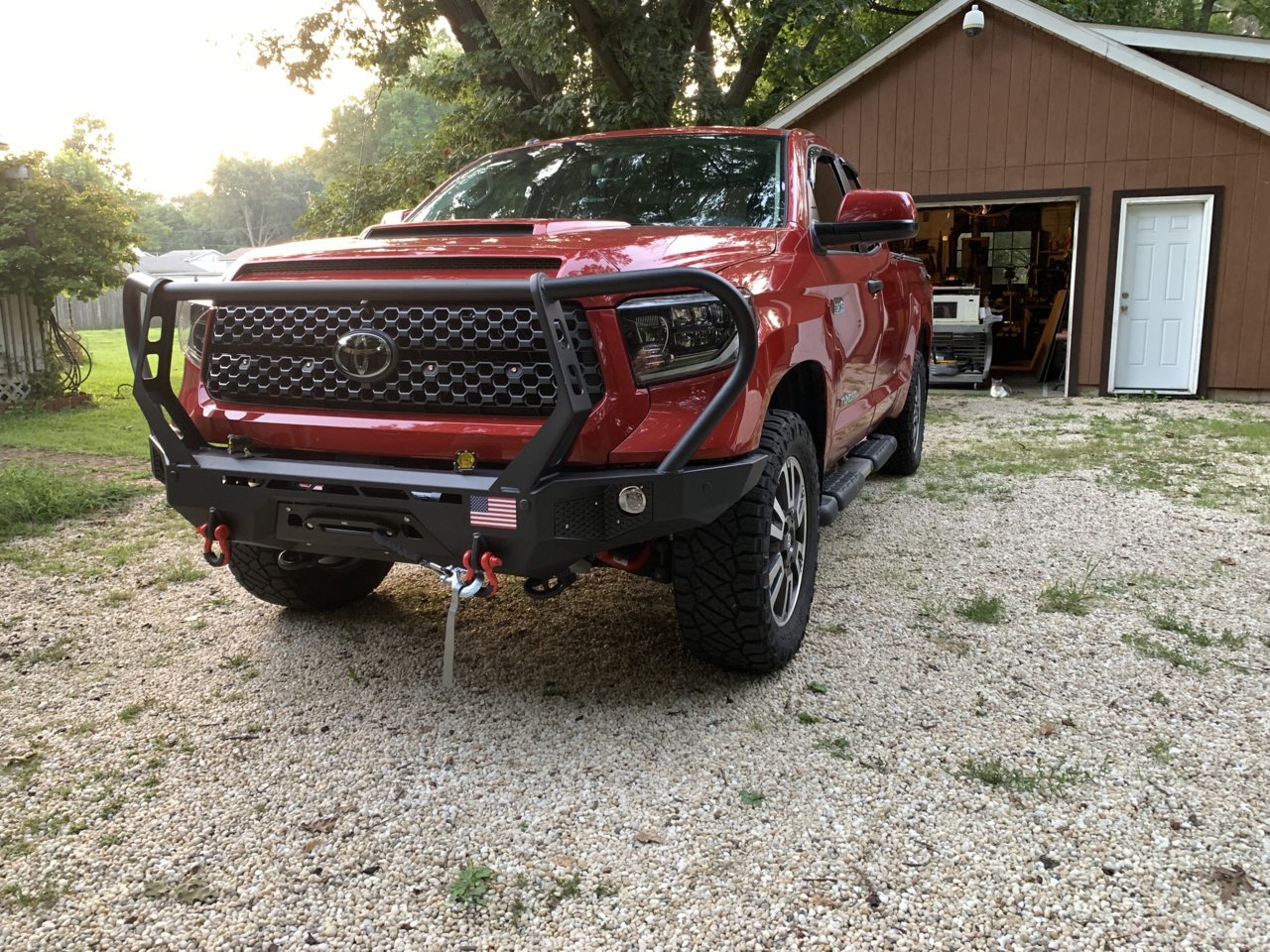

    This is my installation. Somehow it got deleted, so I am posting it again.CBI Bumper with RC Winch on my rig.jpg

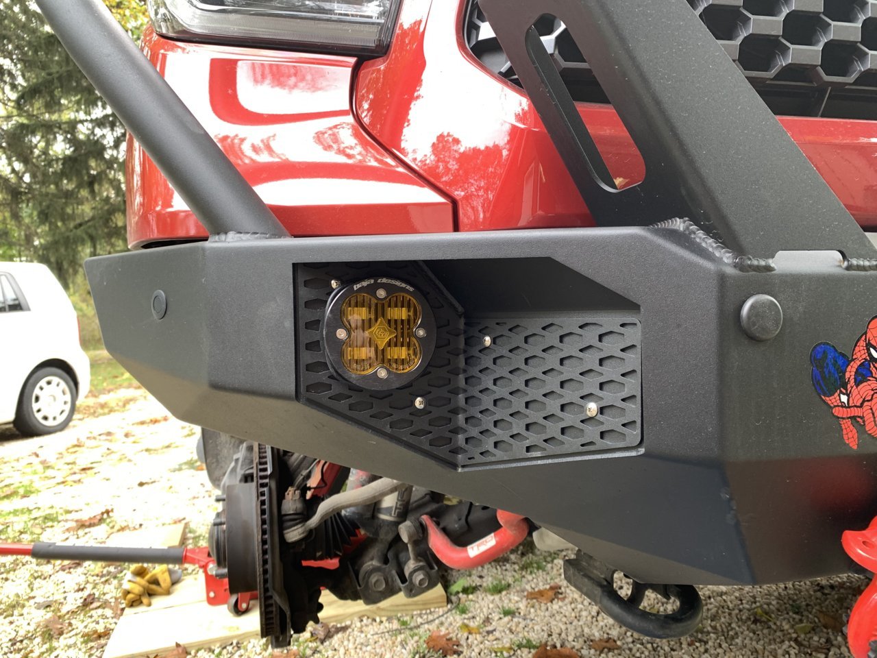

    Mine was installed by a collision repair outfit that does lots of these. They put the winch in the bumper first then mounted the bumper. However, I had to buy a 4' pigtail remote extension from Rough Country, the mfg. of my winch and zip-tie it to the bumper so that I would have easy access to plug in the control pendant:
    https://www.roughcountry.com/winch-remote-extension-rs130.html
    Also, its far easier to add the fog lights at this time too. I didn't do it until after the bumper was installed and had lots of trouble with this. The installers mounted my stock fog lights and they ended up falling out after a while. Then, I got the Squadron-R SAE amber fog lights from Baja Designs and installed them in front of the fog light apertures but mounted inside bumper. This was very difficult and of my own choice to do it this way, but the lights have never worked themselves loose and sealed the opening where they mount (O-rings from Lowe's to provide seal). Also, I found it was far easier to mount them after removing the front tires (one at a time, of course) to get in behind the bumper.Front wheel removed for access to back of bumper.jpg

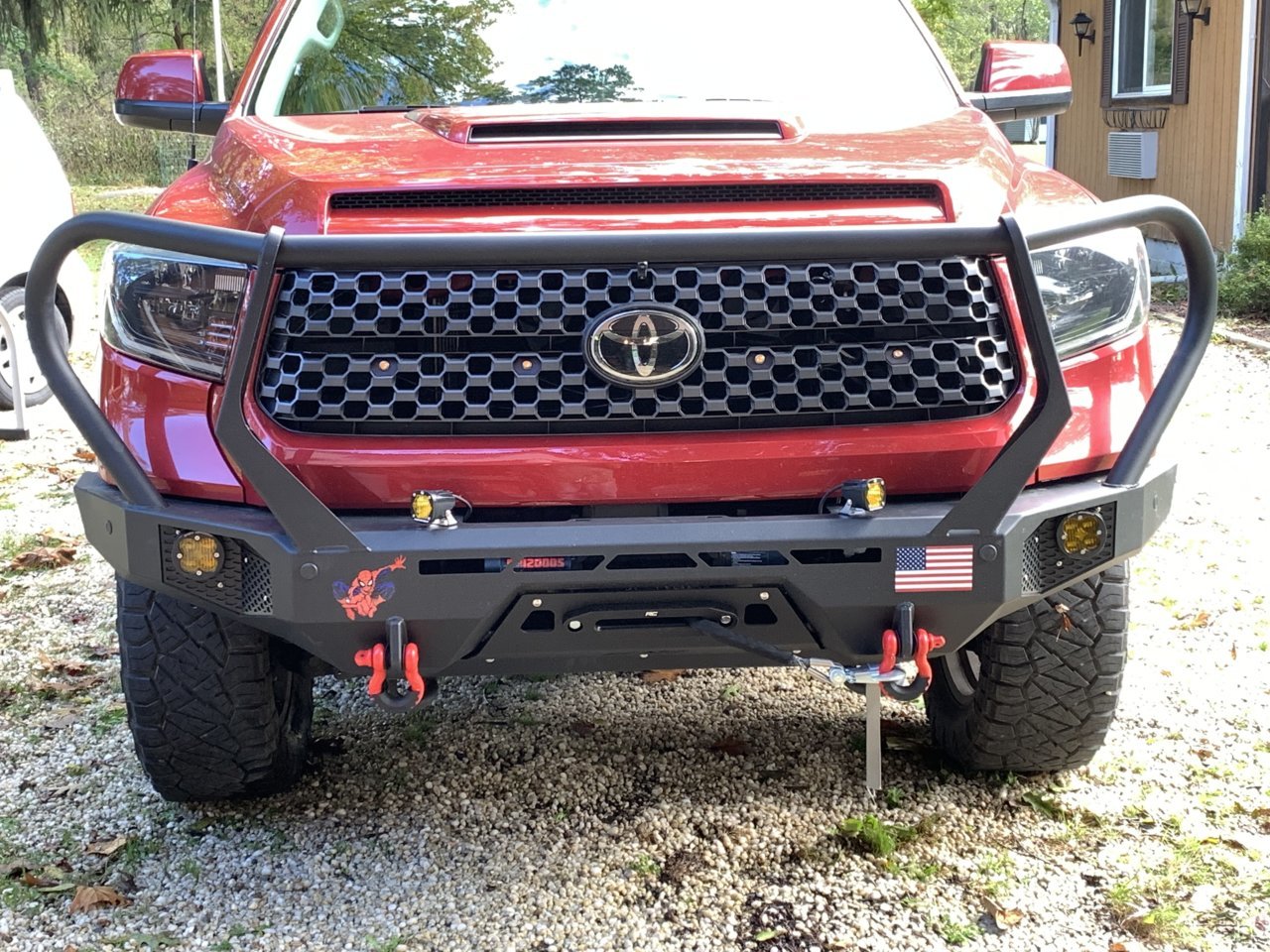

    More photos of front bumper:
    Fog lights finished look.jpg Fog lights tested (waitiong on harness adapters).jpg
