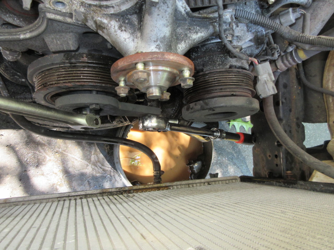

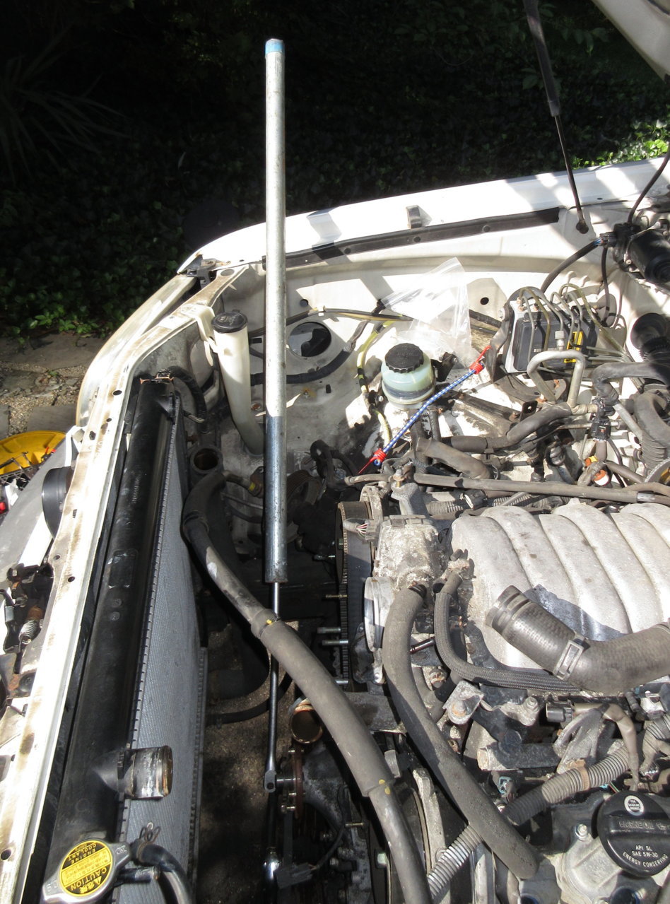

    Got the tool today and removed the crank pulley bolt in 20 seconds with the radiator in the truck.
    Tool works great but it's a bit fiddly putting the bolts in. Might have gone with the other one which I now see you can put in one bolt first, than place the tool around it.

    Maybe tape a piece of cardboard over the side of the radiator that faces the engine to prevent squishing any of the tines.

    Would recommend to just get the radiator out of the way. Much more comfortable to work with the Rad not in the way.

    Plenty of room to work with the radiator in place. This is a truck, not some euro sedan.

    You may not damage the radiator leaving it in place, be you'll most certainly tear the flesh off your knuckles...

    I wear gloves so not a scratch so far.

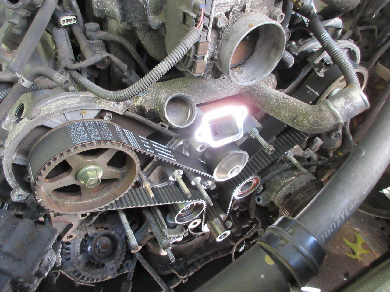

    All parts replaced and engine buttoned up without having to remove the radiator. Started right up.
