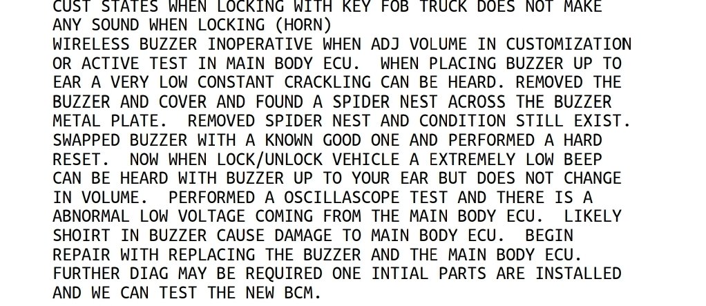

    I am not getting the 1 beep chirp when hitting the lock button using the smart key fob. I have turned it off somewhere, somehow and now cannot find where to turn this on. I would like to have the audible notification as confirmation the truck is locked when I press the fob with my back turned. I have read the manual completely, studied both the multimedia and the multi-info displays settings, looked at the customization features.... but cannot find where to set this. Thanks in advance for any tips.

    That is exactly where I thought the adjustment resided and I have been adjusting the Feedback Tone numerous tries and at different levels, but when locking with the fob, no tone is played. The lights blink once as part of the locking (and twice when unlocking) but there is no tone. I need to try something else. I have the new v2170 and your mail sorta confirms the upgrade did not affect this feature.

    Thanks for your assistance. I did exactly as you described a half dozen times and no beeps. The DRLs flash properly but no chirps. I need to look somewhere else.
