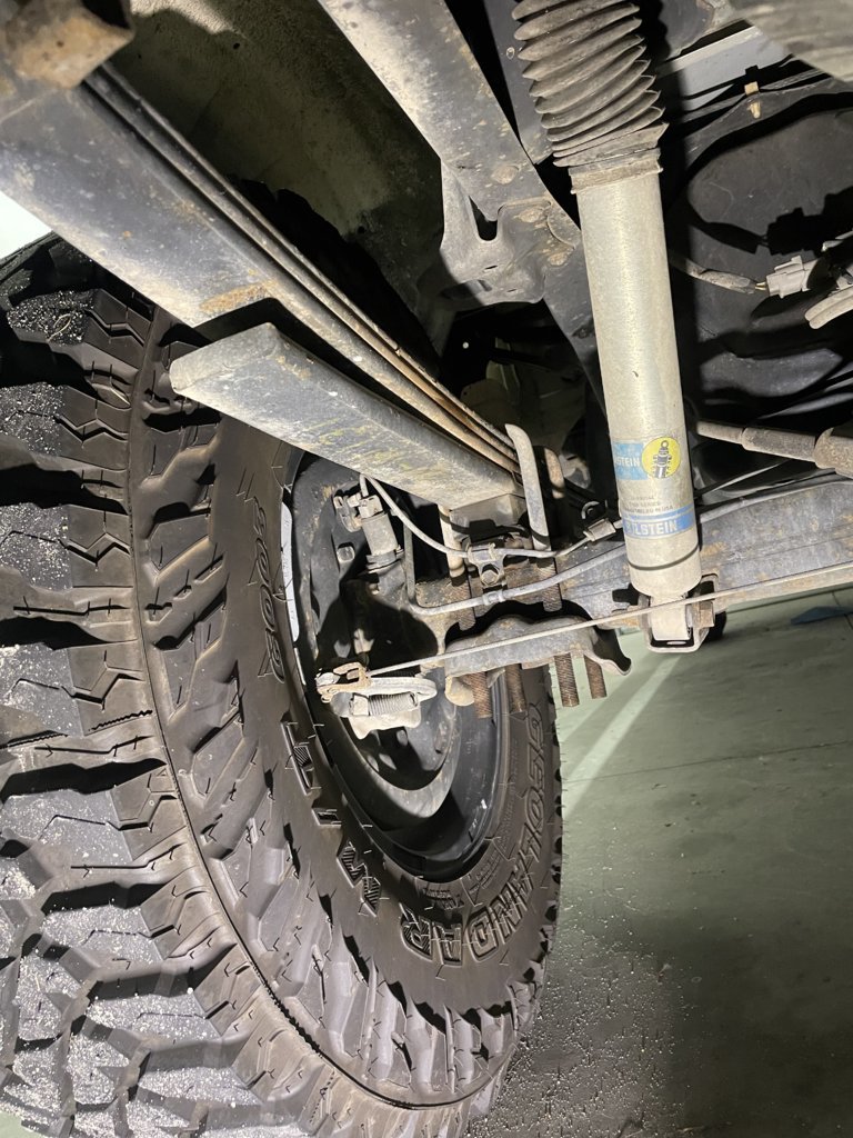

    So I bought a 2005 AC w/ 155,000 miles. I decided to take it to a dealership for its first oil change and get a full checkup done. I knew that there would be carnage when I got the report. I just wanted their opinion, a "professional" opinion since I am no such thing. They recommended $8k in work.
    the list
    -timing belt
    -valve cover gaskets
    -LBJ
    -Sway bar links/bushings
    -CV axles busted boots and grease everywhere
    -Rack and pinion boots busted leaking fluid
    -new brakes
    So I started this weekend. I did the timing belt/wp. I looked at the valve covers and didn't see any pooling/dripping oil, checked the bolts and they were all under torqued. hopefully that fixed that problem. I ordered OEM LBJ's and will be installing them soon.
    So my dilemma is with the suspension repairs. The truck has a lift on it. I'm not sure about what kind of springs it has front/rear but it has 5100's front and rear and and it looks like a 1" block in the rear. The front billies are on the highest setting, #5. it has 285/75/16 Yokahama Geolander MT's on it. Although I do like the look of the truck, It is too high for my use. Just a DD back and forth to work. the tires are brand new and I don't want to buy new ones right now. I know that most of my suspension issues are from the amount of lift that it has on it. I would love to drop the 5100's back to maybe the 3rd setting and remove the rear blocks but I'm not sure if the tires will still fit? They didn't put it on the list but the UBJ boots are blown and they appear to be stock arms.
    So what I was thinking about doing was lowering the 5100's to #3 setting, removing rear blocks, getting Napa CV's, Detroit Axle R&P, Suspension Max Sway bar links, OEM LBJ
    Do you guy's think the 285's will still fit for the time being?
    I'm not sure what Upper control arms to go with the amount of lift that I will have.
    I haven't done much research on brakes yet either if anyone wants to make any suggestions.
    I don't do any heavy off-roading.
    how would you guys approach this project to make this truck reliable for another 200k mi?
    thanks for any input.

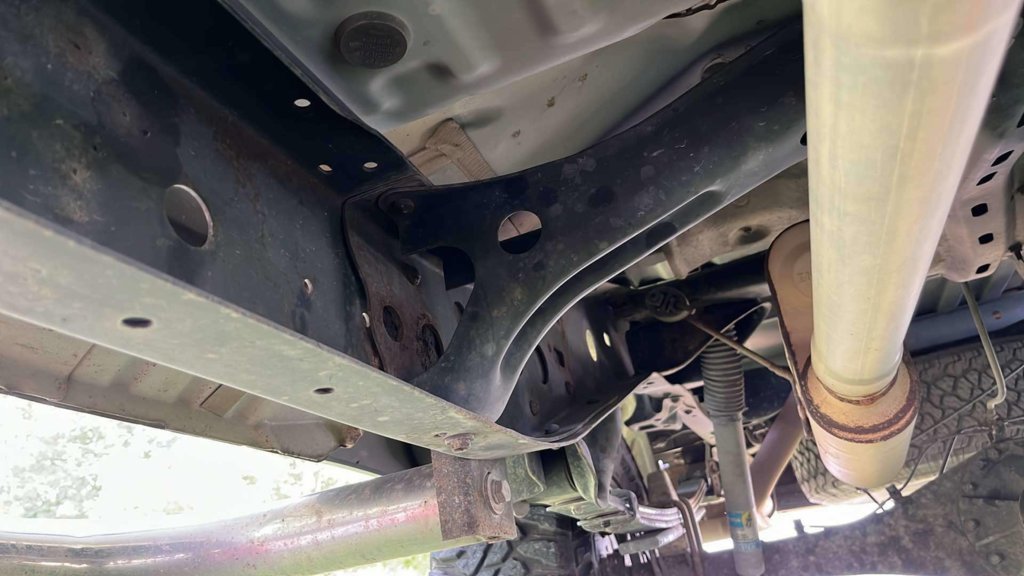

    I attached one photo that I think you can see the rear blocks in.

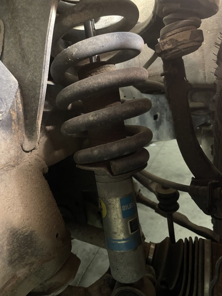

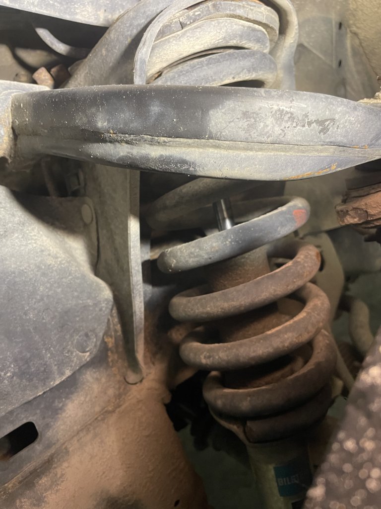

    As for springs, OEM typically were black with colored paint marks on them. Show pics.

    In the 1st pic if that is red paint across both coils, those are OEM coils. You see what I’m talking about right? OEM coils weee black and got tagged with paint across a coil or two, sometimes part of a third, in different colors. The different colors define the different rate/length etc. Someone wrote a breakdown on here somewhere, I don’t remember what red stands for. But it’s something I’ve only seen on factory/OEM coils.
    Looks like a 2” block out back. I say that knowing the overload leaf is about 5/8” and it looks around 2-3x thicker than the overload.

    With the bilsteins lowered, you are likely going to rub at least a little, but probably a lot.

    This coil color code scheme was posted on the old TS website a few years back. I’ve also seen threads were people claim blue or red driver side and yellow or white on the passenger side. I’ve never seen anything that looks official from Toyota.
    Stock 4X2 coils
    - drivers: yellow-white
    - passengers: blue-white
    Stock 4X4 coils
    - drivers: yellow-green
    - passengers: blue-green
    TRD 4X4 coils
    - drivers: yellow-yellow
    - passengers: blue-yellow
    TRD 4X2 coils
    - drivers: red-yellow
    - passengers: purple-yellow
    shifty` likes this.

    PS - If you delete the block out back, you'll need replacement u-bolts, current ones will be too long. In a pinch I'd tell you to run to the JY to see if you can get some good ones there, I've found several over the years, but if you want the OEM, HERE YOU GO, you'll need 4, and while MSRP is a little over $40 each my local dealer is letting them go for $28/ea. Washer for the u-bolt is 90201-15012 and you'll need 8. Nut for the u-bolt is 90179-14019 and you'll need 8. You should really install new ones, you have no idea how hard the PO torqued the current ones down and how much the bolts have stretched.

    For referece: spring color of non trd front driver. This is a 02 4x4 v8 rc:

    yes thats red paint.

    Tundra Coil Color Codes:
    2007+ Tundra TRD: Drivers, Blue-Yellow Passengers, Yellow-Yellow
    2007+ Tundra: Drivers, Blue-Blue Passengers, Yellow-Yellow
    2000-06 Tundra Stock 4X2: Drivers: yellow-white, Passengers: blue-white
    2000-06 Tundra Stock 4X4: Drivers: yellow-green, Passengers: blue-green
    2000-06 Tundra TRD 4X4: Drivers: yellow-yellow, Passengers: blue-yellow
    2000-06 Tundra TRD 4X2: Drivers: red-yellow, Passengers: purple-yellow

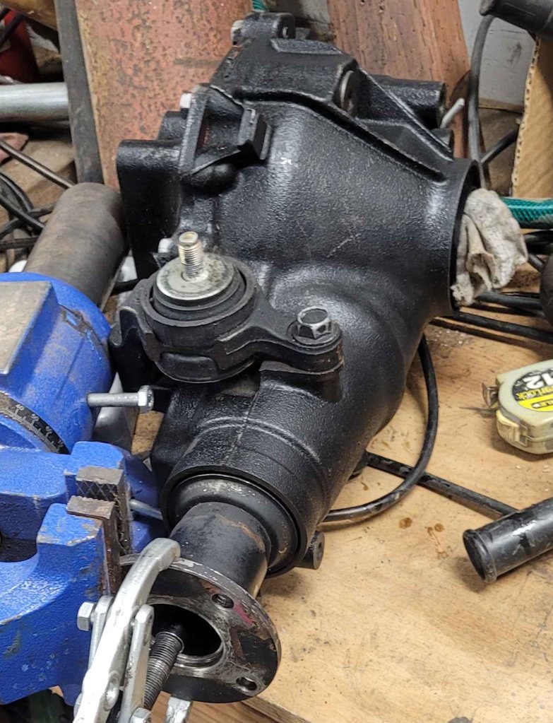

    How much changes if I have a dif drop. I wondered why those spacers were between the front skid plate and the frame when I took it off the other day. I was putting it back on today and figured it out.
    also measures the blocks in the rear today and they are 1”

    That diff drop doesn't really do much at all, it only lowers two out of the three mounting points for the diff, so you're only tilting the front down a minuscule amount. They're mostly snake oil/ marketing crap. Not necessary for a lifted truck.

    Meh. Less angle on the CVs. Not showing all mounting points. Wouldn't make sense to lower only one. Most diff drop kits include all.

    Barely any angle difference on the CVs and they don't help prevent joint failure in my experience. There's a graph somewhere on here that shows angles before and after. I'll see if I can find it.
    And no diff drop lowers the rear mount on these trucks. The rear mount sits on a cross-member. Only two pucks for the front two supports.

    I'll admit I didn't look at the diff mounts too closely on my 1GT. I did put a diff drop on my 2011 4Runner and it significantly (at least visually) flattened out the CV angles. Thanks for the info.
