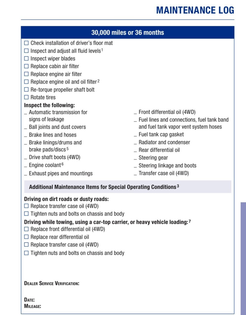

    No, it is recommended to replace oil in diffs and TC if you tow or haul often. TC is recommended if you drive on dirt or dusty roads. I think most people who use their trucks for anything more than commuting fit the ”special operating conditions” maintenance recommendations from Toyota.

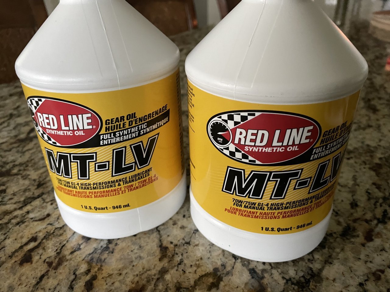

    Was at O’Reilly’s this AM and saw these. Went ahead and purchased them for my next transfer case service.
    Please confirm this is what my 2019 Tundra 4x4 calls for?
    Wallygator likes this.
  14. Feb 25, 2023 at 11:59 AM
    #44
    KNABORES
    KNABORES Sarcasm incoming
    Jan 1, 2020
    #40572
    14,753
    Arkansas
    Don’t believe that’s the spec. That bottle even says 70W/75W for manual transmissions and transaxles.

    is this the Red Line you are referencing?
  16. Feb 25, 2023 at 2:22 PM
    #46
    Wallygator
    Wallygator Well Zippedy Da Do!
    Apr 7, 2020
    #44761
    2,761
    Yes, that's it.. Compatible with the factory blood diamond golden child oil.

    haha. Truth, the Toyota oil is wildly overpriced. The oem stuff is $99 at every local dealer.
    Appreciate you confirming, will go ahead and replace this tonight.

    Yep that’s it. I got a 4 qts in to try
