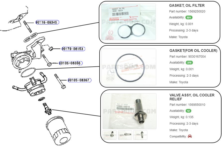

    I'm gathering parts for this job. The Toyota parts site tells me that 90301-67004 doesn't fit my 06 DC but this
    (96721-24025): engine oil filter adapter seal does.

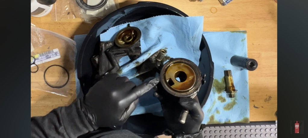

    That seal (67004) went between the cooler and the extension piece went the cooler cover is pulled off correct? Where dudes finger is in the video? He has the same seal part # you used. Sorta confused...

    I have attached the diagram I used. I looked up your part number and that doesn't look like it at all, and the diagram doesn't match up

    I just got off the phone with Toyota parts and he did verify it (67004) fits even though it says it doesn't fit. He said "it's full of shit and 97% accurate "

    So was it necessary to remove the center bolt/ check valve to remove the oil cooler assembly? I've seen a few videos, I think one was on a Lexus GX where the guy took it apart and it was a 30mm nut. Hard to tell if it was actually necessary. That same dude didn't clamp the lines going to the oil cooler and somehow didn't lose fluid.
    Pic for parts reference to help anyone that stumbles in this thread.
    https://youtu.be/-RUXBbS_V9I?si=eGuYZIZGNCYPWXfh

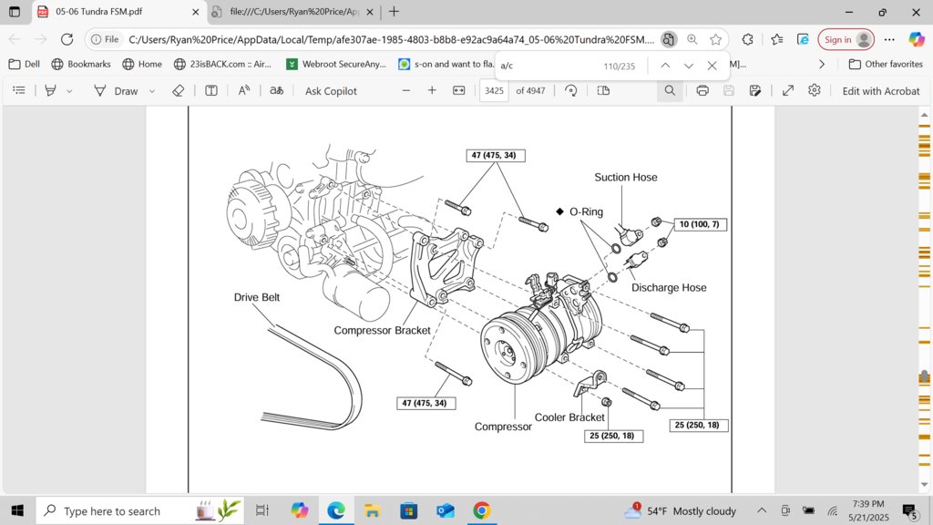

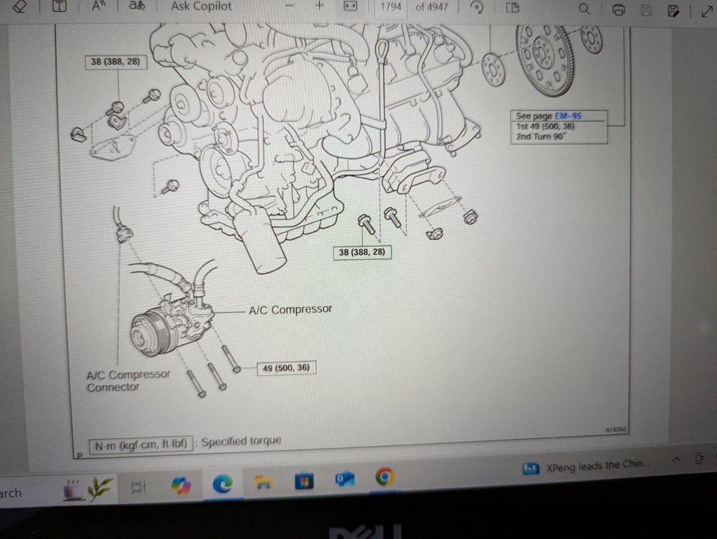

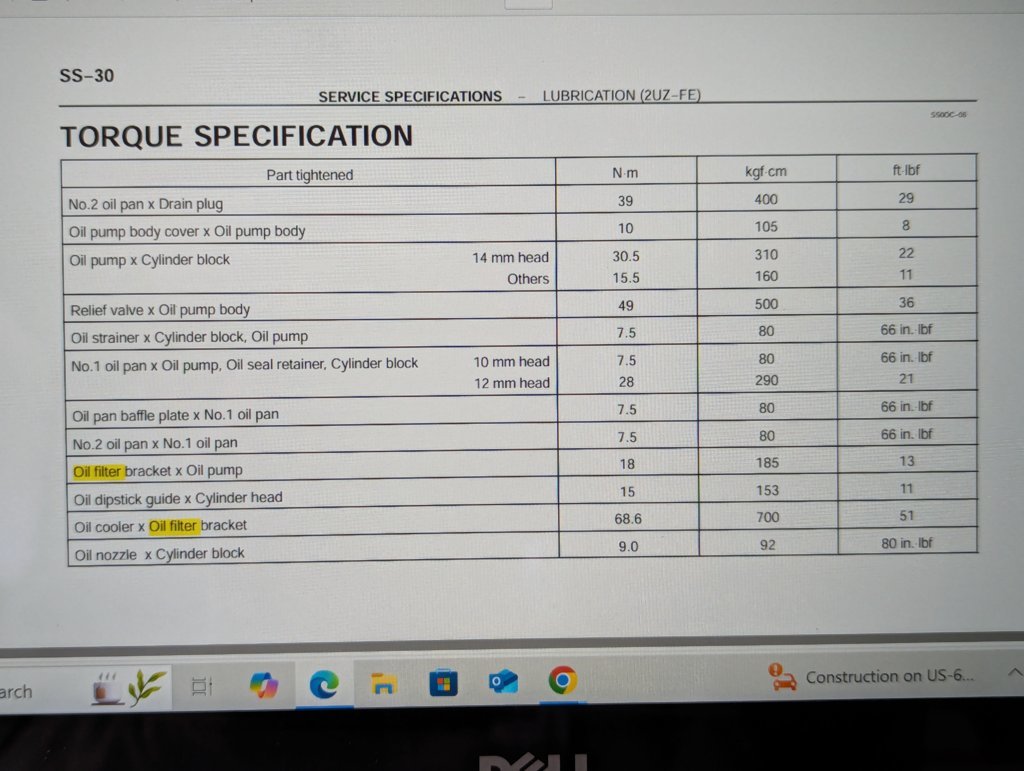

    Here's some more on this. Between the numerous threads I've stumbled upon via searching and the different questions being asked I've decided that here is the best place for these. Before I post them I think it's important to again thank @shifty` , @des2mtn , @KarmaKannon , @PHM, @DarknessReigns? @FrenchToasty and so many more that I can't remember handles of atm for the info they put out and help people with. I don't know if ya'll got a better system on your 'puters or what but searching through the FSM PDF is enough to make a person wanna give up lol. 4,000 pages and the search function being a piece of fucking shit about ended this computer today just to get these pics of diagrams and torque specs for the questions I've seen. Screenshot (6).png Screenshot (6).png

    Shit! I think one of those for the A/C bracket is for the 1uzfe...thank them! This shit is a pita!

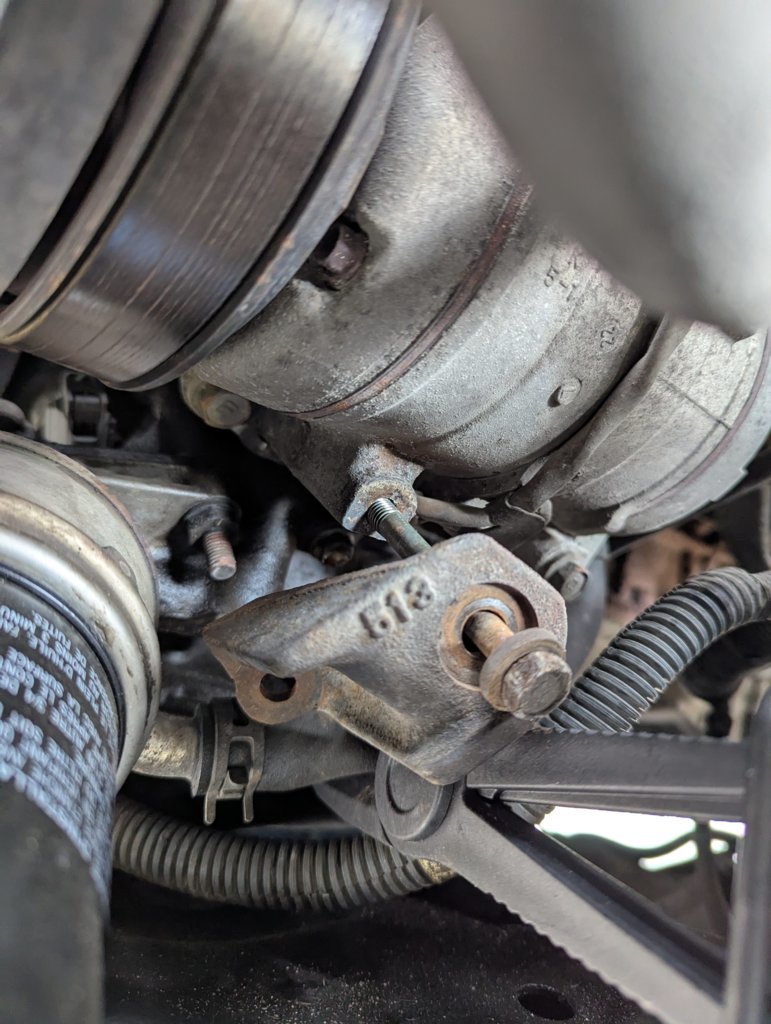

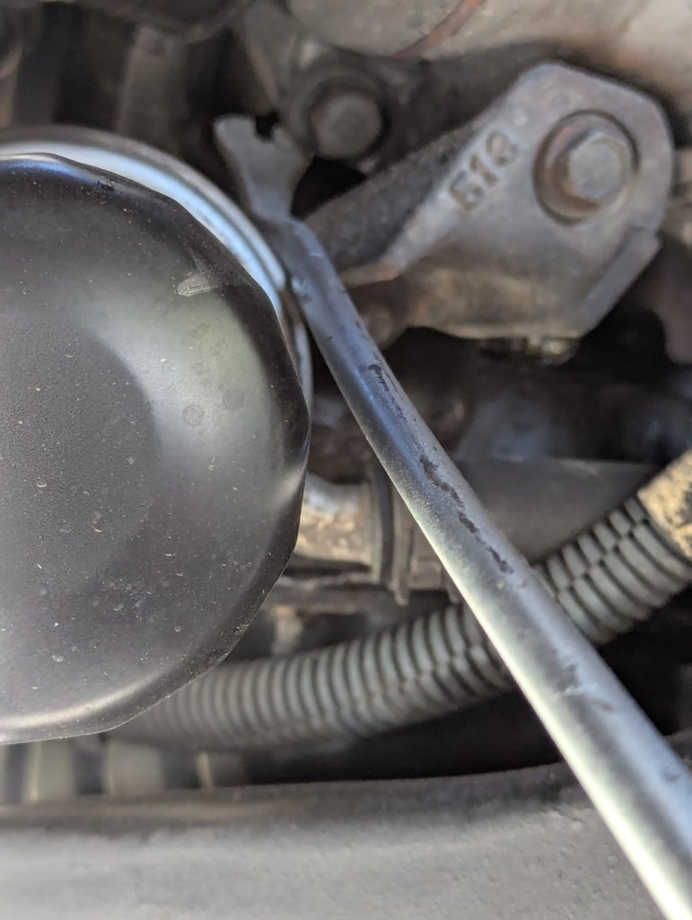

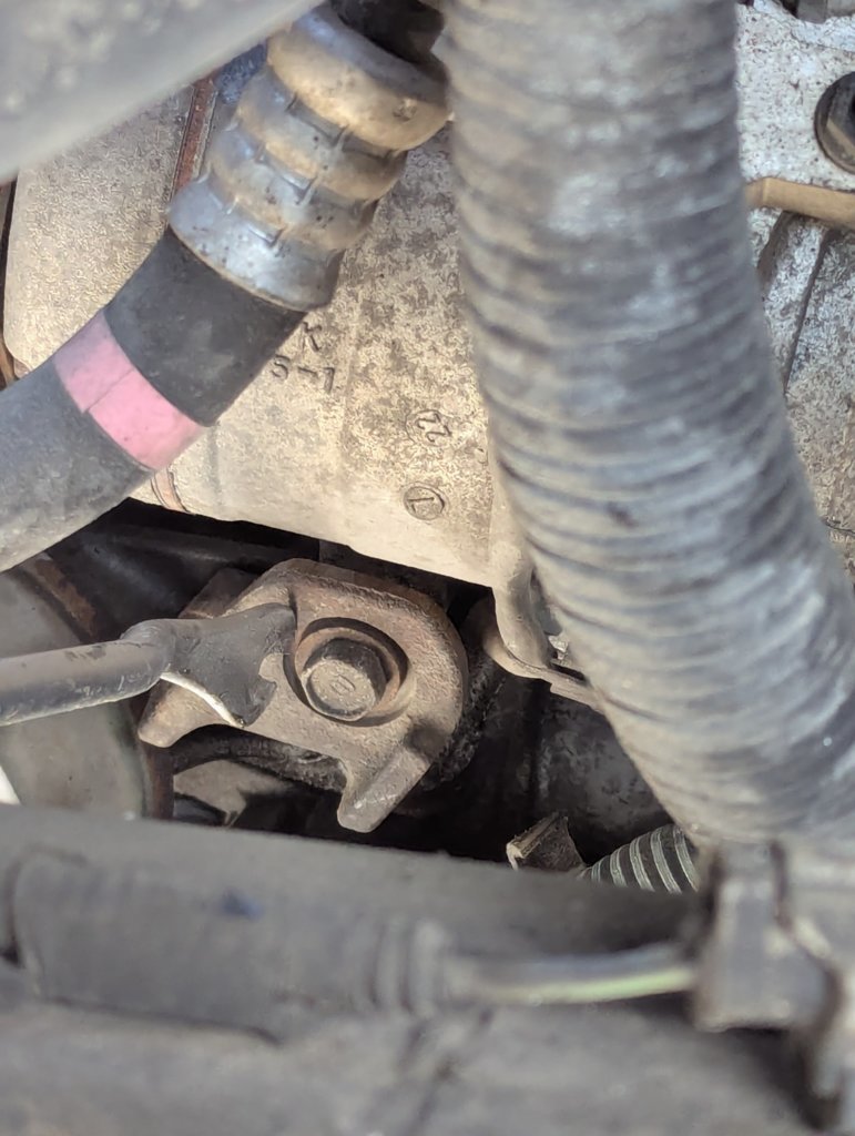

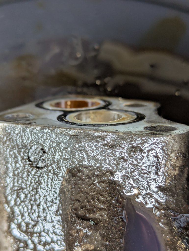

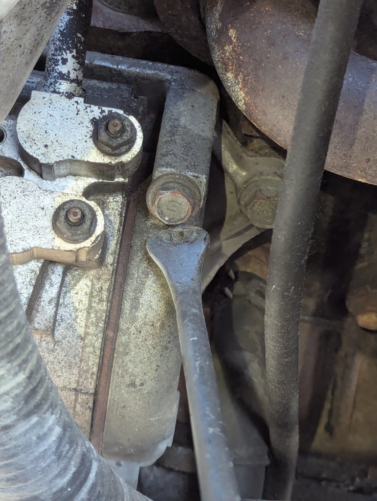

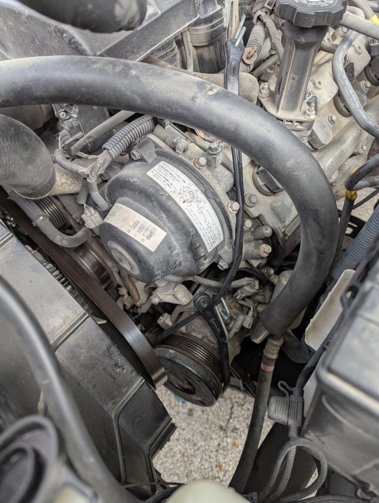

    So I got this done. It's not super bad just time consuming. Pull the inner fender well to get access to a couple of the bolts.
    In the photos the pry tool is pointing to the ones that either need to be taken out or loosened.
    Remove inner fender liner (this is the bolt that needs loosened but stays in to help hold compressor weight) I started here took it all the way out then threaded it back in a few turns.
    PXL_20250522_134406372.RAW-01.MP.COVER.jpg PXL_20250522_134422817.RAW-01.MP.COVER.jpg PXL_20250522_134648940.RAW-01.MP.COVER.jpg PXL_20250522_142329596.RAW-01.MP.COVER.jpg PXL_20250522_155155778.RAW-01.MP.COVER.jpg
    Old figure 8 seal
    New figure 8 seal
    The large seal between the cooler and the bracket was equally as flat.
    Remove the accessory drive belt from the compressor in order for you to swing it out of the way. The 14mm accessory belt wrench makes this fairly easy.
    The last photo is how I supported the weight of the compressor while working. If you zoom in the adjustable bungee cord is wrapped around the compressor and the hooked to the hook on top of the engine.
    I've attached a short for the hidden bolt behind the compressor also
    https://youtube.com/shorts/lsy4m2TbNMM?si=I7YSwp6aR9eFaUi8
