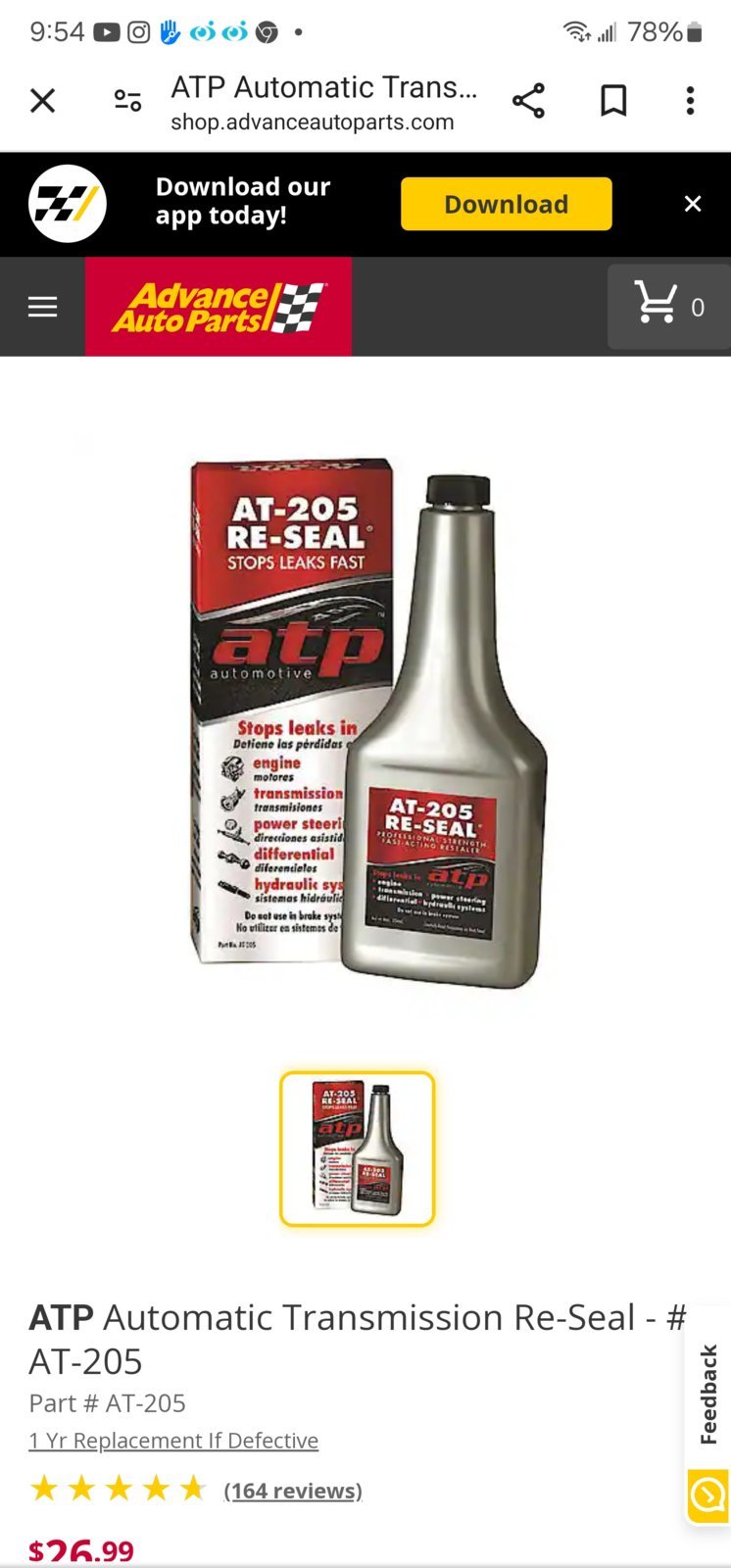

    I know the chemical your talking about. I've used it years ago when I used to buy acura legend for 500.00 because of blown head gaskets. But used this to smooth shifts after a transmission flush. Stuff works wonders. Maybe if it had low miles?

    They say (maybe even guarantee?) it won't over-swell gaskets like some of the other miracle-in-a-bottle temporary fixes do. "gasket rejuvenator" is ultimately how they're branding it. Worked to shore up my dry ass valve cover gaskets, only to find one final small leak was due to piss poor FIPG.

    Good idea I may have to get me a bottle today. They say advance have it but early 2000's Napa was the only place I could find it at.

    My two local Advance stores usually have it on the back wall, in between the Seafoam and CRC MAF cleaner. I usually order online and use coupon RMN15 to get 15% off for in-store pickup. It's already cheaper to buy it full price there than to order on scAmazon, the coupon is icing on the cake.

    Ok got you thanks!! Going to get some today. My buddy asked for a good product to use for his dodge truck and I totally forgot to mention this one. Your the man!!

    Took about 200-300 miles of driving before I saw full effect.
