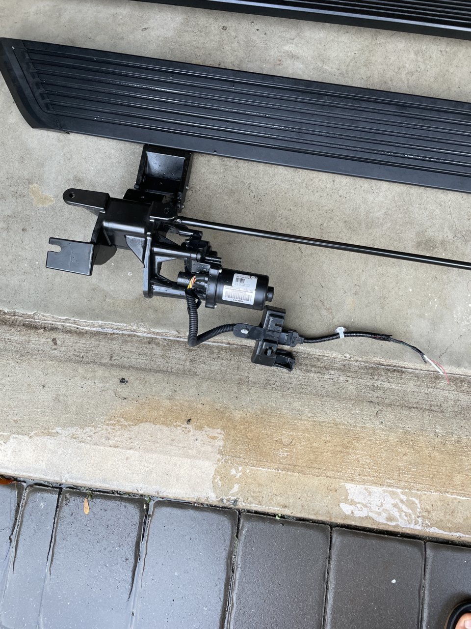

    hello friends, I've been reading this forum looking for the indication of the connection cables of the amp tundra 2022 step. has anyone managed to locate them?
    on the AMP website, there is no manual indicating the place to connect the starter cables of the steps.

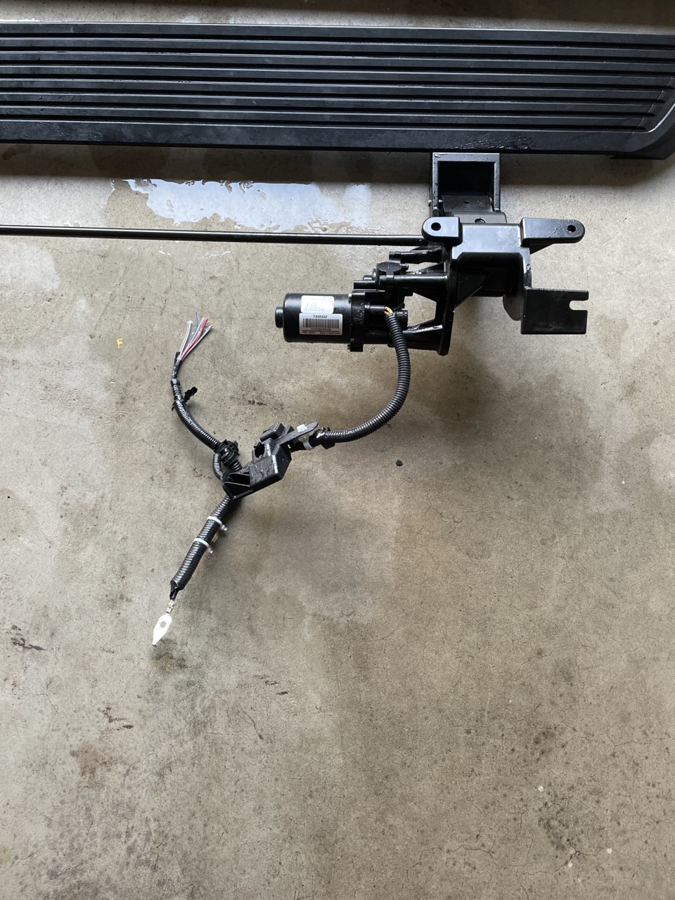

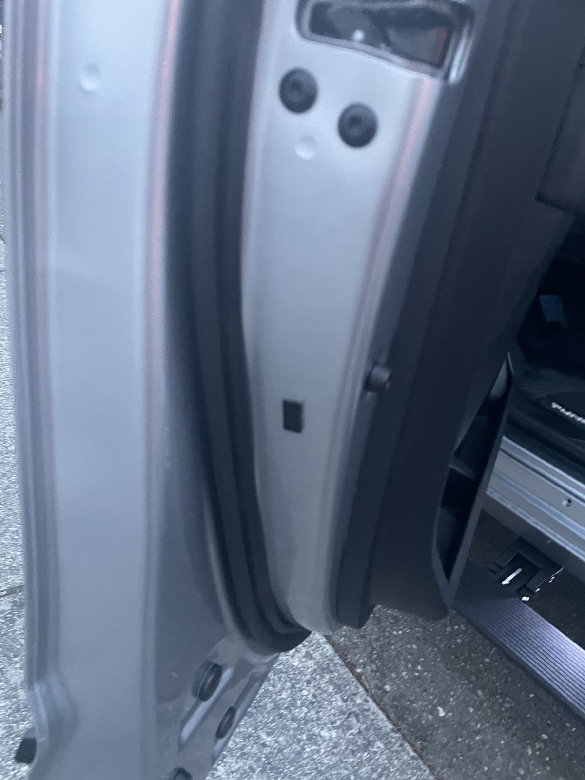

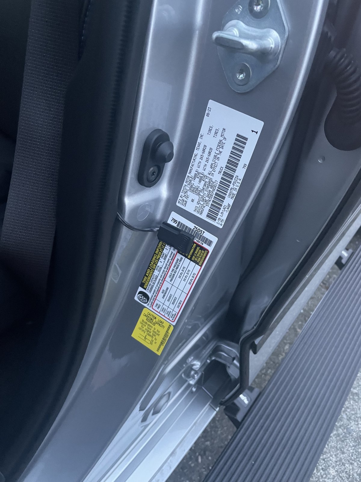

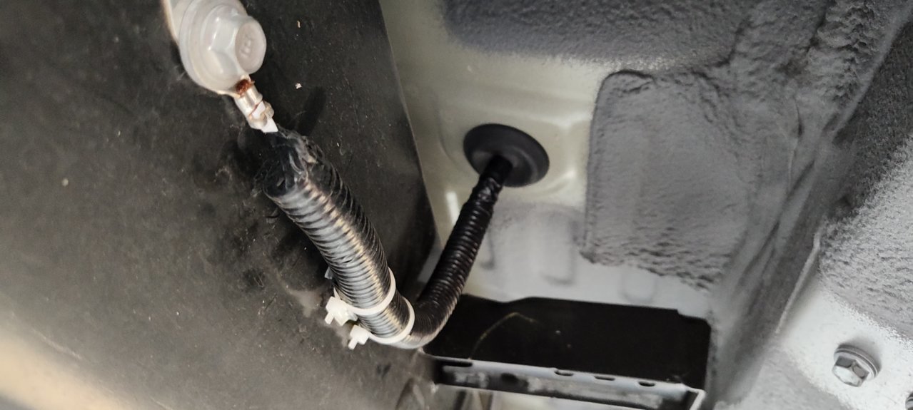

    I removed the first step and there is only one plug that goes to the main harness under the seat. I hope that the plug is already installed and is under the seat somewhere loose.

    On the truck side, where does the harness go? Like is it ran into the main harness?

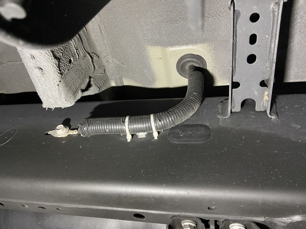

    Passenger has an additional ground wire that goes directly to the frame.

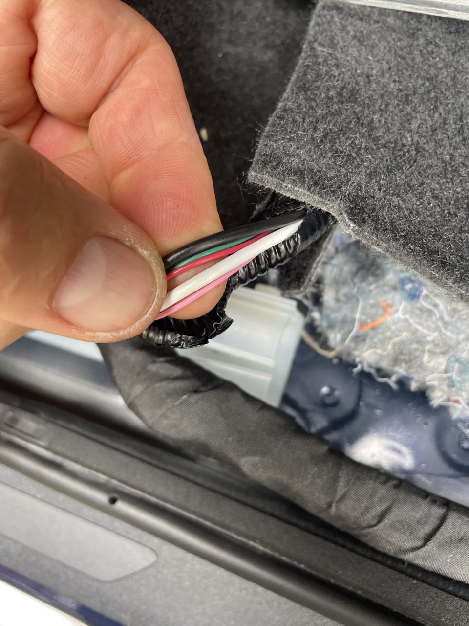

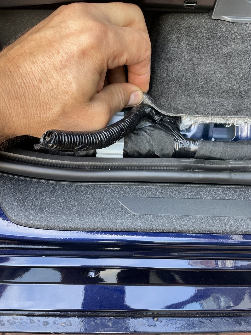

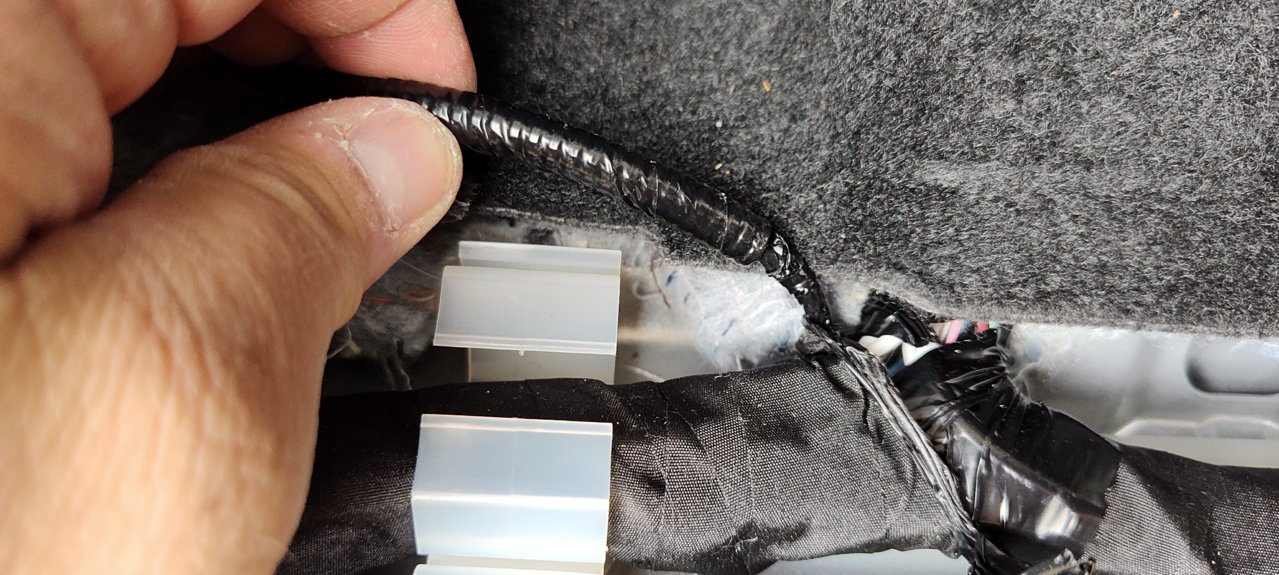

    Yes. Main Harness. See the second picture on the passenger side. Identical on the driver side
    Need to confirm now what a Tundra without the steps installed, has

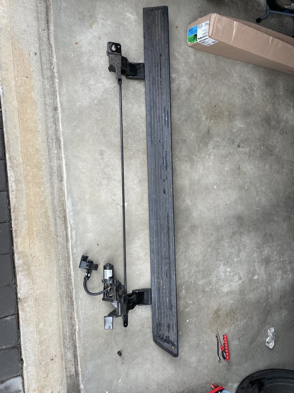

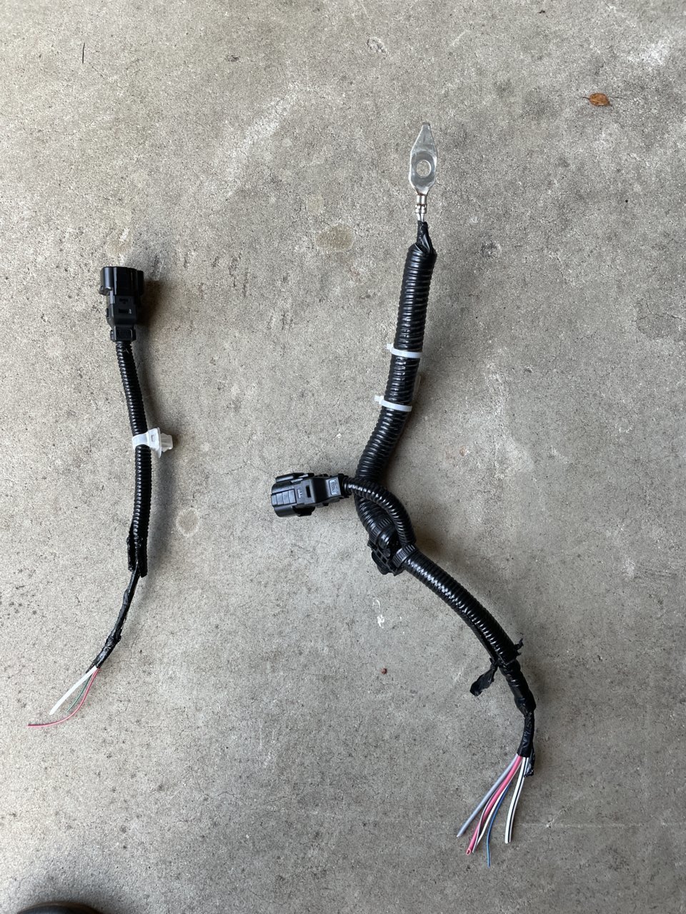

    image.jpg image.jpg image.jpg This is all you could remove up to the main harness

    May be a dumb question. But did you protect the other end in your main harness?

    You may need that ground wire. Mine has the ground wire but nothing else.

    Legit question. We can be in hurry sometimes and we forget the most basics things. I tape every wire independently. Thank you for asking.

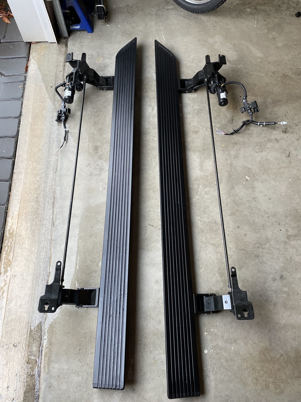

    So from the looks of all the OEM parts that Rockgate received from Toyota, that definitely covers the running boards. My dealership owes me both power running boards and power step. I will be calling dealership to get them to order the parts in, been waiting since March 1st. I only see parts for power running boards, does anyone have the power bed step part list? I'm pretty sure the power accessory switch controls both running boards and bed step. The doors switches control the running boards and the bed tailgate switch controls the bed step. Any help with power bed step part list would be greatly appreciated!

    So you're probably lucky enough to have the wiring in your truck since it's an option on Platinums and 1794's. If you're dealer owes you the parts, I'm pretty sure they'll find the numbers.

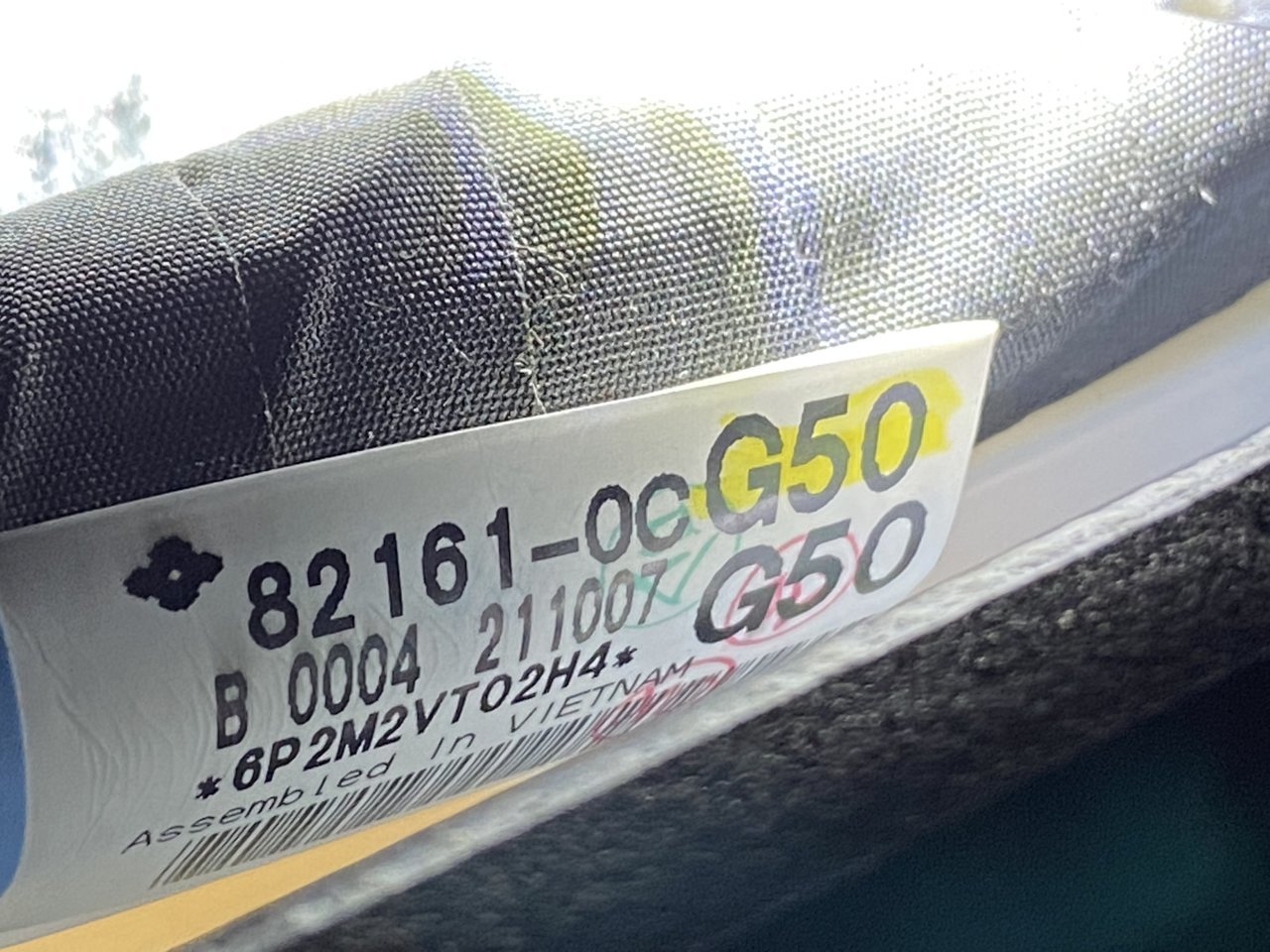

    Under the passenger front seat. Should be where the ECU for them is mounted. Possibly 2 plugs , maybe under the carpet where the split seam is. Under each front seat, there is a rubber grommet for wires to pass through. See if it's just a single wire or a small harness. On the left of the dash where all the switches are. See if there is a loose plug, possibly just clipped to the back of the hole cover garnish.

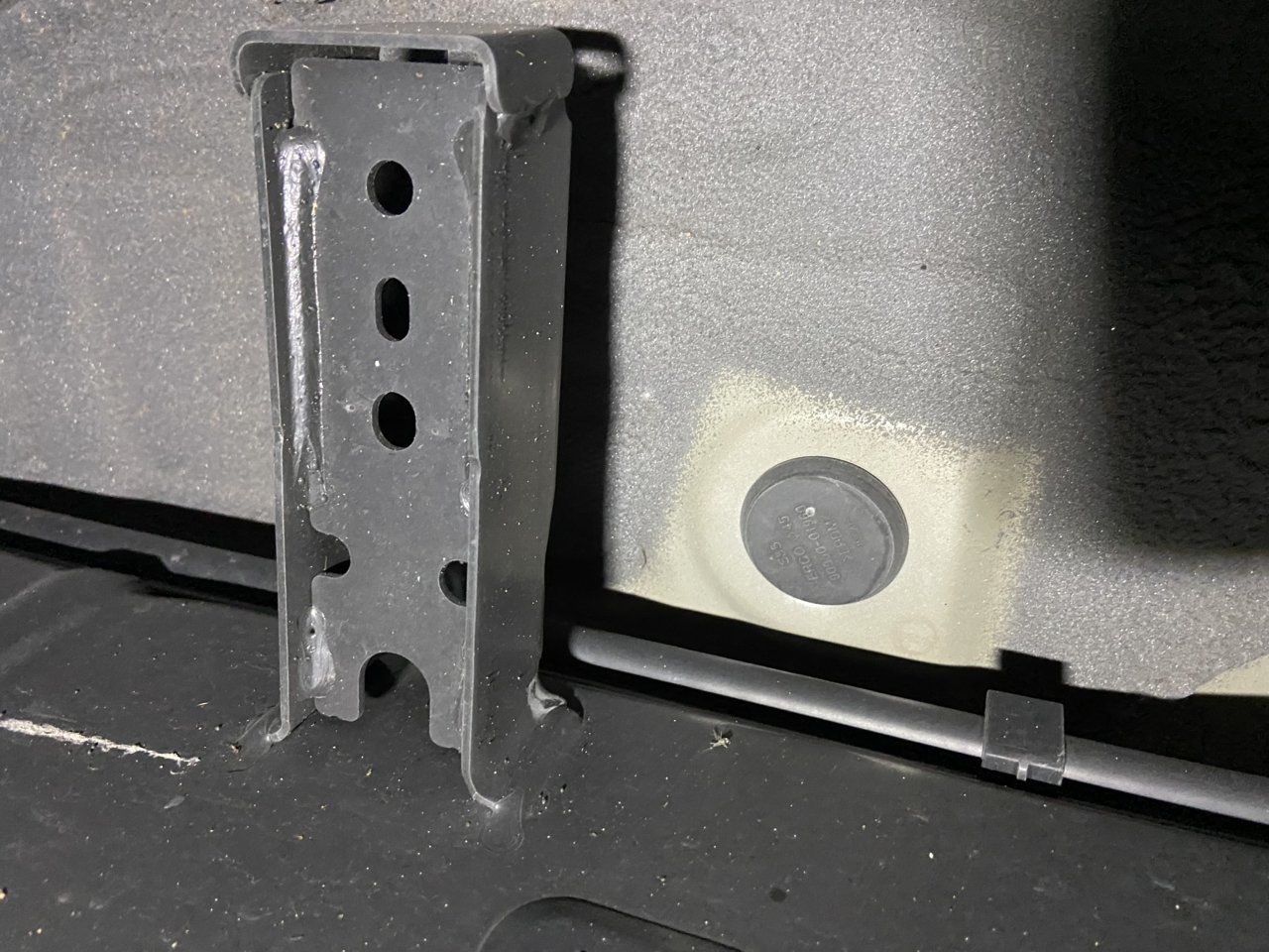

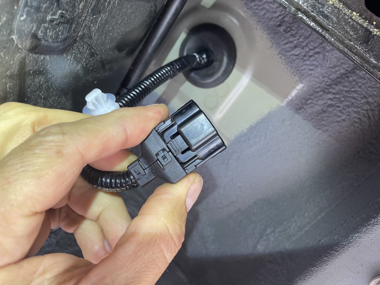

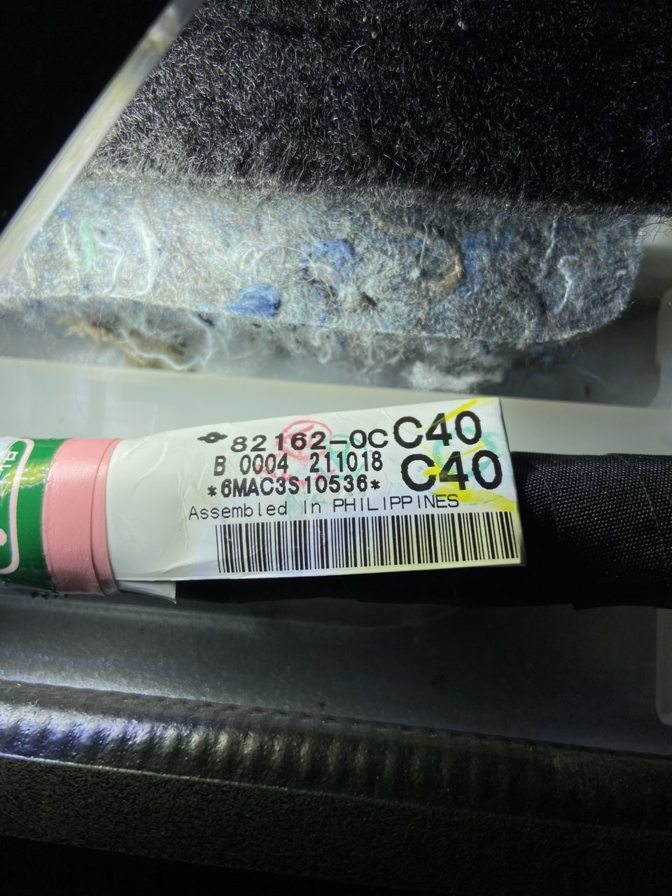

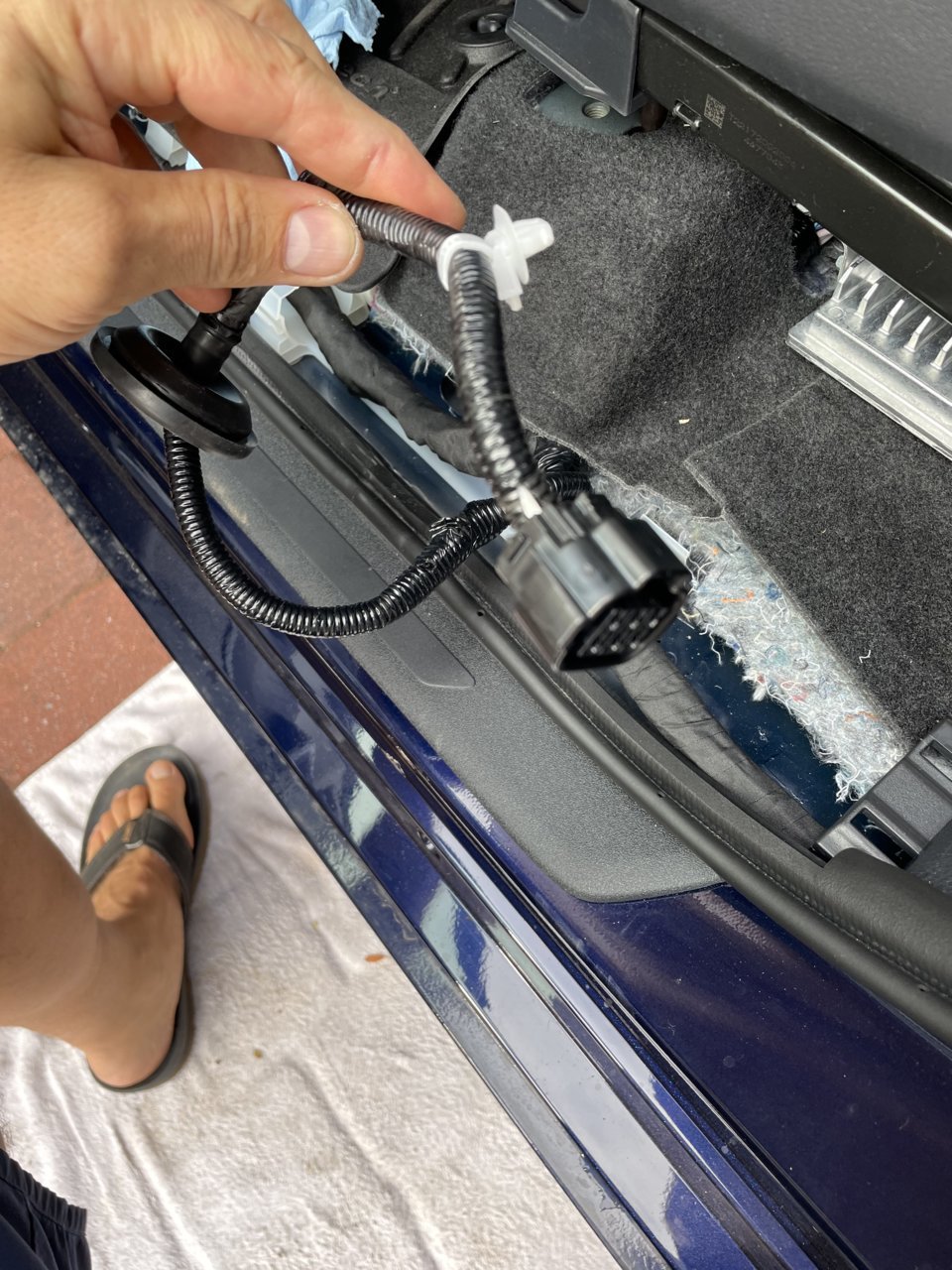

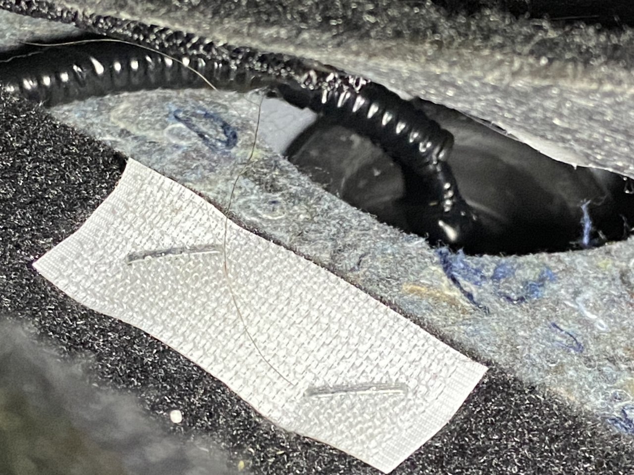

    Looked under driver and passenger side of truck, found blank rubber EPDM grommet underneath driver seat, no wires. Under passenger seat, found EPDM rubber grommet with ground wire just like your picture you posted. Doesn’t look good for me that the Platinum trim came prewired for these Power running boards. Looked under passenger seat to find the ground wire that comes through the floorboard just goes straight into passenger wiring harness underneath the foot trim. See pics and included wiring harness part numbers on both sides of truck to see if you have the same harness. C40 is driver side, G50 is passenger side. I did not see any spare blank plugs under the passenger seat to be able to connect up the pwr running board motor. I have not looked behind driver side switch cluster to see if there is a prewired plug for the pwr switch to connect. Will look at that soon. Also, I have the JBL sound system, so there is black plastic cover plate underneath driver seat, so not able to see if i have any unused wiring harness plugs for motor without removing driver seat. If any one else has done this, please let us know if blank plug(s) are already prewired for pwr running boards. I am starting to think that Toyota has gone super cheap and not provided the spare/open wiring plugs to add these Pwr running boards on any of their models. I guess that’s what you get with buying 1st year models, better to wait 2 to 3 years for manufacturer to work out all the kinks of manufacturing a complex vehicle.

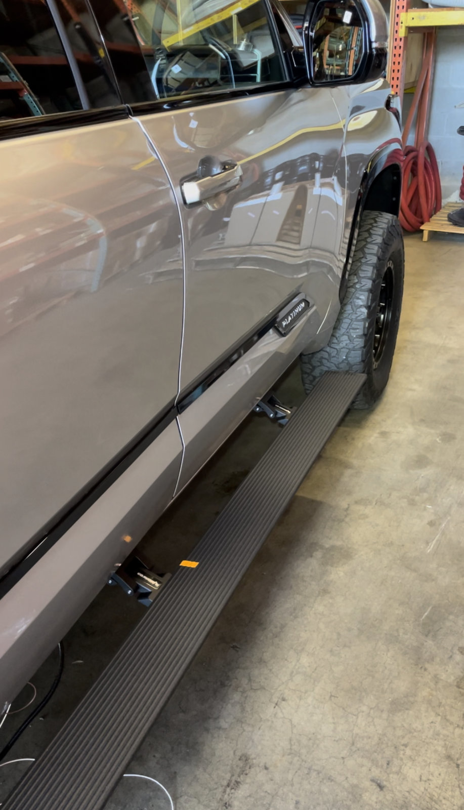

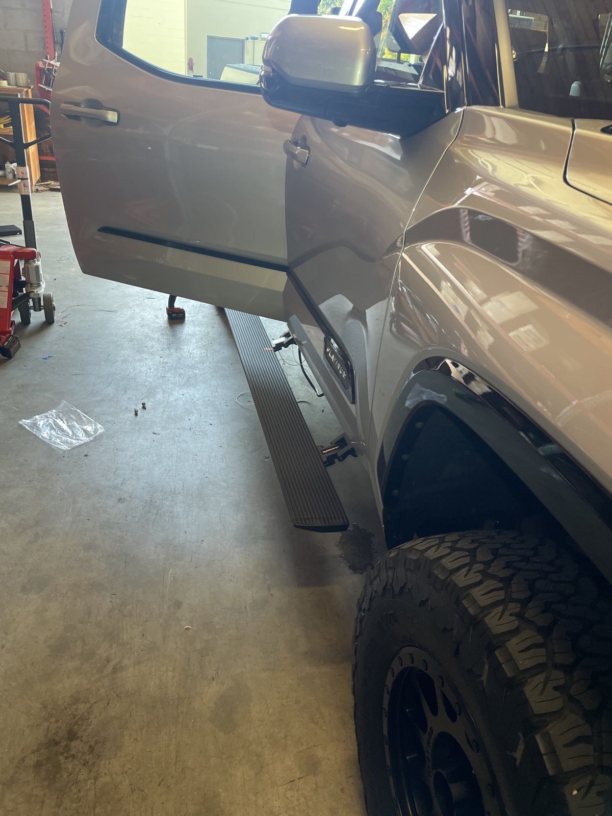

    I have a 23 platinum also.
    I bought both the Amp power boards and Go Rhino’s. I tried installing the Amp’s on Saturday. It took all day and they ended up not working.
    I got power to the harness, but splicing in the DCM to the port (white/blue) wires is where I had trouble.
    I uninstalled them and boxed them back up.
    I installed the GoRhino E1’s today, and I wish I would of gone with them from the start. The build quality is better, installation was easier, they look great.
    Like you, I didn’t want the magnet system. But after installing the kit, I don’t even notice the magnets and they work exactly how they should.
    Let me know if you have any questions.

    @MurphyT206425 I have a question. What do the magnets look like? The switch?

    There’s no drilling or alterations required to install the go rhinos, correct? I’m probably just doing the trd boards but am curious about these.

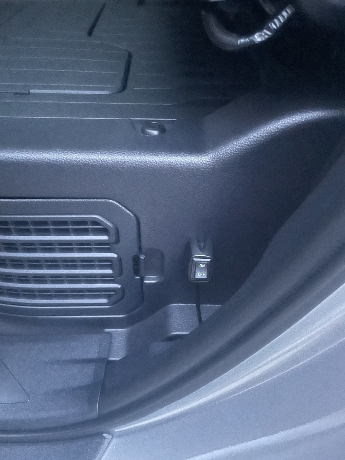

    Attached are some quick pictures I took of the magnets. The switch I routed and it ended up by my hybrid battery. I thought it was a decent spot for it.
    I did drill 2 holes underneath to route the wires from the passenger side up and through (passed them along through the storage/battery compartment) and then a hole on the driver side rear to pass them back down for the driver side hook ups.
    I can take pictures of that if you want to see them.
