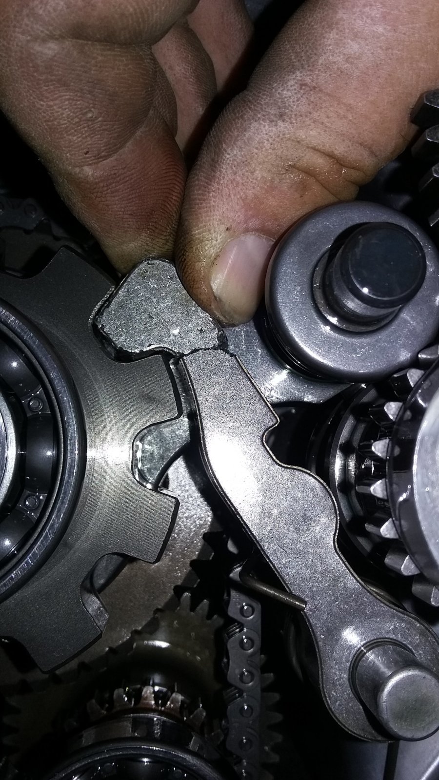

    If you knew just how small a piece of metal the transmission rests on vs the E-brake you'd do it all the time - that is my habit - always use it. That way just in case it gets tapped while parked the stress goes to the brakes and not the trans pin. Luck all.

    In truth, the parking pawl normally locks up with the output shaft teeth and is the failsafe against a parking brake failure, not the other way around. Here is a photo of a broken one. Though not of a 4Runner, but this is representative of a size for one. Notice it is broken and the size compared to the mechanic's thumbnail. The entire weight of your vehicle rests on that if that is all you use when parking.

    What is this picture of?
    Is this what it sits on when sitting on the transmission?

    I wonder if that pawl is made with in mold injected metal?

    I thought it looked like MIM as well given the porous look. It doesn't look machined. I don't know if they are normally MIM, machined or forged. I don't know the vehicle make or model either.
