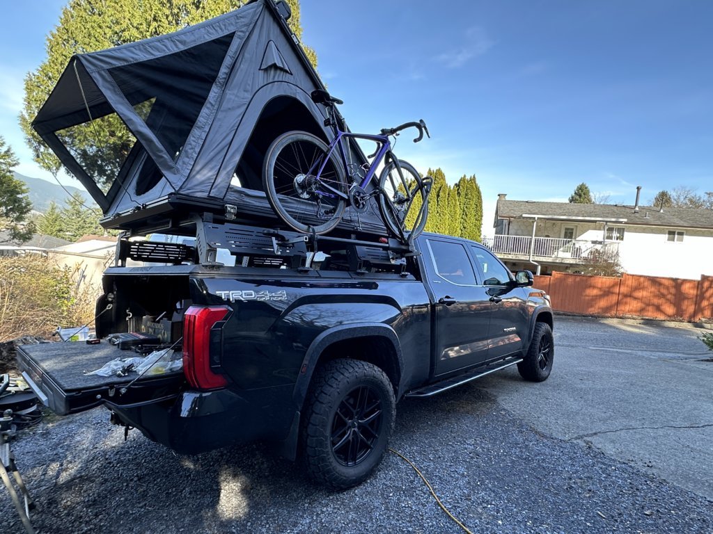

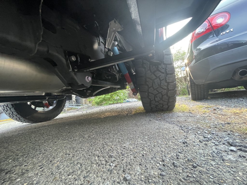

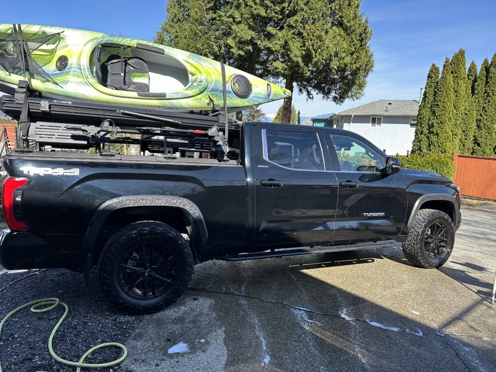

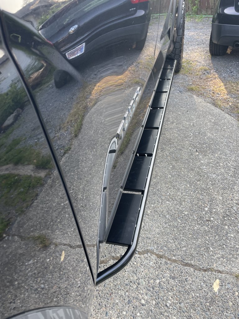

    This is what I put together on my Tundra. The kayaks sit on top of the tent when closed. Bikes can stay up there except when the kayaks are loaded or unloaded. The bikes also provide a bit of protection if a critter wanted to pay a visit and climb into the side of the tent :)
    These were solid, I could jump on them all day long and they didn't move. We made the board section out of Stainless Steel material and the 5 mounts out of steel and had it all powder-coated. The supports were showing some rust after 1 year but the boards were perfect except for the shoe marks.
    Hope this helps you!

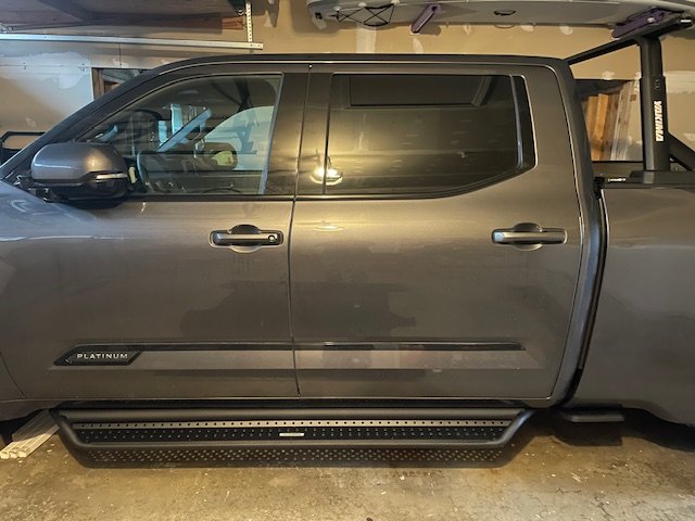

    I had a generous offer from PBNB, but it ended up being more money than I could spend.
    But I waited and almost got exactly what I wanted.
    AMP makes a bedstep, that works on the rear bumper - driver side only.
    They also have a bedstep2, for the side, which originally was NOT available for the 3rd gen tundras.
    But now they do, for both sides. It's a couple of inches lower than I would prefer, but it works.
    And I paired them with the Go Rihno Dominator D1 Side Steps
    rear: https://realtruck.com/p/amp-research-bed-step/v/toyota/tundra/2023/
    side: https://realtruck.com/p/amp-research-bed-step-2/v/toyota/tundra/2023/
    steps: https://realtruck.com/p/go-rhino-dominator-d1-side-steps/v/toyota/tundra/2023/
