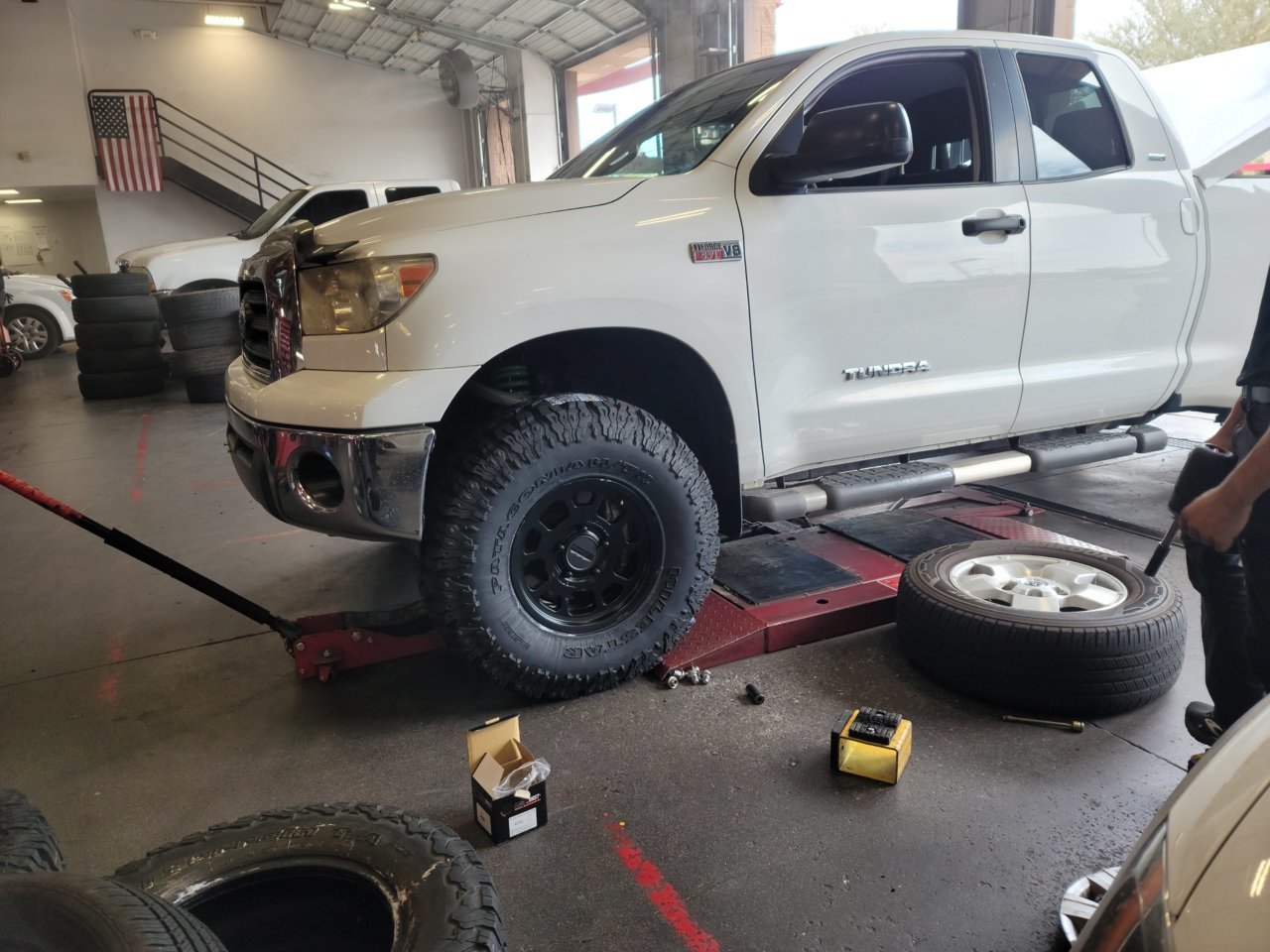

    I just got back from Discount Tire. They mounted one of my 37x12.50 tires on one of the +35 17x8.5 Method 705s I bought and test fitted it on the front of my truck to make sure it clears the UCA.
    I was able to slide my big fat fingers (between the first and second knuckle) between the tire and the UCA, meaning I have probably 5/8in of clearance.
    So I am pretty sure you are going to be just fine with your setup.
