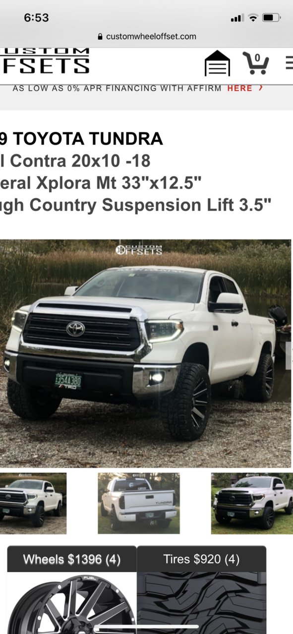

    I’ve been looking at the image gallery on the custom offset website for days and hours. Been lurking on this forum on people’s builds. And I just can’t decide.
    i have a 2018 dc sr5 trd cement, stock. I drove the truck 1,400 miles (one way) to hunt out west last year. Total round trip around 3,000 miles. I plan on going out west to hunt every year. The 2 tracks out there can be sketchy. I went everywhere I wanted to go, but at times wishing I was better equipped. I also want to give the truck a better look and stance. I also don’t want to spend $3000 on a full toytec setup and/or hack the truck up trying to jam wheels/tires in to fit without rubbing.
    i “think” I have what I want narrowed down, but am looking for input.
    3.5 inch rc lift with the uca’s (the $550 one)
    20x10 wheels with a -19mm offset
    305/55 20 falken at3s.
    i like the stance with that minus offset. Is this a good setup for thousands of miles of pavement driving and then 2 track 4 wheeling/crawling? How off-road worthy is that rc lift? Should I do what it takes to get a 35 inch tire in there? Will that 35 inch tire be better or worse than the 33 in off-road situations (rubbing, bottoming out, travel, etc)? Should I toss the blocks in the rear and go with shackles or add a leaf?

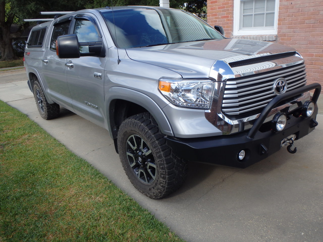

    I chase pheasant out west every year usually North Dakota. Plenty of sloppy 2 tracks under my wheels, one year with an 8 hole dog trailer behind me. 2/0 lift on 295/65/18 Duratracs in this pic then switched to 285/70/17 when I changed to RW wheels. So far, I have gotten everywhere I want to go and been satisfied with the trucks road manners. Stock rear with Toytec coilovers set at 2"

    Tell us more about the Rough Country lift that you are referring to. Is it spacer/levelling kit? Or is it a coilover replacement type kit. I ask as the difference between the two is night and day with regards to ride quality and off road capability. Also, that is a lot of negative offset for a 3.5" lift. The tires you mentioned are 33's, so you are only going up about an inch in tire diameter over stock. But due to that -19mm offset, you are probably going to be doing some trimming to keep it from rubbing in turns. And understand, that -19mm offset is going to reduce the life of your wheel bearings. Just an FYI.

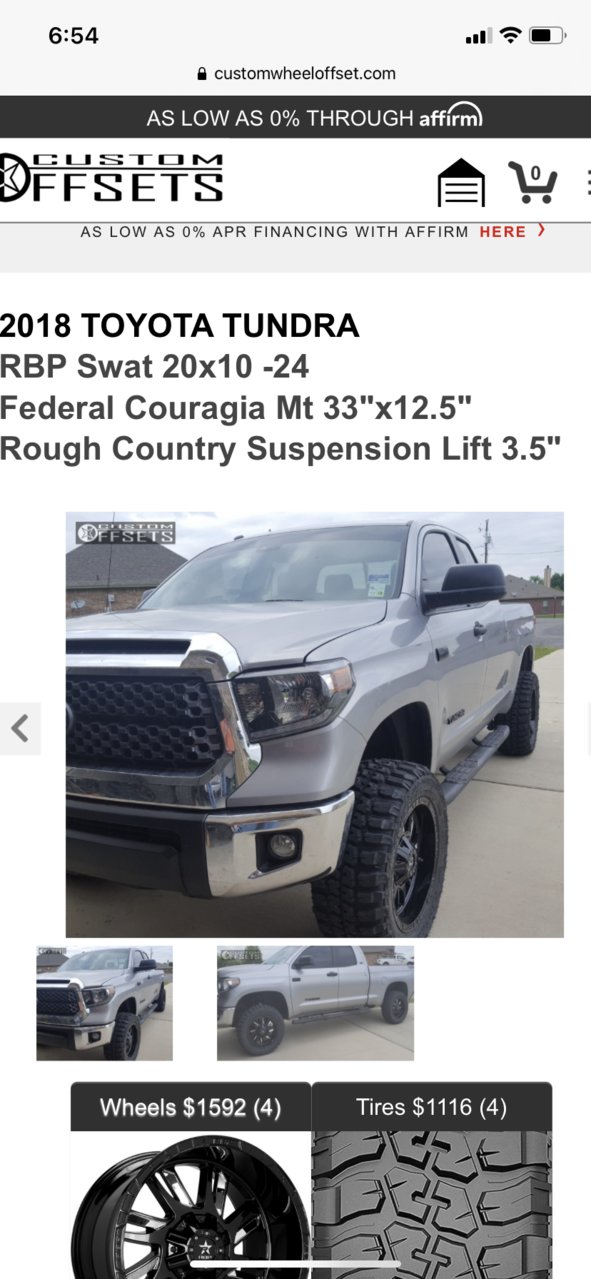

    This lift.
    There’s a couple examples of what I’m referring to looks like (although the one example is a -24mm offset). Both say minor trimming. Several other examples on the custom offsets site with negative offsets, 33s, 3 inch lift - all seem to have little to no trimming. Sticking a 35 on with a 3 - 4 inch lift all say major metal trimming (I’ve been down that road with my old Nissan Titan - wasn’t pretty.)

    OK, so you want to install a spacer type lift. My personal advice is to save your money until you can afford a coil-over lift as it will give you much, MUCH better ride quality. That being said, the RC 3.5" spacer lift will probably actually equate to a 3" lift when all is said and done. So take that into account when deciding on your wheel offset.
