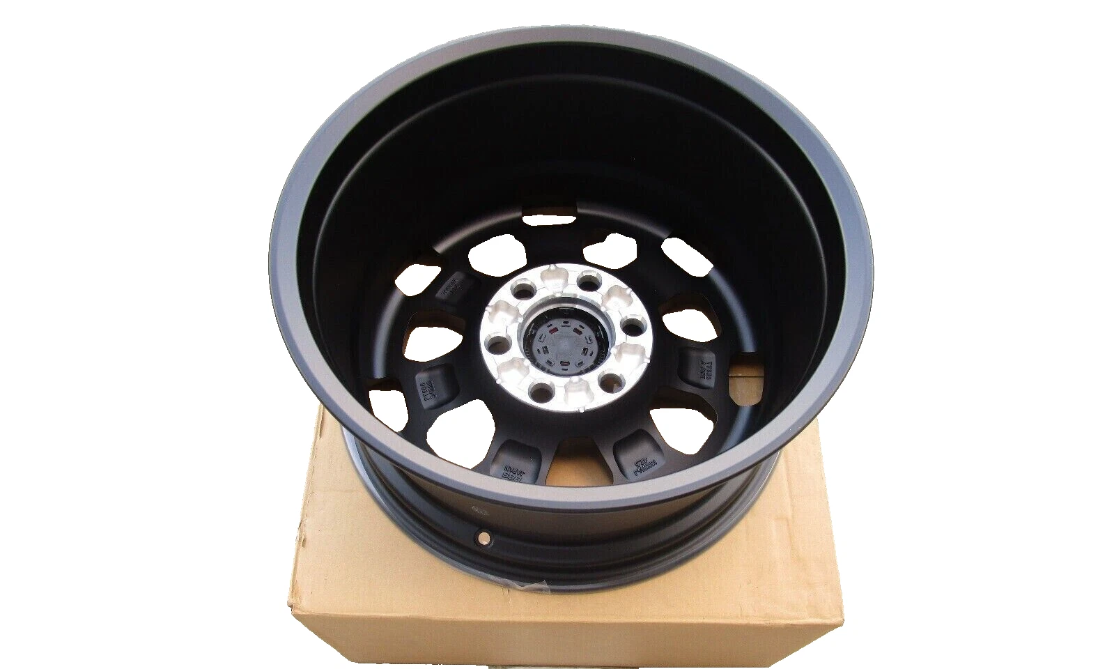

    I currently have the TRD wheels on my truck, is anyone running a 1” spacer with the factory wheel studs with these wheels?
    If so, what spacers are you using?

    1" spacer might be too short if the studs are the same length as the 2nd and 2.5 gen trucks. To my knowledge you can run the shorter spacers as long as the wheels have a pocket for the extra length of the studs to go (look on the backside of the wheel or the mounting surface, if it has pockets in the spokes between the mounting holes you should be ok but don't take my word for it... or you could shave down the extra length but I would personally say just get the 1.25" spacers before doing that)

    I got 1in spacers and the studs poke out a bit. Not a problem on oem wheels since they have pockets on the back but you wont be able to use the steelie spare.

    I'm running SpiderTrax 1 inch spacers and stock wheels with no issues. Studs are flush with spacer.
