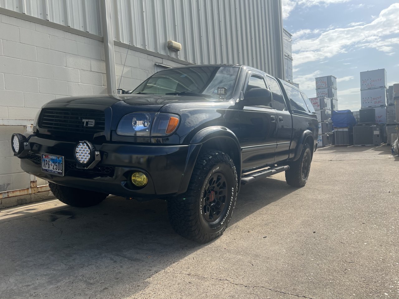

    I have a kind of oddball size of wheel I have an 03 TRD with the flares and want maybe a tiny amount of poke I got mr315 17x8.5 0 offset which has 4.75 backspacing I was thinking 1.75 in wheel spacers anyone recommend any other size?

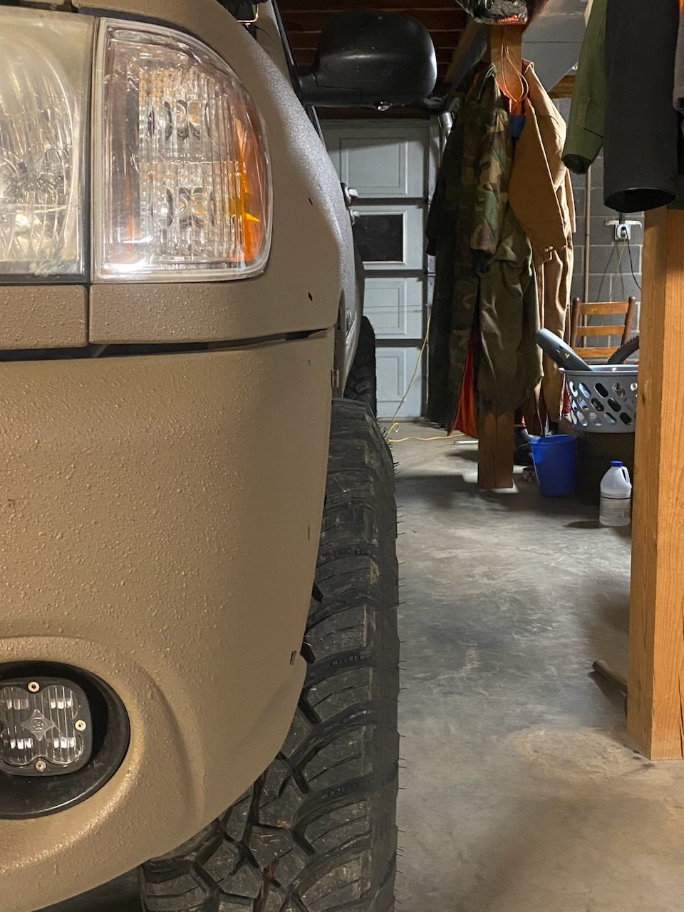

    I’d do 1.25 at most. I’ve got 1.25 on 4.5 backspace and 0 offset wheels and 285’s. My flares are off because i rubbed so bad. The pinch welds are cut and beat flat also. Puts me around 3.25 backspace.
    4.5 backspace was pretty much flush with the fenders and had no scrub.

    I am either getting a 33x12.5r17 or a 285/75 just decided to do something easier
