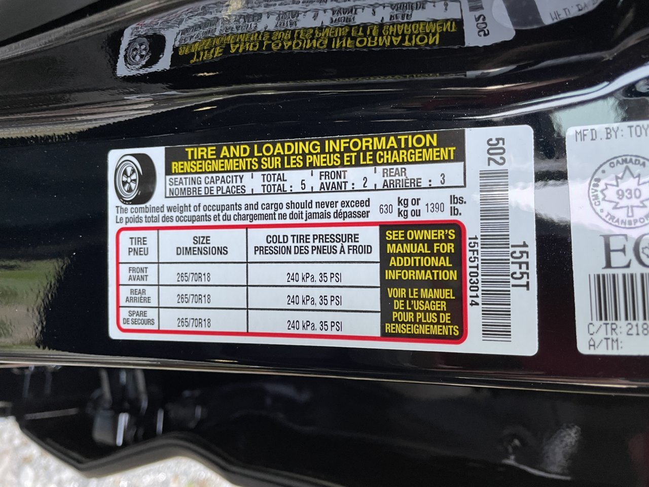

    I am wondering if any Gen 3 owners would mind sharing their payload numbers off the door sticker or even post a picture, like mine which reads: 1,390 lbs.
    Apparently there is a configuration that is over 1,900 lbs! With that config you will probably have to sit on a plastic milk crate! Does this unicorn even exist?
    I am looking at the different trims and options to see where the biggest hits to the payload are occurring

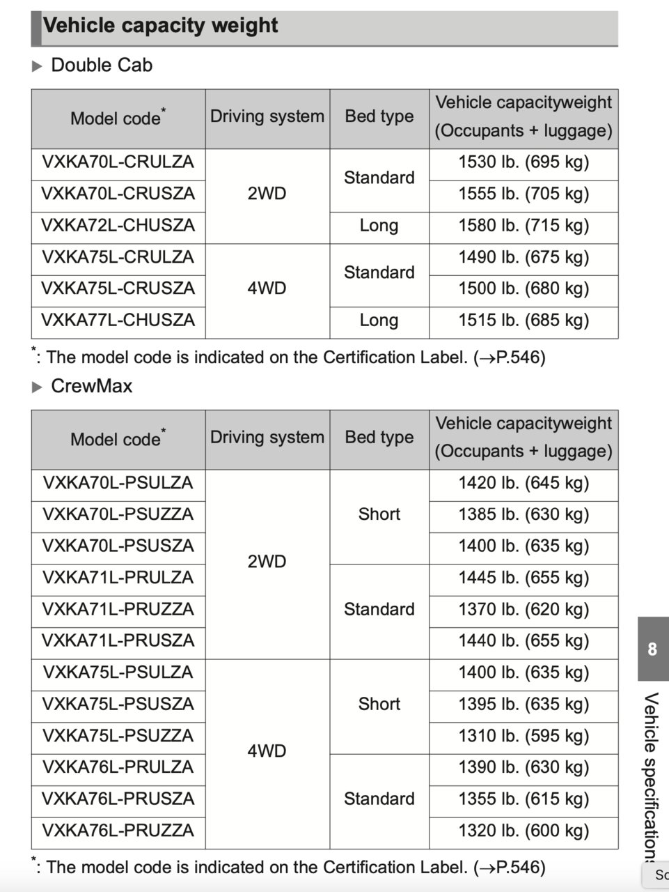

    I got this from my manual. It seems that the best payload number is found in the 2WD Long Bed at 1,580 lbs. I think that doing the weight confirmation at a scale is a good thing to check these numbers. Perhaps the extra ~200 lbs. found by doing the math on your GVW is a safety margin that Toyota built into each payload number?
    If it is about sales and marketing, I would expect them to show higher numbers in a very competitive 1/2 ton market.

    I dont think its a safety margin. I bet what you find is that they heaviest, most optioned trucks might have the least delta between their payload sticker and their actually scale numbers.
    They are applying a single value to every truck of any configuration regardless of options so they are having to build that into the number.

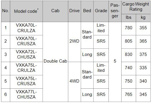

    There is another table in the manual that decodes what the different model codes are, although it seems to be missing some trims. Maybe the 2023 manual has a better table:

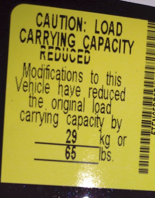

    I also have this on my 23 Plat HEV. So on paper, I have 1305 - 65 = 1240 for payload... and yes, I'll be going to a CAT scale soon.

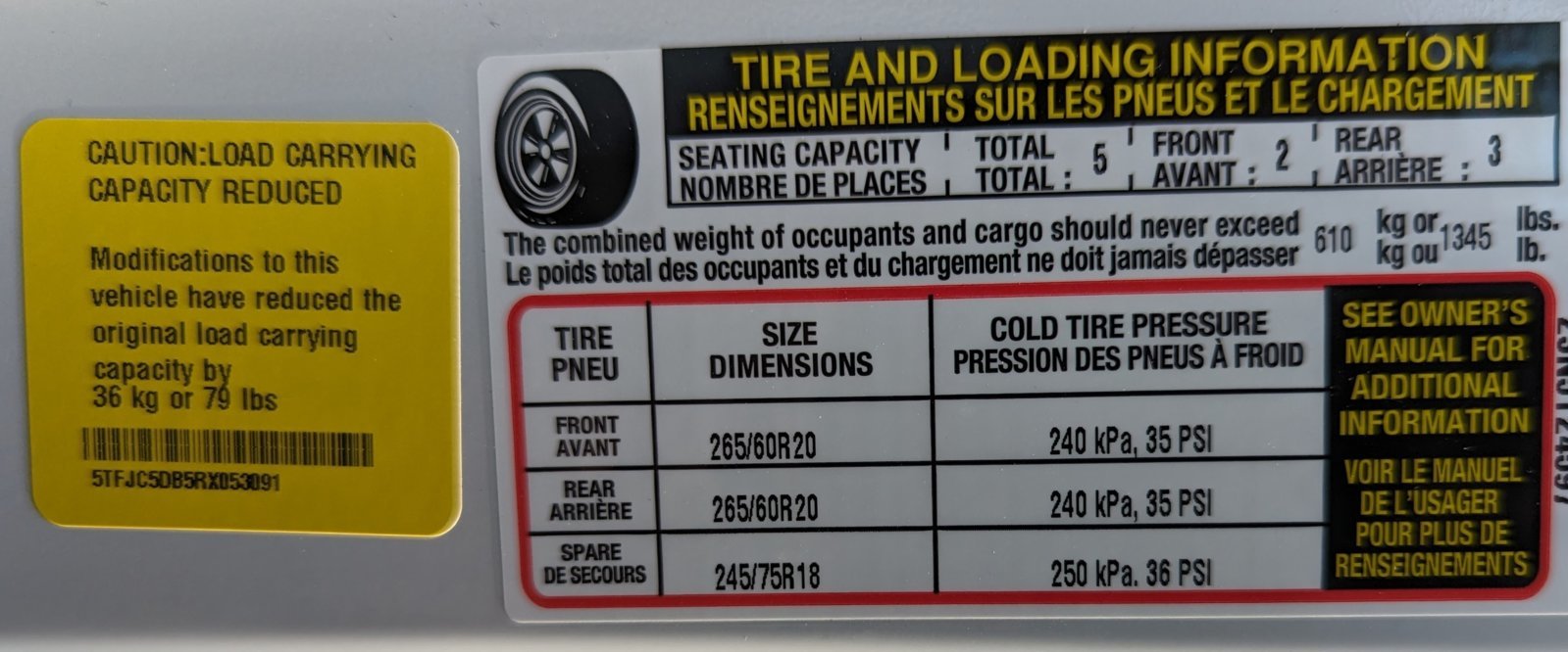

    My truck is the same configuration as the OP's, and I have the same main sticker. However, I also have one of those supplemental reduction stickers. What's up with that? You'd think they would just print the correct numbers based on the VIN.

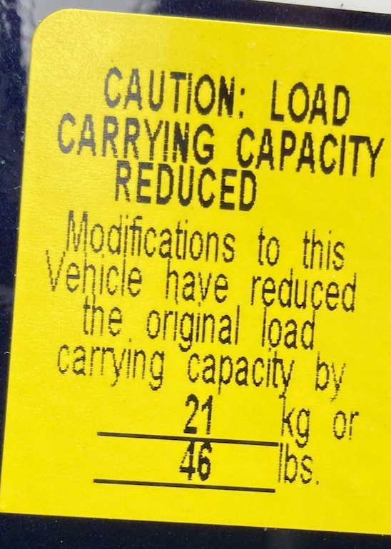

    I have an upgraded sticker on my 2014.
    It isn't a weight reduction, but tire pressure.
    It was because of a Gulf States port added TSS trim level 20" BFG KO tires.
    It was added after the VIN was created.
    You must have a port or dealer added option added to your truck that weighs around 46 pounds after it was assembled.
    That's my guess anyway.

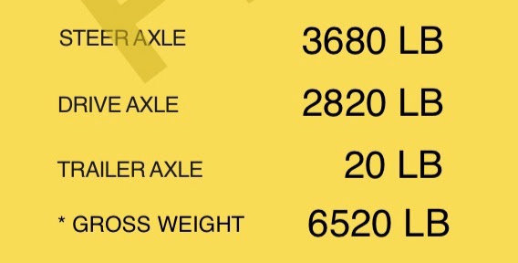

    This is a family members 2024 4x4 Limited Hybrid CM:
    This is the truck scaled with 350lbs of people. (Full gas tank, stock truck, no gear)
    7615 (GVWR) - 6520 (Scaled weight) + 350 (people) = 1345lbs
    1345 (Factory payload number) - 79 (factory mods lowering payload = 1266lbs
    All this to basically confirm that the factory sticker is accurate. Makes me wonder if the dealer even added those modifications that supposedly lowered the payload by 79lbs.
