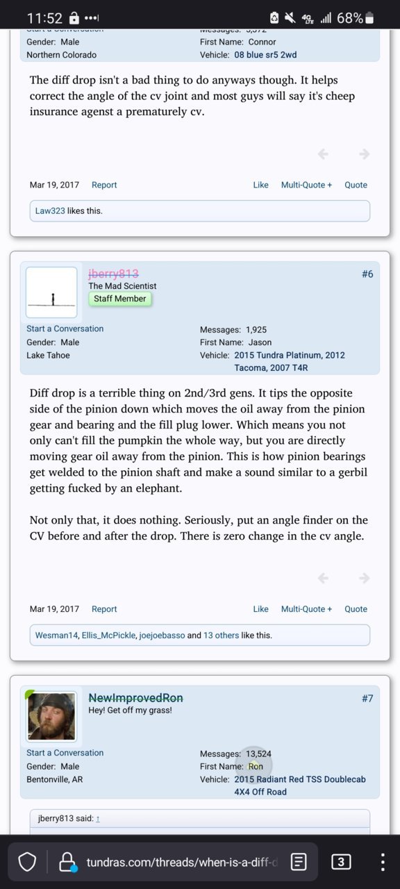

  4. Jan 23, 2022 at 7:50 AM
    #34
    2mchfun
    Dec 31, 2020
    #56879
    6,994
    Dan
    Beware there is a lot that goes in to modifying the susp. Little mistakes like not extending bump stops to compensate for lift can easily turn into damaged parts and costly mistakes. Like many other things in life 1 thing leads to 15 others!

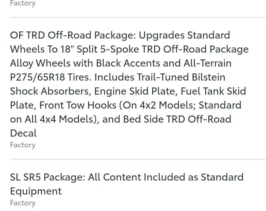

    Screenshot_20220123-100807-118.jpgthis is what the Toyota app said i had via my VIN, i didn't know about the Bilstein

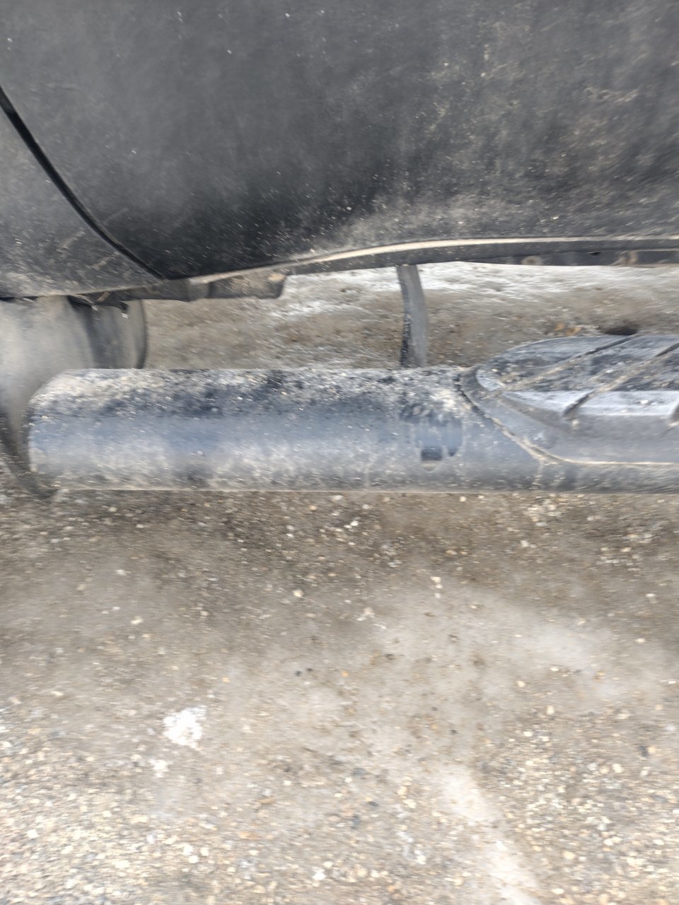

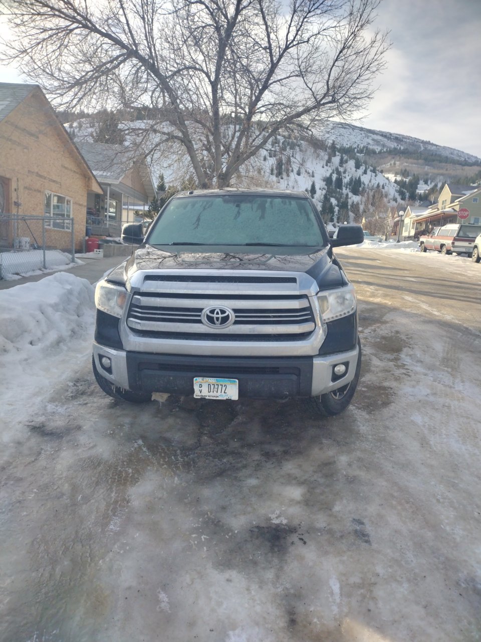

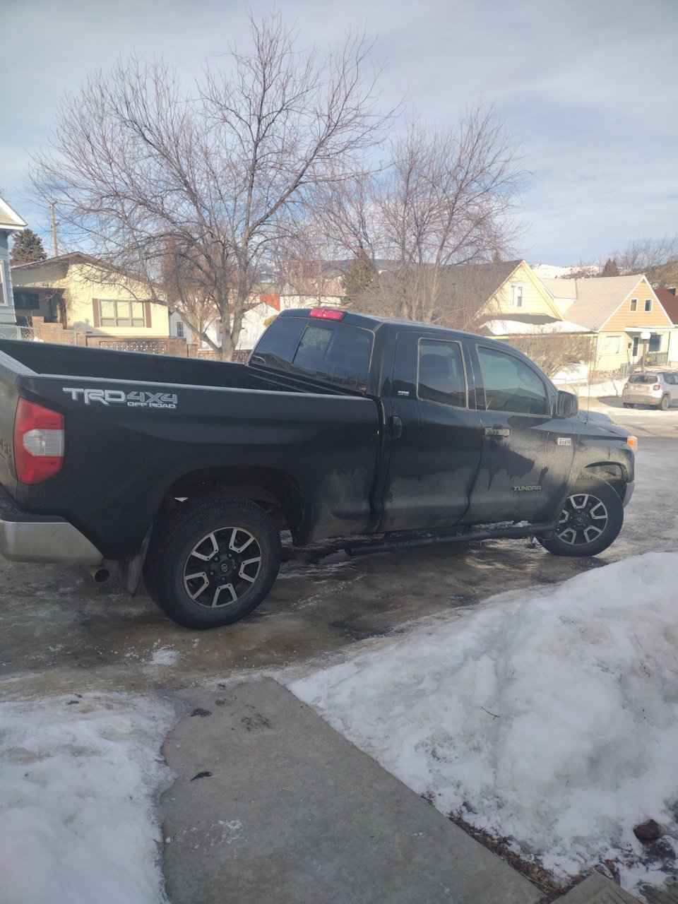

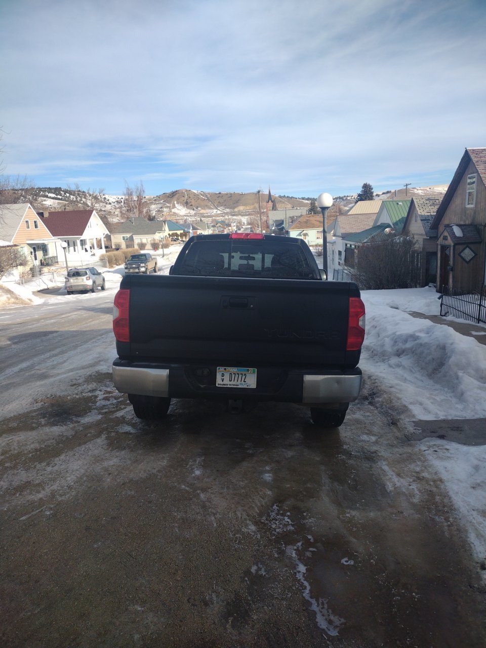

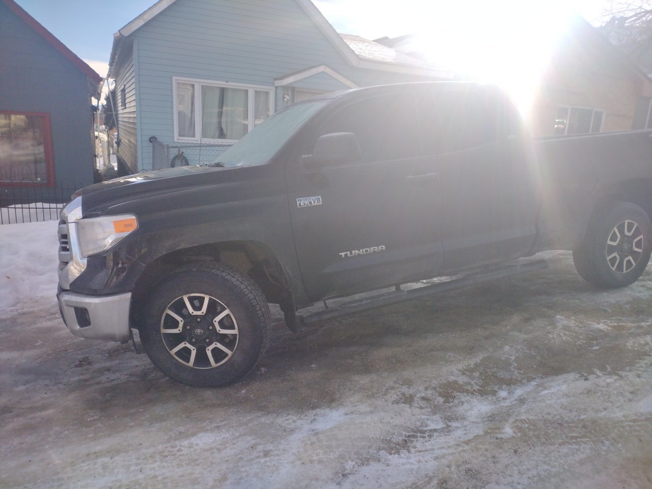

    IMG_20220123_102750276.jpg IMG_20220123_102800375.jpg IMG_20220123_102813776.jpg IMG_20220123_102820391.jpg IMG_20220123_102831036.jpg
    the second to last is the bent mount on the rails, passenger side is worse

    Ok. You have the TRD Offroad wheels. And yes you also have the TRD Offroad Shocks which are Bilsteins but they’re nothing special. If I were in your shoes, I’d just get some Bilstein 5100’s with 2” lift, throw some 295/70/18 tires on your stock wheels, and get a set of sliders. Should be just a little bit over your budget. Then later down the road, upgrade your suspension if you feel you need more.

    Maybe some minor trimming on the plastic and might need to remove your mudflaps but no CMC. This is probably the cheapest way to achieve what it sounds like you need. As a matter of fact, this is the first time Bilstein 5100’s has ever come out of my mouth. Normally I would suggest getting a higher quality suspension but just not possible with a 2-3k budget.
    My thinking is, you need to get bigger tires and get those steps off your truck. They’re hanging too low to be offroad. You can simply remove them but if you’re on terrain that’s hitting them, you’ll eventually get some body damage. Sliders are expensive but they also serve as a step and that one time it prevents body damage, they’ve already paid for themselves.
