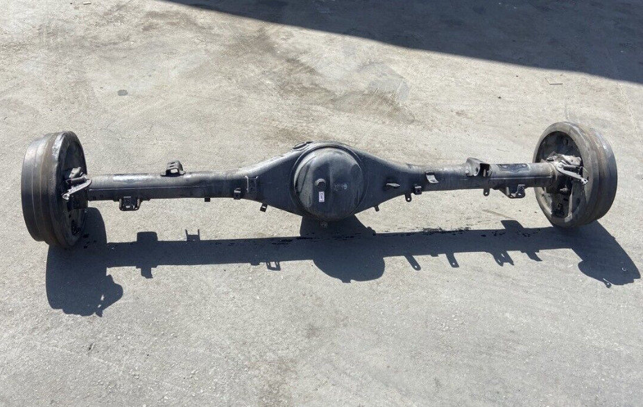

    Well damn lol. I found a really clean So Cal complete rear diff/axle/brakes for $900 shipped, but its from a 2WD 05 DC with LSD. It was the cheapest one I found. Lots of salvage yards wanted that just for the housing. I found many others much more expensive and in much worse condition. I was hoping to direct swap it but if the ratio is different then I'll just have to use my 3rd member. I wonder if I can swap the LSD into my 3rd member because mine is at 272k miles and this one looks to have much less mileage. I will run the VIN in carfax to be sure.

    '05 SR5 AC 2wd
    Most usually round up.
    3.909 = 3.91
    3.916 = 3.92

  8. Oct 1, 2023 at 10:54 AM
    #158
    assassin10000
    assassin10000 New Member
    Oct 27, 2020
    #54157
    2,291
    Andrew
    Northern CA
    '05 SR5 AC 2wd
    Close. But not exact. Not something you'd want to run on the street in 4x4. The gear tooth count is different as well.
    47 & 12 teeth
    43 & 11 teeth
    Sand, snow, mud it'd be fine. Rocks, asphalt, etc it wouldn't. Just swap the centers/3rd member. Pinion flange may also be different (due to driveshaft bolt pattern), I never checked the 2wd vs 4wd DC ones.

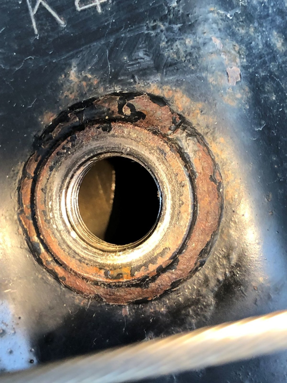

    Apologies in advance for those who know this newbie LSD identification question. Trying to determine if my 2001 SR5 Access has a LSD or not
    The rear differential does not have the red LSD sticker.
    • Housing is stamped K4 (Have not read a thread mentioning stampings)
    • Toyota VIN build does not include LSD
    • Mine has a Toyota hitch and electrical connections.
    • Been told by a local 2001 owner the LSD option started in 2002?
    Most importantly a good picture
    I changed the oil with Lucas 80W-90. About 3.25 quarts drained out and torqued drain bolt to 39 Ft Lbs.
    Thanks
  20. Nov 6, 2023 at 9:32 AM
    #170
    assassin10000
    Oct 27, 2020
    #54157
    2,291
    Andrew
    Northern CA
    '05 SR5 AC 2wd
    Need a better picture.
    Focus on what's inside and move the camera/light source slightly to the left.

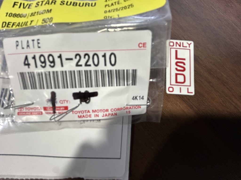

    For vanity, your genuine OEM part number is 41991-22010. You’re welcome :cool:
