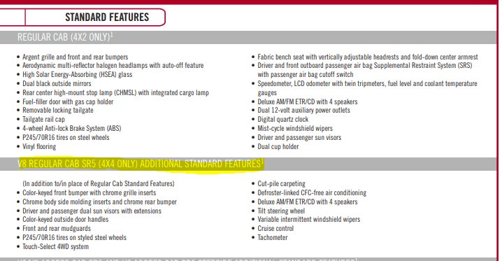

    Here's an 03 brochure, look at page 3, the V-8, regular cab, SR5 4x4. That's what I have. It has that limited slip. The on-line VIN check doesn't list it for my truck, but it has it.

    No, it was an option, not standard on the SR5.
    I think you are mis-reading the brochure....it says it was an option for V-8, regular cab 4x4s, not standard...essentially it's saying if you buy an SR5, then you can get the limited-slip differential as an option, it doesn't mean it's standard equipment.
    Page 2 shows the standard features for your truck and there is no mention of a limited-slip differential...
    Source: http://www.russauto.com/ncinv/modelinfo/brochures/03tundra.pdf

    Re-reading that a few more times, I think you're right.
