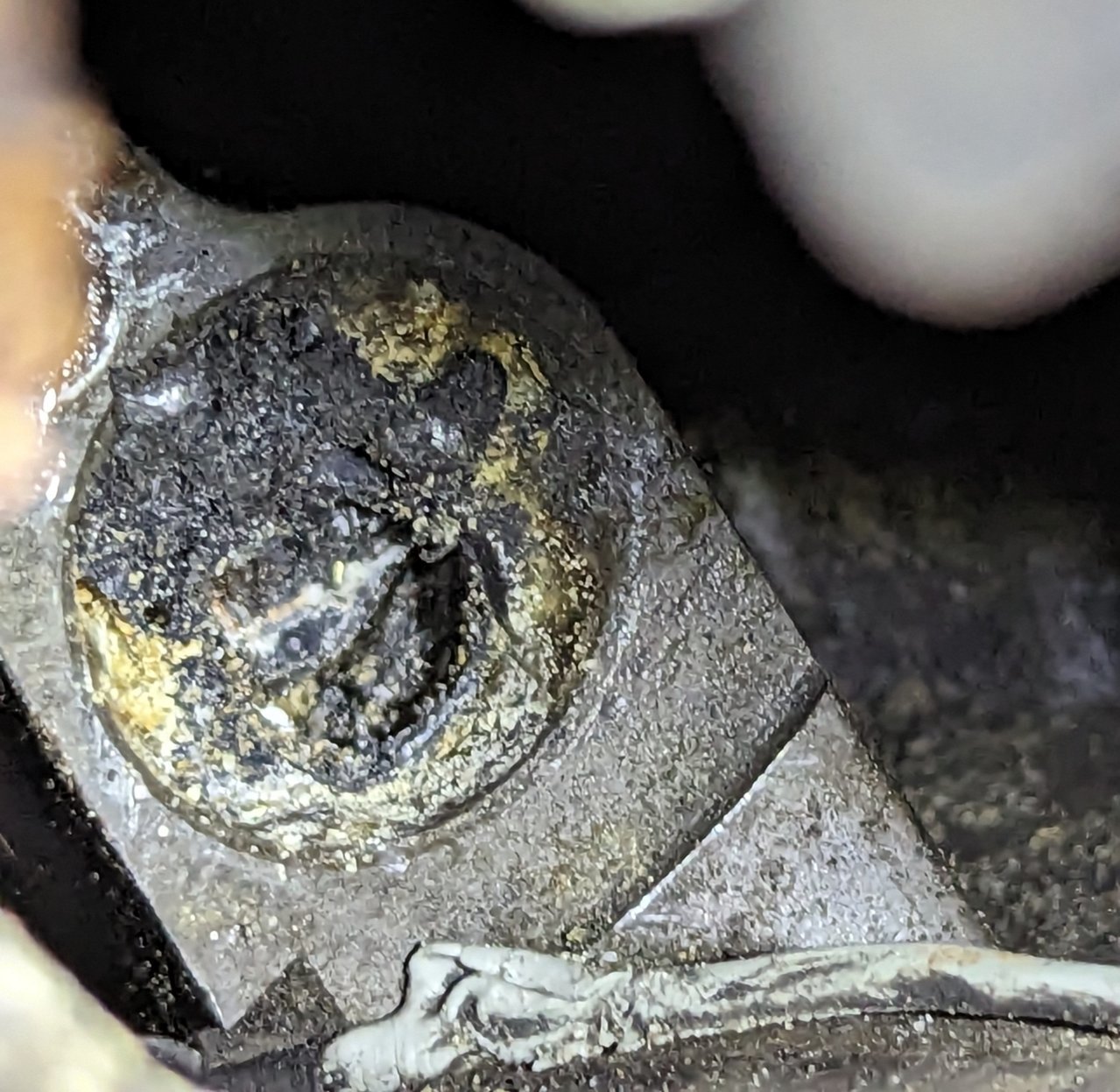

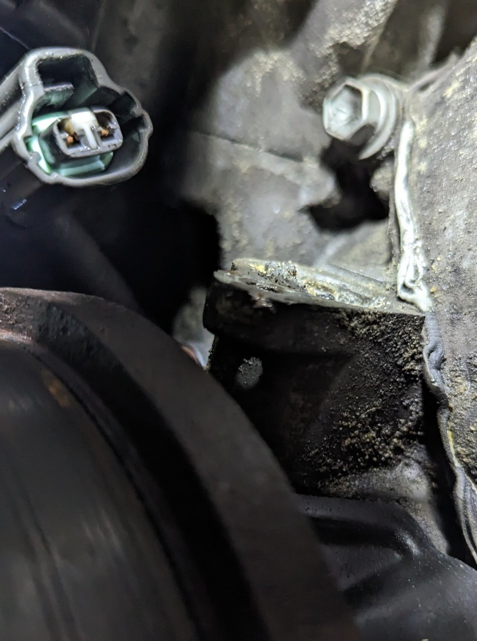

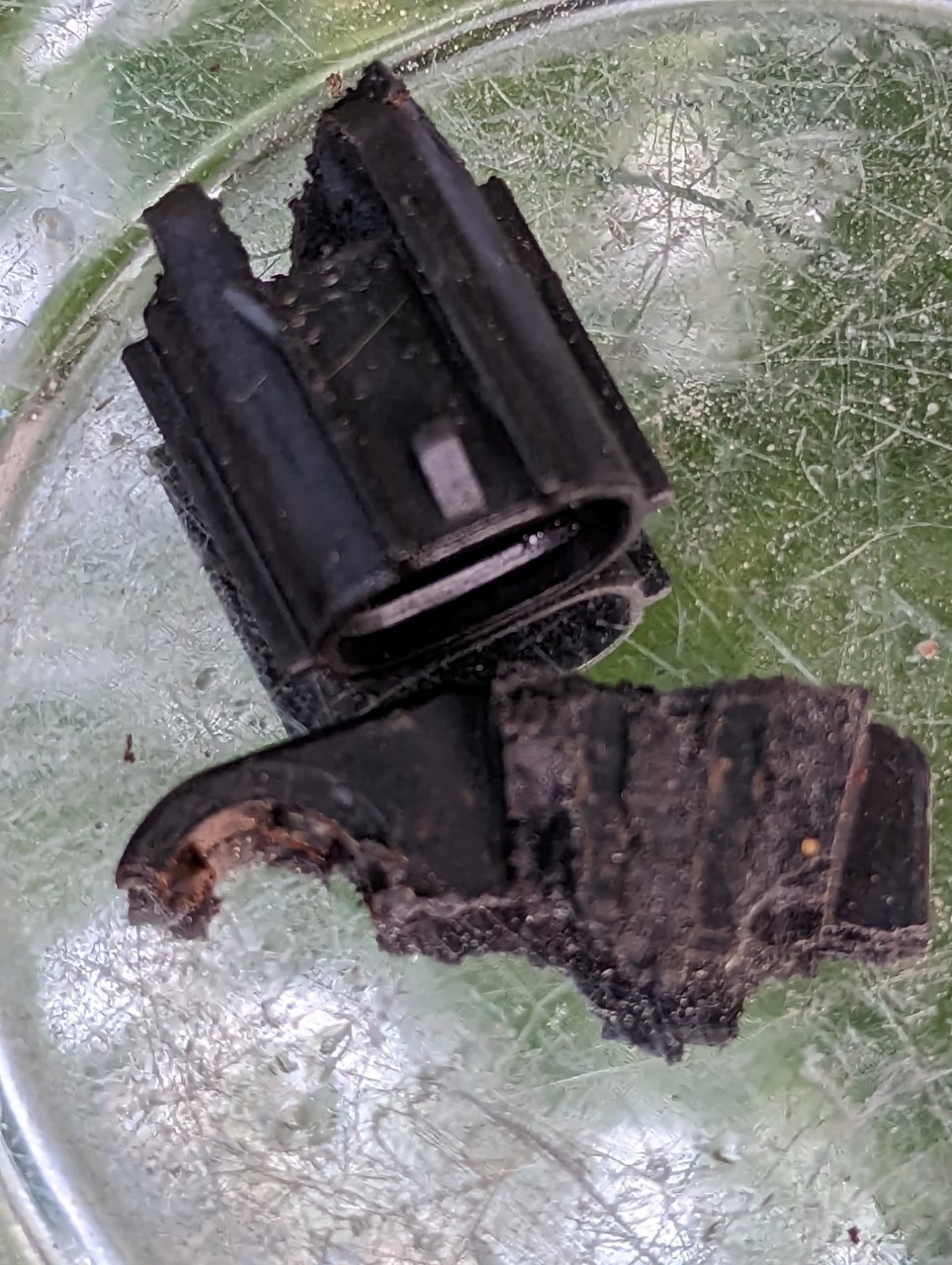

    Went to replace crankshaft position sensor and it snapped in my hand as I was removing the wiring connection .
    I grabbed bits of it with pliers and chipped away at it with a screwdriver hoping that at some point the rest would come out.
    I'm literally digging a hole and feel like I'm now in a pretty bad situation.
    PXL_20230511_234146497.jpgPXL_20230511_234225062.jpg PXL_20230511_234248941.MP.jpg
    Any advice? How much of the truck do I have to disassemble to get at this thing?

    Dammmn! Man, that sux. I’d probably be tempted to use a left handed drill bit.

    This is what I'd probably try doing too ...
    Although I'd also be tempted to tap a wide flathead in there too, just 1/16" or so, and see if I could spin it out. That thing is toast!

    Thanks for the fast advice! I tapped a flathead in there (deeper than 1/16), it just turns chunks out.
    I'll try some reverse bits tomorrow. How worried should I be about going too deep, causing other damage?

    Be aware I'm also assuming this sensor partially unscrews by twisting it counterclockwise when using a left handed drill bit.
    If ours are the type that just pops out, it might be a better idea to do what others I read about have done and that's drilling a hole, using a large self-tapping concrete/masonary screw and yanking it out with pliers.
    Looks like 1A auto made such a video and did that same thing but used something like a slide hammer to pull it out.

    I’m pretty sure that style just pulls out no turning. Look up the part on rock auto and make sure it doesn’t have threads. If it doesn’t I think I’d screw into it like the advice above.
    That style sensor usually has a o ring that gets stuck with age. You’re probably fighting that.

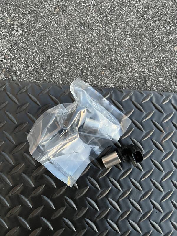

    I replaced mine last week, it just slides out. No threads. Just one bolt holding it in. Just like the ignition coil packs.

    Point of screwing is to ensure it's free in the boss. Then reverse-thread to pull up and out, or sink a fastener as another mentioned.

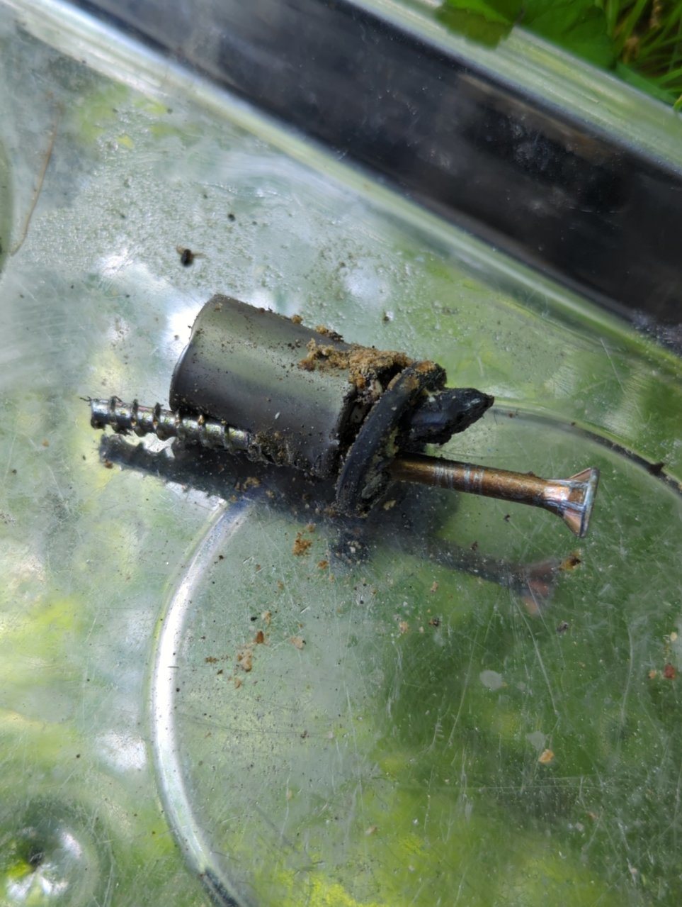

    Is the metal lining show in @jerryallday's pic still stuck in there? Looks like most of it is out.

    Uh oh. Where'd the tip of the fastener go?

    I did not mean to run the screw that deep.

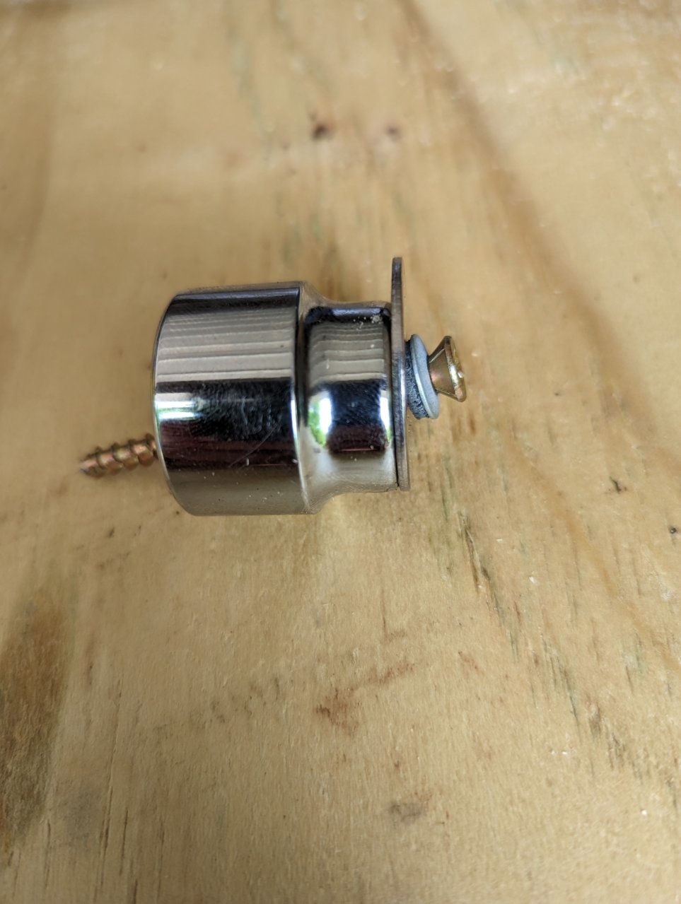

    I tried to make a puller using a large socket and a series of washers PXL_20230512_160838363.jpg. I did not notice that the screw had slipped the washer. It felt like it was pulling out, when it was actually just going deeper.
    Ironically I had clipped the screw because it was too long.
    With the screw in the sensor, it still wouldn't pry out. I used a small flat head and a hammer to chisel away at the plastic. It eventually came loose enough to pull out.
    Fortunately, there's a bit of room for error in there. I think the fact that the screw went through at an angle (unintentionally) saved me.

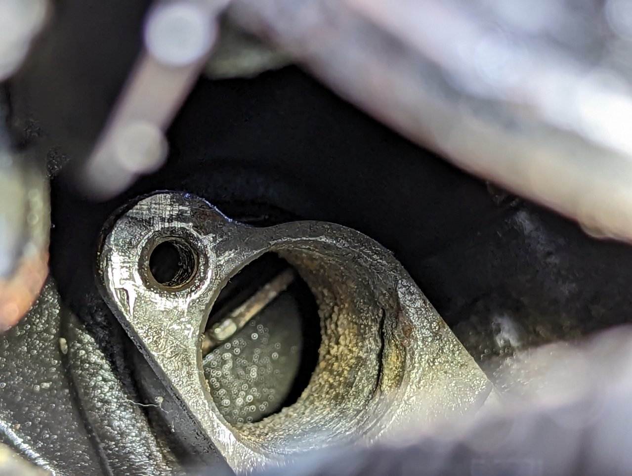

    There's not a lot of room to work, but a long extension will allow you to run a drill bit and a a torx just past the oil filter.
    The new sensor wouldn't fit until I sanded the corrosion in the fitting. A 1/2 dowel and some 220 grit worked well. I wrapped the end of the dowel with sandpaper ran it with a drill (also routed past the oil filter).
    Cleaned it all out with some brake cleaner on a rag, buttoned it up and it's good to go!
