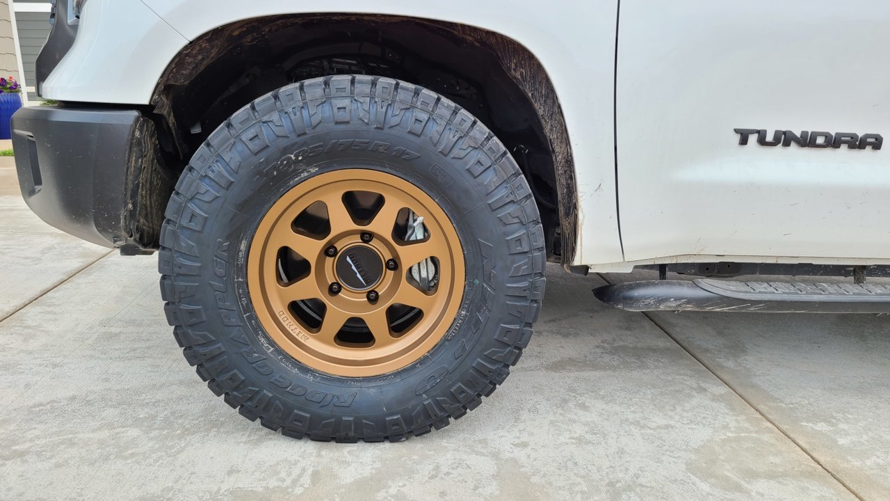

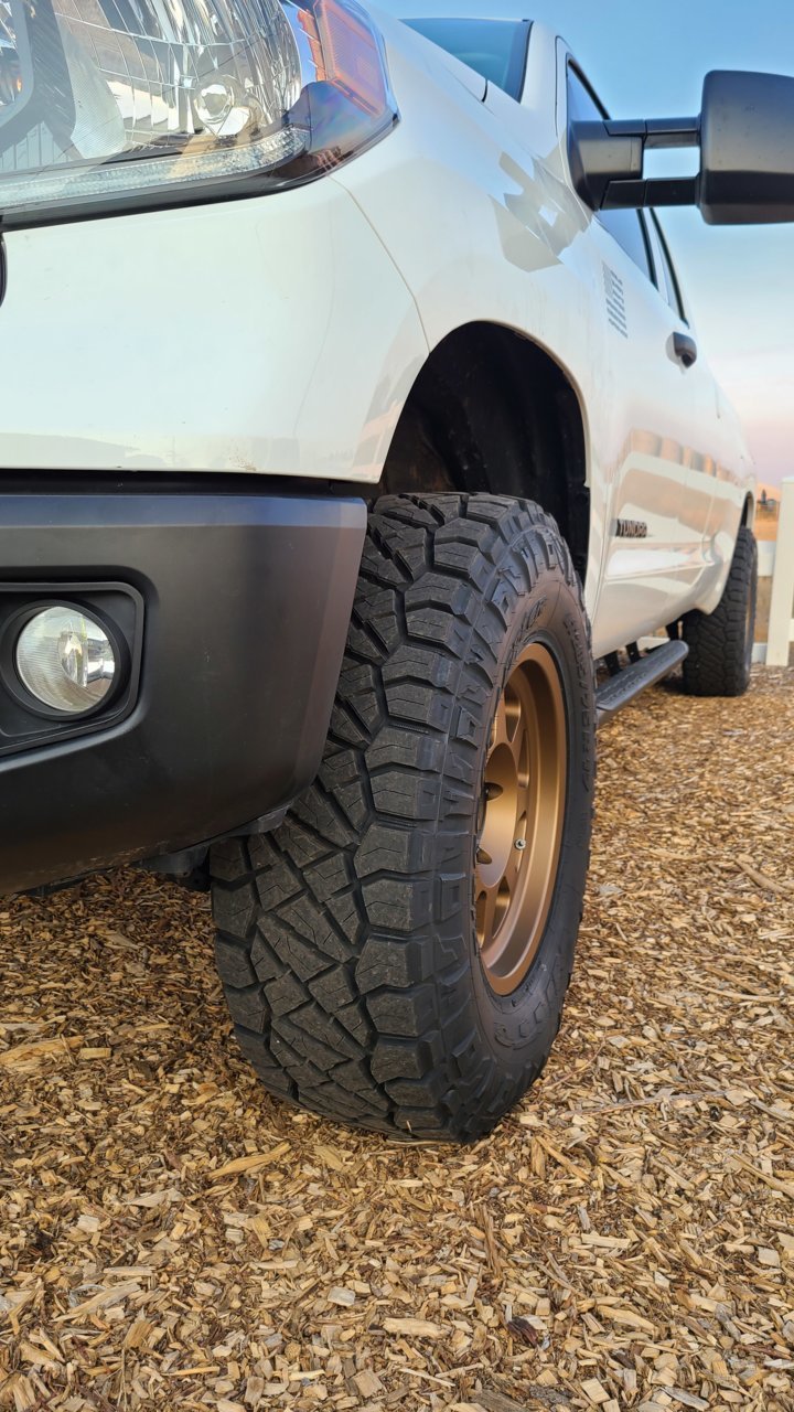

    Zero One Actual =
    That’s actually the direction I took.
    Really happy with result
