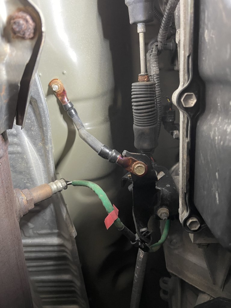

    But a chew can worth of solder has to be worth something! :monocle: that's a great crimp tool! A couple bops with a sledge and she's stuck for good!!

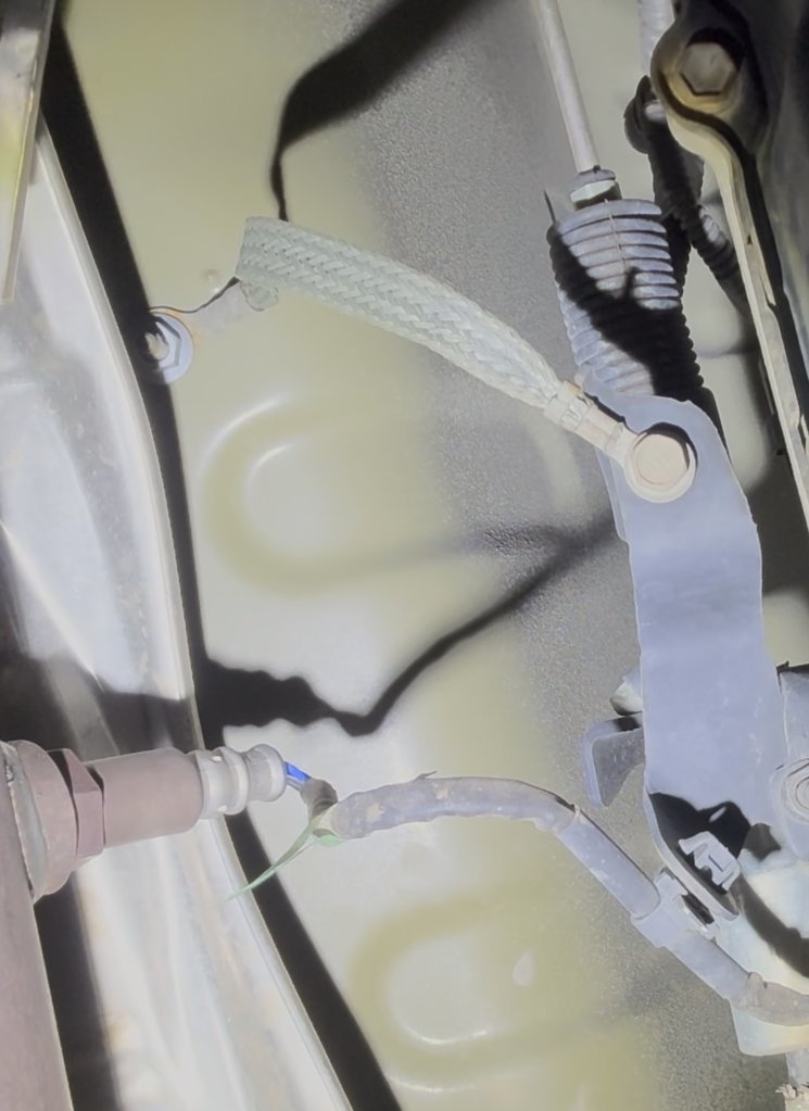

    Late to the party w this post but wanted to know if anyone can tell me how long this cable is and also what the process is to swap. Like what tools and size wrenches, sockets? I have a bad knee and back and it’s very hard to get under truck at the moment. Plan on being totally ready to do it one time if possible. Thanks!

    Use a 10mm socket and an extension and undo it and reapply...10 min of work...you got this!

    Thanks! Any thoughts on what gauge cable to use? I think 2 would be too thick

    2-gauge would be great to use but I bet you could get away with 4-gauge, no problem

    That’s what I was thinking. When I did my battery to fender I used 2 and while it seems fine, I think it would be overkill. But hey that’s what we do!
    My strap isn’t even bad for it being a 2016 but I’m putting in leds headlights ,fogs, turn and markers, I thought I might as well tackle other things while I have parts off.

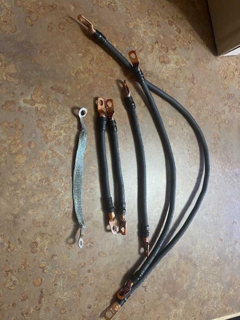

    I used 4 gauge on mine. Made my own.

    I've made my own cables (for other projects) using that exact crimper. Works really great on the cable lugs.
    4 gauge might be the smallest you can get away with using the big copper crimp lugs with.
    6 gauge would be more than adequate for a ground strap but nothing wrong with a little overkill.
