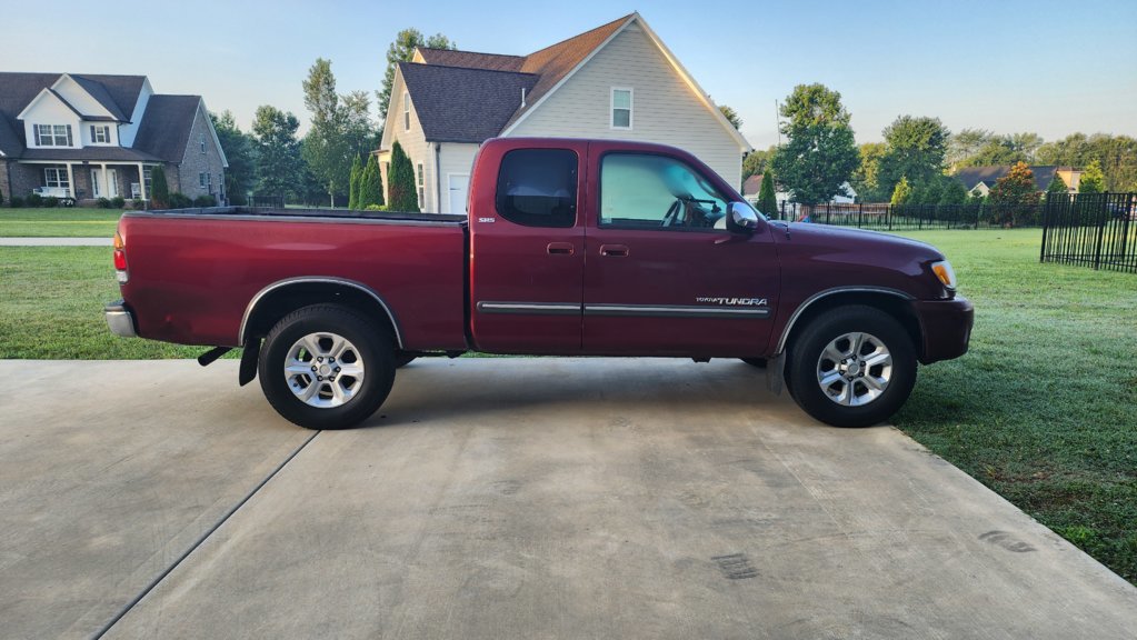

    20250715_061910.jpg265/70-17 for me on my stock 2wd. I really love the look of these which only have 1/4 tread left and can't wait to get something more aggrezzive looking on there. So far, I prefer the Tundras without the fender flares better. With these tires and rims, they are fully flush with the fender well and I can see why everyone uses greater offsets and spacers on the trucks with the flares to move the tires out further.
    On a side note, saw a DC truck same color as mine without flares on my way to work today. Looked good too.

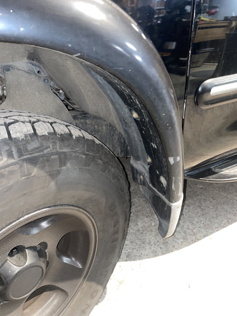

    posting to this thread because it's linked to @shifty`s sticky and it might help someone else. This is my current setup with a 2" lift, 8 inch wheels with 4.5 backspace and 265/75/16's. If I go for a 17 inch wheel with 4.28 backspace is this the spot where I'm most likely to rub? Right now I have about an inch of clearance so am I right in thinking I can only increase in total diameter up to an inch? or would that be up to 2 inches before rubbing?

    I think you're failing to realize a couple of concepts.
    Higher positive backspace puts your wheel farther into the wheel well. So at 4.28 you're pushing the wheel toward poking out of the well more.
    Wheel width does play a role in backspace, so that info you left out is important to know. 4.28 backspace on a 7.5" wheel, I'd expect no rub at all. 4.28 backspace on a 10" wide wheel, I'm guessing you'd grab the pinch weld, regardless, the width is killing you in this case.
    I can already see you're grabbing pinch weld, at least the flap. Almost everyone rubs there, removing the front mud flaps is most people's solutions. I did make a separate thread on how you can cut the flap to compensate. It's in the community info sticky. (not "shiftys sticky", that's everyone's effort, I just posted the first draft)

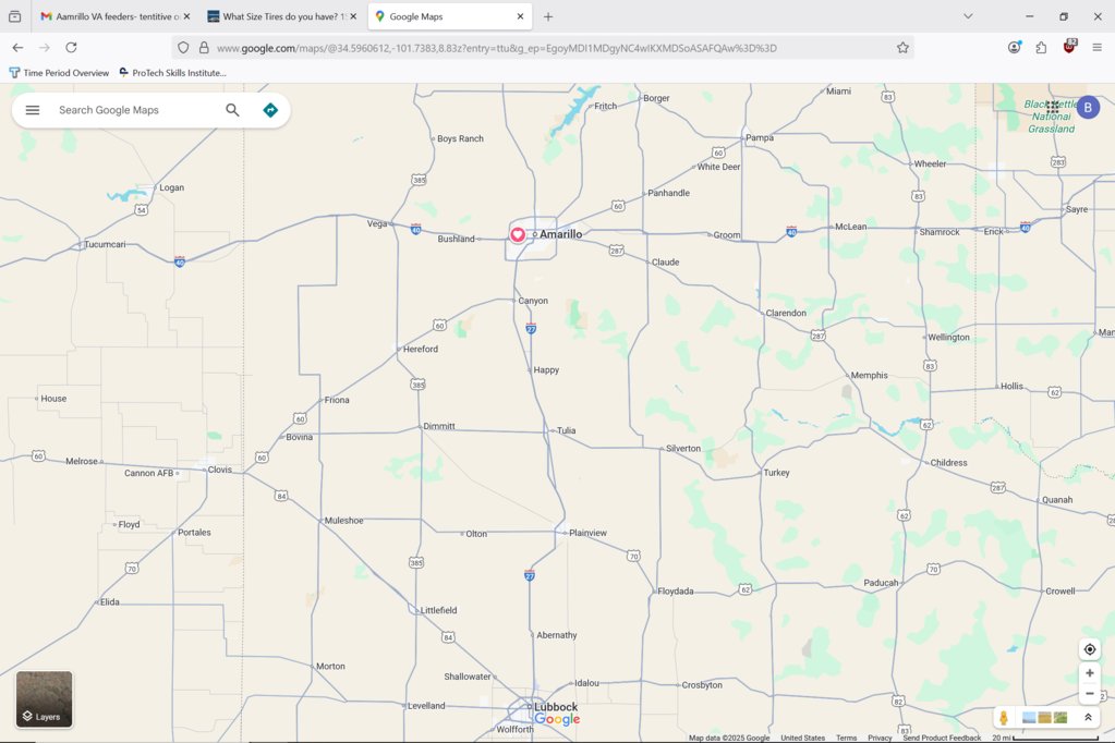

    Now see, you're thinking city life again. I'm talking (semi)country life. If I head NE to Borger, it's 45 minutes away of country driving. ENE to Pampa is country driving same if you head SW to Hereford. Lubbock is more or less 100 miles away down I-27(the 27), so it's roughly 90 minutes to get there.
