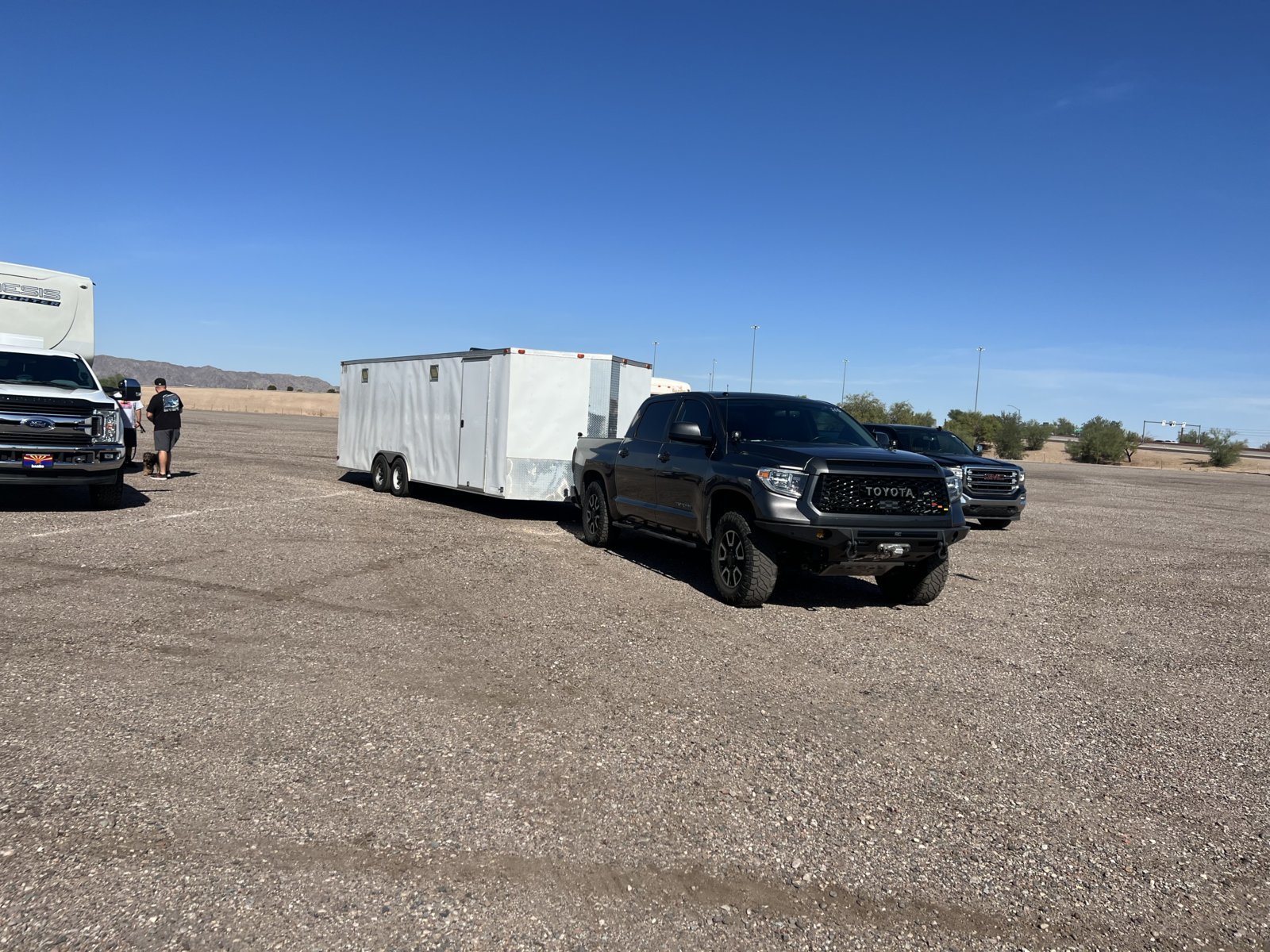

    There are a lot of uneducated guesses in there - I’m not sure where to start so I won’t. Glad you like your ford. I had to help one out this weekend.
    I do a little towing myself… somehow with bigger tires and stock rear end and only using 5 gears in the trans. Weird.
    GODZILLA likes this.
