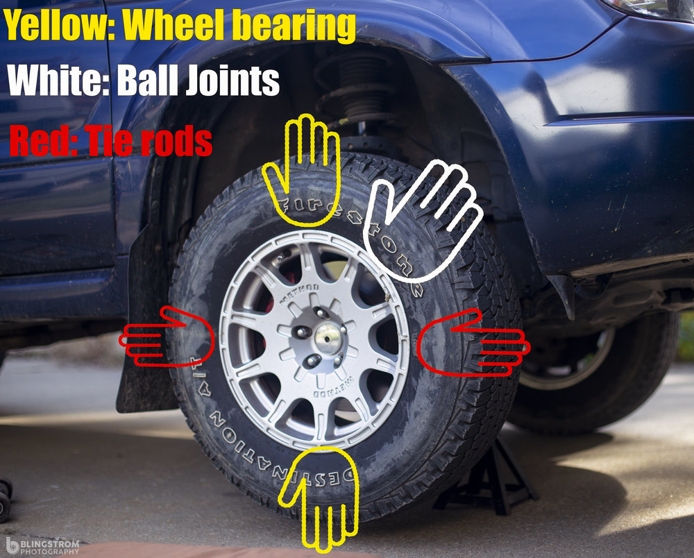

    jack the front wheels up see if they roll freely, then drive around for a few miles being heavier on the brakes than normal to get em up to temp, then jack the front up and see if they still roll freely.
    My fix gave me a hammer, so every similar issue looks like a nail.
    while its jacked up, give it the wiggle test.

    It’s not a wheel bearing. First I’d guess TRE’s, then Ball Joints, then Rack. Only if you ruled out tire balance. I’d still demand a road force balance before tearing it apart.
    At 245k my entire front end was worn out, and I mean everything. 4K in dealer parts and I replaced everything myself.
