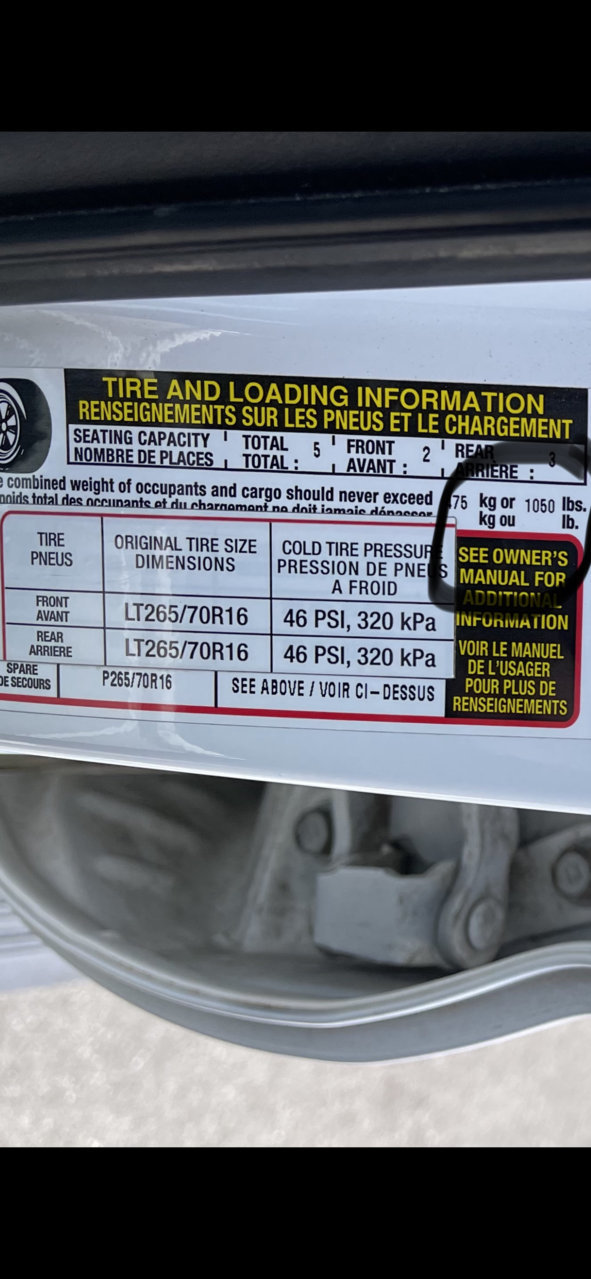

    Dansly56
    Dansly56 [OP] New Member
    Mar 5, 2021
    #60020
    202
    daniel
    That’s what I think I will do today and tomorrow

    Dansly56
    Mar 5, 2021
    #60020
    202
    daniel
    going with a DC will feel like my Tacoma back there for my kids so I’d rather get the CM

    I'm saying that towing with the Tundra vs. the Taco will be a much better experience at equivalent payloads.

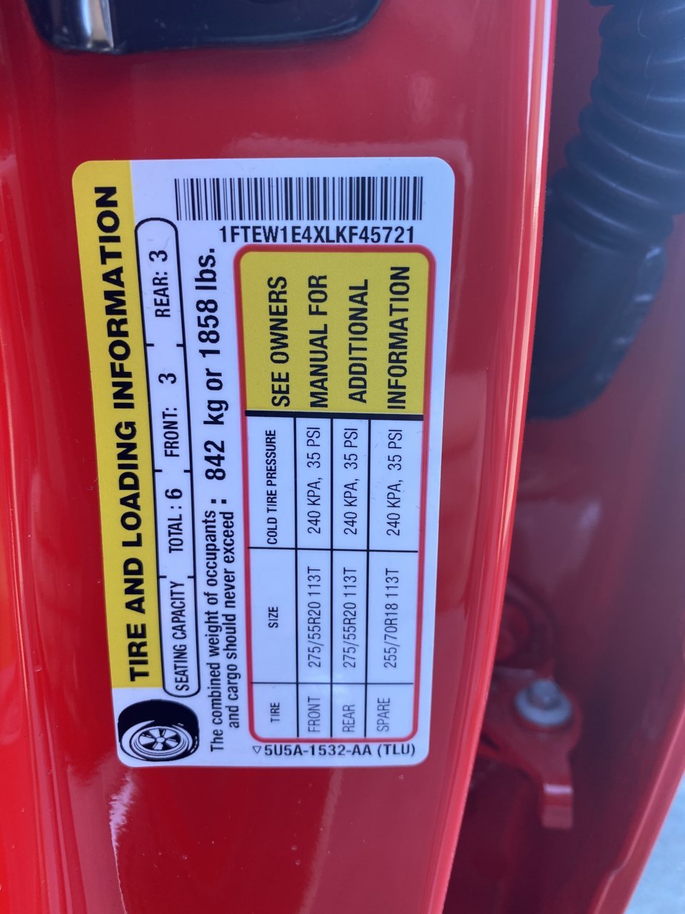

    shoe07
    shoe07 New Member
    Jan 14, 2021
    #57588
    312
    Ohio
    2004 Tundra Double-cab SR5 Tow pkg
    Here’s a door jamb sticker from an f150 my bil looked at last week. It did not have max payload or max trailering package. He went in looking for a 250, and the sales guys at two dealerships tried to put him in a 150.
    he’s trying to haul 2600 lbs of payload with their trailer, family and gear.
