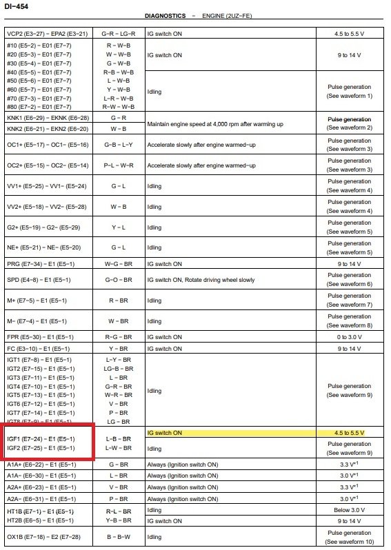

    That’s exactly what I did. 5 volts on pin 2 of good cylinder 0 volts on bad. I checked pin 24 of e7 0 volts. You think bad ecm

    Well, if it was me and I had 5vdc coming out of ECU at pin 25 and 5vdc at pin 2 of a good coil and I had 0vdc at pin 24 of ECU and pin 2 of bad coil, my Monday would suck and I’d get drunk amd I don’t drink no mo.
    Don’t take my word for it but I don’t like what you’re finding for your situation.
    If there was a way to apply 5vdc to pin 2 safely to a bad coil, reset codes and see if that related code goes away, that would be one way to tell. I’m not a Toyota Master tech but I’d be trying something troubleshooting wise before condeming an ECU :(

    My reasoning for suggesting 5vdc check of ECU pin 24/25 was it was a Diagnostic check for IGF 1/2 as shown below. Assuming there was to be 5vdc at those points, I assumed there then should be 5vdc at pin 2 of each coil. When I checked all of mine using their criteria, I indeed saw 5vdc @ ECU pin 24/25 and pin 2 pf each coil with IGN On/ENG off. Assuming gets us in trouble but I simply took them literally without thinking too deeply....for me the KISS theory. As I mentioned above earlier, I ain't a Toyota Master Tech and hope my info is taken with a grain of thought. An opinion/troubleshooting by a trained tech takes precedent over my thoughts any day, twice on Sunday.
