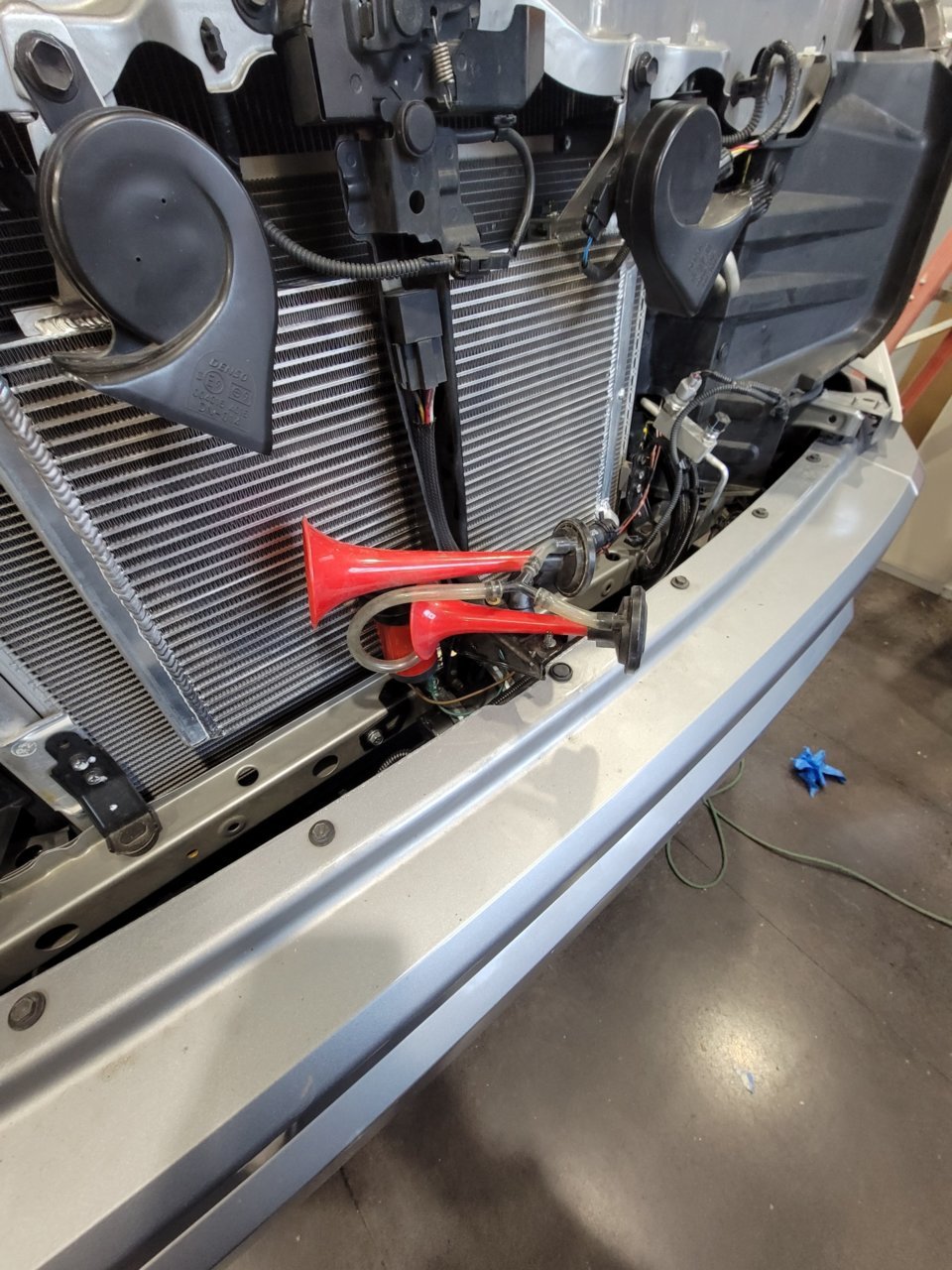

    Damn. I thought inflation was making everything go up! I paid twice that for those horns in 2016 lol Thanks for finding them and sharing the link! For that price they can't be beat. I left my factory horns running with them for a really unique and attention-grabbing sound. The relay fits perfectly in the upright brace right under the hood latch. I used a sheet metal screw, then ground off the back of it when I put my intercooler in (the IC wouldn't fit behind the screw).

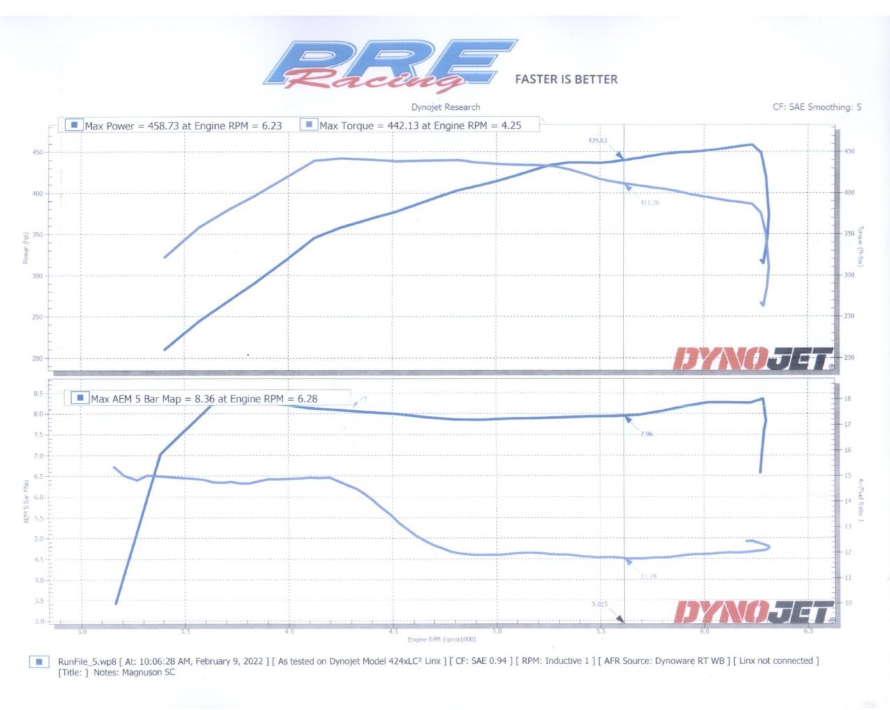

    Just giving ya a hard time! Thanks to you I got the horns installed and oil separator on the bench.

    Awesome to see you finally got the charger all setup and dynoed! Definitely a healthy increase.
    I will recommend if you haven't already, ride in your passenger seat and have someone else drive (if you're that trusting person type). I've ridden in the passenger seat in my truck once, and I was really surprised by how much louder the 10" seemed vs. the drivers seat, I was pumped lol.

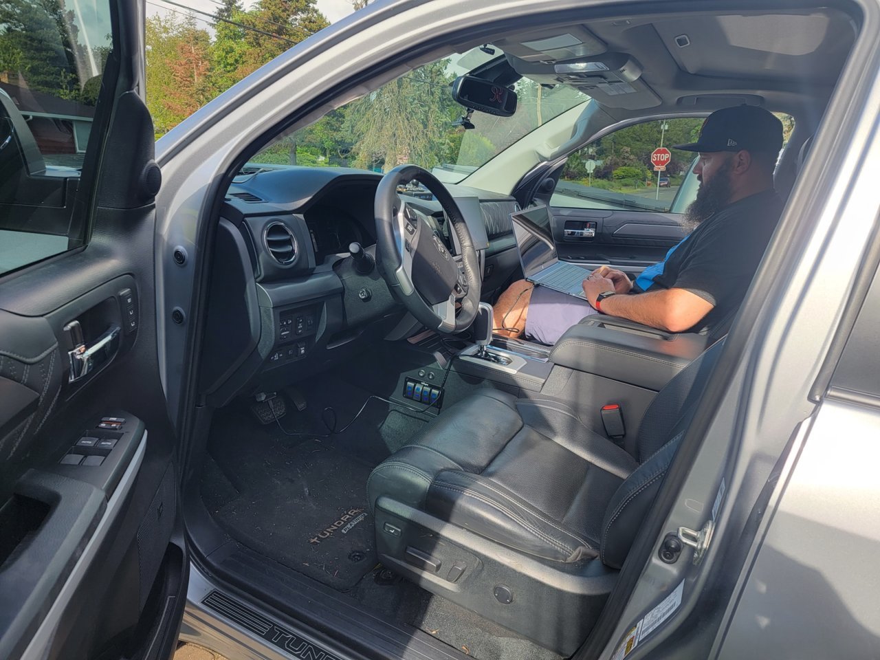

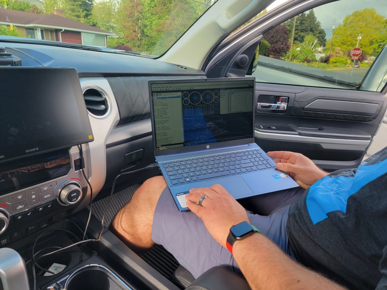

    One of the big disappointments after driving with the Magnuson S/C for about 800 miles is how unresponsive and sluggish it seemed under normal driving conditions. Sure, it was faster if I WOT'd it but the truck wasn't a lot of fun to drive under less-than WOT conditions.
    Enter Cole Hershberger with HP Tuners. This guy spent four hours at my house yesterday tuning and re-tuning my truck. This was HPT's first 21 S/C'd Tundra. What really impressed me was the dedication to getting it right. First thing he did was take a log run on the existing tune to see where we were starting from. I was very shocked to find that not only was I running a little lean but I was also knocking. I couldn't hear it audibly, but twice during my 800 miles I have had a cylinder # 8 misfire. I thought it was probably just me doing something stupid like getting my spark plug gap wrong. Nope, turns out it was the tune triggering the knock sensor and sending it into limp-home.
    Over the course of four hours Cole remapped my ECU/TCU 8 times and logged about 15 miles of data. The preliminary result is a phenomenally different truck. He told me up front that his goal was to have the truck living in its boost zone, and he kept his word. It holds the right gear longer and downshifts at just enough higher RPM to really count. It's faster, far more responsive, and running so much better I can actually hear a difference in the exhaust note.
    The current plan is I am going to put a couple hundred miles on it this week to help it un-learn its bad habits from the previous tune (once you wipe an ECU, it takes a few drive cycles for all systems to reach readiness under the new tune). Once that's done, Cole wants to come log it one more time and possibly make additional tweaks. Then, lastly I have a dyno appt set up on 5/31 that he's going to come to with me as well in case there are any additional changes that we can make to improve the powerband. I'm already loving it so much more than I did before that it's honestly hard to imagine it might still get even a little better!
    My new best friend lol: Cole Hershberger
