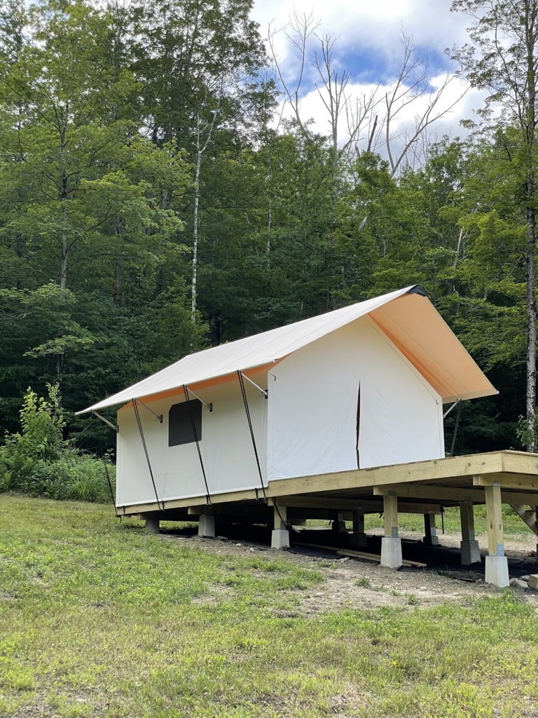

    got the rain fly on this morning, door is framed so will maybe try to get that in place tomorrow and be done with the construction and let the wife take over making it look pretty. I got it on myself, had the wife come up to help me get the bars situated, and she noticed it was backwards. Okay, well keeping it up there and turning it 180 worked surprisingly well! Then as we were strapping it down, one side blew completely over and we had to redo the whole thing:mad: Mowed the field with my lawn mower, just switched to G5 gator blades last week (worried the mower can't spin the G6 in tough stuff) and I was shocked, I didn't even fully double cut and you can see in the photo it took field grass to a lawn without much left behind.

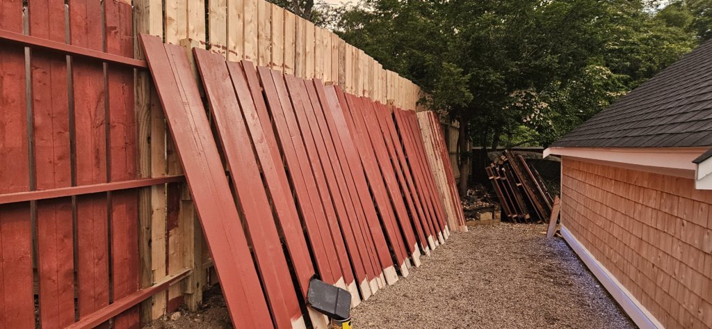

    Got the neighbors front portion all stained, need to snap a line for the back cut those down and stained, now I need to get another 120 1x8x8.
    This time I'm going to stain them first and front side 2 coats then put them up.What a pain in arse to stain it while it’s up.

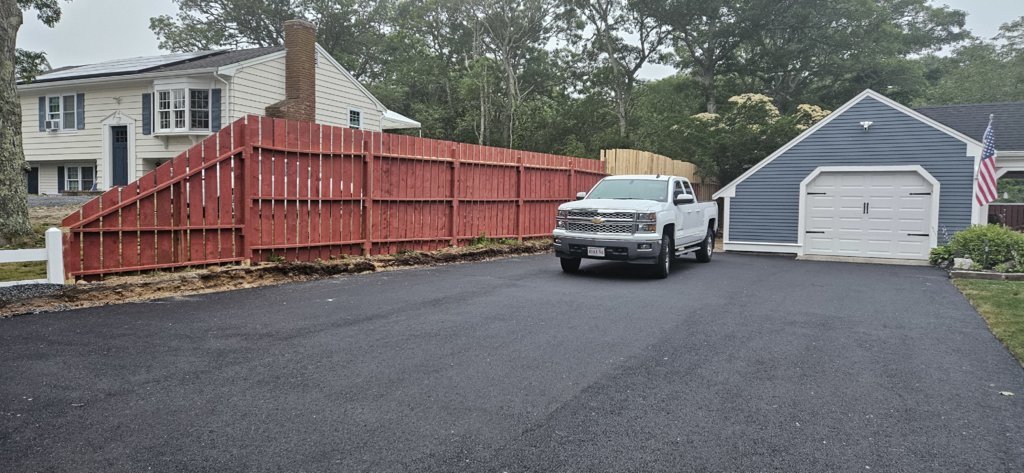

    Well the driveway is complete

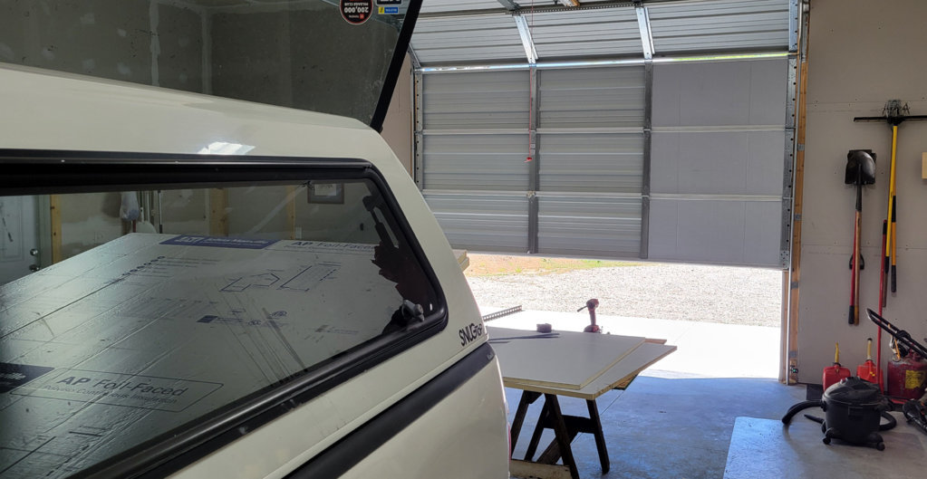

    Just picked up 4 sheets of 1" foam insulation board for my garage door. I have in my mind how it's all going g to tuck into the aluminum panels.... but thats just a dream right now lol. Got some sheathing tape to hold it in when that doesn't work.
    Any advice boys?

    I did the same as you and to ensure it to stay in place I used 2 sheets of 1/4" luan with 5/16" tech screws works like a charm.

    Luan, plan C. :thumbsup:
    The space already stays 15... then about 10 degrees below outside temp when it's getting hot. This is more for this winter when I'm heating the space with the pellet stove.

    Yeah man,as you know it's void free and for 1/4" pretty damn ridged,I don't have a heat source for the garage which would be great but I did it for long term and like the look of the wood verse pink foam board.

    Yeah I opted for the foil faced r6, and it has a white back. :thumbsup: Long term durability of that unknown, but I can make a prediction :rofl:

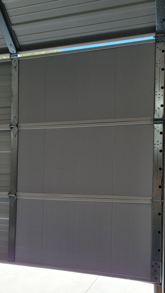

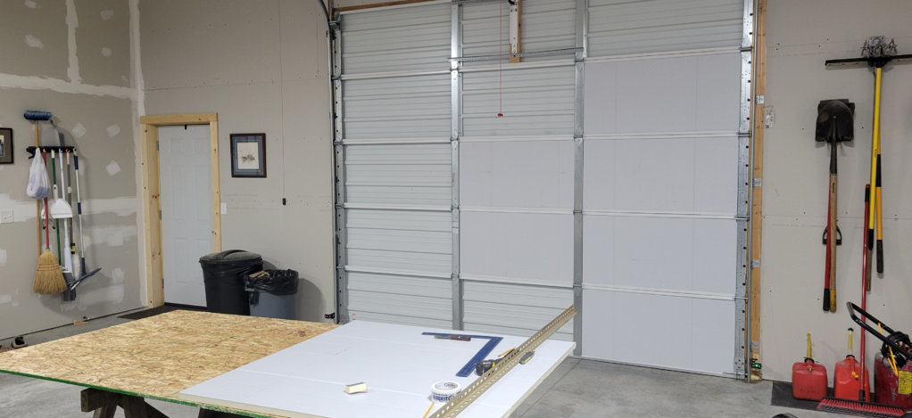

    Really pleased with how this turned out, nice and clean looking.
    Had zero casualties (pieces snap) while horsing them around to get them in there. :thumbsup:
    Holding off on taping them in as they fit pretty snug as is.
    It's it's quieter in here now too. $80, not bad.
    I lined up the factory wrinkles these sheets have in them... is that compulsive? lol
    The last piece on the top center/right I put in with the seam miss aligned. See, I don't have a problem. o_O:rofl:
