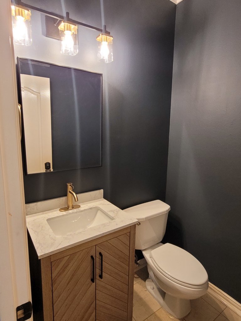

    Half bath refresh. Painted walls new color, replaced pedastool style sink, with vanity/sink/faucet, new light fixture, mirror. Not shown; new hand towel ring, T.P. holder, switch & plug plates.
    Didn't really bargain for any home improvements when the wife asked me to take off with her on her Spring Break. LOL

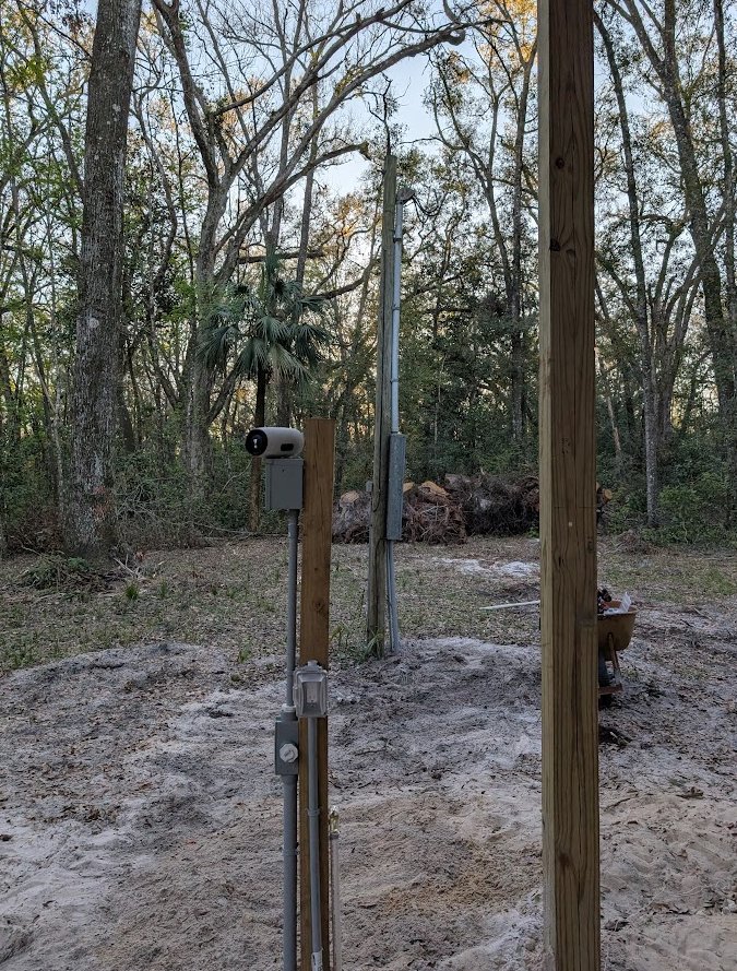

    tonight I finished the wiring and backfilling the trench... time to call for the inspection... fingers crossed my back country ass got this right

    Electrical inspection?

    yes sir... permit filed for reconnect.... so lets see how it goes...

    Make sure your conduits are strapped within 3' of any box or panel. (Can't tell under your main panel)
    Those white water fittings won't fly with the inspector. No-go there

    well shit... I backed off the strapping because it pushed the box to tight against the wood... So I will try to solve for that before calling...
    I used white because I couldnt source the grey before installing... PITA in a small town

    Yeah.. sorry man
    Hope the bad news helps you in the long run, the inspection trip fees can add up if you get correction after correction.

    Hit that PVC with a heat gun (don’t go crazy) enough to soften it and shape a gradual kick into it so it doesn’t pull the box hard

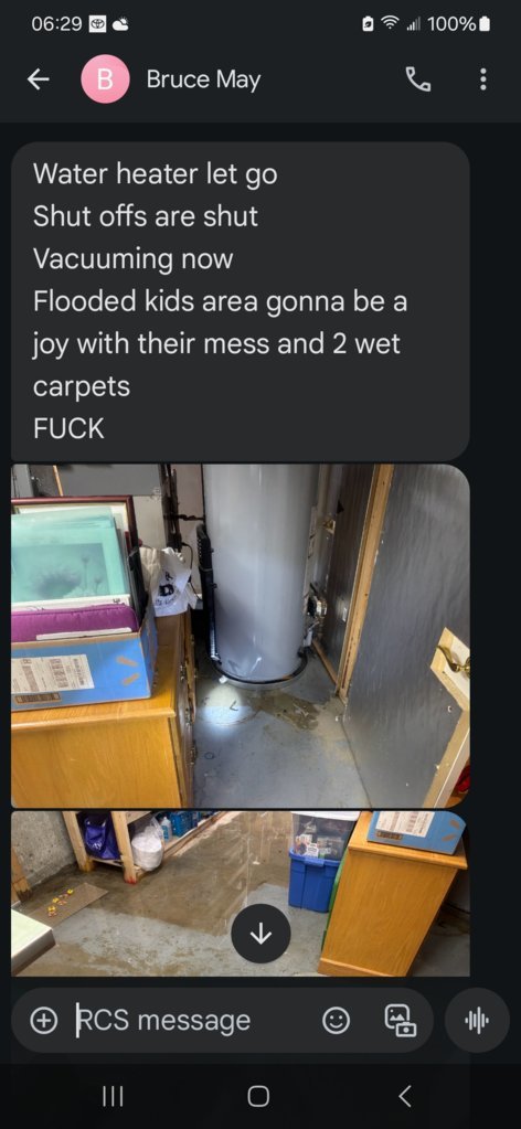

    Now this morning another Buddy texted me at 0604 that his hot water heater let go at some point last night.WTF!
    I'm now at Homies waiting for someone to pick this 50 gallon power vent so I can get this done,so I can go home and do stuff I need for myself :facepalm:

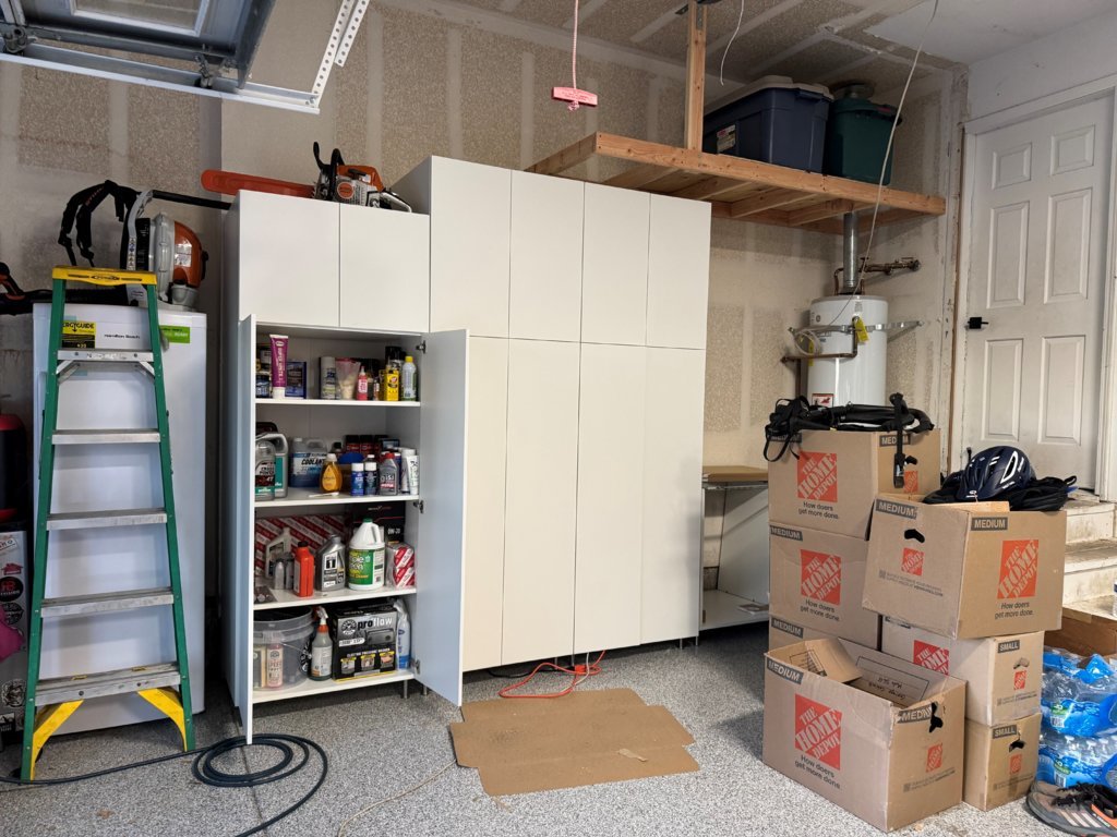

    I made a little more progress on the massive undertaking of garage organization at the new house. I've installed several cabinets and now working on the suspended overhead storage shelf.
