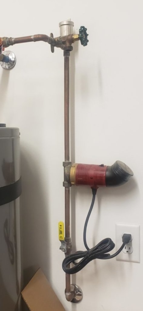

    Turns out there was a little junk in the impeller i didn't see before. Also, the housing where the impeller spins was not smooth. I don't know if it was from the casting or cavitation.
    Either way, I took 2000 grit sandpaper to the housing.
    Reassembled everything, turned the water on, purged air and she's back! Almost instant hot water at every fixture :D

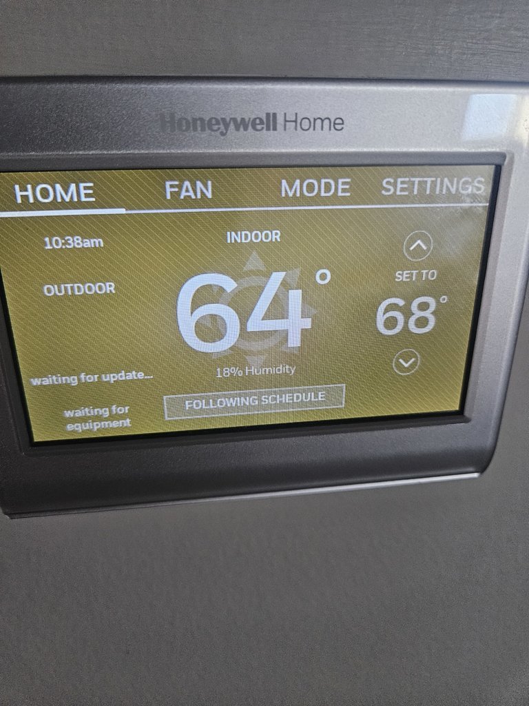

    Couple days ago 0F outside, heat pump dies again. Thermostat stuck at "waiting for equipment" and house getting cold. Amateur hour youtube troubleshot up and down again - eventually learning that anytime there is a call for any heat/air/defrost anything from outdoor unit, it blows the 3 amp fuse. Also "waiting for equipment" on honeywell means the power has just gone out and it's protection the compressor from turning on again too soon. AHA! Gotta be a 24v wiring issue. Found the yellow fan wire from air handler to outdoor unit is shorted to ground somewhere. Swapped to a different unused wire in the bundle and it fired up again like nothing ever happened. I think I can close this one now. knock on wood.

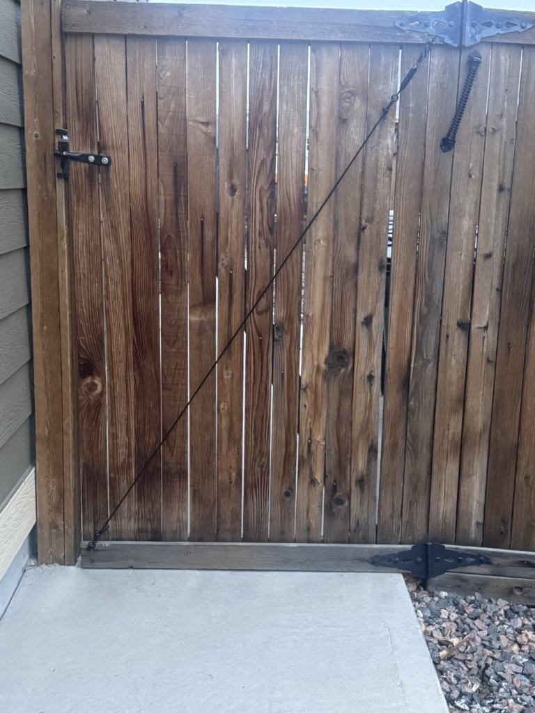

    Got tired of the gate starting to droop, and wanted to get this anti-sag kit done before this Arctic blast of ours comes through this evening. My hands were freezing as I needed to keep taking the gloves off for small nuts and such

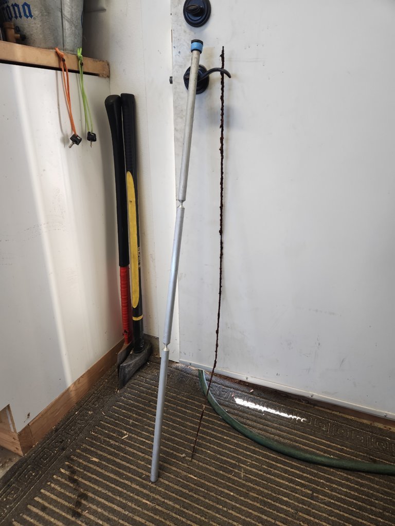

    Last weekend lol.
    2012 unit, original rod.
