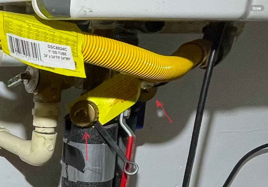

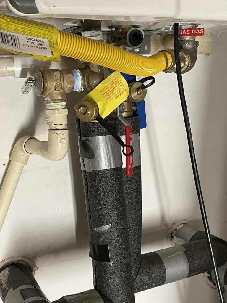

  6. Jan 14, 2025 at 9:30 PM
    WAtundra4x4
    WAtundra4x4 Retired from active retirement.
    Jan 25, 2018
    #12453
    808
    Den
    Wet side WA
    2018 Cement Tundra TRD crewmax limited
    Forward looking camera, Stub Antenna, 3M clearshield. A few other non lifted items.
    On the photo with the pipes showing, the flush/drain valves are there. I cropped the photo and drew a couple of arrows. I need to do the flush process.
    I found an older photo that shows the access to the flush ports better.

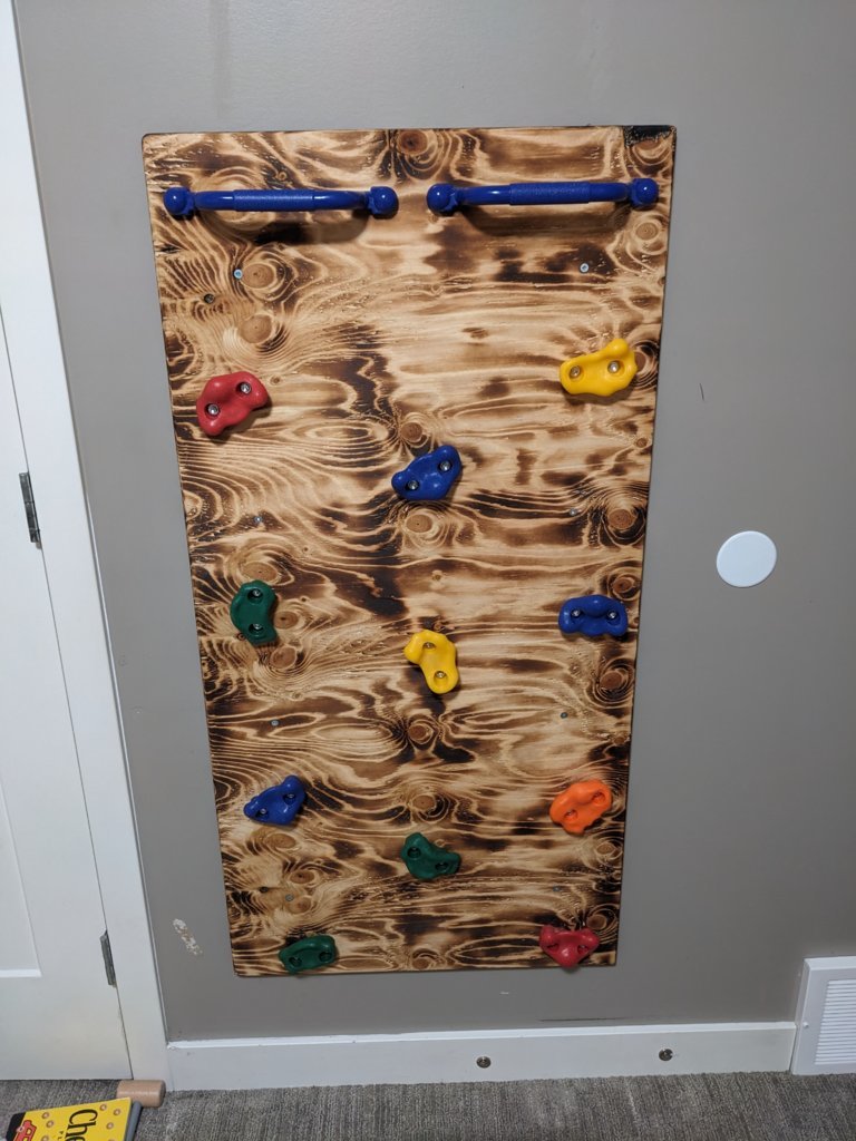

    I built and mounted a mini climbing wall for little AK's room.

    Awesome idea building it inside :thumbsup:

    Nice touch on the burn too, looks good

    The burn is my new favorite finish. Looks way nicer than a stain imho. I did a shelf last month as well that turned out really well and The Woman has requested any future wood projects to have it.

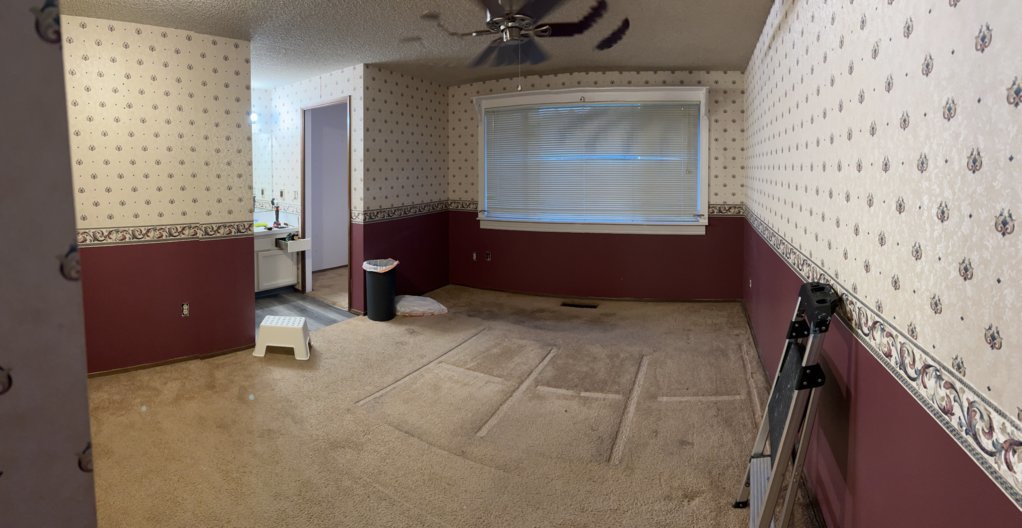

    Master bedroom reno. Scraped popcorn ceiling. Pulled vanity due to a leak so new vanity. Pulling carpet for wood flooring. Wipe down and retexture ceiling and walls tomorrow. Pulling wallpaper took two days. Don’t ever wallpaper people!

    Wallpaper sucks ass. When I did ours I figured out it was easier just to pull it off and then scrape the left over glue. It was hell.

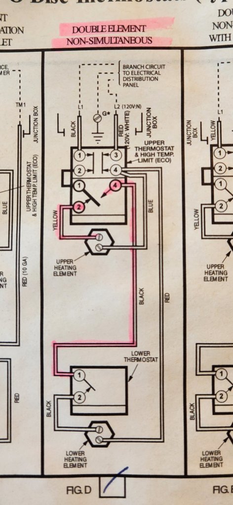

    Riddle me this..
    50gal Electric water heater, drained/flushed and changed anode rod. 4500w upper and lower elements.
    Filled back up, purged air and checked amp draw for shits and gigs. Both t-stats were made up, only the top element fired off. Looking at the wiring diagram, only one element can run at a time!
    1. When does this switch operate?
    2. What's the point of having two elements if they both can't heat at the same time??
    :confused:
    *Edit- now the lower element is switched on.. maybe the elements switch with every cycle?

    A few... Definitely more than 2
    I found this when I googled it. Seems, reasonable with the main benefit being half the current draw while the drawback would be longer cycle times.
    "Storage water heaters having equal to or more than 30 US Gallon / 100 litres (different storage for different countries) needs more energy input to heat up the large amount of water. Plenty of times you may also go for more than One heating element so that content of the tank could be heated up more efficiently.
    Although there could be more than 2 elements and maximum 6 For commercial water heating range but there are some models which could be customised for more no of elements as well, however right now I am only considering dual element model for the case of simplicity.
    Now this configuration can have simultaneous operation and non simultaneous as well.
    • In Simultaneous models, both lower and upper elements would get on at the same time, however they may get switched off at different times. Since hot water is lighter than the dense cold water, so it would automatically rise to the top of the water heater always. So the lower element in this case would always be working more as the top element will cut off faster. This mode is faster in water heating as compared to non simultaneous one.
    • In Non Simultaneous models, its the upper model that gets kicked in first, and having heated the entire top content of the water heater it switches off and then it triggers the lower element to start. In this case wear and tear of both the elements is more or less same."

    Makes sense, I guess. Dang engineers outsmarted me again! :D

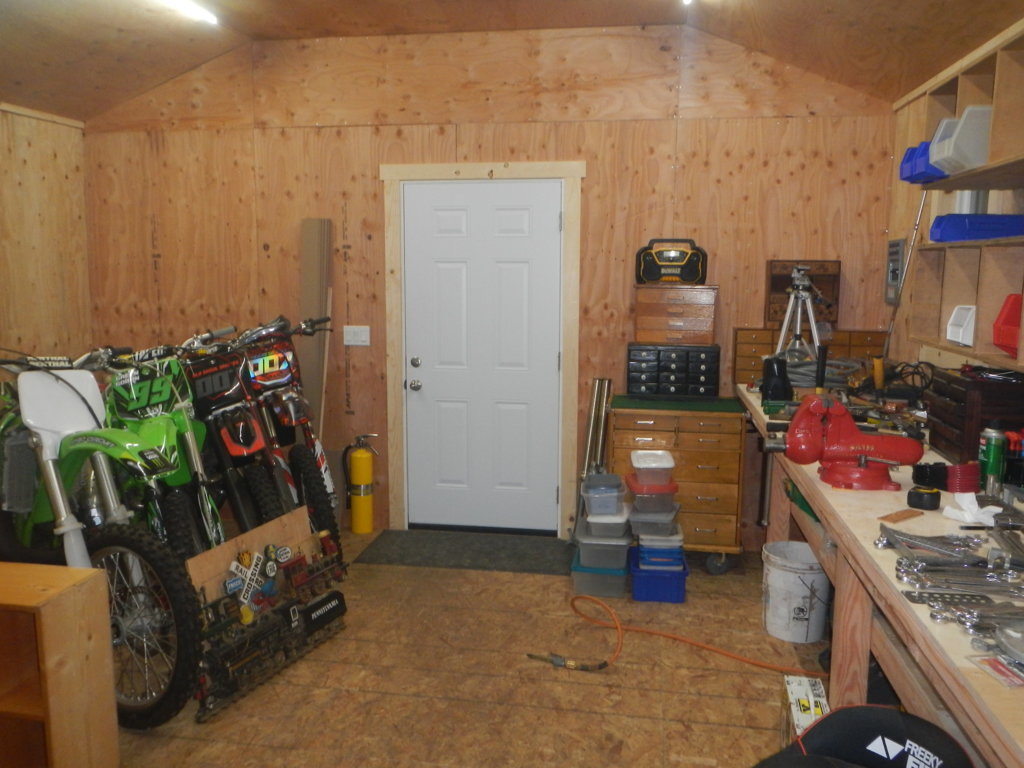

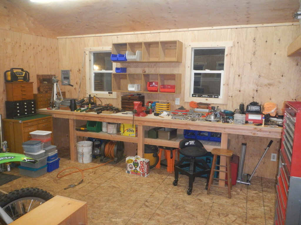

    Been awhile since I posted any progress on the new shop. If I get everything sorted and moved in by summer, I'll be amazed. 50yrs of accumulation. The project starts on page 441.

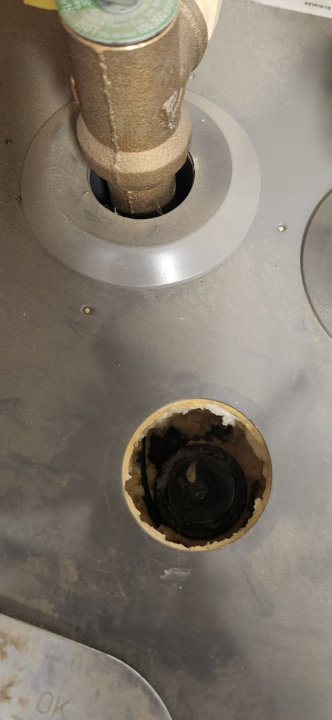

  25. Jan 17, 2025 at 7:52 AM
    NWPirate
    Dec 24, 2019
    #40251
    12,140
    Zach
    WA

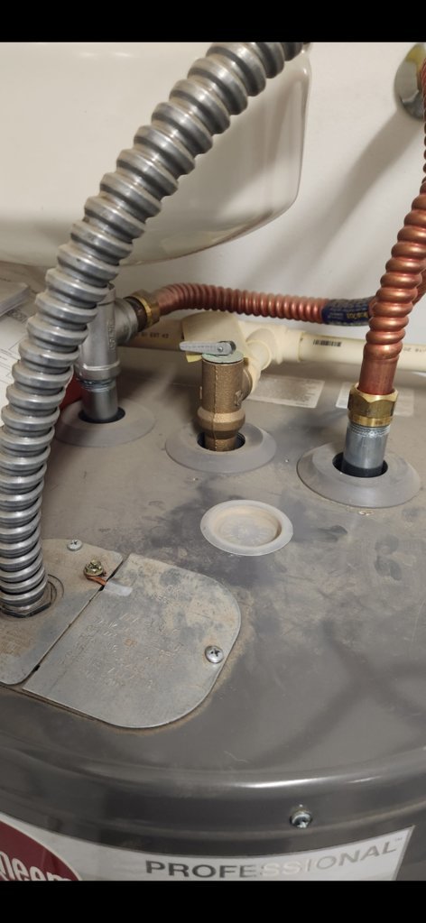

    8 years, and we don't have that hard of water here.
    I've looked for it before but I didn't think it had one.
    Had to dig out 2" of foam to find the plug.. now i know!

    In my experience, digging the foam out is the second worst part. Followed by breaking that sum bitch free from the water heater. The new model I have, I asked about that and swapping out the bottom drain to a more open one and they informed me that it immediately voids the warranty. So I will wait a couple more years before checking on it

    No joke man, I tried a breaker bar but it took my 1/2" impact to bust it loose.
    Mine has a brass drain valve, I guess a lot of the new ones are plastic.
