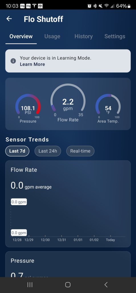

    Moved our PRV before our water softener and Moen e-valve. Guess I never noticed that when I plumbed in our eater softener, I plumbed it before the PRV. Wasn't until I installed the Moen valve and it sent me a high psi alert that I realized my mistake. Moved it down right next to the water shut off, ran some new pex and got it all done. It's leveling off at around 72...I'm gonna bump it up to 80ish

    Adjusted the PRV as much as I could..got up to 81.5psi....I'll take it.

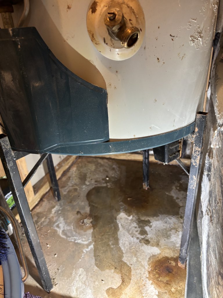

    Well shit. I guess I jinxed myself. I hate when that happens. Looks like I'm on the hunt now ... Gotta figure out what to buy (tankless is where we're probably going).

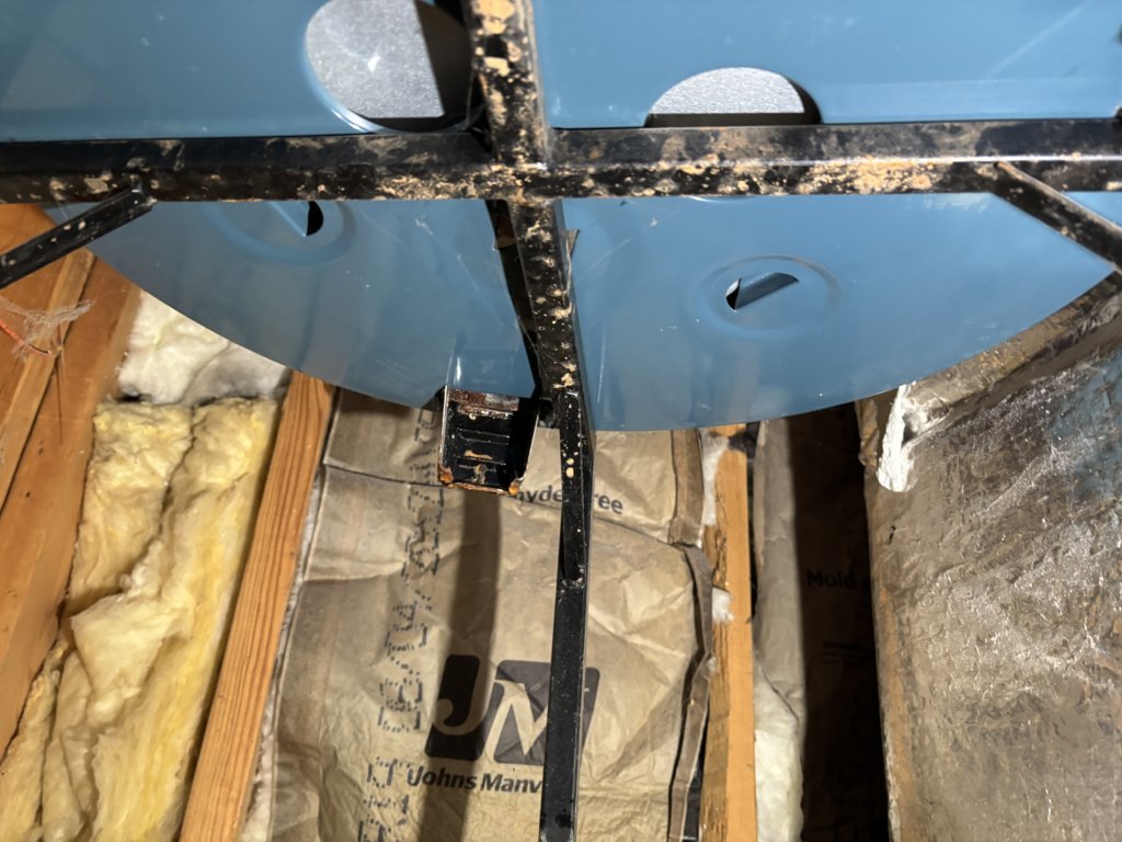

    I have a state tankless that I would buy again. I'll get a pic of it for you. I've also heard good things about Rhiani. Are you on propane or electric? Because I'm far enough away from a city to shop around I've also had good experiences with this place for plumbing and heating supplies.

    Sorry this took me so long. I got sidetracked. Wife is out of town so I had to go get my daughter from Basketball practice then come home and make dinner.
    This is installed in my crawl space under the house. The sticker has minimum clearances posted as well as serial number.

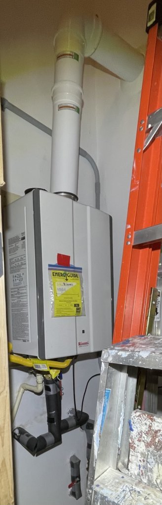

    I want post a few pictures of our installation. It’s 3 years old now and has worked fine. I showed a copy of the label and the clearance requirements are there. When we had our old home and maybe 10 years ago the water heater redo, we looked at tankless. BUT the ventilation was to be stainless steel, so our run to the roof would have been expensive. Note the venting now is PVC, a lot cheaper. I also showed the gas connection and the final connection to the tankless system. It is larger than what I had for my old tank water heater at the old house. Anyways, the tankless system is good for 4.5 gal/min on this model of Rinnai

    That venting is dual vent pipe - it’s an inner SS or AL pipe with a separate outer PVC. The inner is the exhaust and outer is intake air. It’s expensive stuff, and Rinnai is particular about total distance and total fittings, but makes for a very compact installation.
    I don’t see flush/drain valves under your heater - that’s too bad because they make the periodic HX flushing process so much easier (I do mine about every 18-24 months).

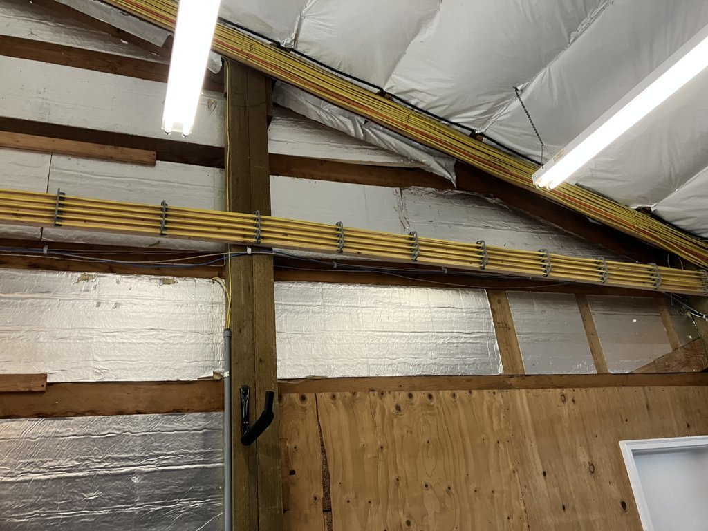

    I’m stalled on progress due to being sick but this is my kitchen power in the shop feeder.

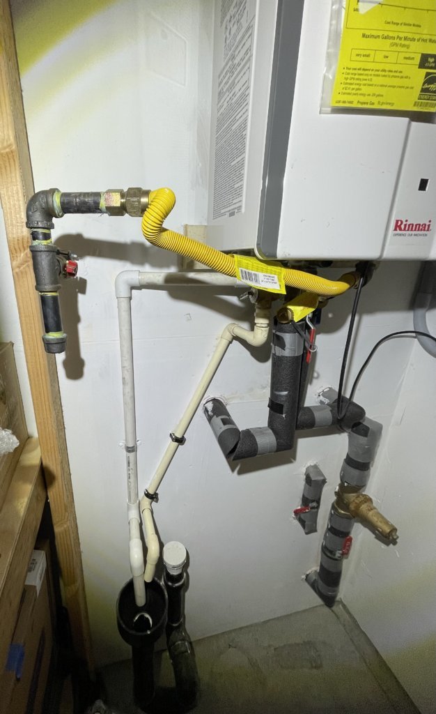

    Thanks for your input. Any extra eyes I can get on this, any input, is all welcome. New territory for me (tankless). I'd shot the shit casually with @FrenchToasty and @Festerw (IIRC) at one point, thinking I had years. Obviously not the case.
    This is current setup, with WH/expansion tank/furnace, see pics.
    Gas:
    Note the black pipe run overhead is 1½" OD black pipe, tees vertically down one 1", then splits in 1" and 3/4" respectively to each appliance (3/4" goes to water heater, but I've got a good volume to tee from). Sediment traps, I recently added.
    Exhaust:
    Vent off the WH is obviously small, but dumping into what I believe is 6" (possibly 5").
    Vent off the furnace is 4" and you can see where it jumps up to the 5" or 6" just before the WH dumps into it.
    Where it disappears into the insulated wall, above 4ft forward from that point, it goes up through a chase to the attic.
    Spacewise, I'm thinking the back wall may not have clearances required, so we may be sticking it on the wall to the left. Bummer, leaves us with less closet space than I'd like if that's the case.

    So I just went through this as we are building (almost done) with our house. Our plumber, who can get any brand, says go with Navien hands down. I also asked other plumbers/companies in my construction groups for work and about 8/10 said Navien. I also have a buddy who owns an HVAC company and they install Ruud/Rheem and he has Navien in his own house.
    Navien has all stainless interior parts, as well as pretty high efficiency. It is the Toyota of the tankless world. From what I can tell they seem to have overtaken the tankless world for best/most reliable. This may vary by region.
    At our house I actually did 2 tankless water heaters. Yes sounds crazy but hear me out. With one water heater in the corner of the basement, it was about 130 foot run to get to the other side of the house to the master bedroom. You can run recirc kits, but by the time you run it that long, get the correct kits, etc... you are at the same price for a 2nd heater. So we have one for each side of the house. The first one has the 2 kids bedrooms and the kitchen, the other one run the bonus room, master suite, laundry room. We do not have any recirculation setup and 15 seconds is the longest it takes to get hot water anywhere.
    We also have a line with valves running from one tank to the other. If one of the heaters goes out, I can flip a valve and the whole house will run off of the 1 heater in a backup situation. I have 2 of the Navien 240S2 199,000 BTU heaters running on propane.
    I thought my plumber was crazy for suggesting 2, but now that I did it I am really glad I did!
