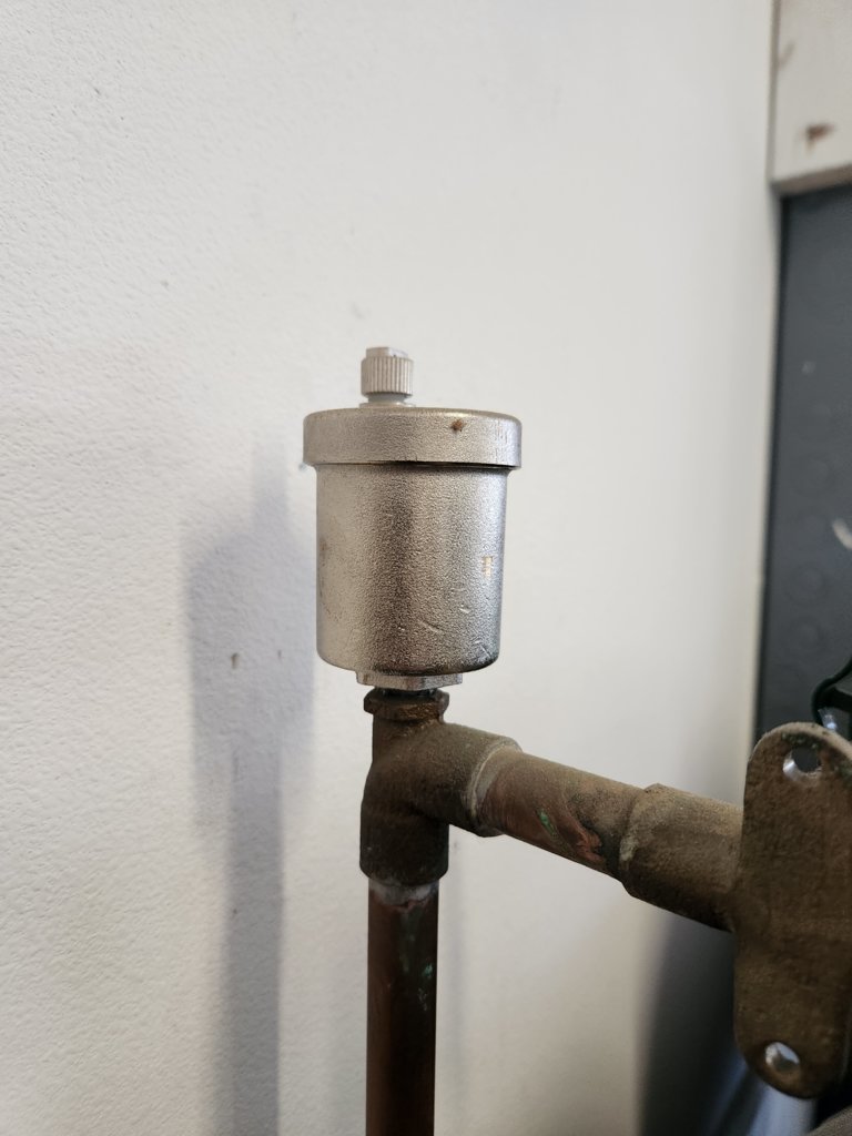

    Does anyone know how these Taco air vents work? This is on my hot water supply loop. It's labeled 150psi

    That's a Taco Hy-Vent model 400. It's there to burp air pockets out of the system - don't normally see them in domestic water systems, but I could see why someone would add one to a recirculation loop (to prevent air from causing the pump to cavitate). If your system is build right, the only time it would ever be burping water is if you had to do a drain-down and re-fill of the system.
    There's a float inside of them that holds it closed when the system is full of water, but when air gathers in the body the float will drop and burp that air out the little cap. It is possible for them to spit a little water when that happens (not much), but if they are leaking considerable water it's a sign that the unit isn't working right (or you have a shit-ton of air in your water). They do make an adapter to replace that small cap that you can connect to 1/4" NPT pipe threads to route to a drain.
    The "150 PSI" marking is the rated pressure it is built for, not the operating pressure of your system. The newer ones now are built for a 250psi rating.
    We install thousands of them in industrial and commercial projects, primarily on hydronic systems to allow for draining and filling.
  10. Jan 11, 2025 at 9:20 AM
    NWPirate
    Dec 24, 2019
    #40251
    12,366
    Zach
    WA
    Very cool, thanks for the info.
    Is there a way to manually burp the vent? Just thinking about it when I pull the circ pump off
    TaquitoBandito likes this.
  11. Jan 11, 2025 at 9:31 AM
    RainMan_PNW
    Oct 27, 2020
    #54134
    16,952
    Casey
    Clark County, WA
    2021 Lunar Rock TRD Pro CM
    That style - not really.
    But burping it won't really do much (other than spray water) if the air pocket isn't at the spot of the air vent. And that's the purpose of the "automatic air vent" is to burp that stuff out as runs through the system and collects at that point (presumably a high point - at least a local high point).
    When you get everything buttoned back up, open up the piping as normal but don't turn the pump on right away.
    Run your highest faucet in the house until it stops sputtering air.
    Then turn on the circulation pump to run continuously and let it run for a while (maybe an hour?). It should burp anything that loops through the system and makes it back to that point (they collect a bit inside before the float will trip). While it is circulating, you can also open various faucets off and one to confirm they aren't sputtering.
    https://youtu.be/Vn4W4Nt7z2E
  12. Jan 11, 2025 at 9:41 AM
    NWPirate
    Dec 24, 2019
    #40251
    12,366
    Zach
    WA
    Yep, that is the high point.
    Great suggestions, thank you :fistbump:

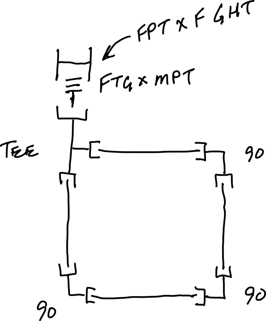

    If you've never sweat copper before, it's not difficult to learn but it might be good to make yourself up a "test piece" that you can test to make sure you get a feel for it AND that you can leak check before you go to town on your live systems.
    get some extra 1/2" copper tube and a few fittings - I'd suggest a tee, 3 elbows, and a FTG x MPT adapter, as well as a FPT x female Garden Hose adapter.
    sweat it up into a square donut like this sketch, then thread the garden hose adapter onto it and thread that onto a garden hose and hit it with some water while sitting over (or in) a bucket. After an hour - see if you have any water in the bottom of the bucket (to confirm you don't have some small pin-hole leak).
    You can always re-use the garden hose adapter, but the rest of it you can put on your desk at work to prove to the plumbers that electricians are smarter than they look. :boink:
    A few other pointers:
    • use MAP gas for your torch - it gets hotter and will work better than propane
    • I recommend a torch that has a trigger pull for igniting AND gas flow. You'll be on-off-on a bit and you'll want the other hand free for wiping the joint. Like this one
    • Put the heat on the fitting - never on the pipe. Just above the tip of the lighter blue flame is what I like to touch to the back of the cup.
    • Do all of the joints on a single fitting before moving on - prep the pipe, flux everything, and dry fit all piping going into a single fitting before you start sweating that fitting. Every time you heat a fitting up you have potential for the other joints to weaken so working on one fitting at a time minimizes issues.
    • 1/2" and 3/4" elbows and tees are best to put the heat to the "back" of the fitting cup and spot test your solder after a bit - touching the solder to the open edge 180* from where the heat is being applied. As soon as it starts to suck into the joint, turn off the heat and feed in the solder to that joint. Then give it a wipe with a damp rag before moving to the next joint on that fitting. Apply just enough heat to the back of the next cup to start drawing solder into it before turning off the torch again and feeding that joint. If you don't think you got enough in there you can always heat it up (again, just enough) and feed some more in.
    • Disassemble the pump body when you sweat it - you don't want to be putting heat into the o-rings or any other parts, just the bronze housing. Same basic principle for sweating the housing except it will take noticeably longer to get it hot enough to draw in solder (it will also hold the heat longer). With the smaller pipe size of these pumps, you shouldn't really need to keep heat on the housing while you feed the solder in (on larger sizes you would need to keep heat on it to fully fill the joint).
    • Working flat on a bench is best when pre-assembling - you can keep things straight and avoid mis-alignment. Soldering "uphill" is kind of a pain compared to "downhill" (thinking of your vertical piece of pipe), but these size fittings aren't that much more effort (compared to trying to feed uphill into a 2" elbow).
    • emery cloth for cleaning/roughing the outside of the pipe AND the inside of the fitting cup is critical - even on bright shiny new fittings.
    • flux is critical.
    If it was ME, this is would be my order of operations:
      1. cut out the old pipe leaving room for to have a ~3" piece of tube on either side of the new pump housing and a union (and not be too close to the existing valves).
      2. sweat half of the union to the pipe that is still in place (top of water heater and bottom of the pipe coming back from the house). this determines my "end-to-end" spacing between the two.
      3. cut two pieces of tube that when fit into the pump housing end up about 1" longer (on one side - there's a minimum length needed for the tubing cutter) than the space needed between the two union halves. sweat these into the pump housing on the bench.
      4. sweat the UPPER union half onto the upper section on the bench.
      5. get a final dimension needed to make the pump section fit between the two union halves so that it fits cleanly without any stress on the pipe. make that cut, then flux and assemble that union half onto the lower section. do not solder on the bench.
      6. "dry assemble" the pump section into place. hand snug up the upper and lower unions (don't tighten) and then sweat the lower union top half. Then ensures the union faces aren't misaligned at all (there are tolerances in the fitting cups when you are putting things together).
      7. let it cool to where you can touch it with bare hands, then back off the union nuts and confirm that the pump section can be removed smoothly (the whole point of using the unions). assemble the pump components into the pump housing
      8. final reinstall and properly tighten the unions using two wrenches (or channel locks).
      9. give all the joints one more good wipe down with a damp rag so there isn't any flux left on the outside of the pipe (it will oxidize the copper and turn green).
    Hope all that makes sense.

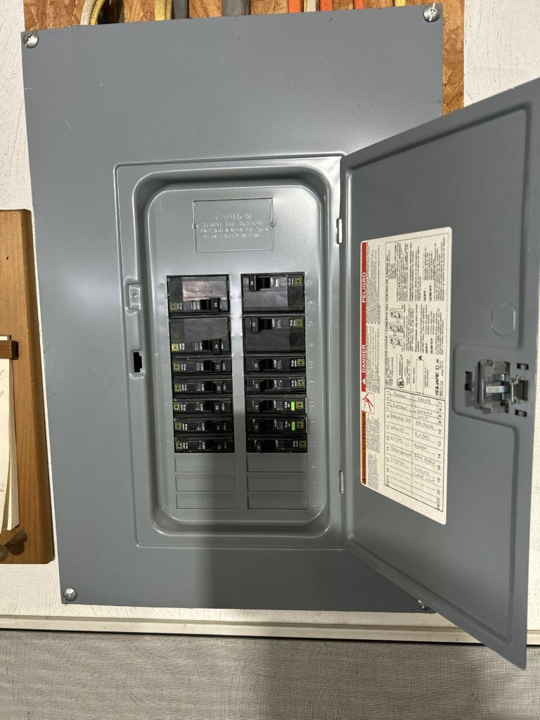

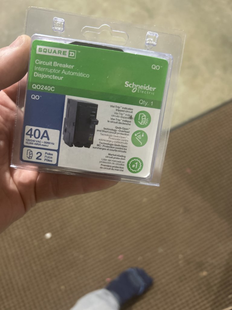

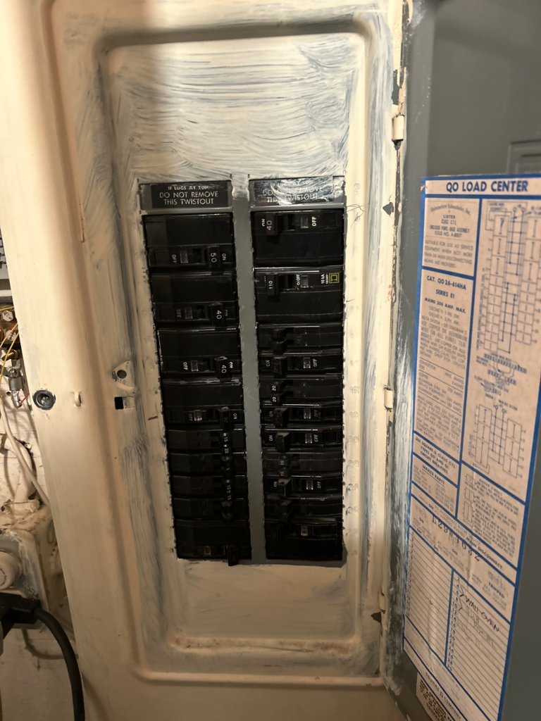

    Ok question for you all - I am pretty handy but have always been a bit Leary of electrical work. Over the years I have put my nerves aside and accomplished installing recessed lighting, ceiling fans and requiring gfi’s, etc. However this is a bit different and I need some advice.
    after cleaning and organizing the garage, I have a pretty nice work space now. I want to install a heater in the garage. My wife gave the go ahead to buy this one:
    https://www.amazon.com/gp/aw/d/B0DD4NXJ4C?ref=ppx_pt2_mob_b_prod_image
    I went ahead and ordered it on open box at a big discount and installed a joist brace to lag bolt the heater bracket into. I bought the 8/3 romex and double pole 40A breaker. I am going to connect the wiring to the heater (if not done out of the box) and mount the heater to the ceiling joist. I will run the romex down to the sub panel in the garage (close to where the heater is mounted). Here is a picture of the sub panel.
    Here is the main breaker panel of the house (in the basement):
    My questions are:
    1. How hard is it to wire a breaker into the panel. I watched some videos and feel like it’s definitely something I can do, but would be lying if I didn’t admit being a little nervous.
    2. I assume I have to shut the power to the sub panel from the main house panel? Or do I have to shut the entire electrical down while wiring the breaker into the sub panel.
    3. If I were to tackle this myself, here is what I have gathered.
    A. Shut the power to the panel down.
    B. Remove panel faceplate.
    C. Punch opening at top of panel and run wire through; install wire clamp.
    D. Strip ground wire and connect to ground of sub panel.
    E. Strip neutral wire and install in panel.
    F. Positive hot lead connects to back of double pole 40A breaker.
    G. Clip breaker into panel.
    H. Reinstall face plate of panel.
    I. Turn on power to sub panel.
    J. Test the heater.
    Is it as easy as that? Or am I oversimplifying things and need to hire an electrician? I wasn’t sure if I had to somehow physically tie into the basement panel and run to the sub…..
  16. Jan 11, 2025 at 11:26 AM
    Trooper2
    Feb 7, 2018
    #12738
    6,795
    JR
    Houston, TX (Suburban South)
    Not a certified electrician but know this is definitely doable.
    Most panels do not require disconnecting the feed to install or remove breakers. It won't hurt anything if you do but not necessary.
    I would install the breaker first, before landing the wires. You could test your breaker before landing the wires if wanting to.
    Other than that I think you are good to go.
  17. Jan 11, 2025 at 1:41 PM
    NWPirate
    Dec 24, 2019
    #40251
    12,366
    Zach
    WA
    Sounds like you've got a good game plan, the panel is a good SqD QO panel too.
    You don't have to kill the sub-panel but it doesn't hurt, just to be safe.
    I will say just make sure your lugs are good and tight. It wouldn't be a bad idea to kill the power after a couple months and double check the lugs on both ends.
    Have fun!

    What these two said, except that if you're a noob working inside of a breaker panel then I would absolutely still turn off the sub panel first. It's pretty hard to fuck up inside of there unless you make contact with the terminal screw on one of the live breakers or one of them on the feed coming in, but it's still a good bit of extra insurance.
    Snap the breaker into place and turn the breaker off.
    Bring your wires down into the top and lay them nice and tidy along the sides like the other wires in there should be. Connect the ground to an open ground bus terminal spot. Same for the neutral. Then land your two hot legs each on one of the two terminals on the breaker. Snap/twist out the cover pieces to fit over the new breaker and put the cover back on. Turn on the power to the sub-panel, then turn on the new breaker.

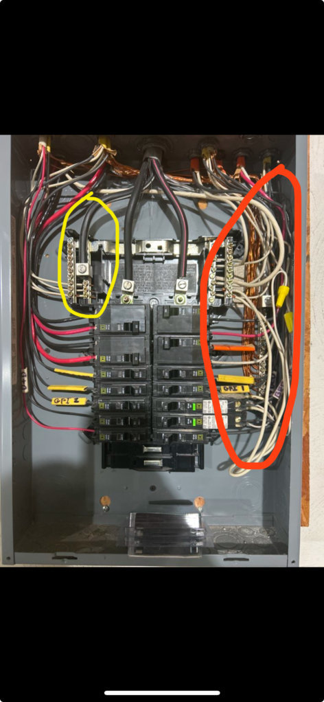

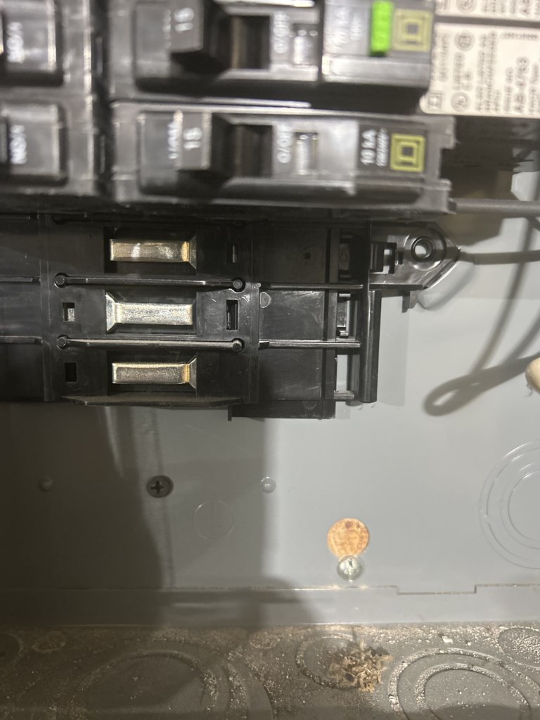

    This is what my sub panel looks like now. I am looking for confirmation here just so I am doing it correctly.
    I would connect the ground copper wire to one of the lugs where the red circle is. I would connect the white neutral to one of the lugs where the yellow circle is (the grounding lugs are where the copper wires are neatly stranded together behind everything else). And then black and red would connect to the poles of the breaker. Does it matter where each color goes?
    This is the breaker:
    And it would clip in here:
    TaquitoBandito and NWPirate like this.
  22. Jan 11, 2025 at 4:05 PM
    RainMan_PNW
    Oct 27, 2020
    #54134
    16,952
    Casey
    Clark County, WA
    yes, except
    I would connect the white neutral to one of the lugs where the YELLOW circle is.
  23. Jan 11, 2025 at 4:07 PM
    shawn474
    shawn474 Lego connoisseur
    Jul 23, 2019
    #33569
    2,850
    MoCo, Maryland
    Yes my mistake ; that’s what meant to type. The red and black hot wires can go to either side of the breaker or do they need to be oriented on an assigned side?
  24. Jan 11, 2025 at 4:14 PM
    RainMan_PNW
    Oct 27, 2020
    #54134
    16,952
    Casey
    Clark County, WA
    yes - you can plug either one into either side.
    the way it works is that each hot leg is 120V (combined they make up the 240V that feeds the heater). the neutral acts as the return leg for 120V power if any other component in the heater runs strictly on 120V (often the electronic controls in things like an oven or a dryer run on 120V while the big heating elements are what use 240V). And the ground is just that.
    https://youtu.be/fJeRabV5hNU
    NOTE if you watch that video - pay attention that when they show the ground connecting to the neutral bus bar, it is because that diagram is using a shared bus (via that bridge connector). In a SUB-PANEL you will NOT have a shared bus bar (code requires them to be separate except in the main panel).
  25. Jan 11, 2025 at 4:28 PM
    shawn474
    Jul 23, 2019
    #33569
    2,850
    MoCo, Maryland
    Thanks to you all so much. I feel much better about this. And can save a couple hundred bucks
  26. Jan 11, 2025 at 4:31 PM
    NWPirate
    Dec 24, 2019
    #40251
    12,366
    Zach
    WA
    Standard practice is Black then Red (A phase black, B phase red).
    Notice your top two breakers on the left.
