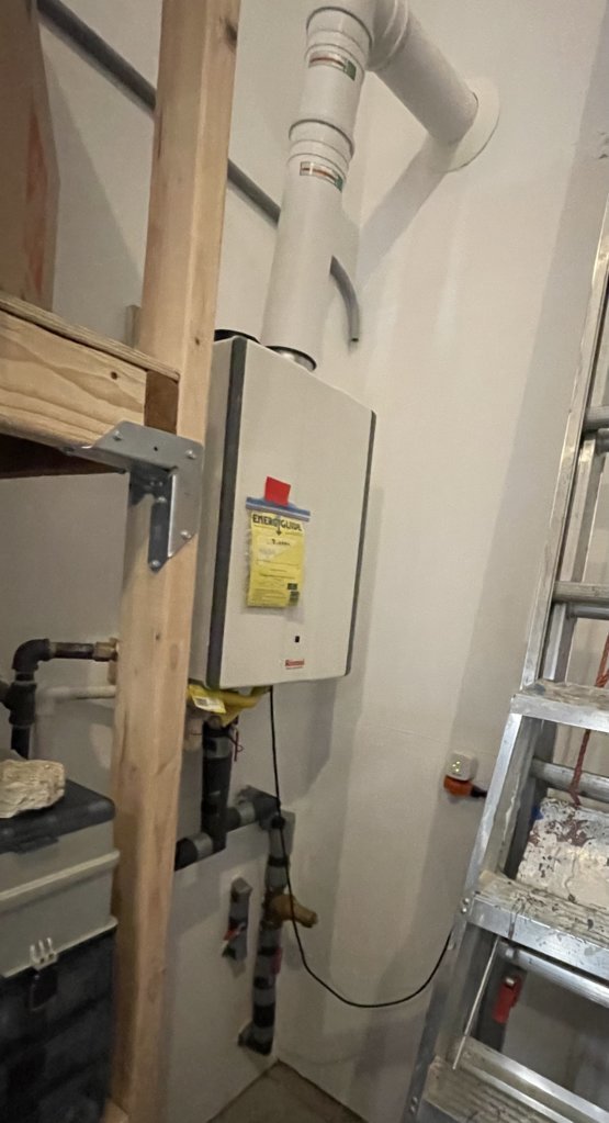

    We woke up this morning to the lovely smell of my house full of propane. I don't know why at this point but we got everyone out and the tank shut off and windows open. They should be at our house to inspect things shortly.

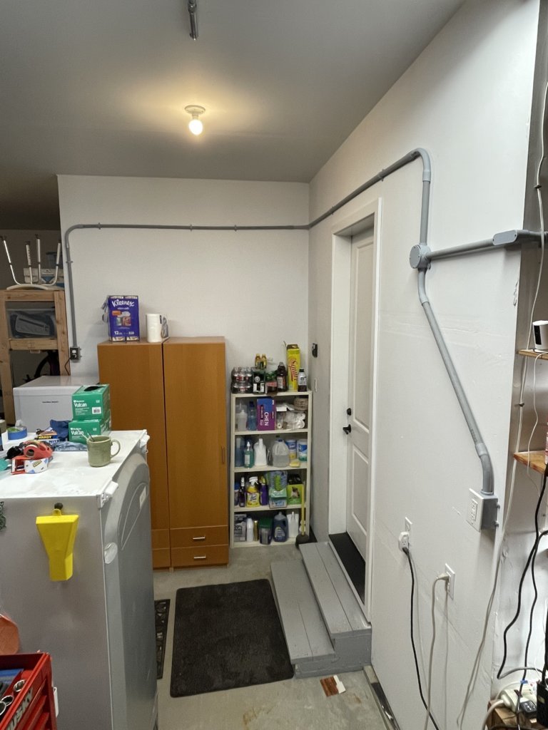

    The outside outlet should be Ground Fault circuit imo by the hot tub. It should be off a GFCI breaker or tapped off a GFCI outlet from the house.
    Breakers can go bad or just be bad from the factory. I had a breaker that was tripping on a coffee pot, ended up replacing it and solved the coffee pot issue. Note: I thought it was the coffee pot but after replacing the pot it still tripped.

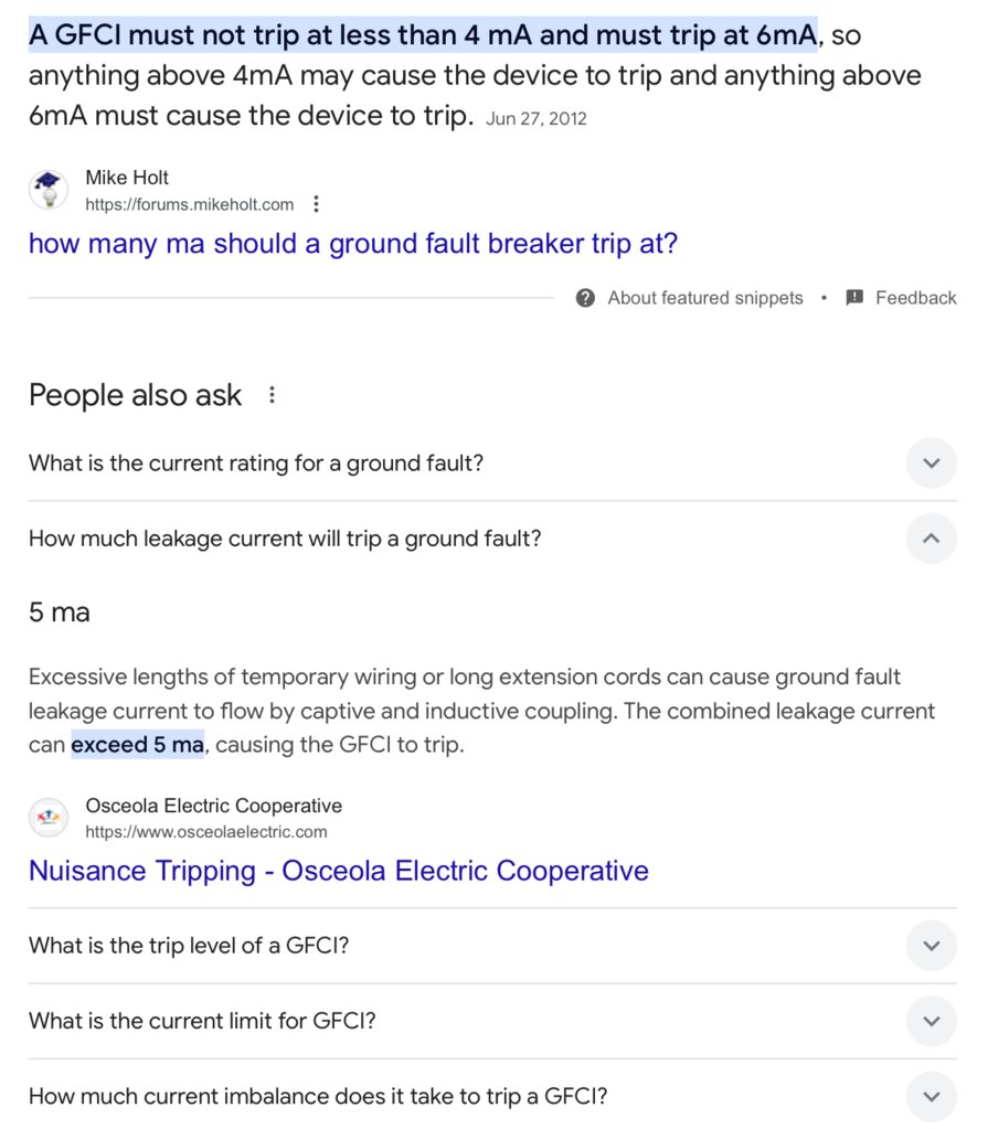

    Crazy part its not tripping the breaker at the panel. Only tripping the GFCI cord. And I agree the outlet needs to be GFCI.

    From what I read you have a GFCI Cord plugged into a standard breaker. You have a ground fault, but not an over current fault.

    Yep. I checked the outlet and it appears to be grounded, but I'm just a guy with a multimeter and YouTube. Dangerous combo. LOL. Waiting for him to reply.

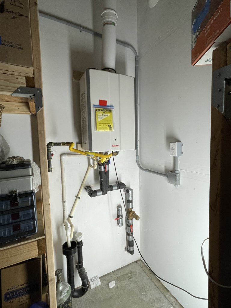

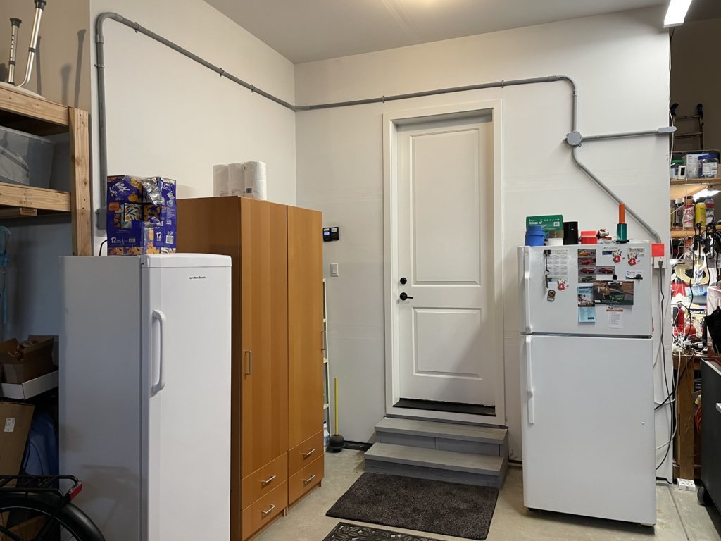

    We had a solar panel system with a 10KWh backup battery. The backup battery is just a partial house backup. Our tankless water heater circuit is one of the circuits backed up with the system. I decided to put the fridge and small freezer in the garage on the same circuit. I did some power measurements and did a month test with extension cords to see if the breaker would be tripped. It worked fine. So I proceeded to add a couple outlets off the water tank circuits also. I used 12 gauge solid copper wire THNN Type in 3/4 inch conduit. A lot of ladder moving and body contortion for the install. It’s been doing running ok for a couple nights so far.
    Outlet by ladder to be tapped.
    Conduit installed.

    The extension cord might be the culprit.

    I thought that too. Plugged it into the other outlet outside and it works fine. Granted now I have to use an extension cord. I

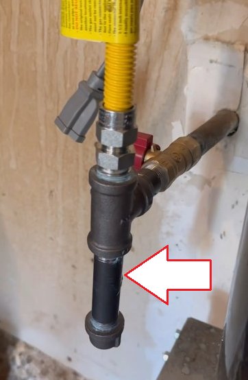

    Ok. Sorry for the delayed update. It turned out to not be a leak, thankfully, but more our inexperience with propane. We've always had natural gas everywhere we have lived before this house. Apparently, when your propane tank gets low enough you can get a gas smell inside the house. And that's all it was. Which was definitely concerning when you wake up to it and don't know it's a thing. The propane company did apologize to us as we are on a plan where they monitor our tank and it's never supposed to get below 30%. But their customer service and response to our problem has been nothing but outstanding.
    Up where we live in Norcal it has been pretty wet and no real concern about fires right now. This week is the first week in a long while where there is no rain.

    Best case scenario.... good to hear! Glad the family is safe and good to know since we just added propane and didnt know this was a thing.

    I remember reading your post and thinking "I wonder if his tank's just getting low.....NAAAH it can't be that simple" and forgot to mention it.
    :facepalm:
    My apologies for not saying squat. That's totally a propane thing - only time I noticed it was when the local propane company screwed up and forgot to deliver stuff. In response I just got used to checking the tank gauge every month or so and notifying them whenever it got around 40%.

    Called that a drip leg all my working life, wonder if it's one of those regional things

    I’ve heard both. Also mud leg and dirt leg.
