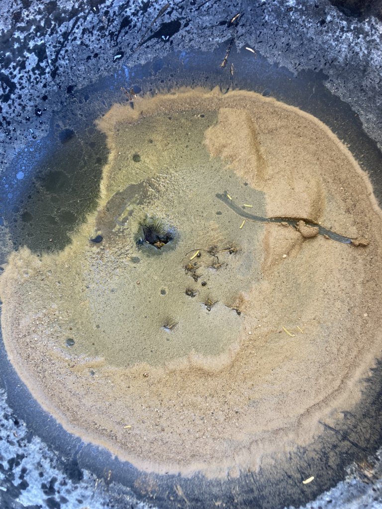

    IMG_7494.jpgAll this hot water heater talk got me in a mood…..
    I haven’t flushed our tank in maybe 4-5 years, not terrible since our water is just that

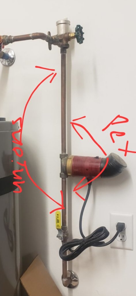

    I think ill go with a Taco continuous duty pump like @ColoradoTJ posted.
    When I solder in the unions top and bottom, how does a guy spin all the nipples on without spinning off the other side?
    In the electrical world we have a 3 piece rigid coupling for this scenario

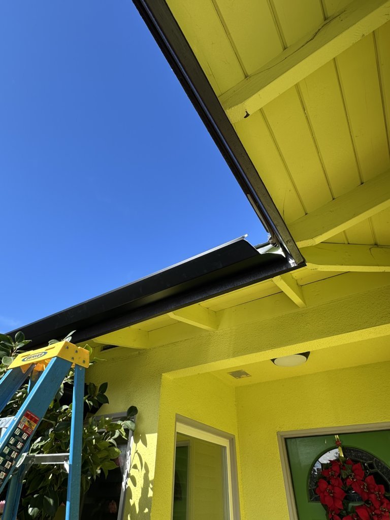

    Installed new gutters on rental before house getting painted..lol

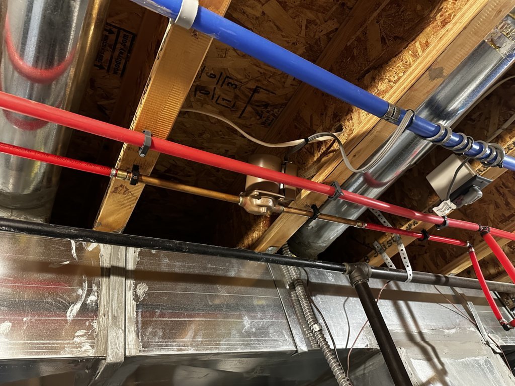

    I will go take a picture of how ours is installed.

    I was thinking the same thing but opposite with mine, pex on both sides of the pump.. :monocle:
    That way I can get everything in place and then crimp the rings.
    What do you think? @ZPhilip @Festerw

    Also FWIW, my whole house is Pex B except for this pump section

    I'd skip the pex and just use unions on both sides of the pump.

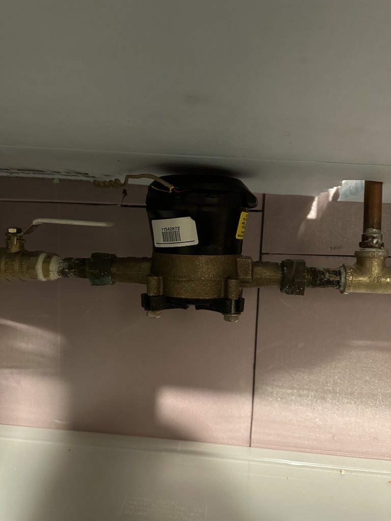

    Please skip the Pex B as it causes a restriction compared to your copper there. I just don’t like Pex B.
    This is a picture of my water meter, not a recirculation pump. This is how I would install it with unions on each side. Looks like you already have valves on either side of the pipe also so you don’t have to drain down whole house when swapping.

    I would sweat the new one in. It is using the pipe to support it. Pex isn’t going to give it that support and may allow it to vibrate due to the rotation of the motor.

    What these two said.
    No PEX
    The hardline supports the pump and provides straight line of smooth pipe to reduce flow restriction and possible cavitation.
    Unions are a watertight pipe version of your 3-piece couplings. Use sweat ones - don’t bother with threaded nipples here… it’s just more leak points. And always use two wrenches when tightening them - one to backup the “male” side and one to tighten the nut.

    This one is plugged in but has a timer on it
    :laugh:
    Yeah, I've convinced myself to sweat the connections.
    I can hear up the old solder to pull those pipes, right?

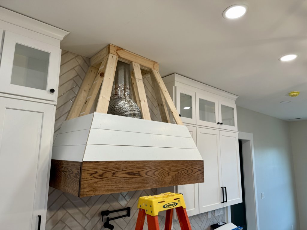

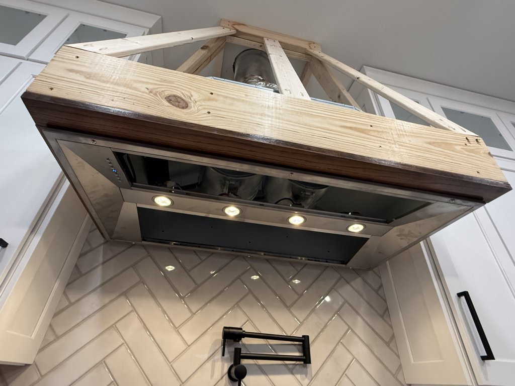

    I have been working on our range hood past 2 weekends. Have some trim pieces and may redo the top 2 pieces to flow a little better, but all in all this is what the Mrs. Wanted.....
    IMG_0095.jpg IMG_0093.jpg IMG_0102.jpg IMG_0115.jpg IMG_0119.jpg IMG_0121.jpg
