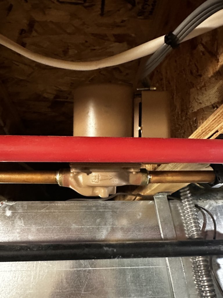

    :help: Hot water circ pump.
    1-Replace bad pump with similar model Grundfos? (This one only made it 5-6 years) Easy swap out.
    2-Switch it out for a Taco or another brand? Will require additional copper work.
  23. Jan 5, 2025 at 10:51 AM

    I’ve never used taco pumps, but I hear they are way cheaper, how many times do you want to replace it in the future?
    also, check the capacitor, and see if there is acess or pull it and see if it spins freely, might get lucky with just a bad cap

    Not impressed with the Grundfos so I'm leaning towards another brand.
    If i swap it out I'd like to plumb it with pex or flex so I can replace it easy. This time I'll have to solder a female adapter on both ends, I'm thinking..
    It's a magnetic motor with a little turbine style pump

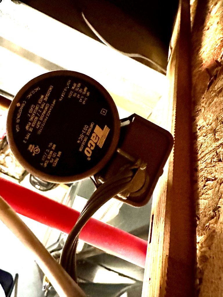

    Taco pump has been running since 2013.

    It's not for pressure, I have a hot water loop plumbed in so every fixture has constant hot water a *few feet away at the tee.
    Pretty much like an insta-hot using a hot water tank

    I would try a better brand if you can source one, maybe with threaded connections. And solder in 2 unions so you can swap it out in the future without soldering.

    That's what I'm leaning towards.
    What kind of pipe should I plumb in after the unions to the pump?
    A flex line would be nice and easy but I imagine the flow might be a little decreased with that
