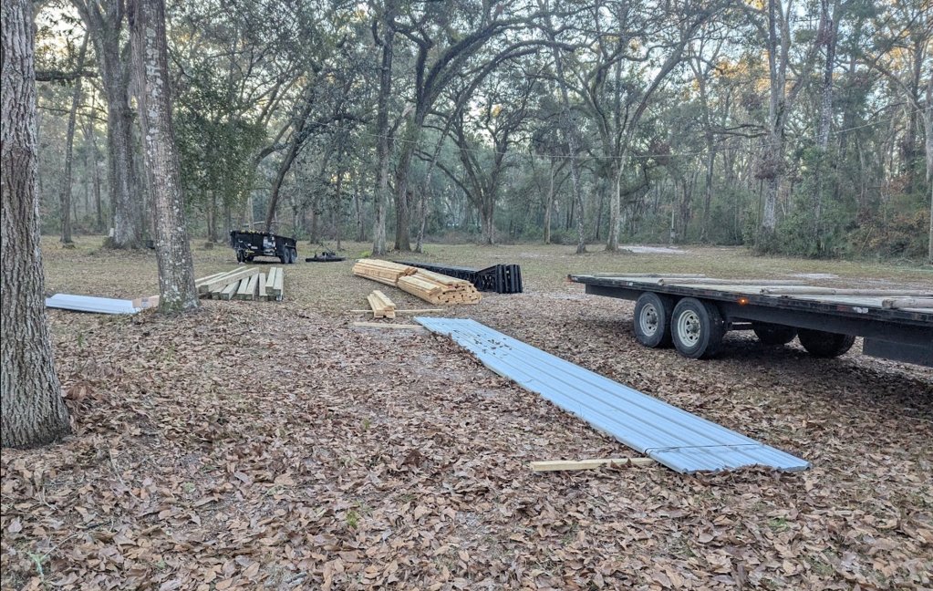

    Today we got our delivery... New barn is now on the ground while I wait for permits and tree work.

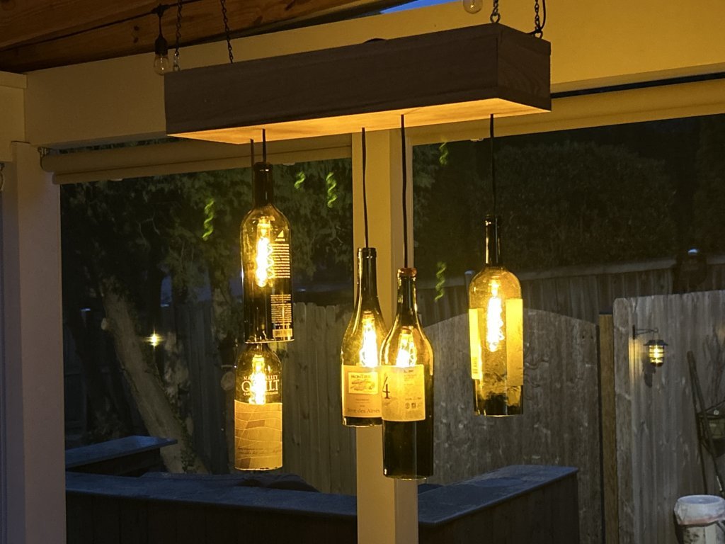

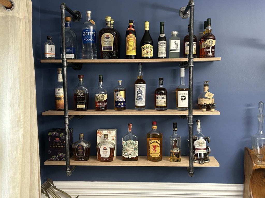

    We have an attic above our garage that is used for storage. I had a bunch of old wood lying around and even some old closet doors. With all of the Christmas decorations being packed up I figured it was time to make this a more accessible space. So I laid all of the scrap wood and closet doors and screwed down to create a floor. My old ass and three back surgeries don’t allow me to snake through rafters balancing on joists like I could years ago. Now I have freedom of movement and can easily navigate. Increased the storage space exponentially and allowed me to free up a ton of garage space. Now to tackle the organization of the garage!!!!
    I also ended up building a wine bottle chandelier out of some scrap red oak shelves that I had lying around and built a liquor bottle rack. Just a couple fun projects over the holiday break.
