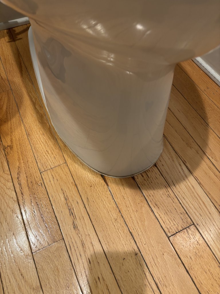

    Edit: looks like the caulking is falling off the base of the toilet

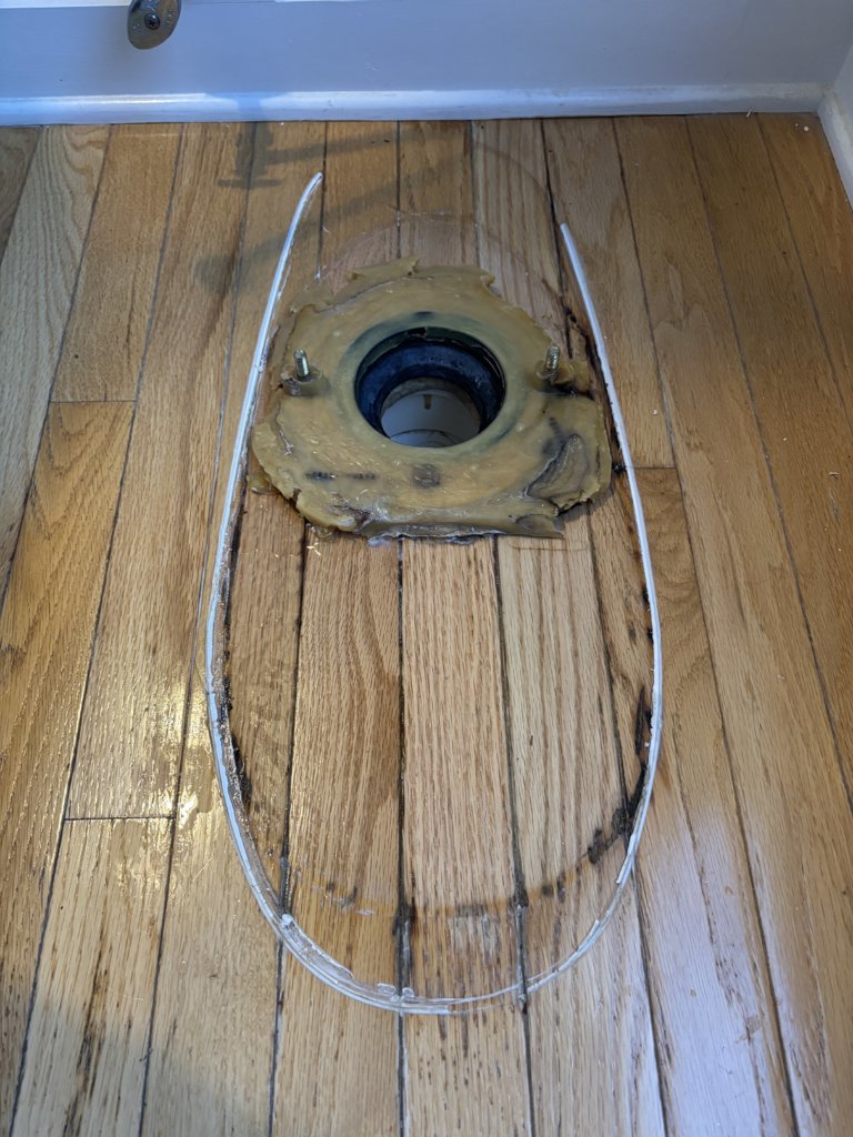

    '06 AC Limited V8/4WD

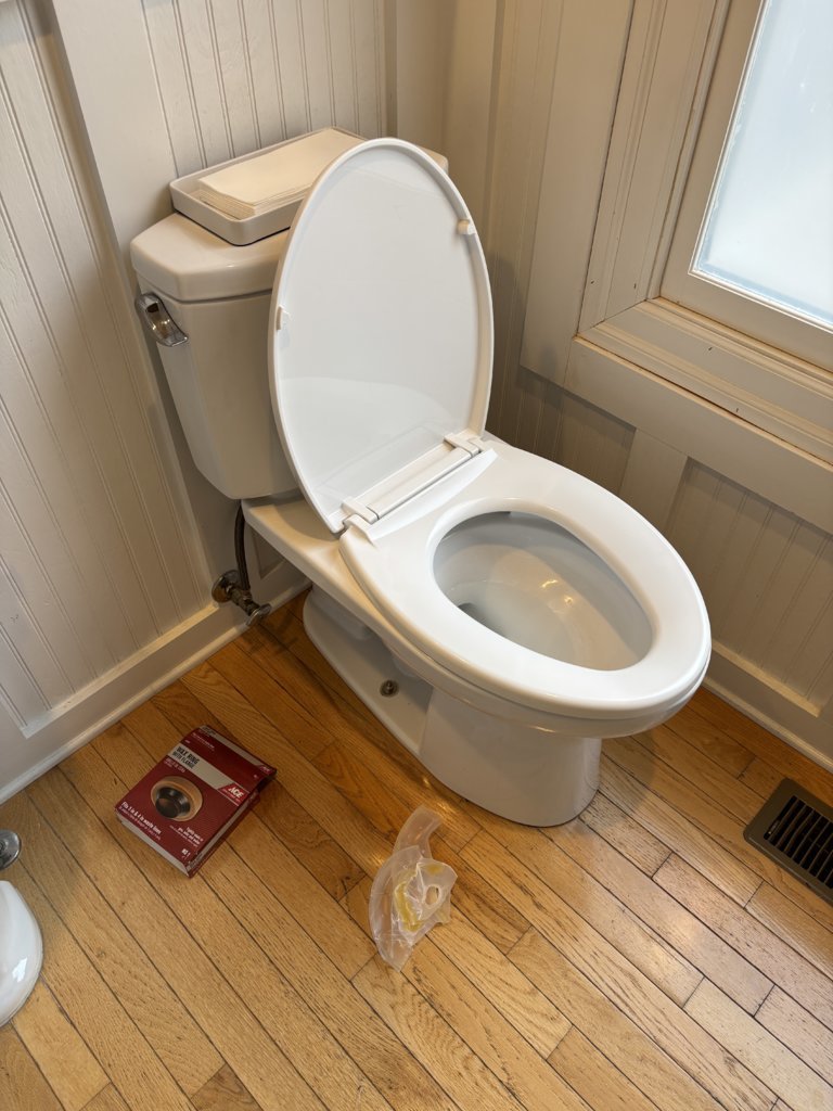

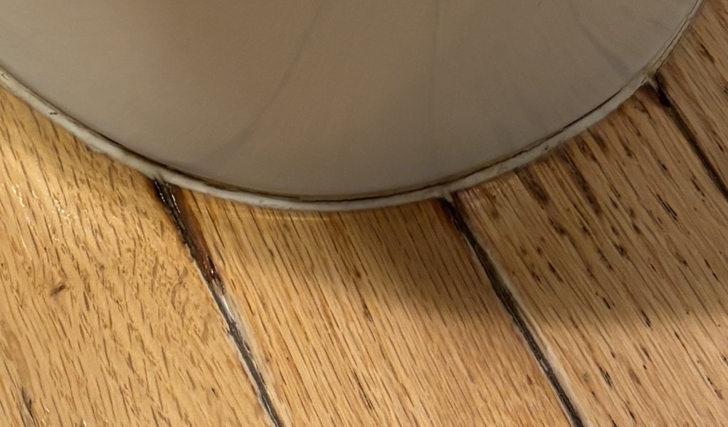

    Nah, there's water under the toilet, it's leaking forward in the seams of the woodgrain floors, and the caulk bead is breach. 90% positive wax ring is jacked, I'll be shocked if not. I'll post pics tomorrow when I lift it off, then hit Ace or big blue/big orange to get a new seal.
    This has to be recent, I do see a bit of discoloring there, but that's how far out the water staining was when I noticed it this AM. It wasn't leaking when we had a dozen ppl over here for t-giving a few days ago.
  5. Dec 1, 2024 at 6:24 PM
    164,323
    Ah, I see it now. I wasn’t looking closely enough at the floors

    I think you have no choice but to remove the toilet and check out what is really going on. If it’s an old toilet, I’d think about updating it with a new one. Minimal fix is new wax seal(s) and new water supply line imo.

    Supply line is fairly new, braided, awesome. House is hitting 20yrs and this toilet is relatively new TOTO Drake unit, about 12yr old. Definitely had some breach happening somewhere but it looks almost like a tiny amount of water was breaching over the wax ring at roughly 5 or 7 o’clock? There was a smaller-based toilet here before which leaked too, IIRC. Anyway, grabbing some plastic flat razor blades and TSP to clean the floor, then drying it out, then running to grab a new seal. Debating whether I should try one of the new “waxless” seals that costs 2x as much but supposedly won’t fail? We plan to sell the house in the next 8-10yrs and buy land elsewhere to build out as a home base so we can enjoy life.

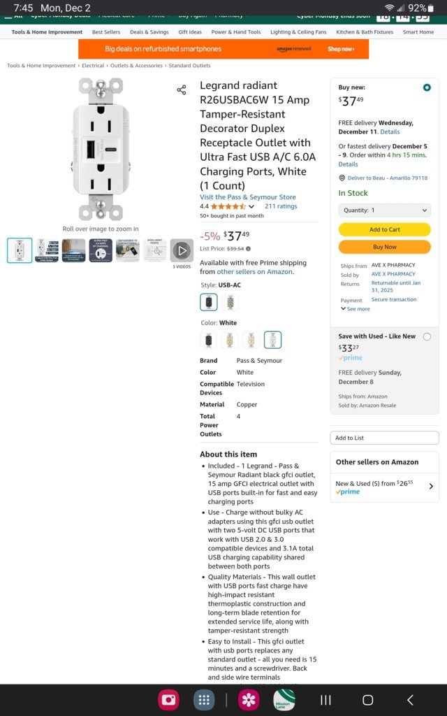

  8. Dec 2, 2024 at 5:45 AM

  9. Dec 2, 2024 at 6:10 AM
    shifty`
    shifty` Inside his chest they found ten thousand pencils
    Jun 20, 2020
    #48239
    30,642
    ATL

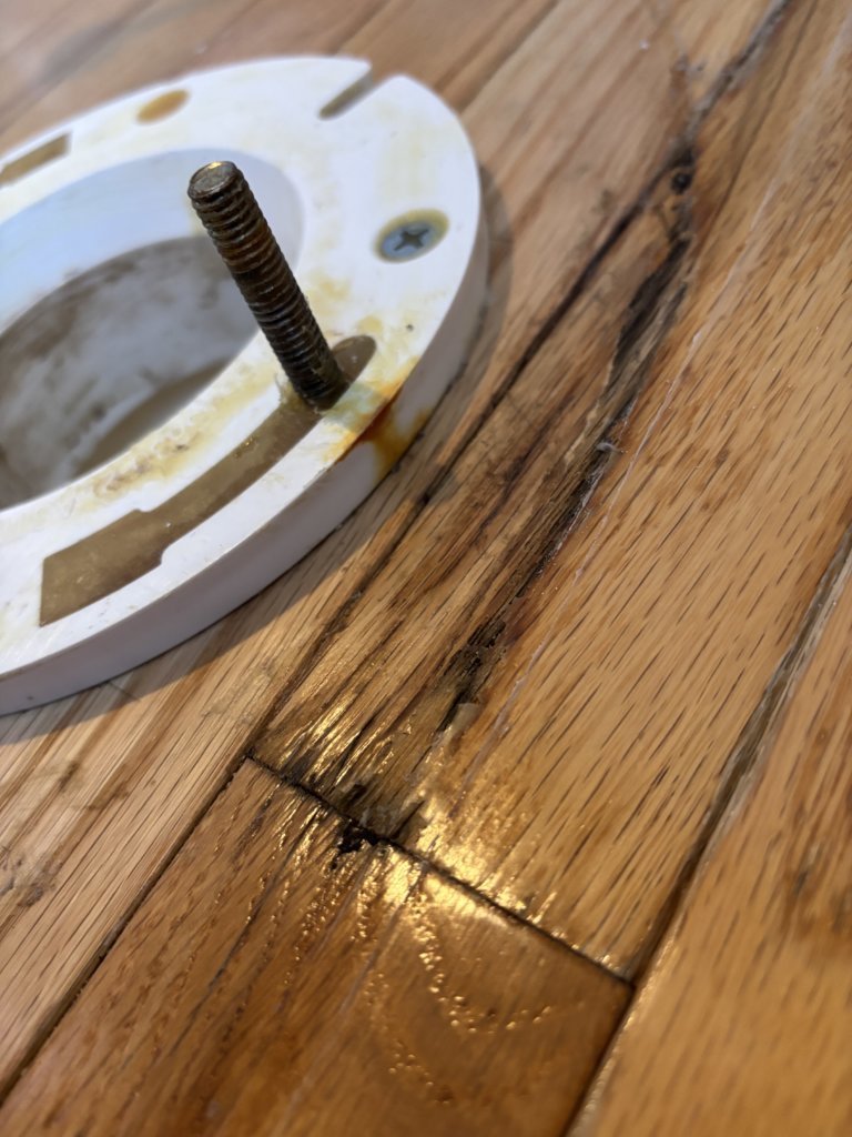

    Pretty sure this rust stain suggests the breach happened on this side of the wax ring. Bring of the water damage is on this side. Probably need to dry out and re-clear the wood. Will see, I guess.
  10. Dec 2, 2024 at 6:10 AM
    shifty`
    Jun 20, 2020
    #48239
    30,642
    ATL
    I like Legrand a lot. Aren’t they part of the same group now, though?

    I got hooked on those Korky "reuseable" wax free seals. Just too damn clean and easy. I have a few johni rings on my shelf and last time I had a leak I just bought enough Korky's for the whole house. As I renovate or get a leak I replace! The height adjustability is great for any wonky floor situation.
  12. Dec 2, 2024 at 7:14 AM

    I was looking at the “Better Than Wax” one, it’s blue. I like Korky products, overall. It’s gonna boil down to whatever the local Ace has. I always kick them business first before hitting the big box (orange or blue). Heading up there in 45. Floor almost dry now, trying to let it dry up naturally.

    Yes sir, Pass & Seymour Legrand. I just like the way their plugs/plates look. They're also a bit better on actually hooking them up. Also, I'll NEVER use Leviton GFIs. They go bad in 6 months to a year if used outside.

  16. Dec 2, 2024 at 7:41 AM

  17. Dec 2, 2024 at 7:50 AM
    164,323
    :laugh:
    I will check what brand outlets were used. We haven’t had any issues, with any outlet other than the motion sensor I had installed in the guest bath a few years back….only went on the Fritz post remodel I did. I replaced it with a Leviton motion a couple of weeks ago- good to go

  18. Dec 2, 2024 at 8:00 AM
    bmf4069
    Sep 1, 2018
    #18880
    9,875
    Beau
    TX
    02 AC sr5 4wd v8
    You can post a pic and I can (probably) tell you what brand they are. I'm betting since the switchers are P&S, the outlets are too.

    I may be in a pickle, reading through the reviews it looks like the Fluidmaster (blue one) isn't compatible with the horn on newer Toto toilets (we use Toto Drake or Drake II throughout the house, dunno if it qualifies as "newer" or not). Found some guy on a random forum saying he could make it work on his Drake II if he lubed the horn on the bowl first so it didn't bunch up. But virtually all other reviews on the big box store sites and scAmazon point to "doesn't work with Toto". Searching reviews on the Korky units, Toto users appear happy. I may just end up going with wax again, forego any headaches. I've set enough bowls in my lifetime to have a feel for it.

    For S&G I grabbed the Korky and a standard wax ring, knowing I'd be back if the Korky sucked. Where the Korky waxless should intercept the horn, it's not suitably sized, and using the thinnest foam, the toilet is unstable as shit, even while sitting on it, and I'm not risking cracking the flanges on my toilet on a gimmicky product that appears incompatible. So back in the box it goes for return. I'm running with wax.

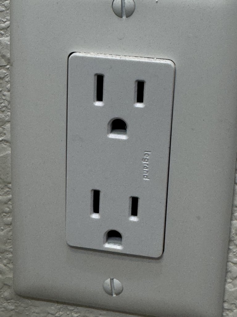

  24. Dec 2, 2024 at 11:00 AM
    164,323
    It’s LeGrand
  25. Dec 2, 2024 at 11:04 AM
    bmf4069
    Sep 1, 2018
    #18880
    9,875
    Beau
    TX
    02 AC sr5 4wd v8
    And decora! Look at you go fancy pants!

    Back in the shittin’ business again. Will go with my gut next time and skip the newfangled crap; what a waste of gas and time. These Toto toilets flush way too good to bail, just gotta deal with weirdness of Thor bottom half. Although I gotta say, this system to mount toilets is nonsense. You’d think someone decades ago would have created a no-brainer system you bolt to the floor and slide the toilet over which didn’t rely on the use of wax or foam to seal it to a drain, and was easier/cleaner to replace, or better yet was such a solid system that failure was virtually impossible...

    It’s just this Toto toilet. The horn underneath is not only thicker rimmed, but is also slightly elongated. Everything I’m seeing online says you can technically make the Fluidmaster or the Korky wax less work with my toilet, but you’ve got to do one of two things: lube up the horn before laying it over OR hit the horn with alcohol so the gasket will stick to it; then l stretch the waxless ring gasket over the horn, then try to drop it on the flange with all the holes lined up.
    I tried it with the Korky a few different times/ways, but the sad fact of the matter is, due to the thicker and non-round horn flange on this toilet, the thing got so distorted that I highly doubt we wouldn’t see a leak, and I’m not wasting $15 on something I need to finagle that hard that may leak, esp when a $4 part I’ve been using for decades just “works”, yknow?
    I dunno. I believe the Fluidmaster and Korky probably work awesome with other toilets, Kohler, American Standard etc. this Toto Drake elongated is an awesome toilet, and I guess old school ingenuity is what works with it?
