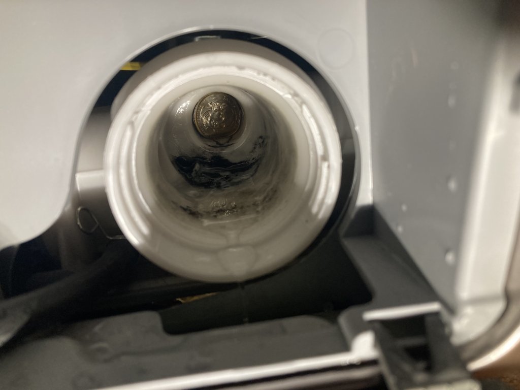

    Got a text today from mama bear today; the washing machine errored out on some rinse error. So I knew I’d probably need to clean out that thing that no one ever does……
    Brought in the Milwaukee pack out vac and started sucking out the bottom port bleeder tube, I got about 3 gallons out.
    The filter thing was full of “stuff” but I decided to peak down the dark hole………
    Gold dollar fully blocking the pump intake!!!!!
    Got some mechanics picks and gently worked it sideways and pulled it out(it was actually stuck pretty solid!)

    Score!!!

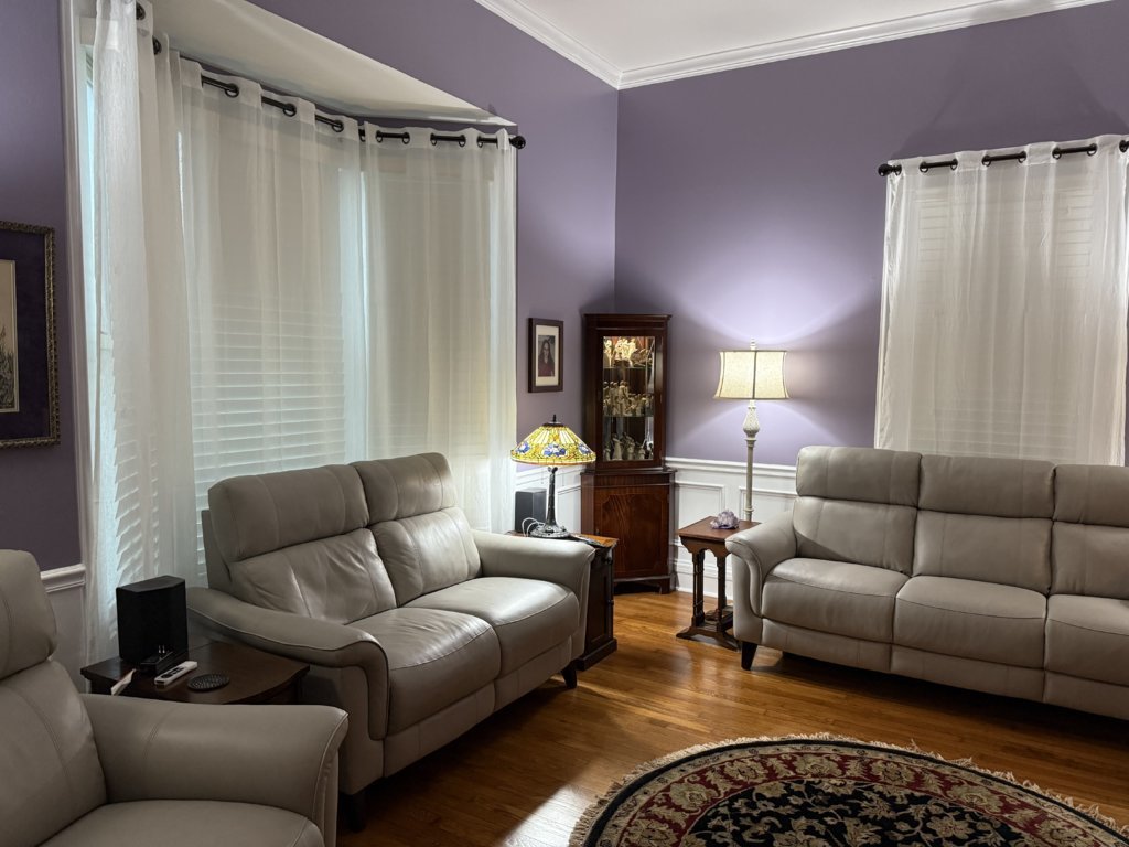

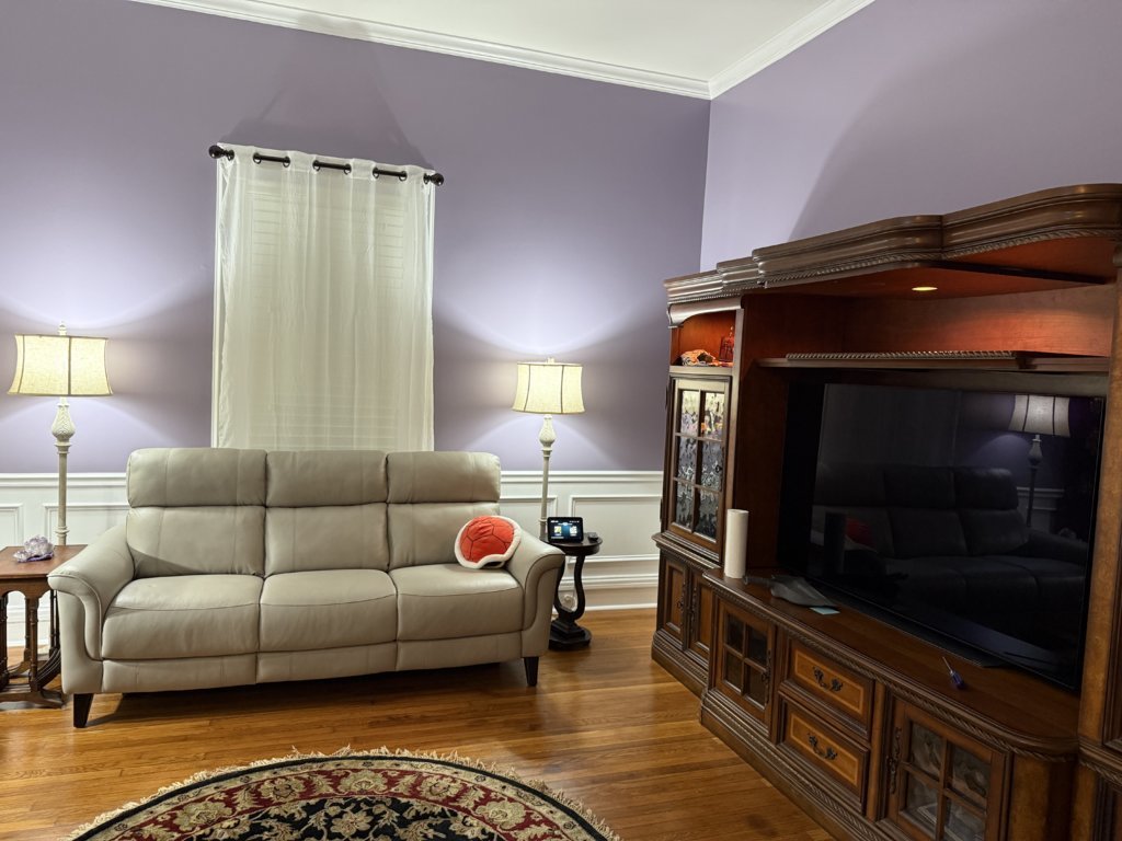

    Finished painting and put the furniture back. Now I have to hook the electronics back up again and life will be good.

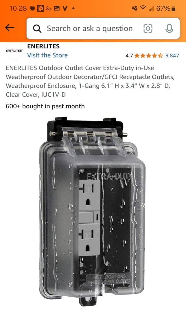

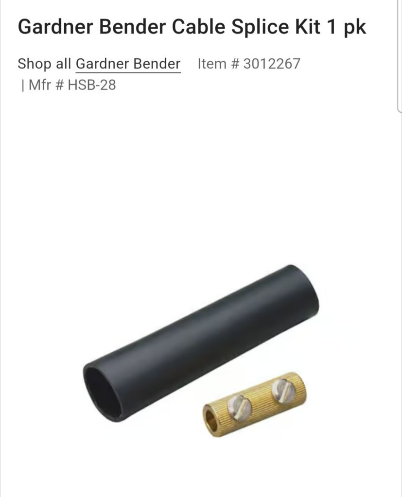

    The ground I can pull up and re do it or would it be suitable to splice at the post base with short liquid tight whip with a weather tight gasket box or better off useing water tight lug style with a shrink band?
    the channel work I thought would be ok in combination with a j box and weather tight receptical cover suitable for wet locations or should I pull the post to and re do it with UF?

    So yeah, if this is an underground run in PVC, it's gonna fill up with water. The heat from where it's exposed and the coolness of the underground creates condensation in the pipe that'll eventually fill it up. It'll eat up the outer jacket of the Romex. Use UF cable instead, either direct buried or in PVC. If going building to building, my preferred method is a J-box on each side with individual THHN of whatever size you need.

    This. Romex is a bitch to pull through conduit. Even UF cable sucks to pull in conduit, but it's the new code for residential floor boxes. Also, any outdoor boxes should be bell boxes or similar wet location rated.
    Do you have better close up pics of the boxes? They make underground splice kits, but I don't recommend them. You'd have to dig about a 1 sqft hole to be able to work it, and it would need to be 24" deep minimum to be code compliant. That cover is an in use cover that lets you shut it with something plugged in to be wet location compliant, but you need a bell box to mount it to.
    Oh, and stay away from whatever that splice thing is. That's not UL listed for direct burial.

    Thanks for the clarity, I'll pull the post and homerun UF the entire way box to box.The ground is still soft so I'll do it this weekend.

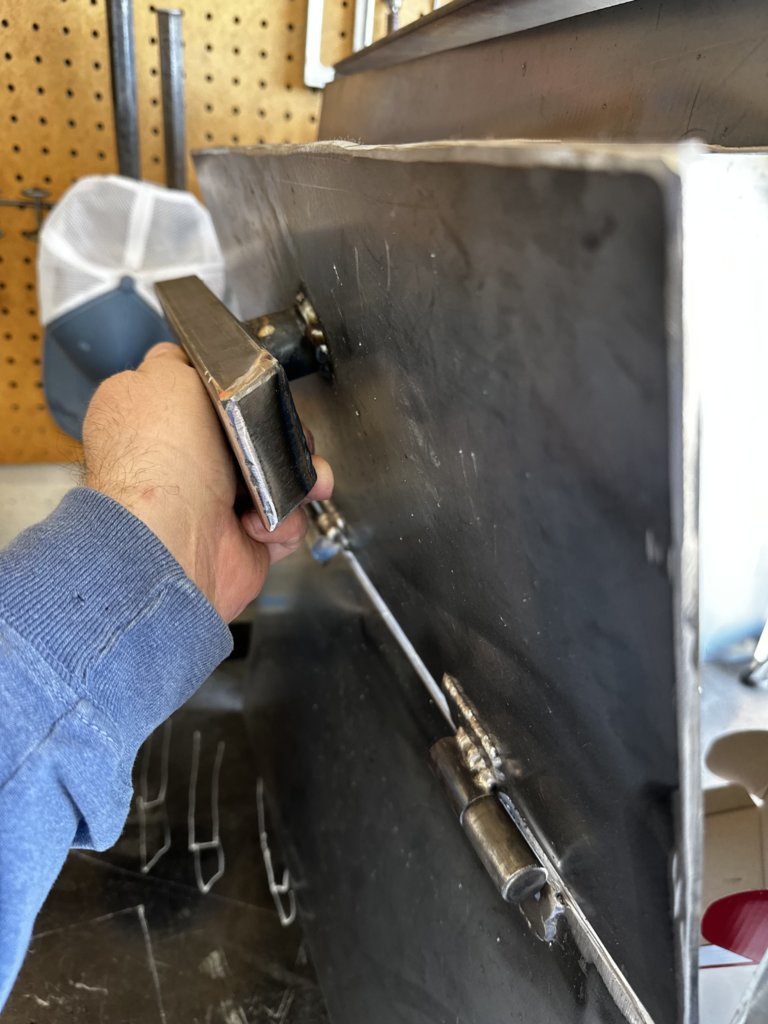

    Made the front of my new mailbox today. Ran out of shielding gas. That sucked. A tank fill and 11 lb of wire was 118.00.
