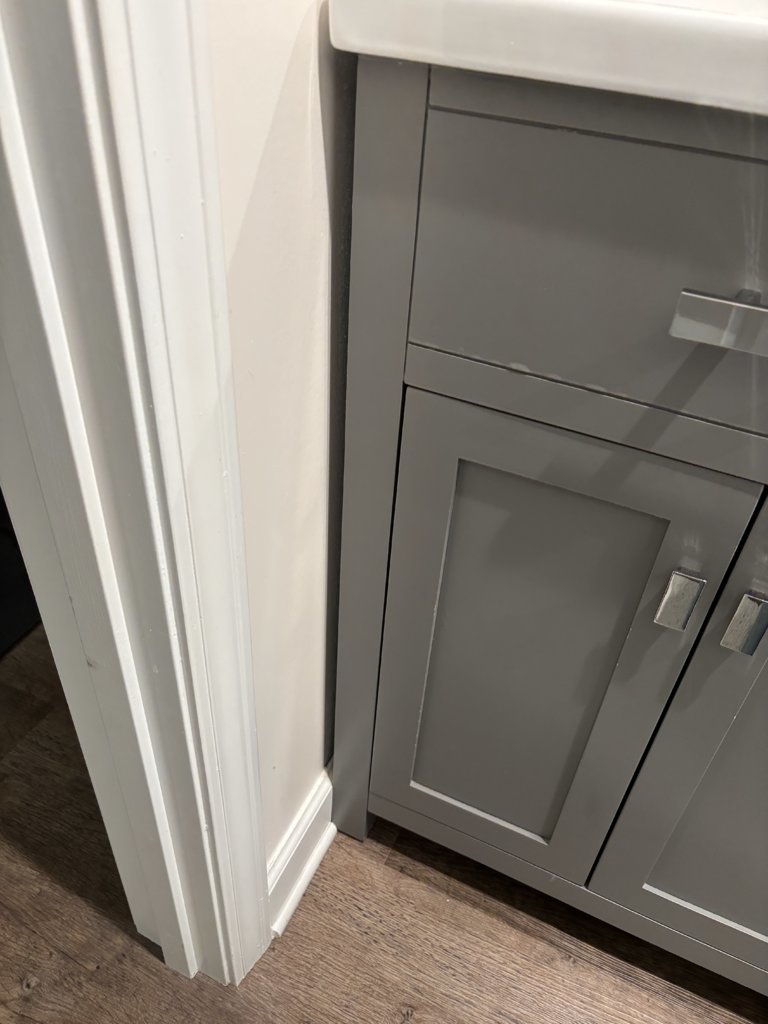

    Similar issue with our downstairs bath. Installed it when I built out gym for my wife. Only in our case the pre-fab cabinet has an overhang for the countertop. So I had to leave the baseboard in place and trim the quarter-round to get the spacing somewhat normal looking.

    I removed the cardboard, but its still not perfect....maybe some new caulking and I lean against it to hold it where I want it?
