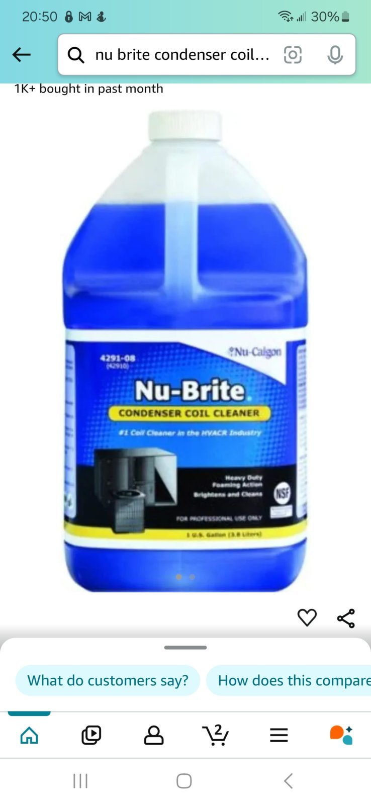

    This is great stuff for your condenser, 5/1 ratio one gallon will get you two seasons.
    Like mentioned earlier turn the unit off and pull the 5~ 3/8" screws out,this will allow you to pull and tilt then lay the fan shroud with fan motor on top of the unit. Cool the condenser coil down with just water and make sure you adjust the flow to a semi cone spray with the water because with to much force you can bend the fins and you don't want that.
    After that spay the coil down with the mixture, the outside of the coil with a 2.5 gallon spray bottle.
    Let it sit for a minute or two and it should foam up and pulling all of the dirt,debris and pollen or what ever you have in your region out,then use your garden hose and spray the coil, start at the top and work your way down keep in mind from the inside,this is why you removed the fan.
    Here in the NE. this is done mid June after most of the pollen has subsided.
