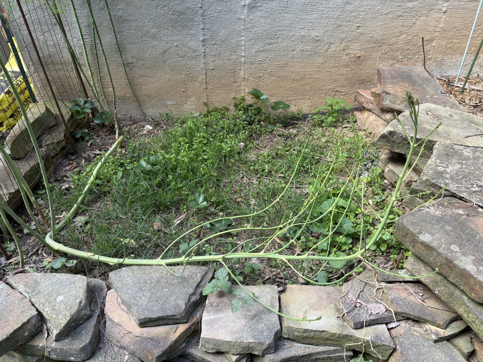

    Was drawing up plans for a raised bed expansion earlier as part of next week’s list of chores, making more room for fruit vines instead of just produce. Anyway, keep getting a chuckle out of this mutant asparagus in our asparagus/strawberry bed, it started out thicker than a half dollar coin, then grew 3+ feet in a couple different directions. Totally nuts.

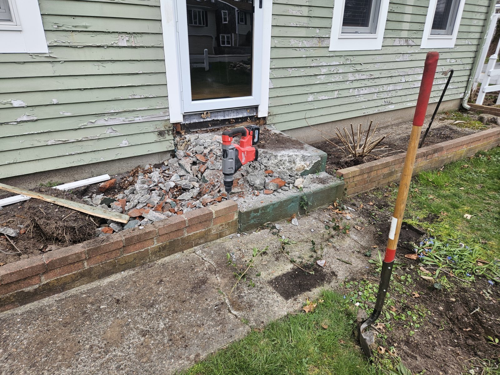

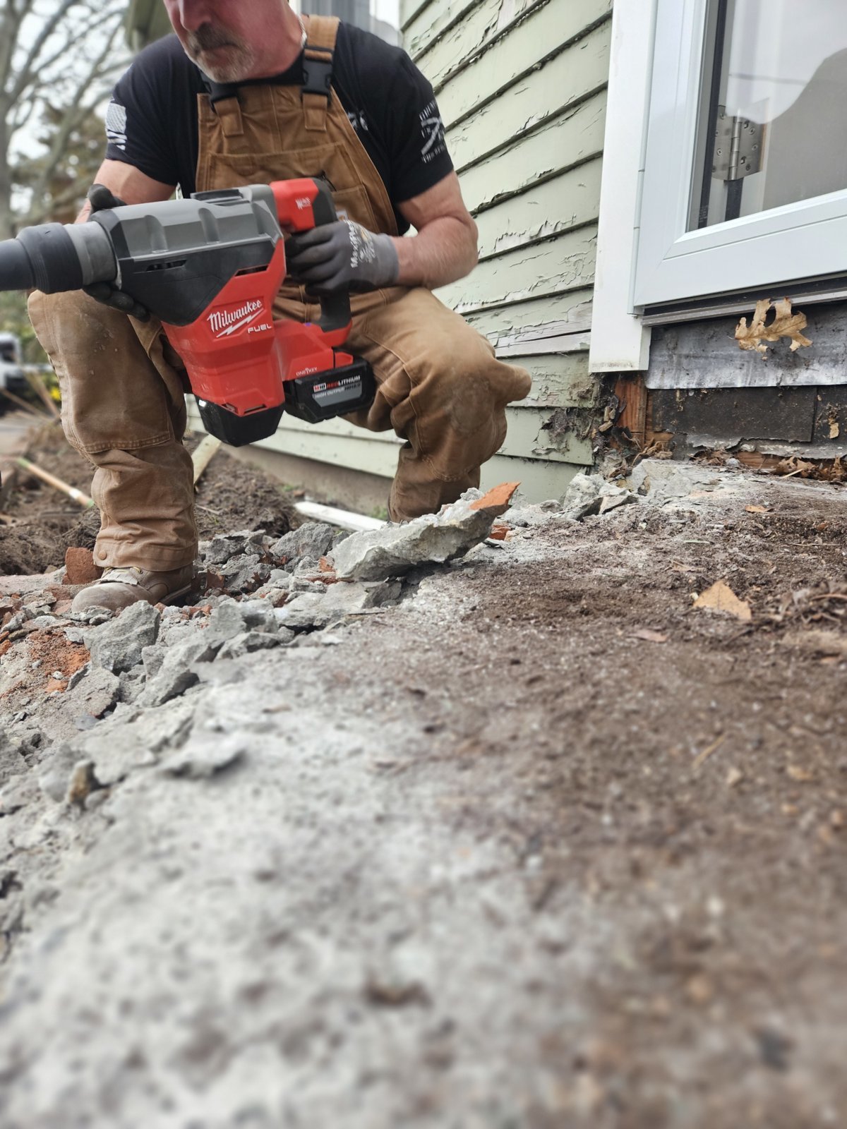

    With half a day off good weather I was able to dig up and remove an old cedar stump and a couple of shrubs.
    My Buddy wanted my front steps so when I took the steps down I pulled out all screws, bolts and nails so it'll be easier for him to re purposes it.
    Then it was hammer time.

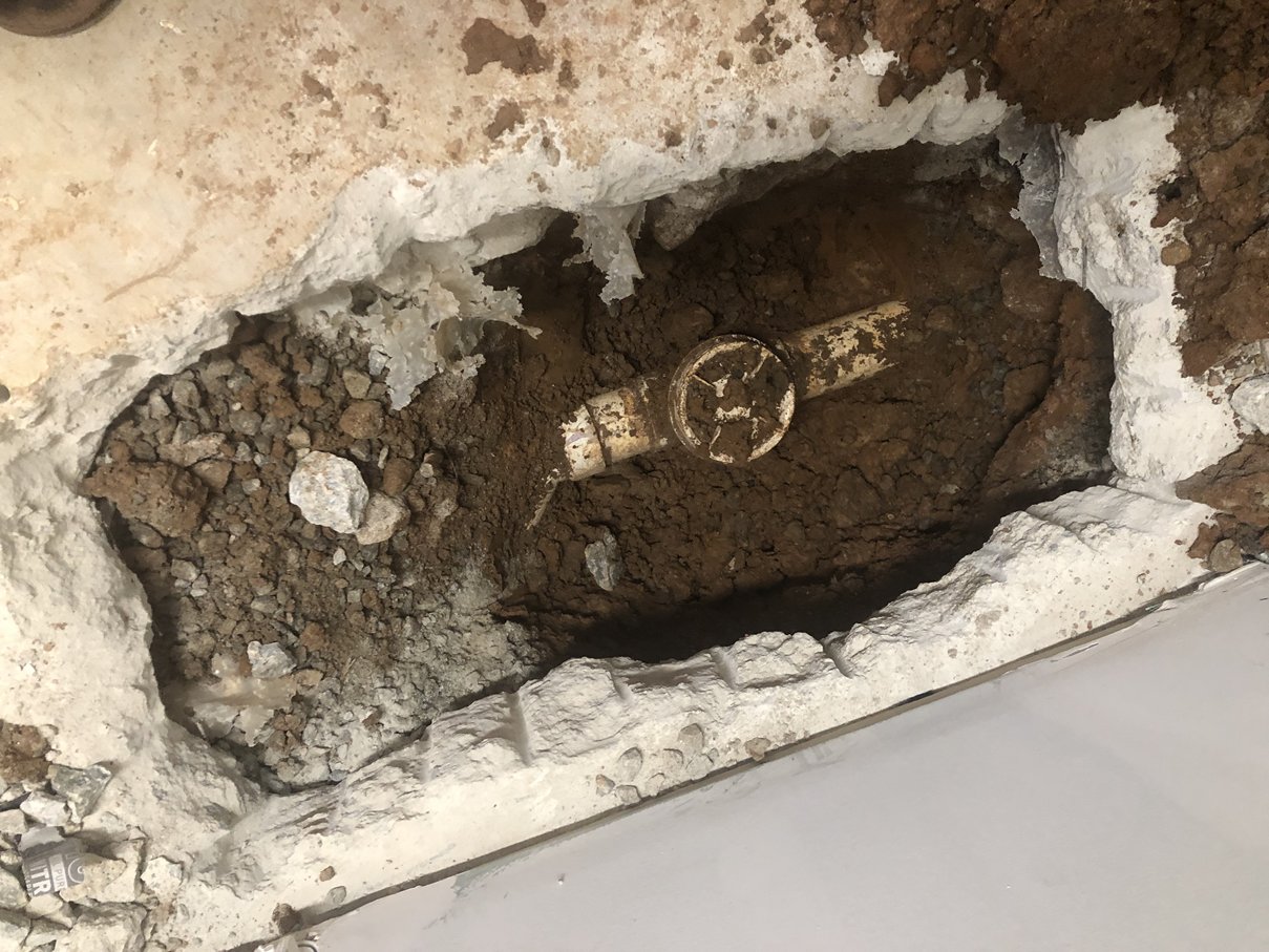

    Those team red hammers work great. That's what we used when we realized water wasn't flowing out while remodeling the basement. Quick camera down the drain showed the assholes who built the house 20yrs ago installed the backwater valve backwards when they stubbed the basement bathroom out.

    Some people are just priceless...

    Not sure what voodoo Milwaukee discovered with those, but I've never used a hammer drill quite like it:thumbsup:. Like a hot knife through butter, and very good isolation from the vibes. Mine is a click or two smaller than that behemoth :rofl:

    :eek: wow.
    It still amazes me what I find from "Professional Contractors" :rofl:

    It's pretty amazing what that thing can do, going through that concrete and rocks like nothing. The handle has an 1.5 of spring loaded recoil movement that absorbs a majority of those tuff spots, it feels like an ordinary hammer drill but with good weight, maybe 30#.
    The downfall is it drinks batteries like a fish I had burnt through 3 of them in about 1/2 hr.and there 12.O lithium but better than slinging my 20# hammer and risking breaking the storm door with debris ricochet all over the place.

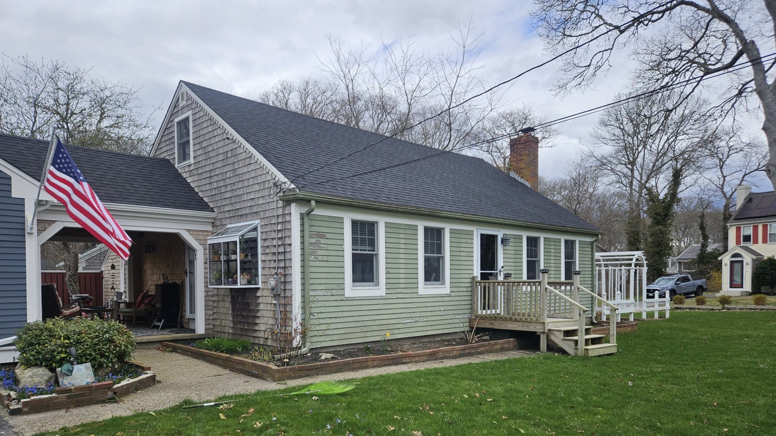

    Whoa, I have only use mine for a small amount if demo... that's a hungry tool. I've run a P-90 (90# jackhammer) for a week in my 30s and it will kill you or make a man outta you.
    I'd ice shield that entire (lower pitch) roof over the front porch addition. What's the pitch on that like 2.5 - 3? Up here in the frozen tundra anything less than 4/12 is not ideal.
    That's going to be a nice space :thumbsup:

    Thanks Bro!
    I forget what the model # of it is but worth it's weight for sure.
    All honesty this is a project I tried to launch last year and all of my friends of merit were tied up,so it fell to the back burner, well until we got engaged.
    We are having our ceremony at the house so I've amped it up on getting projects started & done by June...
    There is no moss on my heels.
    So yeah ,I pulled the trigger and having it done professionally to shave off a little coin I'm removing the little decking and stairs which did save me a lot.
    The deck will be 8.5"X40' with 4 columns it'll be wide open and just above grade height this way I can avoid railings and Bannisters,I wanted and open feel to it without restrictions of railings and such.

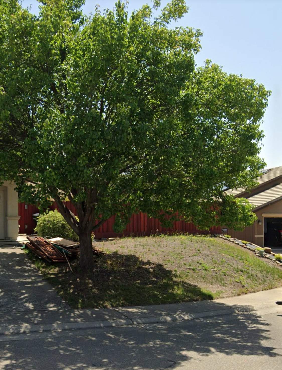

    This weekend was landscaping weekend. I still can't believe I got this much work done. We are days away from listing for sale.
    Before:
    After:

    Man your an animal!
    Nice contrast & very open the fence color makes it pop!
    Nice and clean looking!

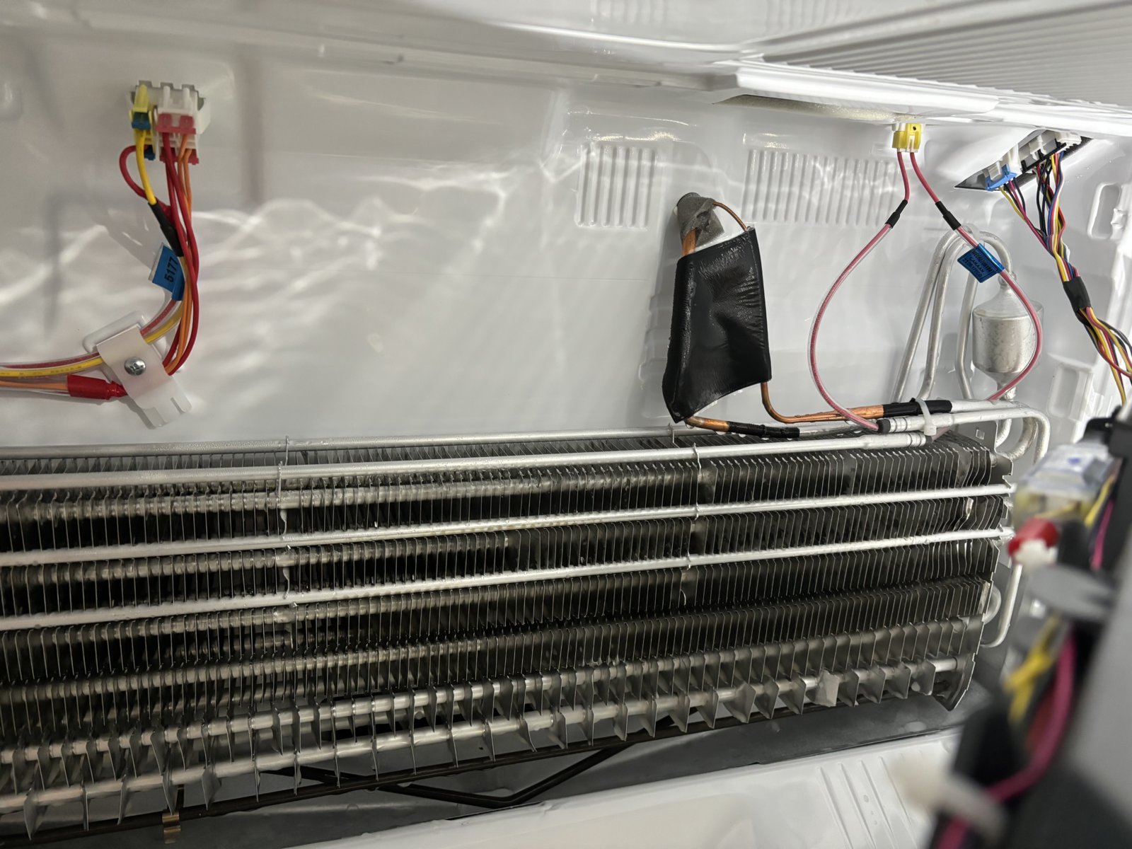

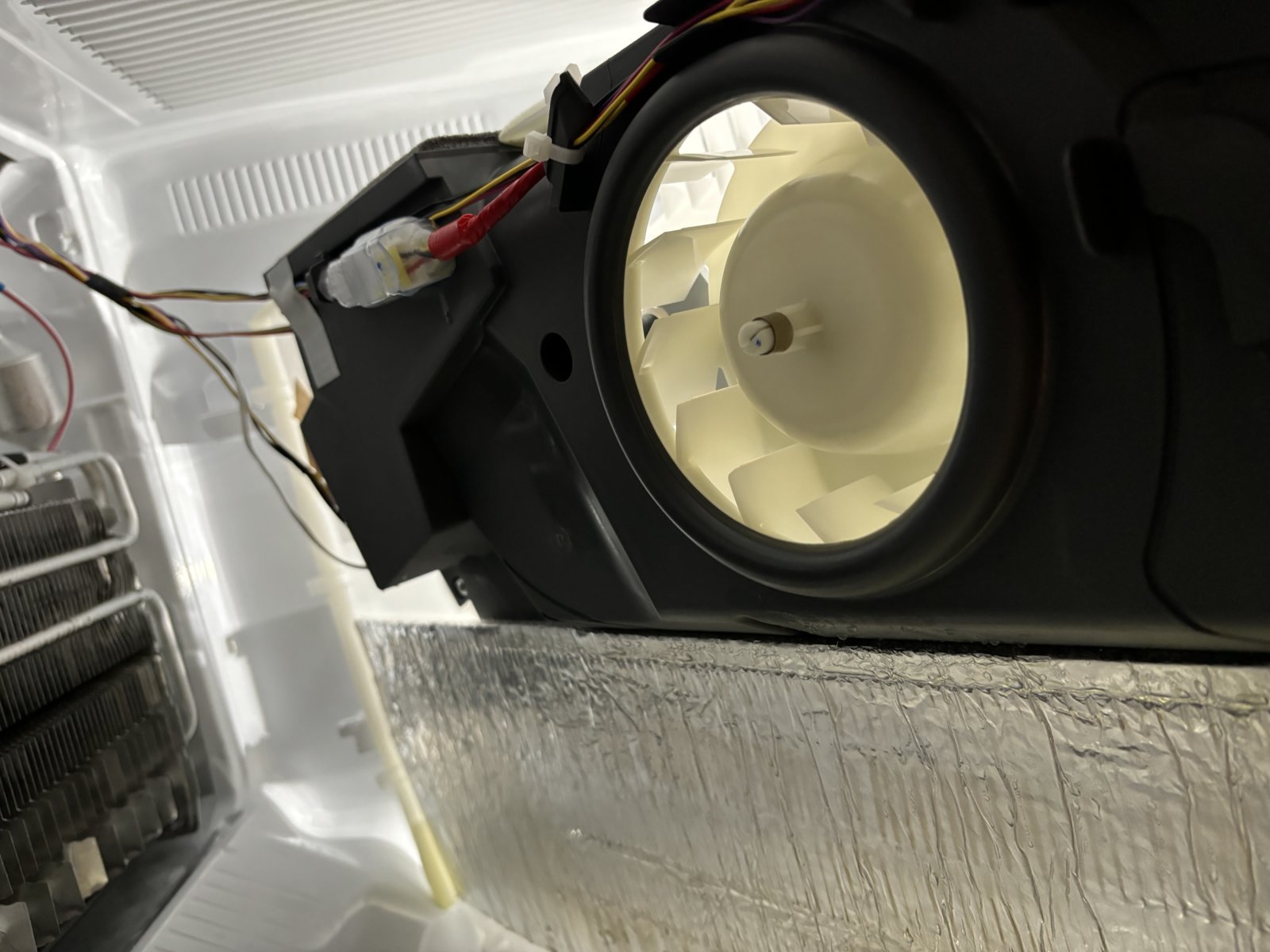

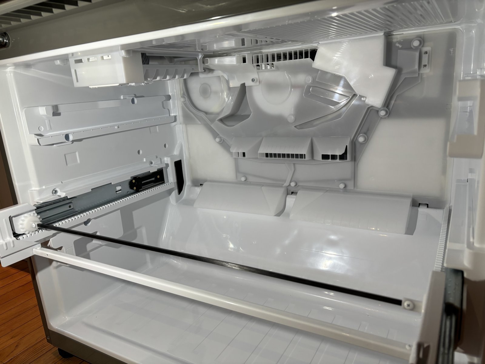

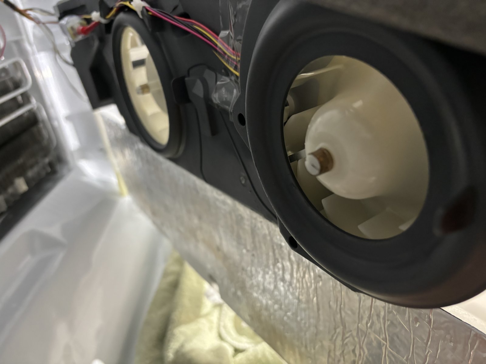

    Had to rapid defrost this SOB today. At least that’s what our new-ish (4mo old) LG fridge was telling me. But when I pulled the shelves out of the freezer and popped off the back wall, there was virtually no ice anywhere. Why the hell is it throwing a 1F / IF error then? Supposed to mean a fan for ice creation is iced up. Got it double warranted (never used LG appliances, just their TVs, got tired of repairing the 20yo Frigidaire) so if it happens again I’m calling it in. Y’all see any ice in here I’m missing?!

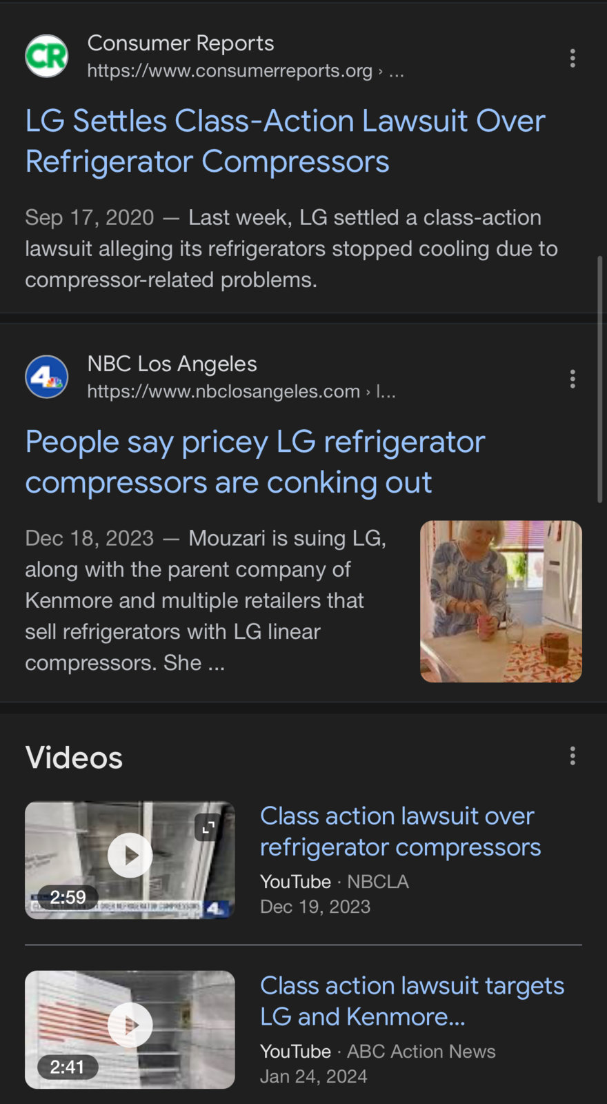

    LG. The worst. That stupid linear compressor or whatever is notorious for failure.

    Could also be the board itself failing

    Yeah it's so quiet because it's dead....
    All kidding aside looks like the evap froze up and probably caused ice to imped one or both fan's to give you that error code.
    Like T Rex mentioned could be the board not reading the temp bulb properly.
    I dunno not there so I'm shooting from the hip.
    You bought the warranty so definitely use it,you'll spend some time on the phone unfortunately you're going to explaining it several times to multiple people.

    The second and third Pic shows ice build up that's no bueno.
    Defrost cycle it is a timed event & scheduled where it reverses the roles the evap becomes the condenser and the condenser becomes the evap.
    I don't believe it has and additional time clock which leads me to believe it's on a separate board.
