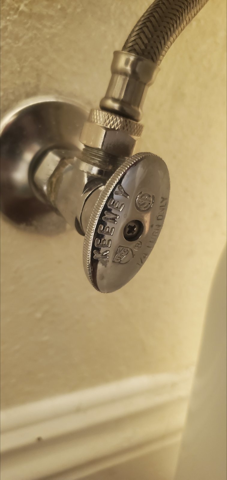

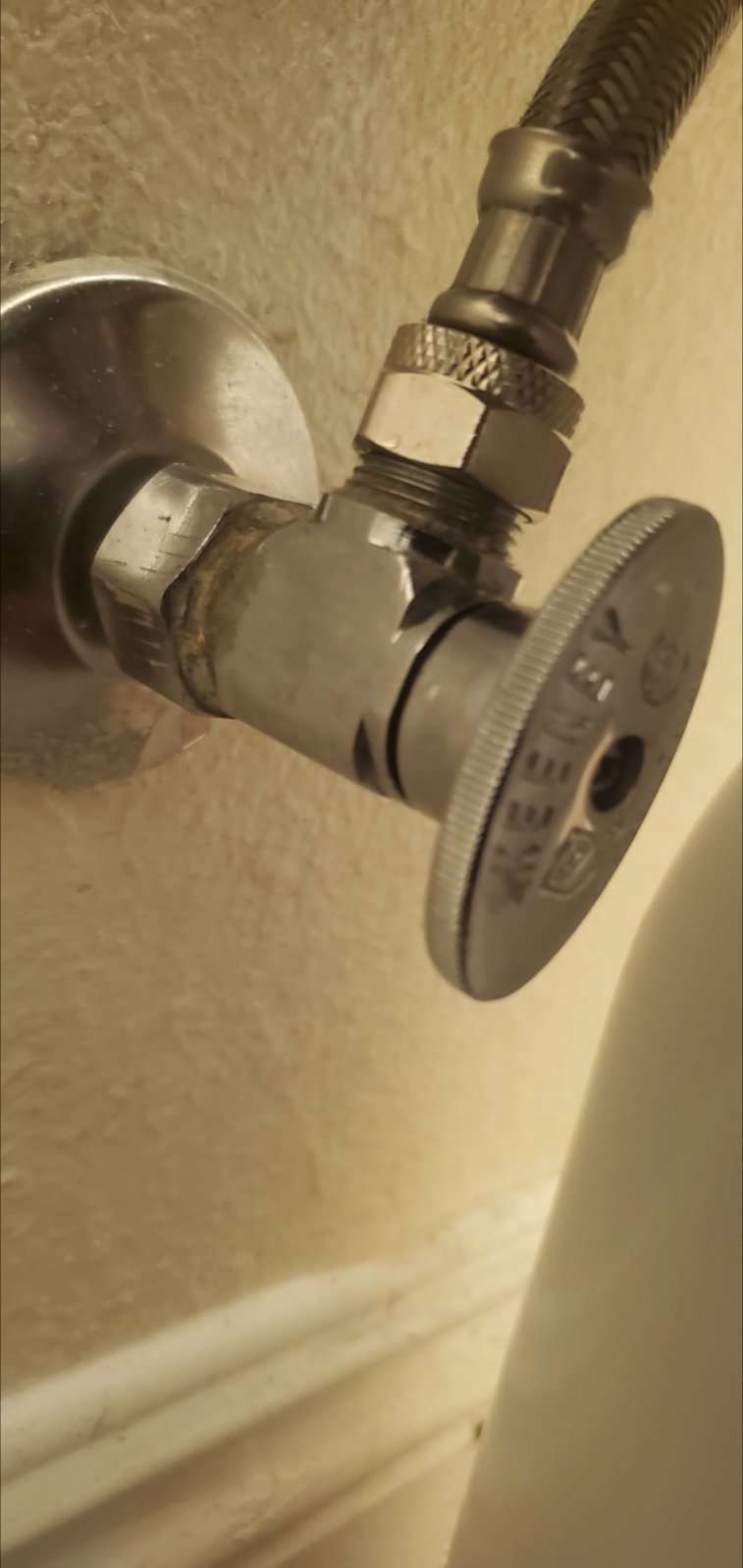

    Rebuilt my 3rd and final toilet this morning... Flush valve started leaking and you could hear the toilet running every 5 to 10 minutes. My 1st one let go while at work, wife had to turn off the water to the house. I bought all 3 kits at that time and have rebuilt all 3 in 6 months....
    Anyway the shut off valve is seized?? or am I dumb ass since I can't shut it off, so I bought a sharkbite valve shut off and it doesn't seem to turn. The other 2 valves were easy so I'm at a loss...

    Depending on how old the shut off valves are and how much corrosion/sediment are in them (hard water?), they can be very hard to turn. I try to remember to shut mine and reopen a couple of times a year to keep things freed up.

    Don't seem that old, but I tried hitting it with a hammer on both sides and did not give.. I have everything to replace the valve, but I can't turn this thing in my hand, which is why I'm asking. Not as smooth as the other 2.

    I think they sometimes are stiff like that in the beginning. Can you hold it with a clamp and then really rank on it? Open it and close it a few times to see if it starts loosening up a bit.

    See if you can get a wrench on the handle and apply some pressure to close and open.

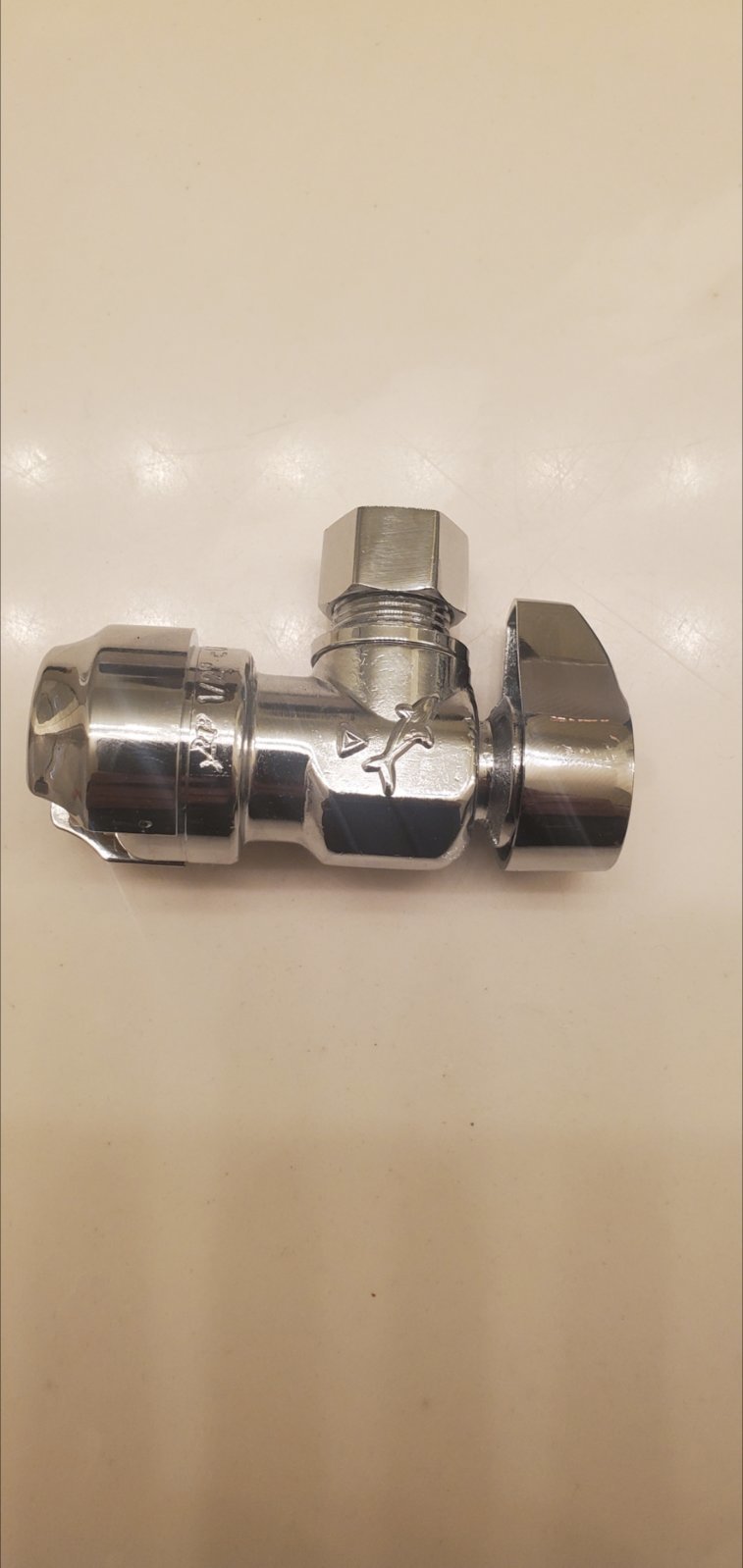

    Got the new one to turn, thanks for the advice. Old one still not budging. May need to do this later today as my big kid is up.
    Here is some occular pleasure.
    old valve still attached
    New one pending me figuring it out.

    Took this advice and has been successful. Blunt force is not always the answer I guess.
    Thank you guys for the help. Will be working this handle all week, so it doesn't seize again

    I saw you got it but you can also easily replace that valve without the Sharkbite.
    Grab a new compression valve, unscrew the old one, and screw the new one on.

    Even with it seized, it's hard water coming through so assuming at a certain point and time the valve will need to go. Been youtubing on how to go about it. Lowe's options were very limited with options.

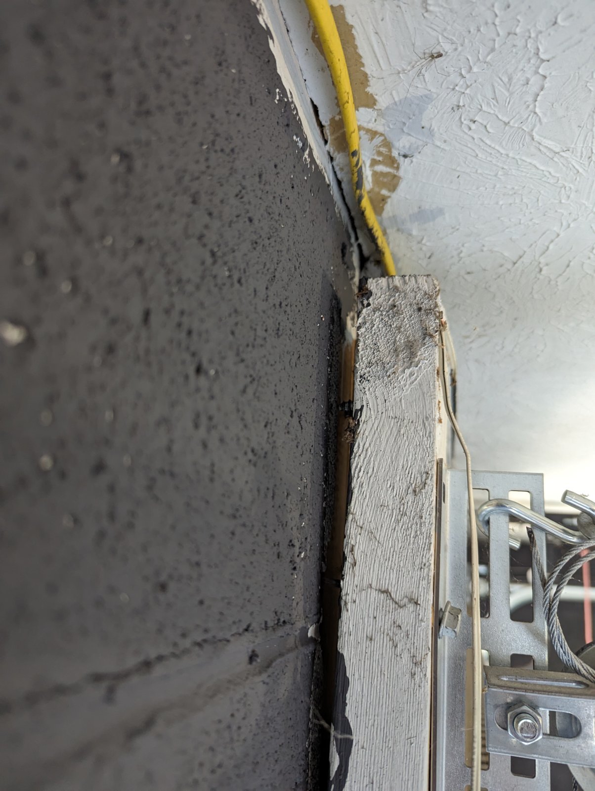

    Do we have any garage door experts on here? We have two garage doors and 3 out of 4 2x4" holding them in place are bowing out at the top. One is worse than the others.
    I tried driving new screws into them with no luck. It started cracking rather than actually close the gap.
    I've had my wife close/open the door while I watch and the gap doesn't change under load.
    Is this something I should worry about?

    I'm not a fan of sharkbite type valves. You also have to be careful with heat when sweating valves. This is a good option and then use a threaded valve.

    Are your bolts longer than the thickness of the wood? If so then the screws/bolts may be pushing the board away from the cinder block / concrete wall. If you are trying to keep the wood flush against the wall I’d think about not using long fasteners.
    The garage door metal has to be fastened to the wood and the wood has to be separately fastened to the wall imo. Use a metal brace to secure the wood to the concrete, Use concrete inserts that expand for the bracket fasteners. You have to drill holes in the concrete for the concrete inserts.
    That is assuming the wood is still ok. Was it pressure treated as moisture seems to permeate concrete.

    It looks like the block stops and behind it is wood framing. So the 2x4 is screwed into wood behind it. At least up top. I'll take another look at it and see what my options are. Thanks for your response.

    I would agree didn't really feel comfortable with it, but since I was able to move it turning it off/on, I'm no longer replacing it. unless a real serious problem comes from it, then I will change it to something more appropriate.

    It appears to me that the 2x4's have dried out and bowed and should be replaced. They won't get any better and could get worse. Just my opinion and $.02 cents...
