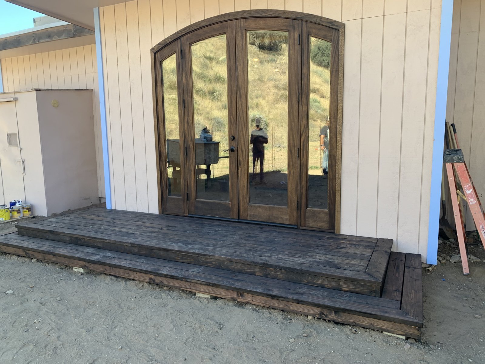

    Beautiful doors! Are you also replacing the siding? The doors vs siding is like an oxymoron.

    Tell me about it. They renovated their whole interior including windows, but couldn’t sway them from the T1-11 siding they have. Most of their budget went to the kitchen and baths. We cleaned it up the best we could, replaced a few panels and painted.

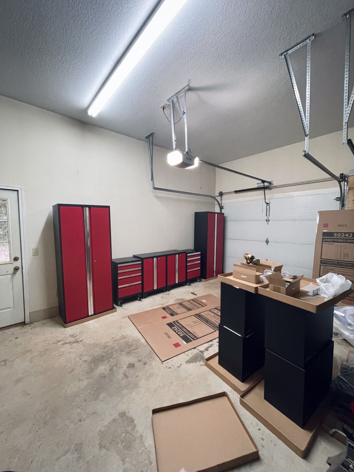

    Finally got my NewAge cabinets in. Shipped on a pallet that was about 650lbs but it was packaged so well. I was very impressed with them. Started mocking it up, still need to mount to the wall and put up the cabinets. The garage has ancient fluorescent lights so have a couple 4ft led panels that i need to install too. Eventually will put down some flooring too.

    I bought 8ft LED bulbs to replace my ancient fluorescent lights. Had to bypass the ballast but light is much brighter and no annoy ballast buzz.

    OK, at first I thought they are your doors and you were going to put in another $14,000 set.

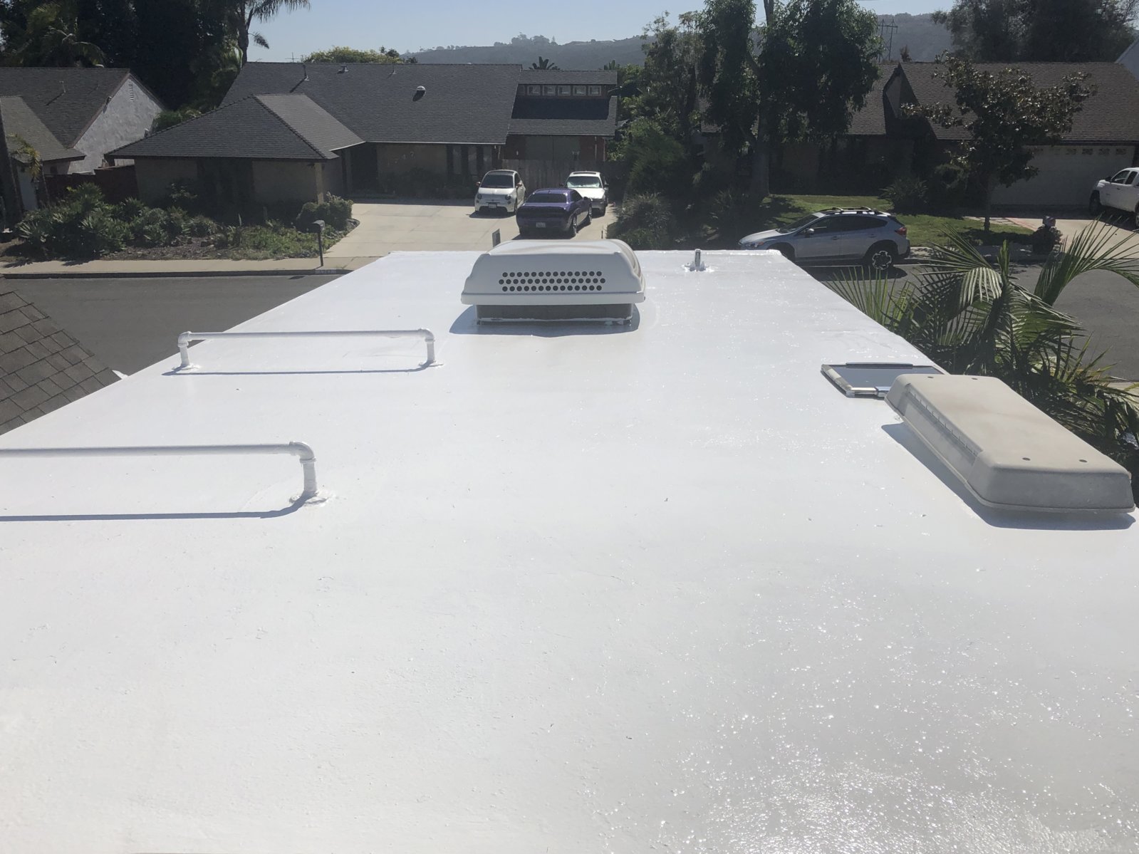

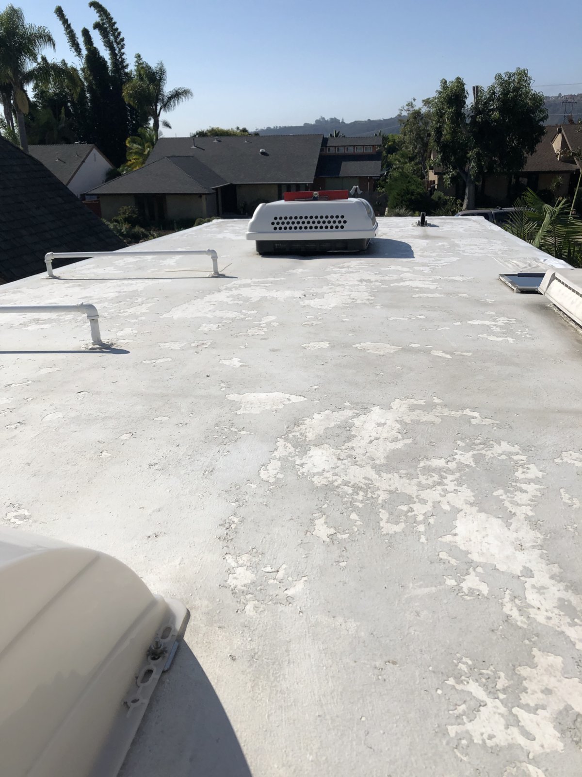

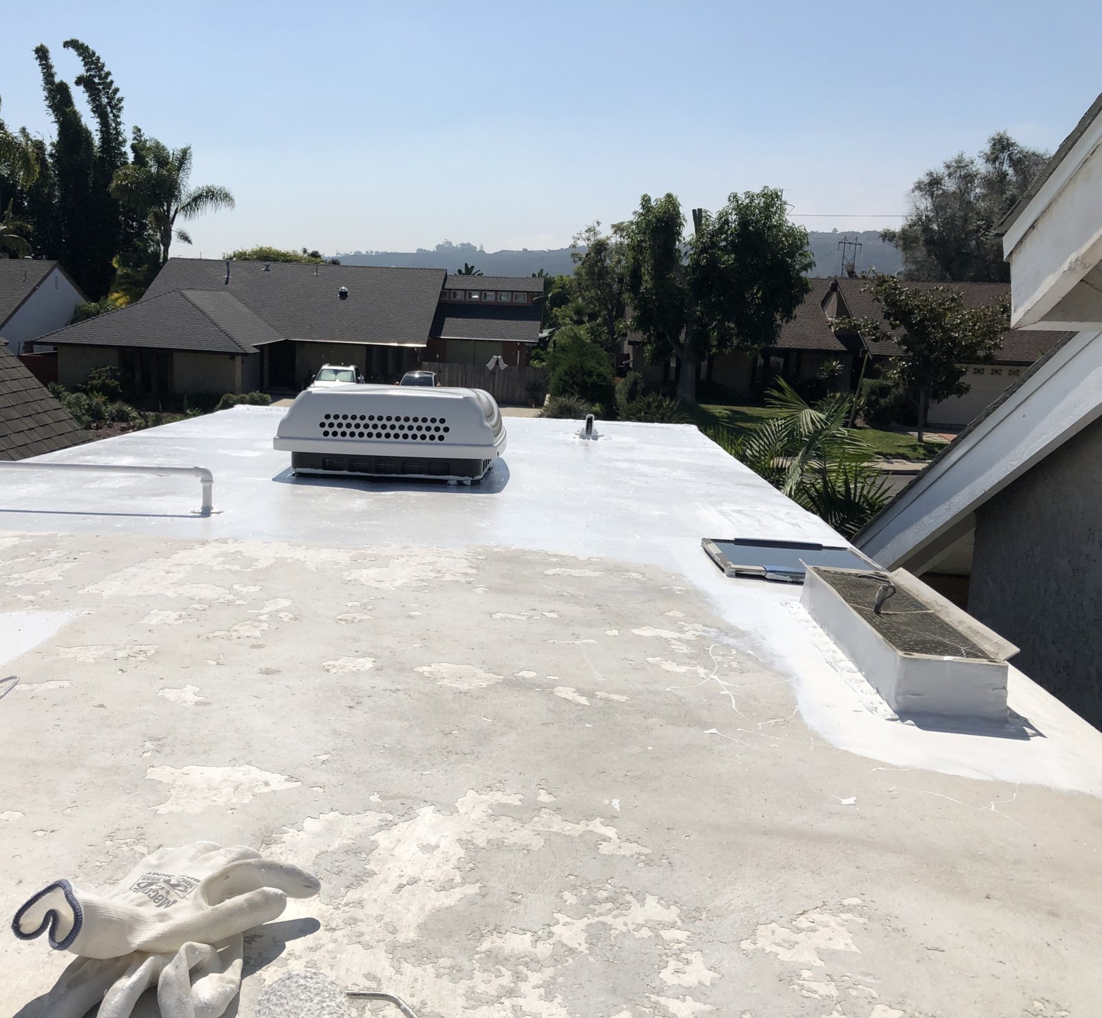

    IMG_4953.jpg IMG_4940.jpg IMG_4937.jpg More of a motor home improvement. Preventative maintenance, no leaks. Re-sealed the entire roof. 3 coats on perimeter and around vents. 2 coats on the main roof area. Not perfect and still need to do some cleanup. But wayyyyy better than it was.

    That looks great! What product did you use? And how old is the RV?

    I love my new age cabinets. One of my better purchases.

    Guess I need to find a better job geez. $14k I could Reno my entire kitchen and get the last of my windows doneAND a new front door lol. Looks great though!

    Thanks! I only got paid to install it. :rofl:
    And this is only the back porch!

    Holy smokes that's just the back door,the back door to what the Tajmahal?
    Lol, but that door is incredible.So what's the Sq footage of that house,so that can absorb something of that size?

    Yeah, but that siding…

    If we did the siding, we would have renovated her entire home. We highly suggested replacing the siding, she just didn’t have the budget, but wanted these doors to remember her late woodworker husband. Trust me, we all hated the siding.

    At the end of the day, if the client wants lipstick in a pig then that’s what we try to give them.

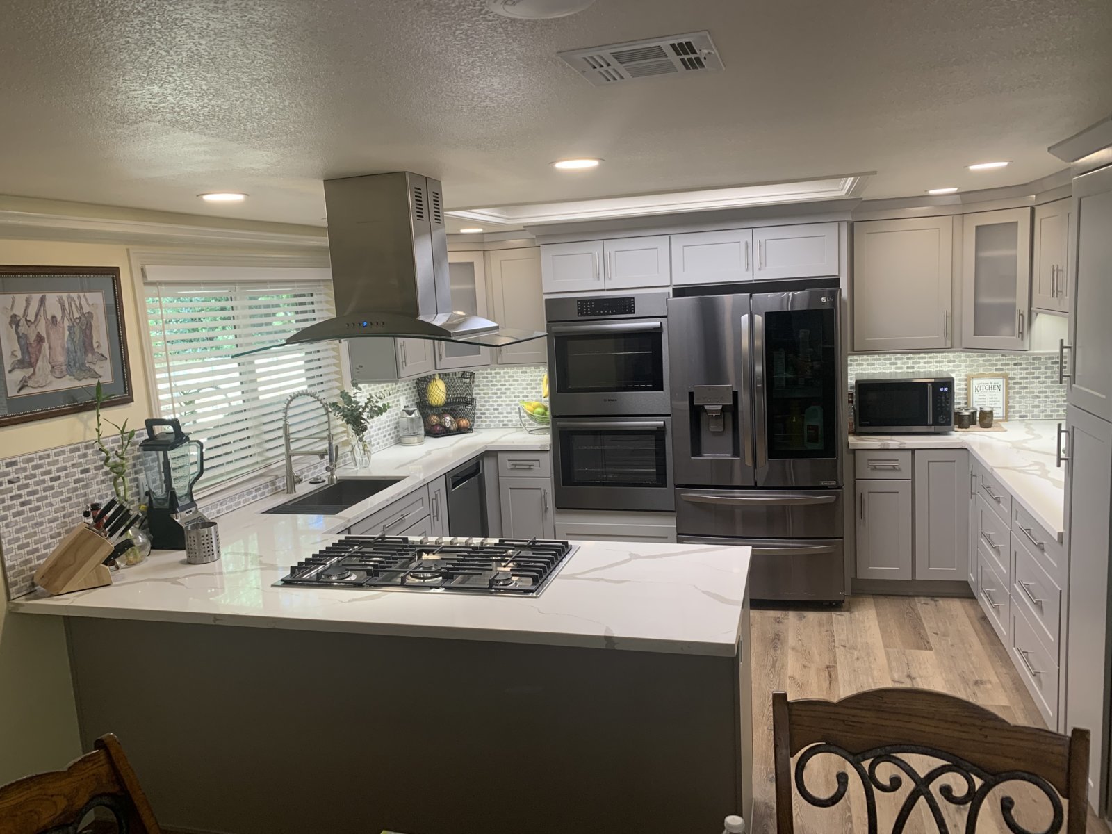

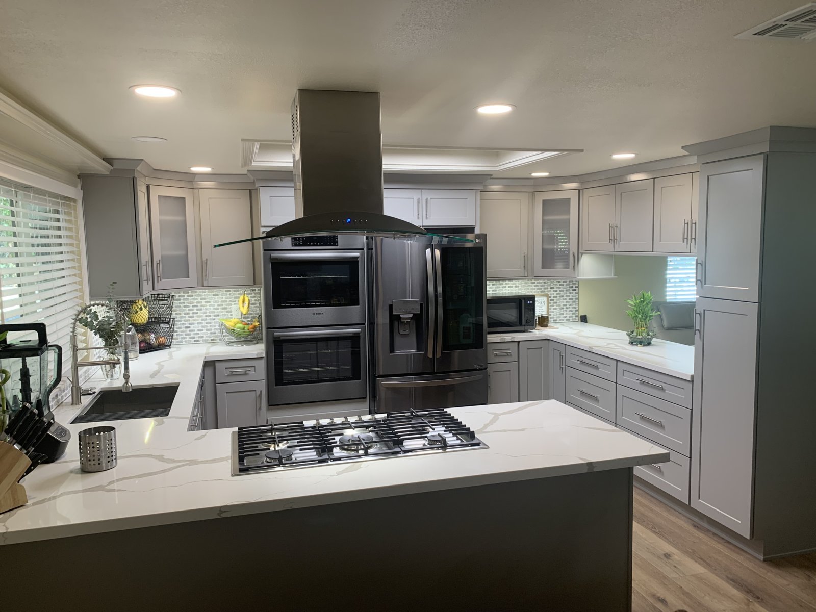

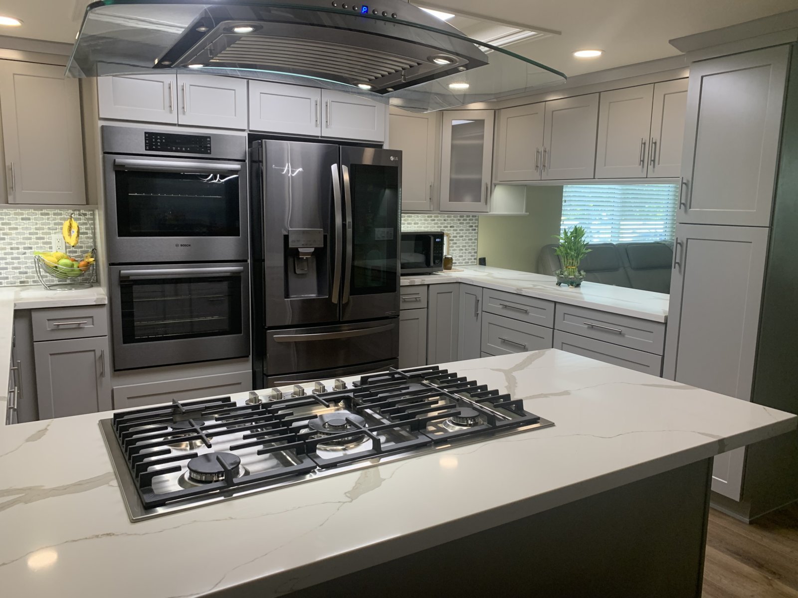

    Finished up this kitchen for a client. Back today to install the glass doors and straighten up a couple things.

    That’s a beautiful kitchen!

    Killer work!

    :thumbsup: Looks great!

    Wow man,nice job on that kitchen!
    I honestly feel that the kitchen is the hart of a house, it holds the best conversations,celebrations,holidays the best of times and the sometimes the worst, but its the common grounds of a good home.this is why I think it's the hart of a home.
    Well done!

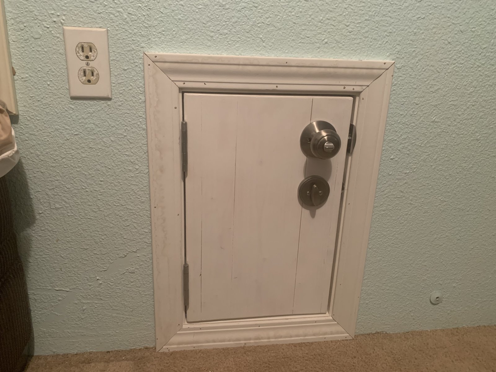

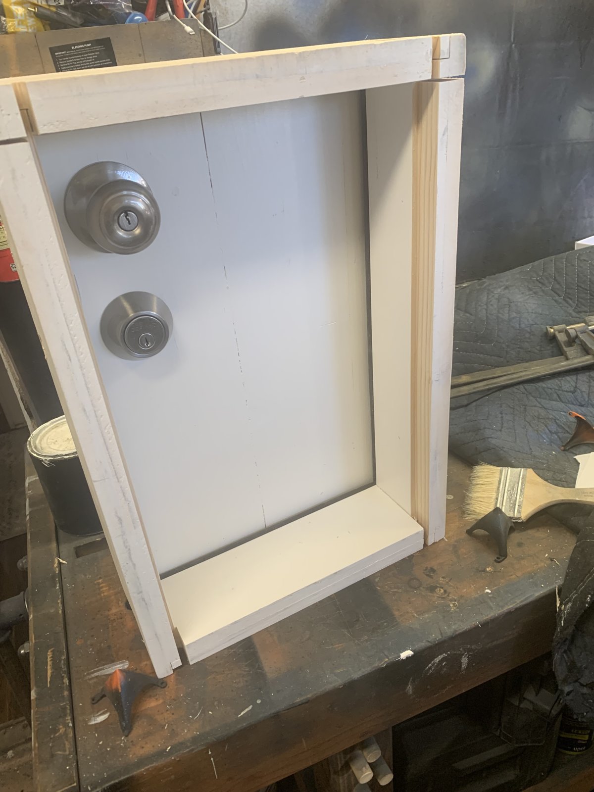

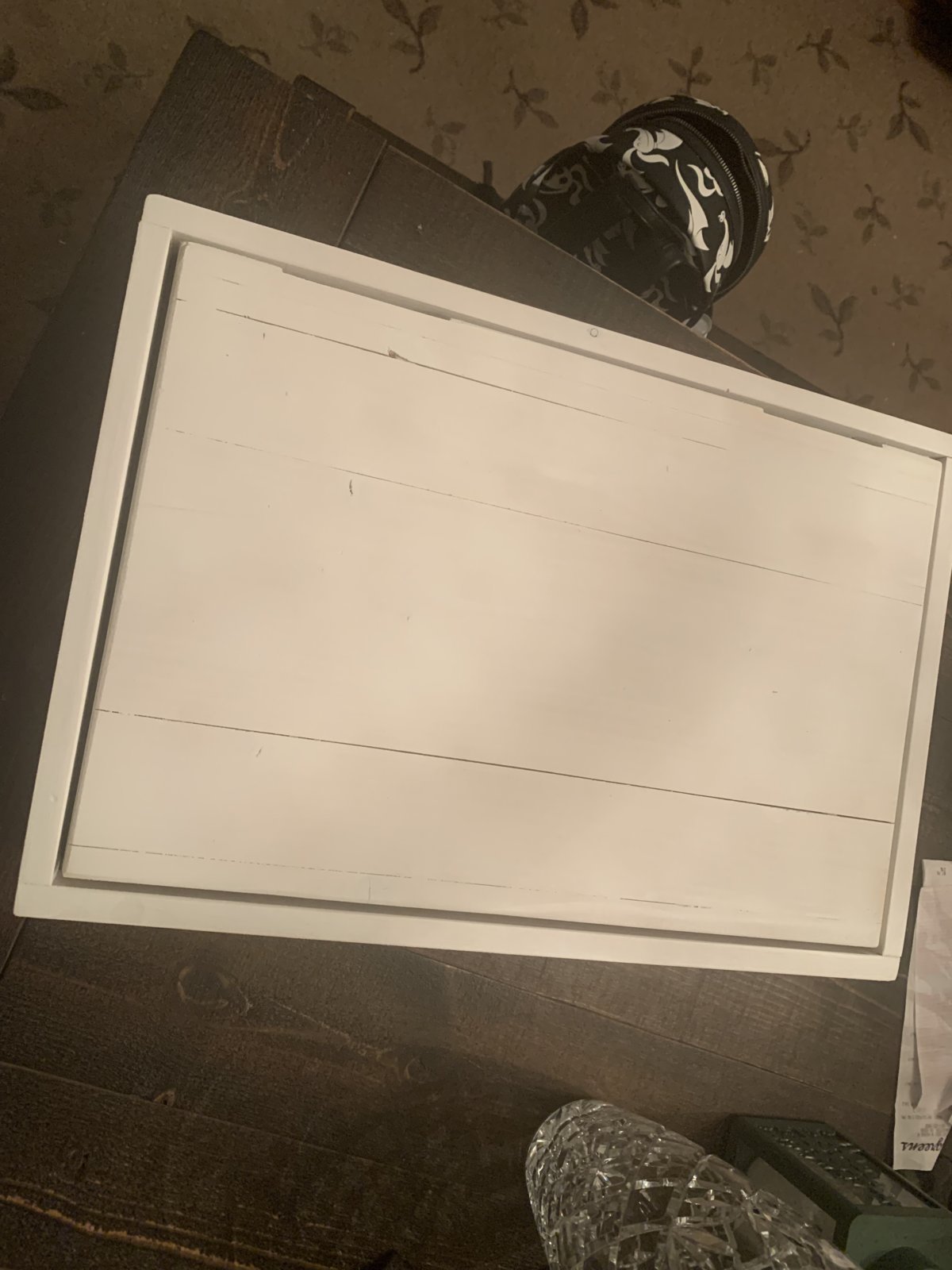

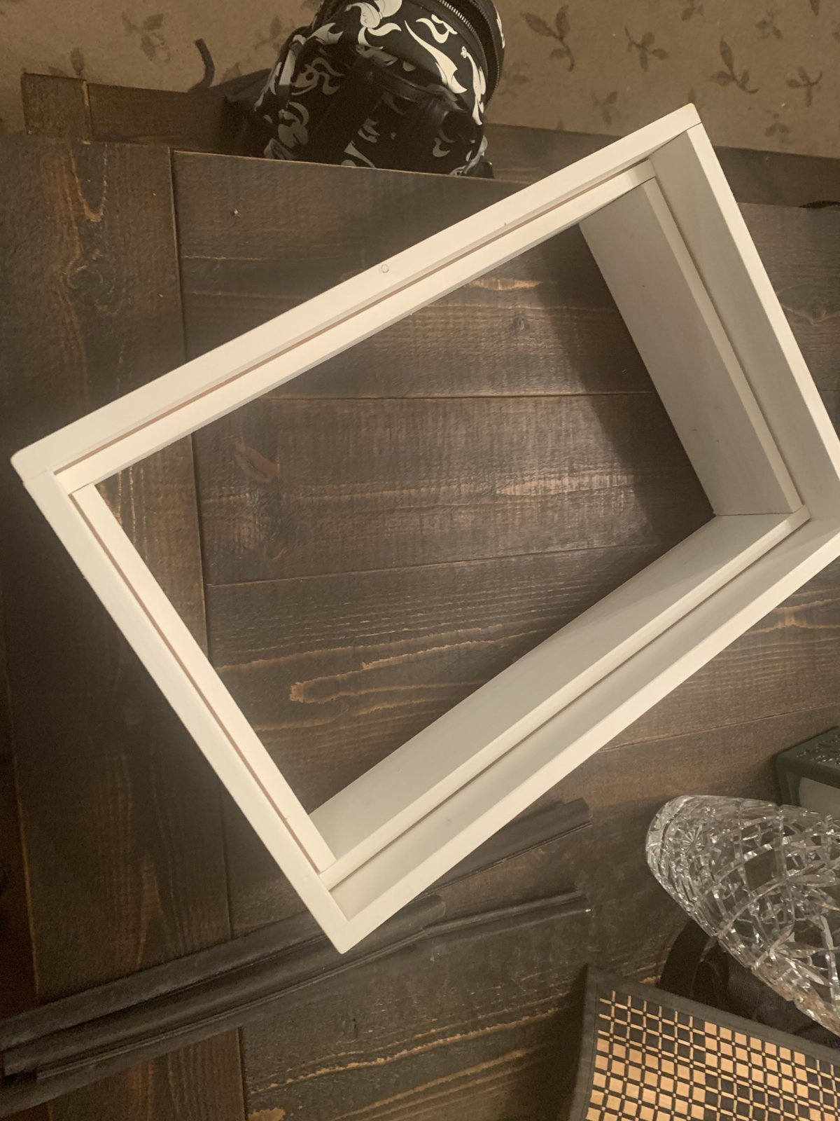

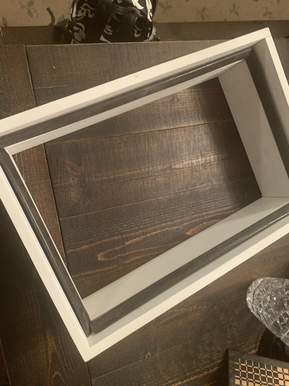

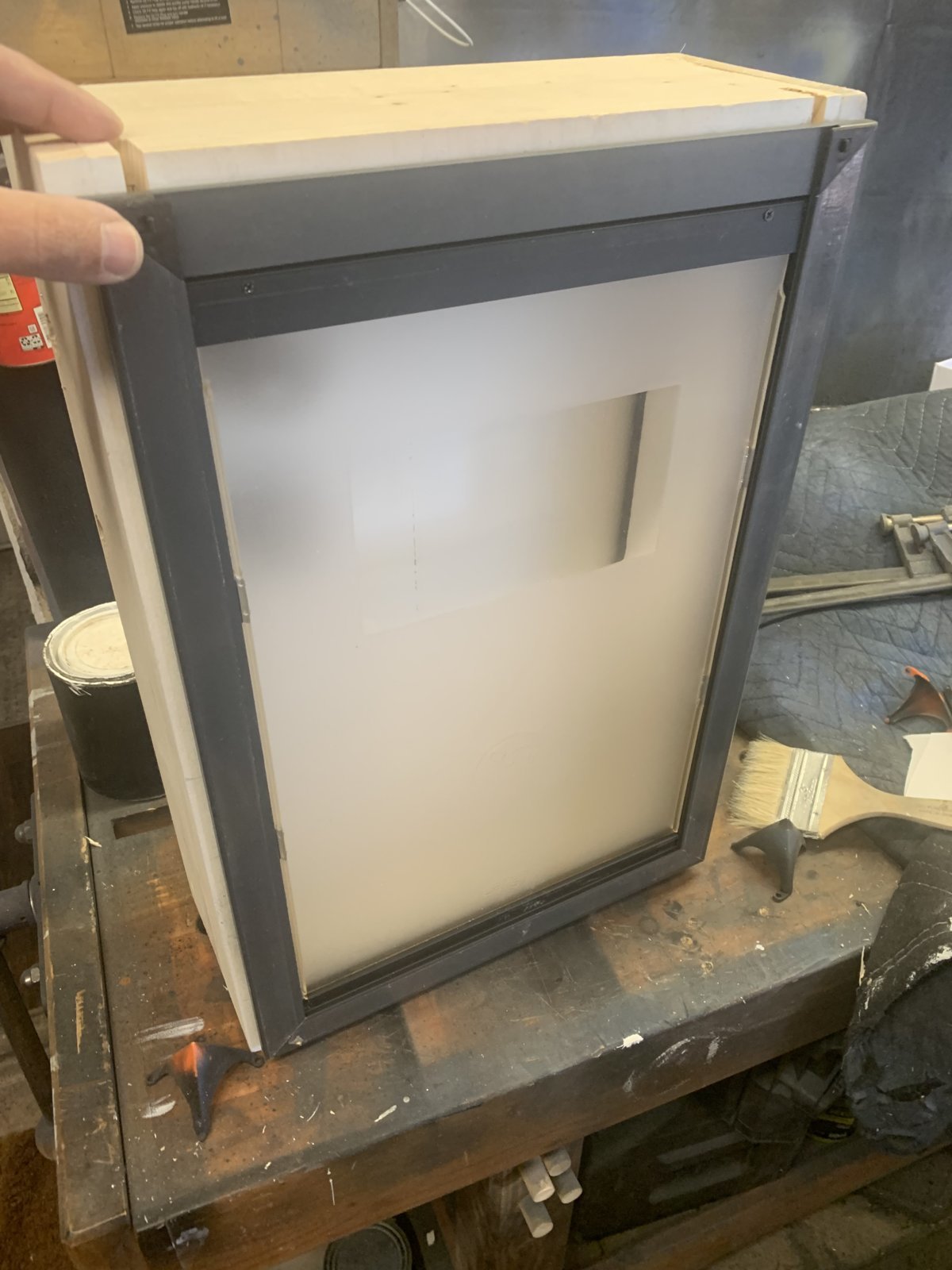

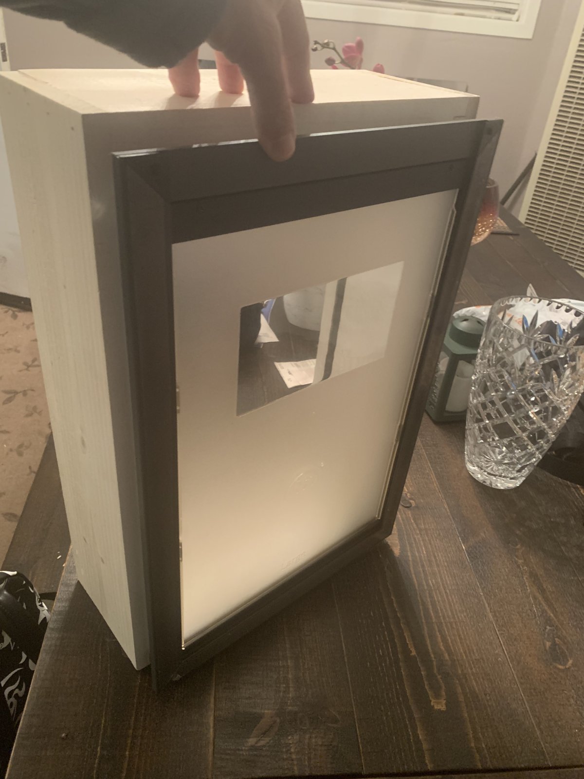

    Been thinking of doing this for a while. We need a dog door in our bedroom wall, but my wife hates them (security and weather).
    So I bought a dog door and will use half of the assembly. I built a 12”x19” door frame with the proper groove for weatherstripping, and glued up a 1-1/2” thick door using 1x and cut grooves in it for a old time look (my wife may veto this old time design later).
    The door will get a knob and deadbolt mounted high.
    Now I can install the frame and door in the wall, and we’ll have weatherproofing and security. I understand this isn’t a steel door, but I did leave a little extra space for door expansion (about 3/16”), and I’m hoping with plenty of paint and proper maintenance, we should be ok. Right now it’s just primer, but I’m sure my wife will have a color in mind to make it pop.

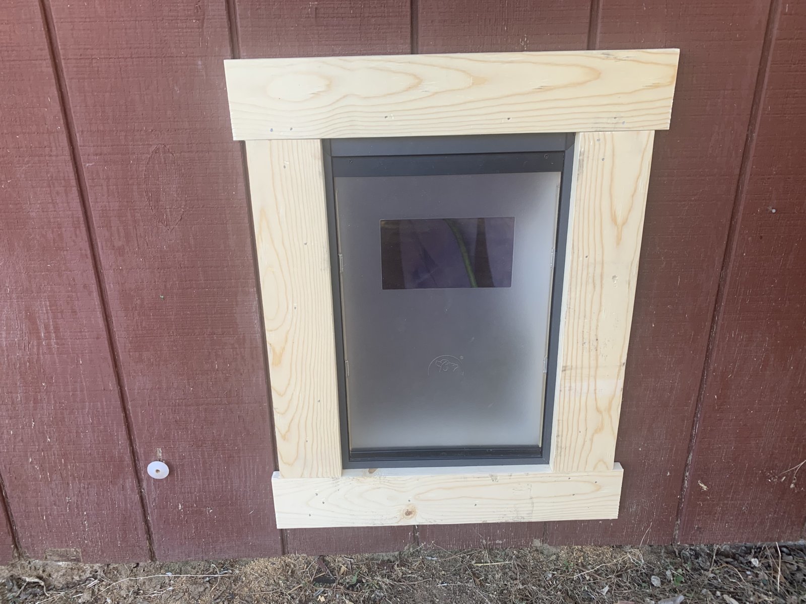

    Finishing up the dog door, just needs paint, and a little training.

    What if your dog loses his key? LOL!

    I like the set-up! Certainly better than any prefab, that's for sure!

    Thanks! The pups already love it, and has made our lives easier by far. Our Pit had ligament surgery two months ago, and needed a quiet place to relax. Our side yard is perfect but needed easy access.
