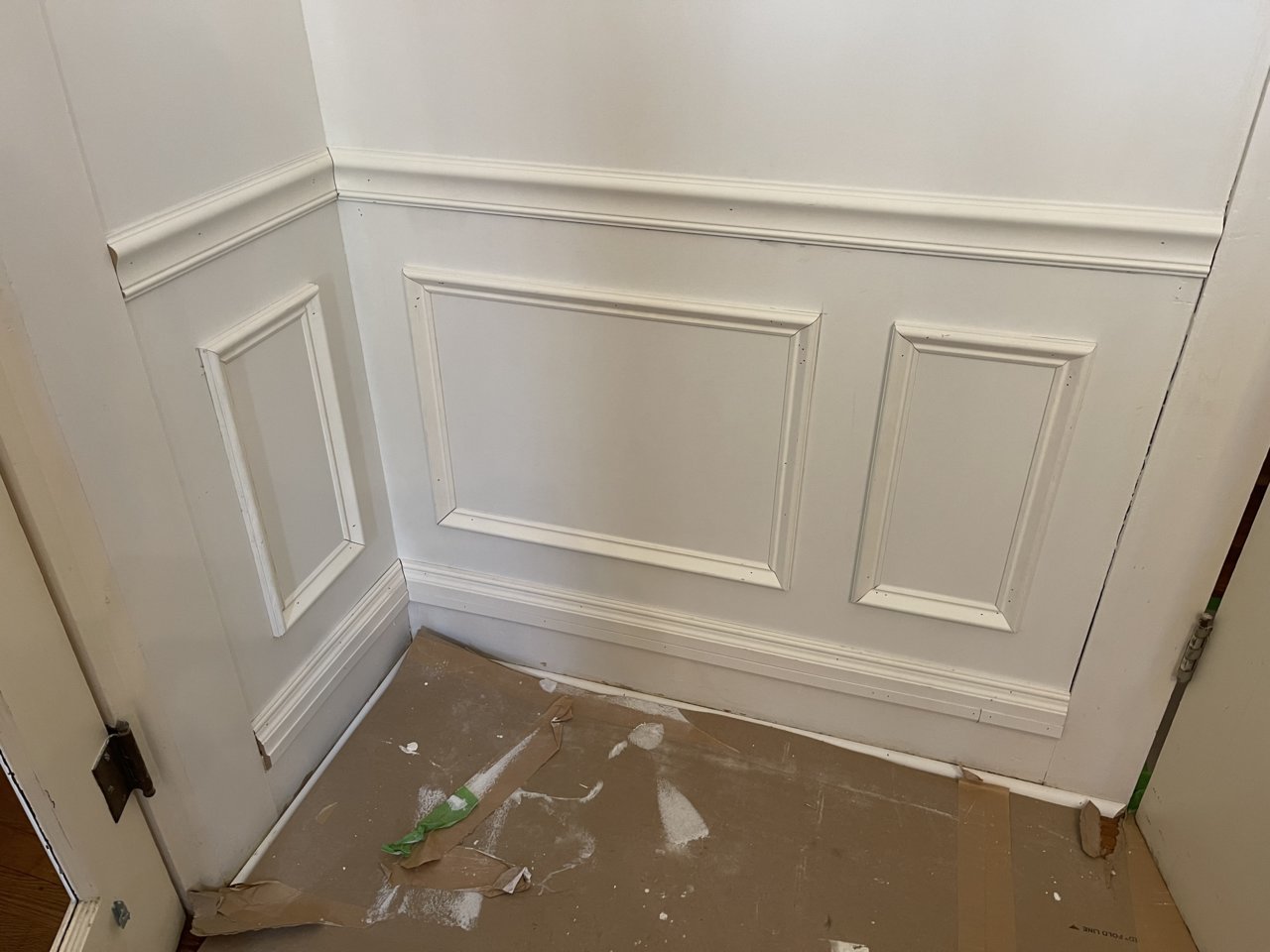

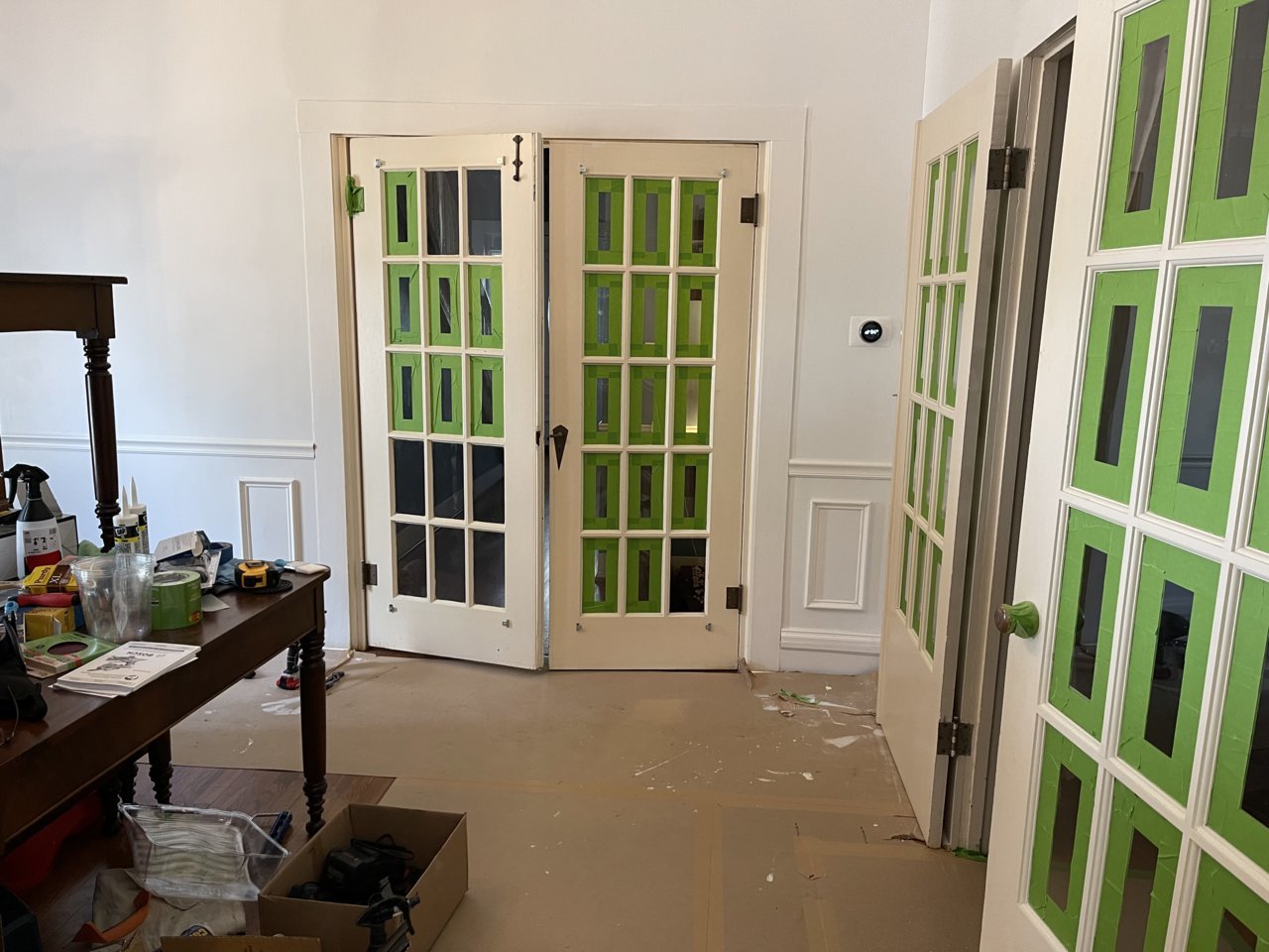

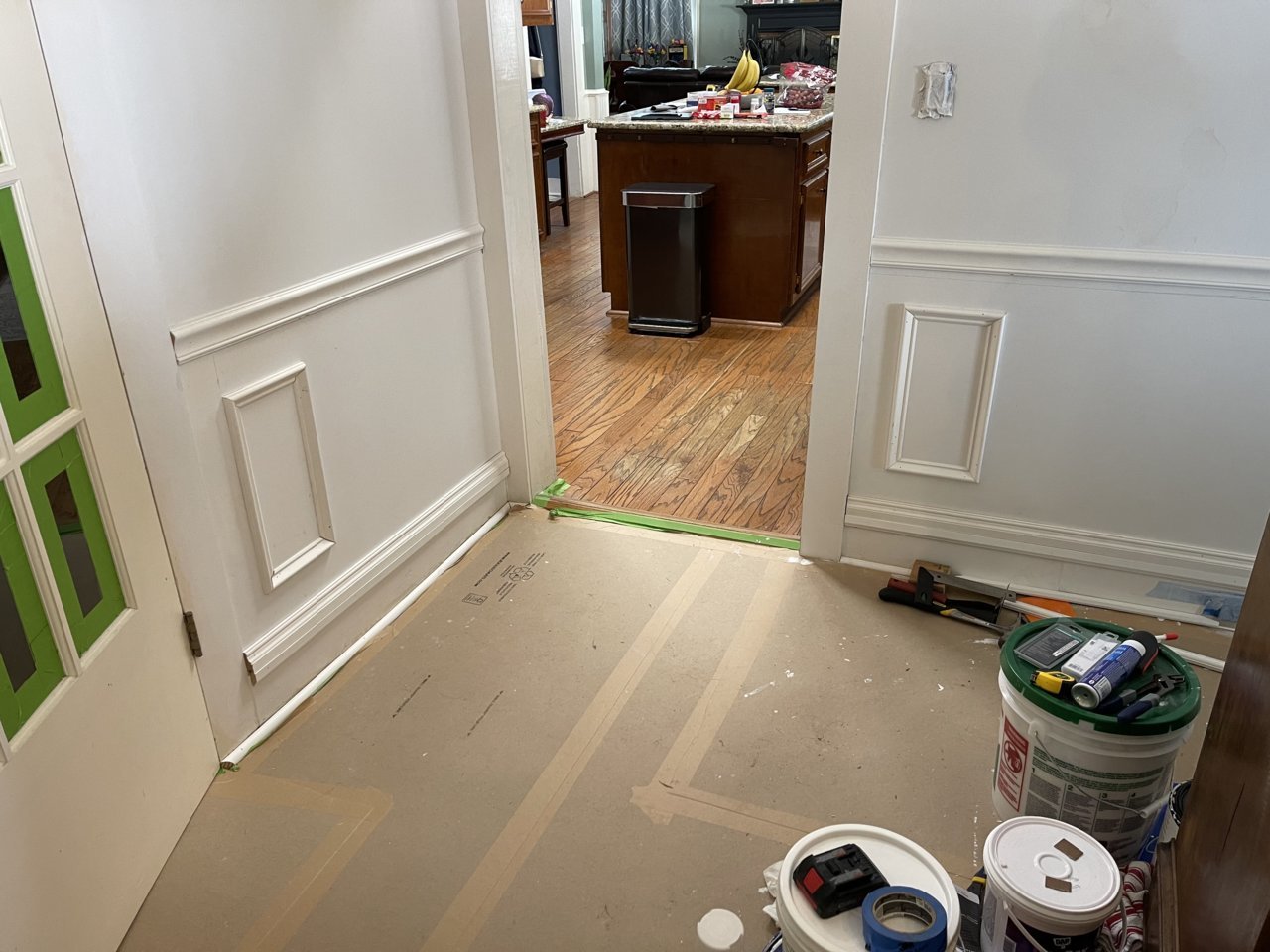

    Finished the wainscot this morning, switched out the old outlets with Decora styled ones, took a nap, caulked and filled the nail holes for half of the room. Hoping to finish caulking, filling, and then sanding the filling tomorrow. Maybe even get some primer on all of the trim. With some luck, I'll be done with the "remodel" by the end of the week.

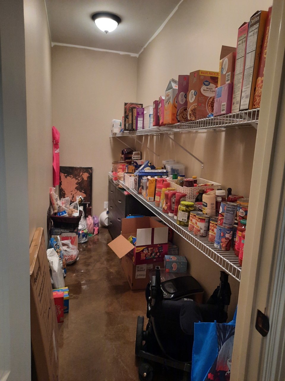

    I forgot to put in here, but not long after I installed a motion sensor. It seems common that the light gets left on in here (typically cuz the wife's hands are full and/or she's got 4 little ones at her feet distracting her). I put it in and had some issues with wiring at first, but got it resolved. Also thought the sensor was crap because it wouldn't turn on once I walked in, but it would when stay on detecting motion because I turned it on. It was simply a setting and just the push of a button took care of it. Simple, yet everything I do seems to be more complicated haha.
    I used the one someone suggested in here....so thanks to whomever suggested it.

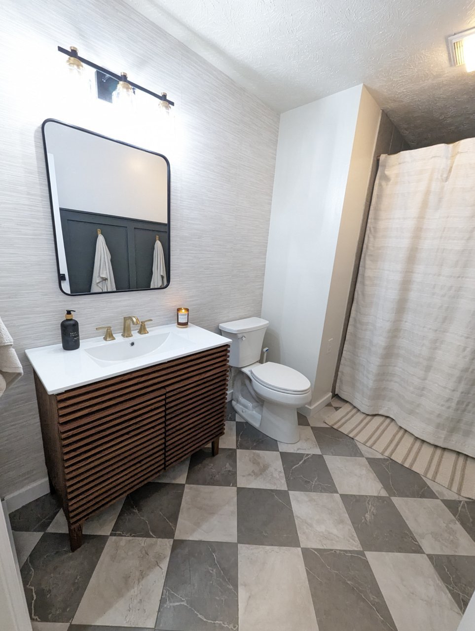

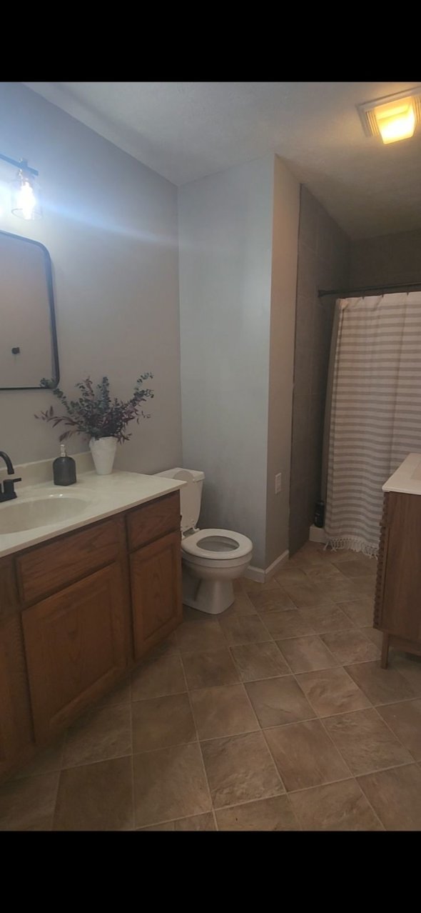

    It's a little shocking the outlet by the shower passed code inspection.
    Your wife did an amazing job on that remodel. Tell her for us. Something I hope she is proud of.

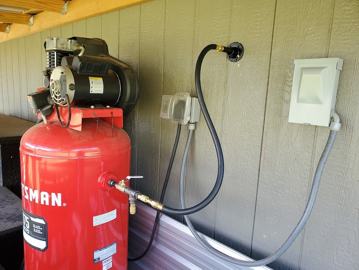

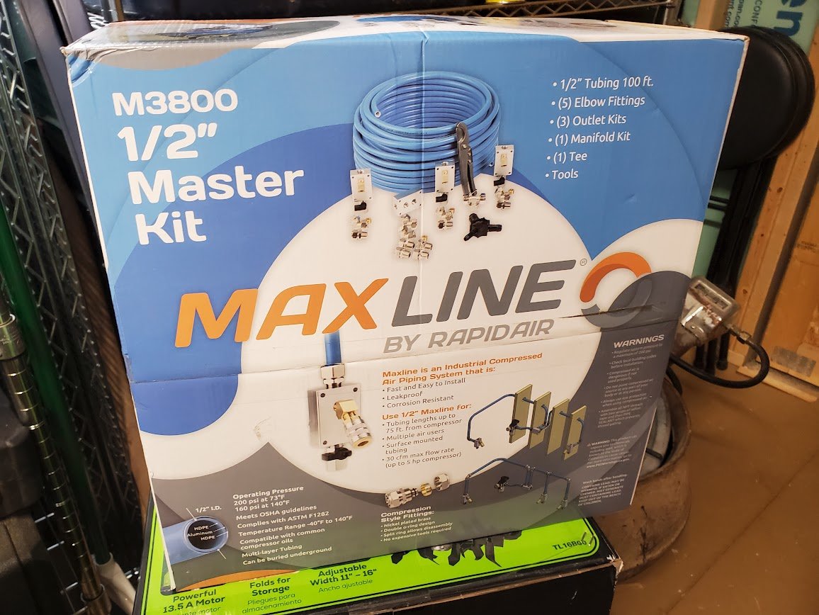

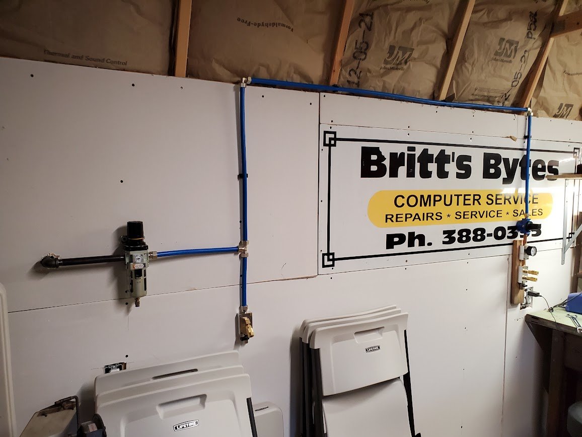

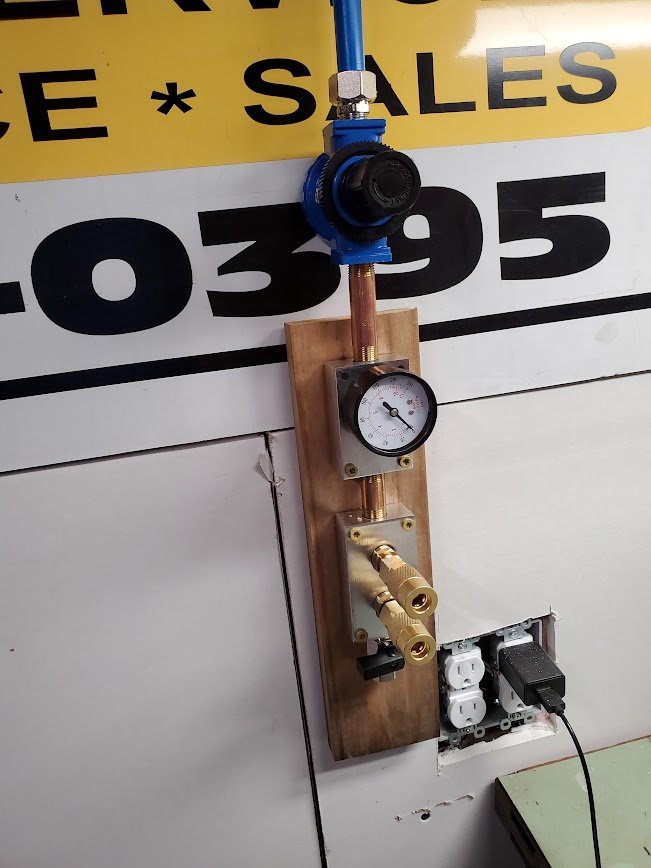

    Did a shop improvement.
    I got a Craftsman 60 gal compressor a couple years ago, got it wired up and working out behind my shed. Finally got around to plumbing the inside.
    I put way too much thought into doing this over the years and ended up using this product for the piping.
    ADCreHfwh-GAGBwm-HUql0JEkgy7GHLyuSVvrwGx_f71e344981066df19880f7f399587f879cec11d2.jpg
    To transition into the shed I used black pipe with a quick connect for easy maintenance.
    ADCreHfIBGMnwxMoAcaZkCLhI9je3bM4UVlF7xXj_88ac594de79f6bb368c562a46dd52bf8adb84b14.jpg
    ADCreHegwrrEYaTv1mttRdPh4vMrsM4Qdvlp6keM_a90f474cf694f52bb465eb20905c786a9665b726.jpg
    The precut pipe is easy to work with but I wanted the flexibility of the pipe. One of my hobbies is scale models and I use airbrush for painting, that's why the other pressure regulator.
    ADCreHetJA3_2TNYNHdRLO9syDQXLT80_A92cPx7_32f9d966c848f8201d30134784afe49dfbb72a46.jpg
    It's a bit out of reach from my bench but I used a bigger gauge so i can read it, ok it's crooked but that's how it lined up. I'm ok with that. I used Loctite thread lock to seal the threads, testing this out before I got to far it sealed up nicely. Fella on youtube did it so how can I go wrong? I'm going to put pressure on it tomorrow, wish me luck.

    To quote my self, I did pressure and leak test today. Cranked up the pressure regulators and squirted windex on the joints. Not a leak anywhere!

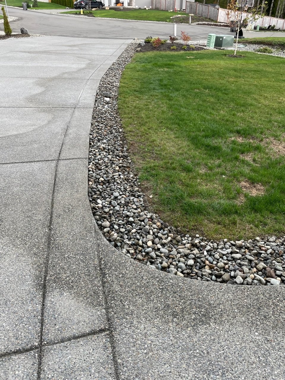

    Had the concrete guy bring in a load (1.5 cu yd) of river rock to fill the French drain. I did have a skin on the perforated pipe but also added a layer of weed blocking fabric over it before adding the rock to keep dirt out. A before and after photo (different days). An hour after we finished a thunderstorm came in with a LOT of rain, and the drain worked well, no pooling on the driveway nor grass. Success.

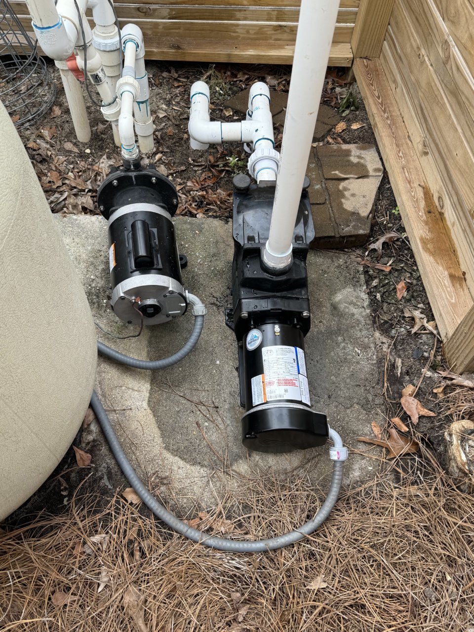

    how old is the pool?
    saltwater pool?

    Started out replacing seals in my pool pumps but ended up buy more parts due to extensive corrosion of several components. A pool owners life.

    Mid-1980s pool. Chlorine.
