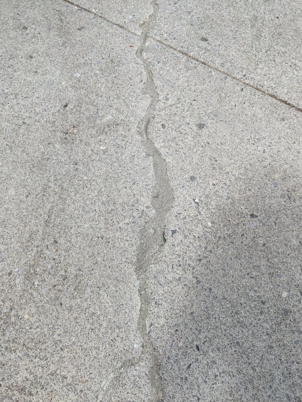

    Not the most exciting and maybe not even the best way to do this, but here is my progression on fixing my driveway cracks. I started by filling the cracks with fine crushed rock. In some of the biggest cracks I stuffed 1/2" backer rod in first. Then I used Tremco Vulkem 45 sealant. While it was still wet I sprinkled more of that crushed rock on the sealant to make it blend in with my driveway.

    Kudos to you, most folks don’t have a clue what backer rod is. Especially those who should know. :facepalm:

    Ironically, I'm only familiar with it because many of us 1st gen owners used it to eliminate a dash squeak on our Tundra. Worked out well for both jobs!

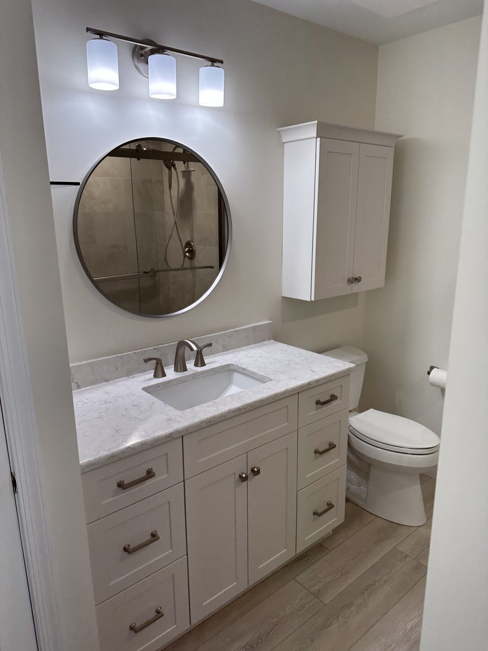

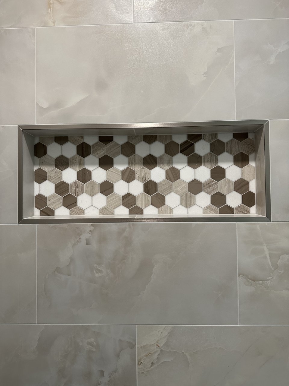

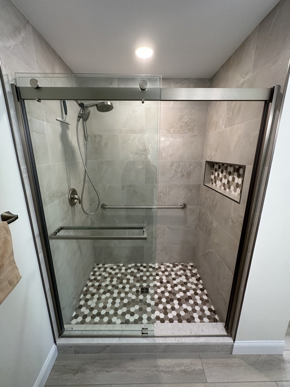

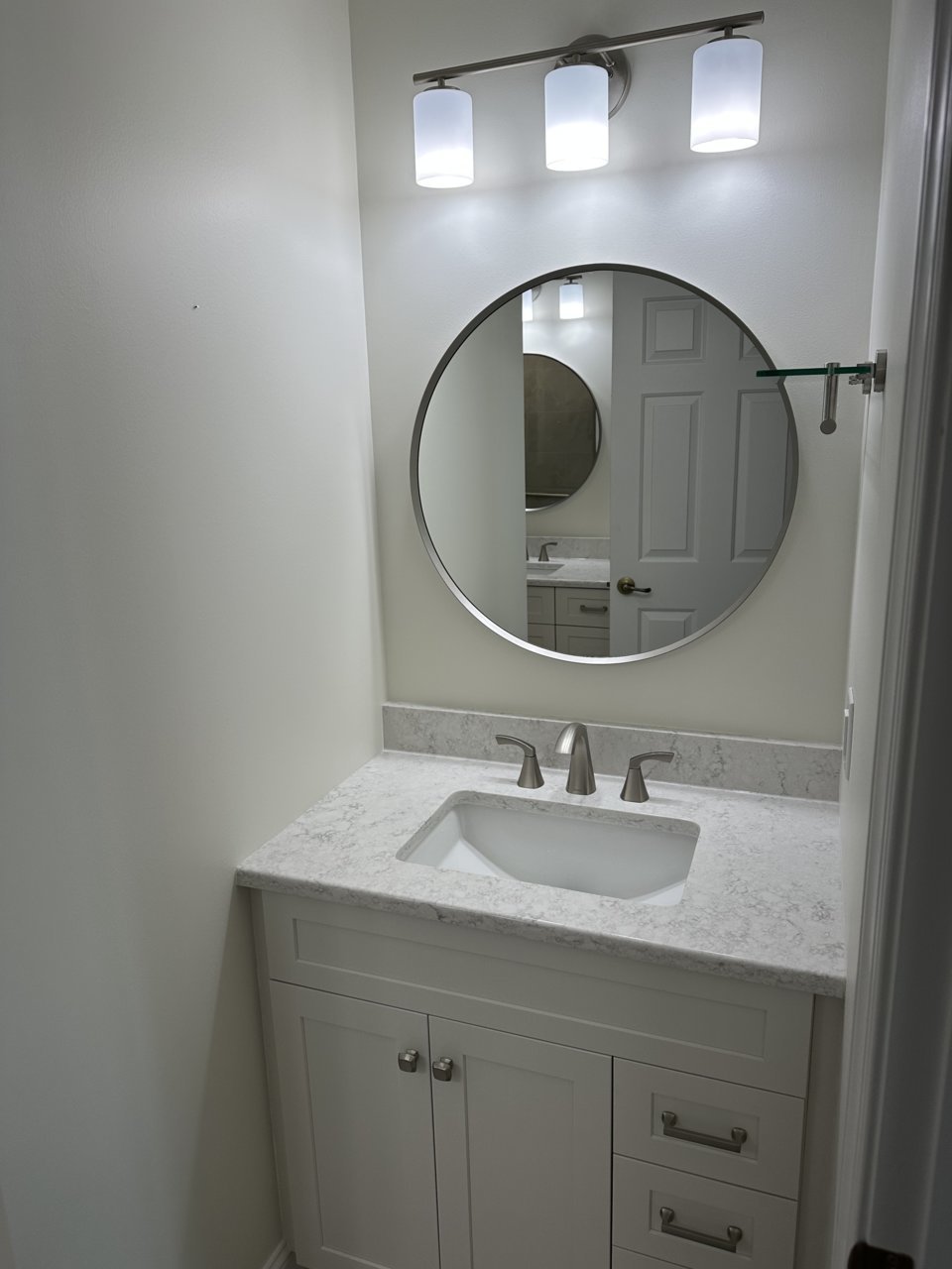

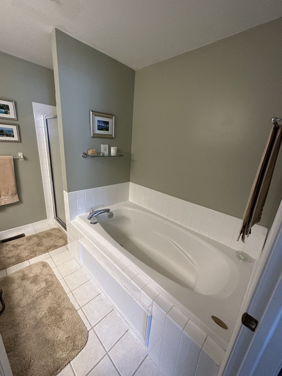

    Wrapped up another master bath this week.
    Before:
    After:

    Yes indeed it is. I did all except the quartz countertops and I hired a painter.

    Pretty decent work, VERY good in fact!!
