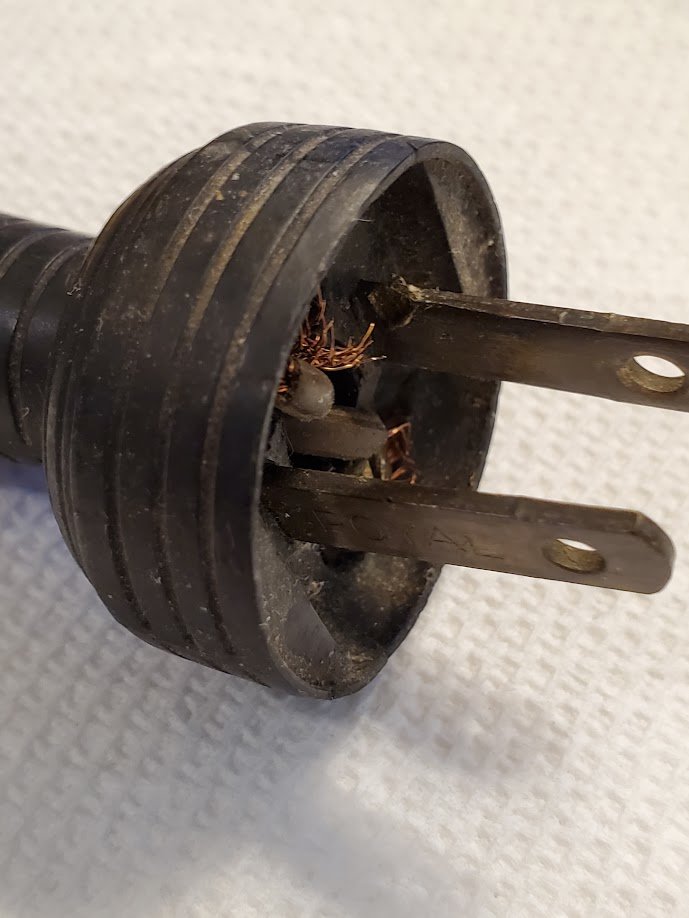

    Been having problem with a breaker tripping often, had a large storm blow in the other day and it tripped again. This time it wouldn't reset.
    GFI but it's also really sensitive arc type..don't know the electrical term. I thought the breaker had gone bad. Called my electrician to come replace it, I'm in the list. ok.
    I got everything unplugged from that circuit which runs outlets to 4 different rooms, just a few in each. Really old house so who knows how it's routed. With everything unplugged I thought try the breaker again. Sure nuff, it reset.
    I started plugging things back in and noticed a three way lamp with a REALLY old plug on it. Wire looked ok but the plug just looked old. So I replaced the plug and found this.
    AIL4fc-v7EehXkm8agxmtaJLAwZUZT2keeU4qmuA_f25dfc55a469363cfd2395fccf3815c9b382b2fa.jpg
    Can you see the melted bit on the prong? Looks like it's arced more than once. Lamp works fine now.
    And here I was cursing the breaker for doing it's job!
