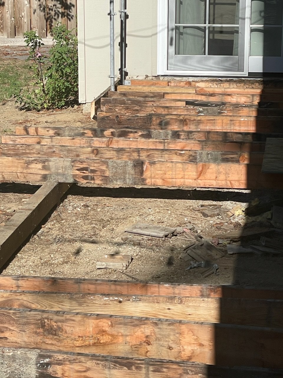

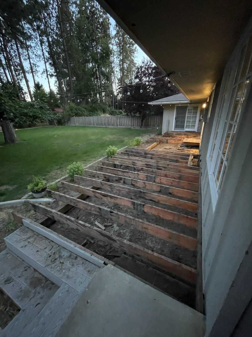

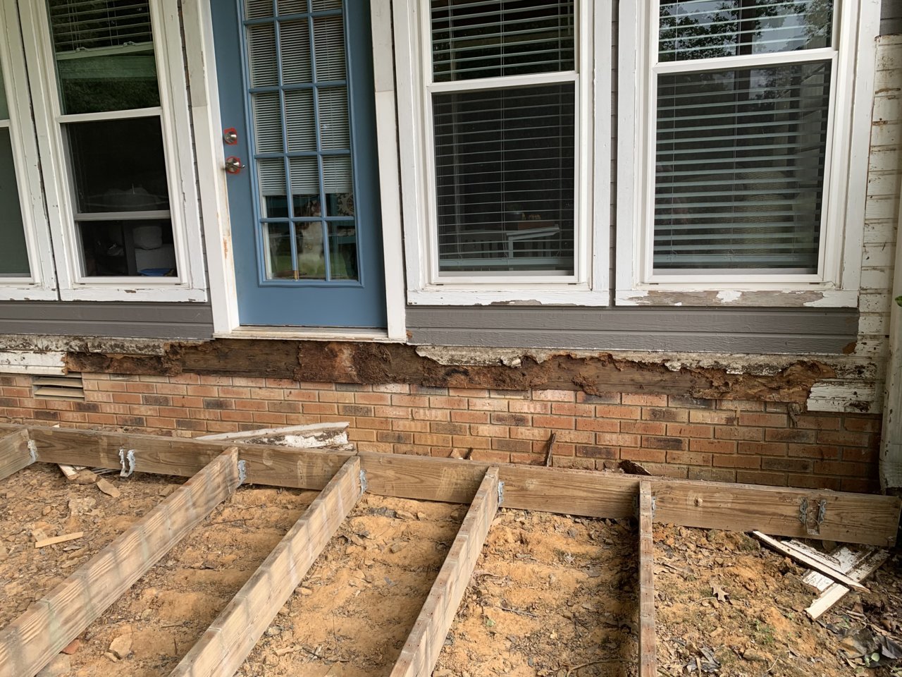

    Well I’ve wanted to redo my back patio for a while and finally tore into it yesterday. Existing is 38.5ft long by 10ft deep. I plan on going 12 wide now as well. Some issues I’ve seen already:
    No flashing
    No butyl tape on the joists so most if not all are unusable due to rotting
    The cantilever of the joists (2x8) from the beam are 2.5ft
    so now I’m gonna have to tear everything including the ledger boards off and basically start from scratch :mad: which will allow me to move the beam placement for a long span of the joists so I can get my 2ft cantilever and get 12ft of depth total.

    What's wrong with it? (I know literally almost nothing about concrete and the like.)

    You’re lucky the house skirt board isn’t dry rotted out. That’s what happened on a huge section of mine when I discovered the flashing issue

    It’s funny cause the ledger boards look the best compared to everything else. But I realized today they didn’t even cut the siding. They just screwed the boards right over it into the house.

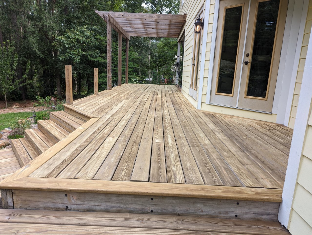

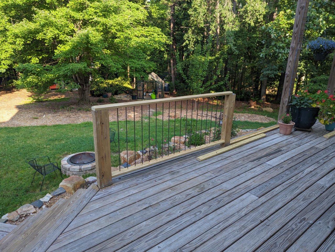

    Spent since last weekend cleaning, pressure washing, sanding, and vacuuming the deck.preparing to stain. Before and after...PXL_20230628_115415987.jpg PXL_20230719_112506797.jpg

    That looks great but must have been a miserable endeavor. This is why I replaced our deck with Trex in the last house. I swore I would never do a wood deck again

    Yeah, I hear ya! I checked into Trex, but it would've meant replacing all the joists (or at least running another set in between to pull the span in enough to not flex), so I just replaced with wood...then neglected it for a few years until I had to do all this work to stain it proper!

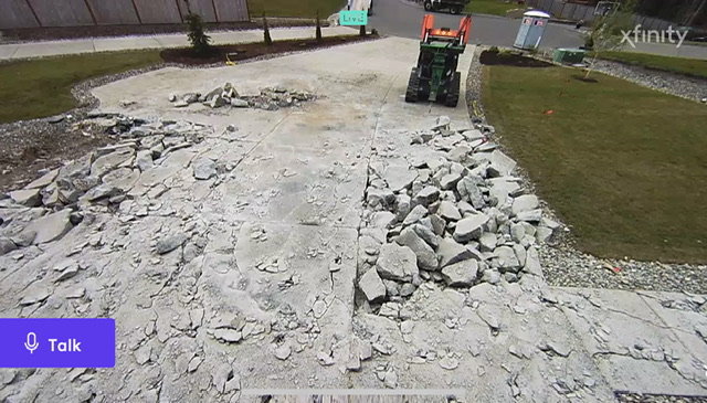

    I have some photos on this post:
    https://www.tundras.com/threads/wha...-did-you-do-today.25160/page-338#post-3054100
    when the dry weather hit this summer, the concrete seemingly never cured right, our tires would bring in the pepples and sand into the garage. The driveway was on a slow dissolve. It was a form of “spalling” I believe. 14 months ago, We were thinking about adding an onto our back patio and one concrete contractor’s first words last year were “your driveway is crap”. That kept us, and my wife being persistent on the drive way issues. We decided to go with pavers for the back…. They are also going to replace the back patio, which I hope does not turn out to destroy our landscaping in back.
    With regard to wood decks others are replacing, I’ve been through that 35 years ago…. I do concrete or pavers now. That being said, I do have an upper deck, completely covered with roof except for the steps. It’s all pressure treated or cedar wood. I stained it after 6 months of moving in, but the sun exposed wood looks like it needs another treatment again. It will most likely last more than me.

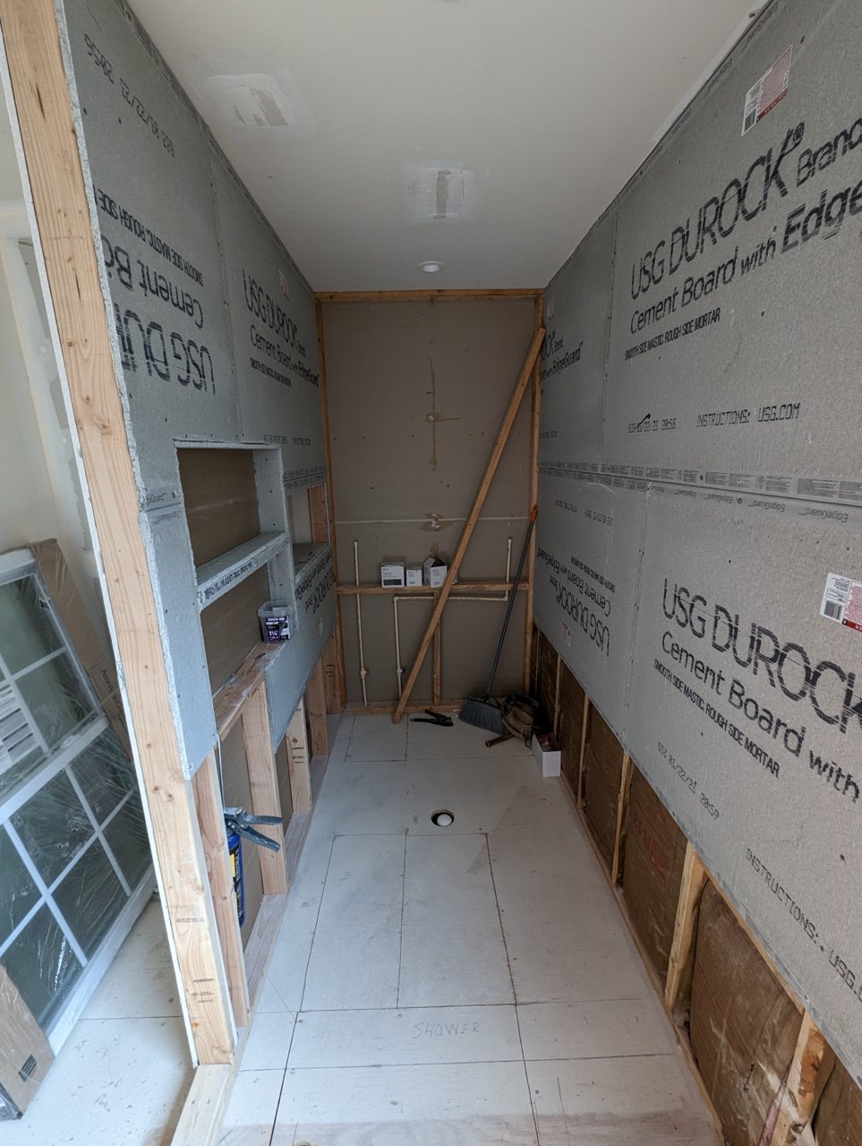

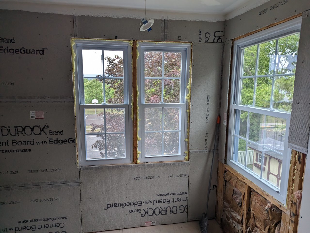

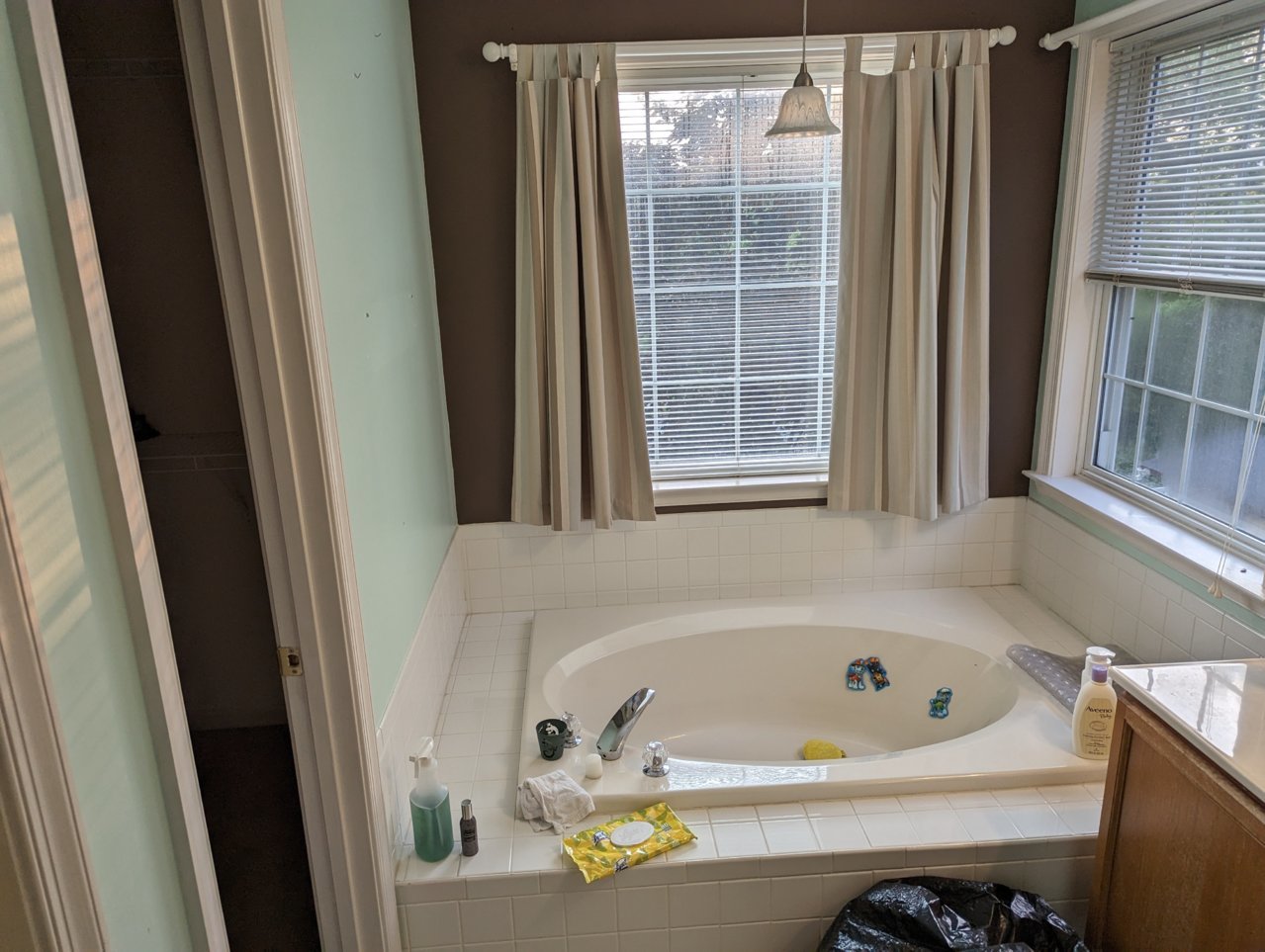

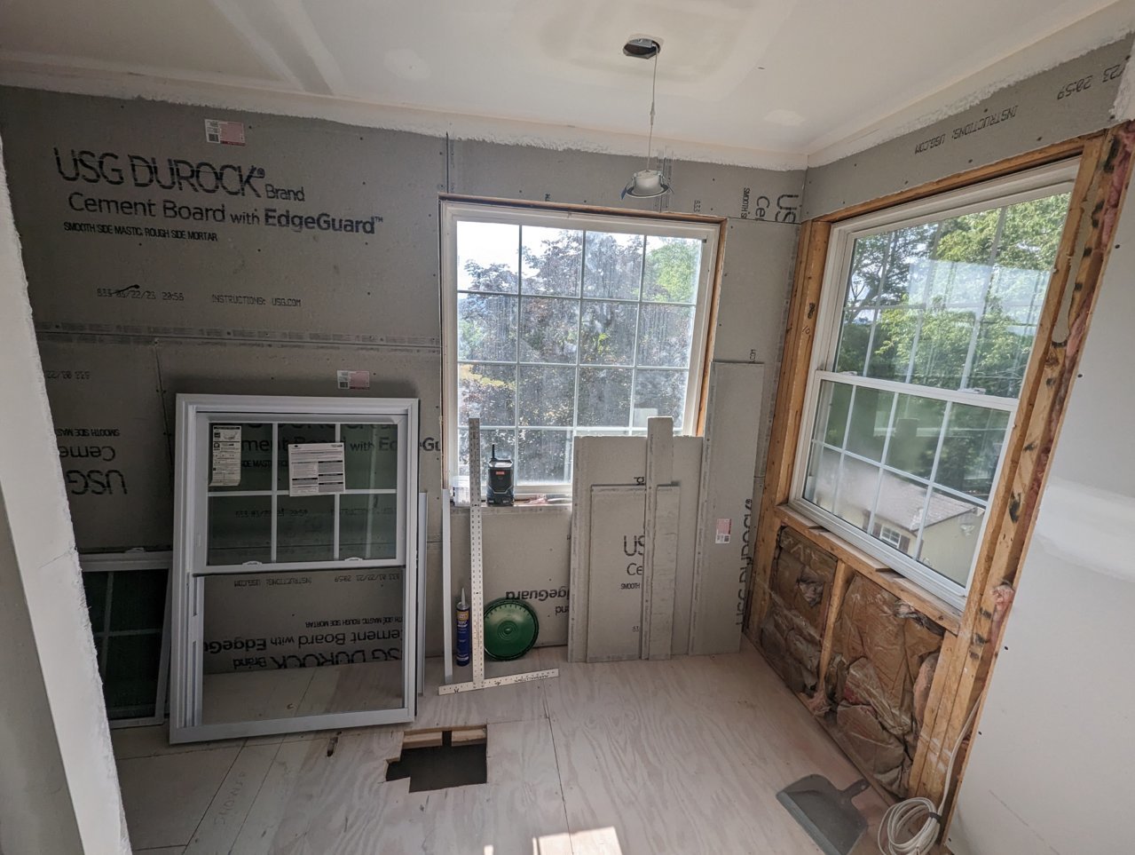

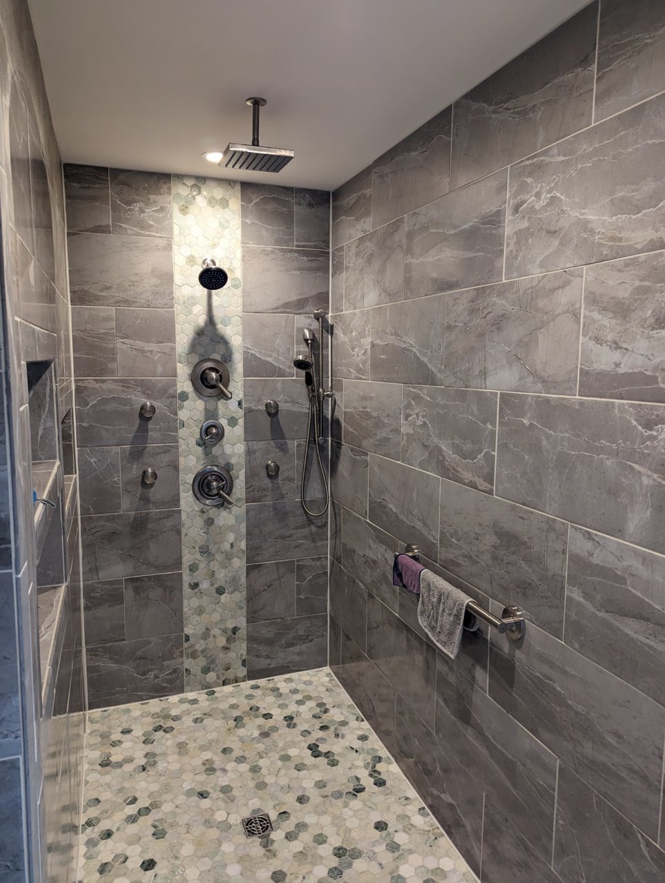

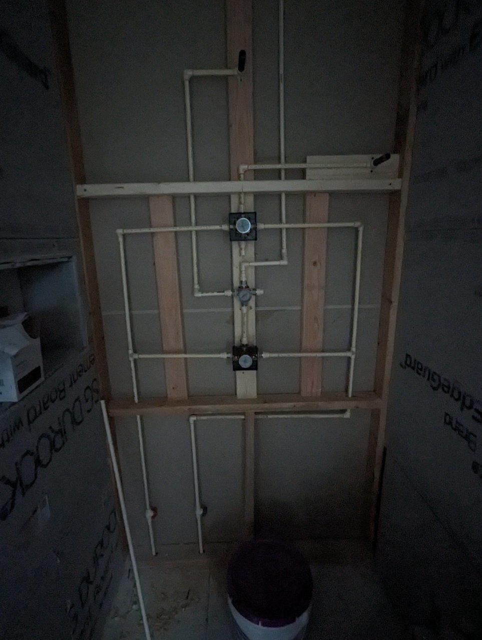

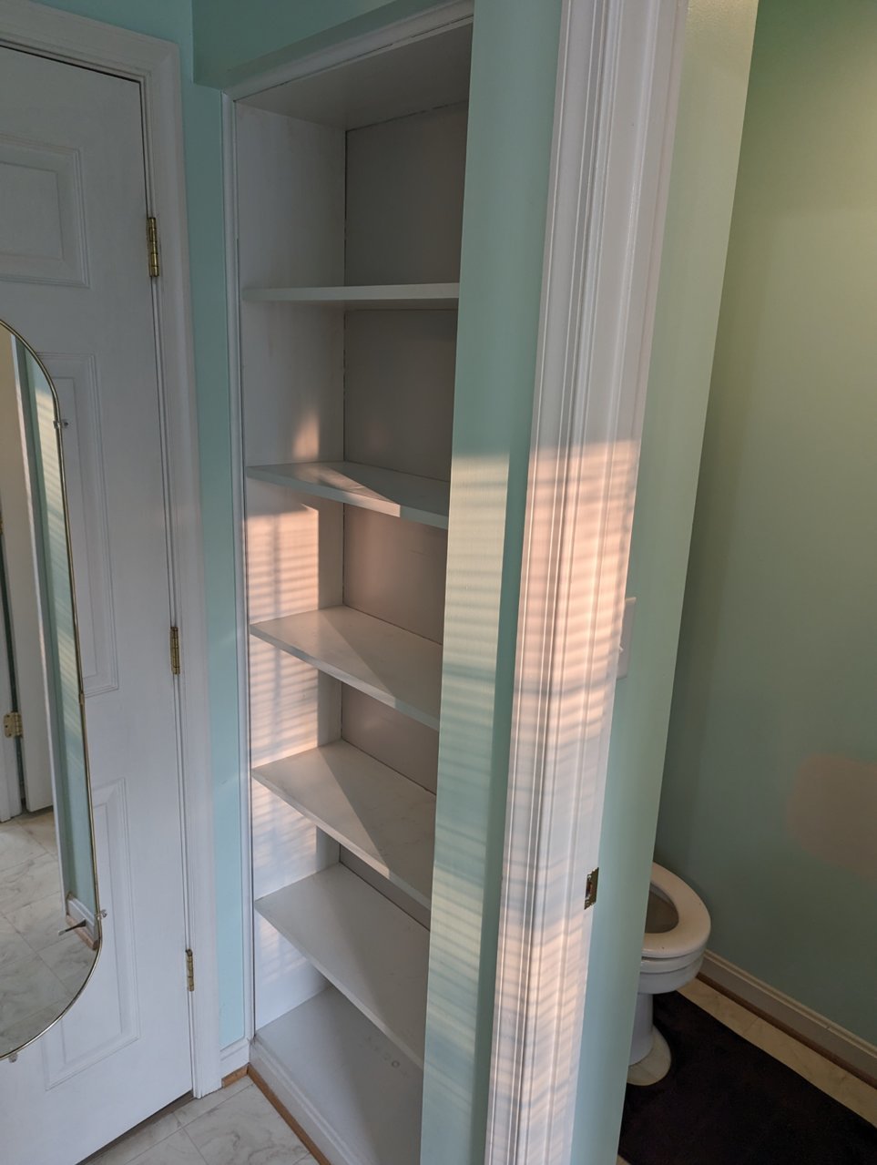

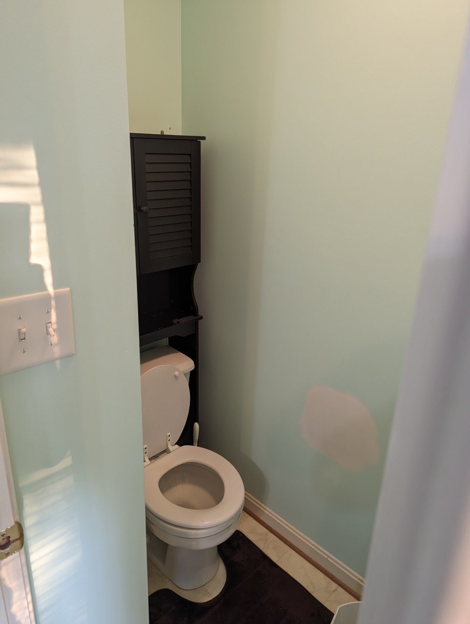

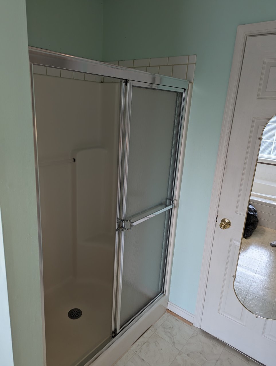

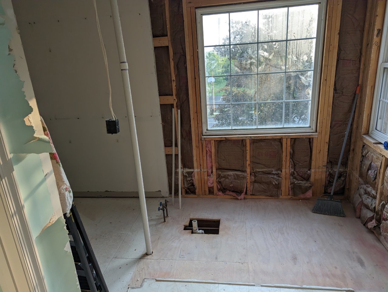

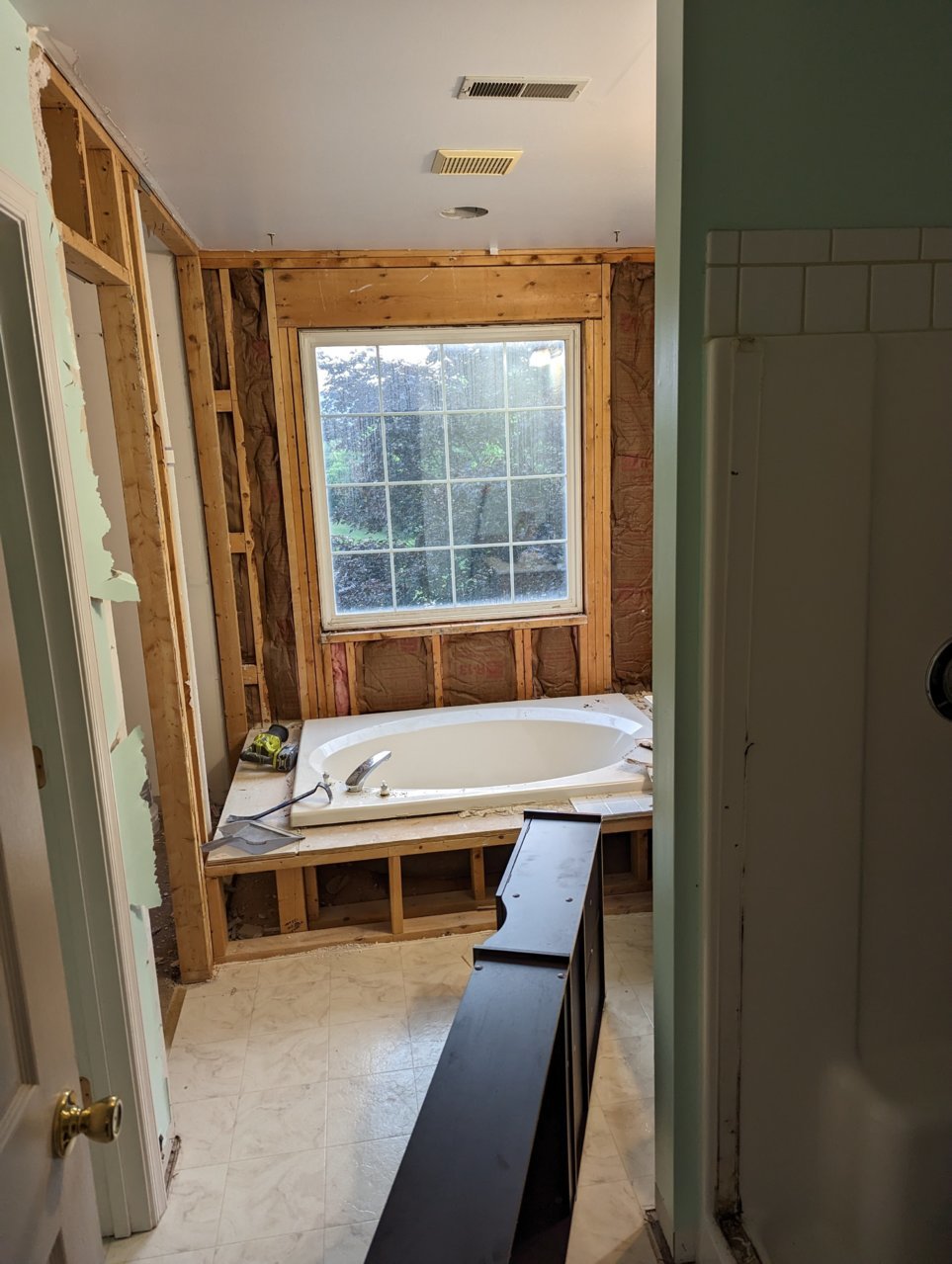

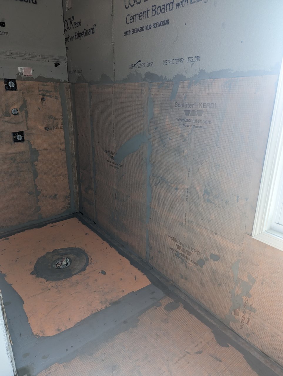

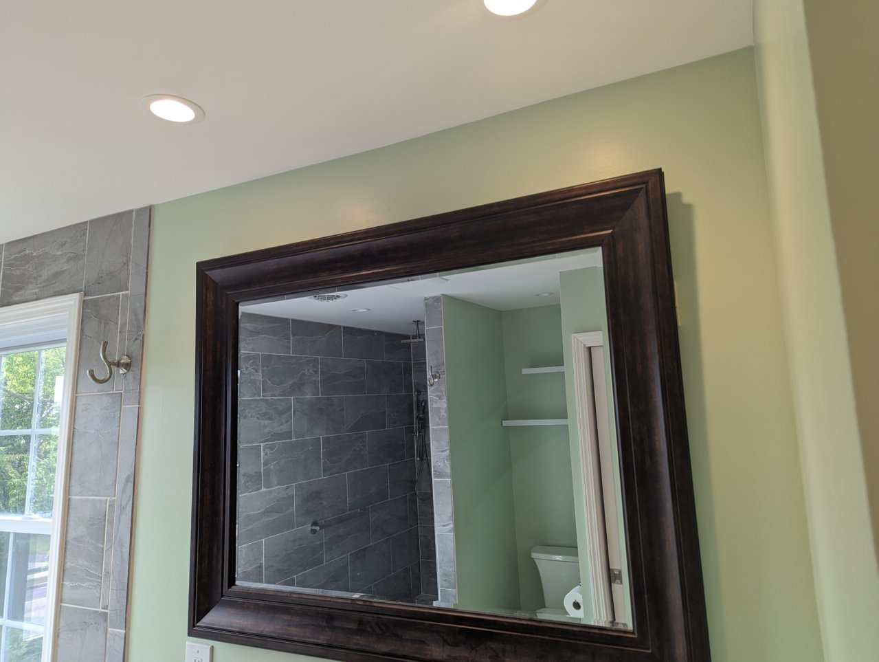

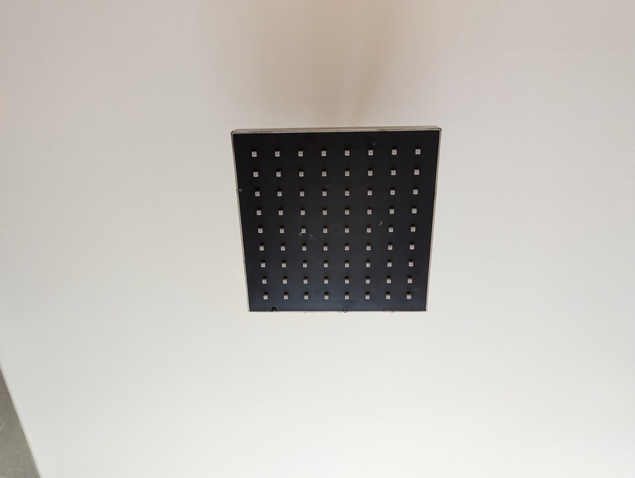

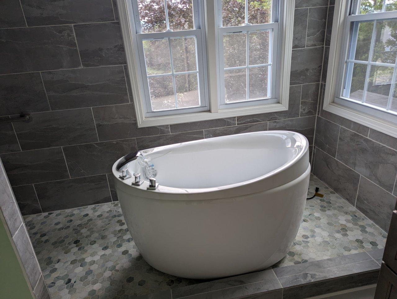

    I wanted to re-do the master bathroom-REM1.jpg REM2.jpg REM3.jpg REM4.jpg REM5.jpg

    Is it just me or does that look like an absolutely gigantic TP roll? :confused:

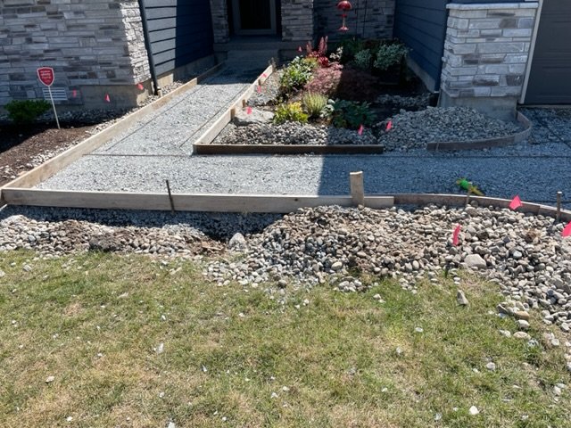

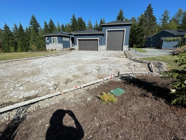

    I guess I will find out, …. A lot of homes have their roof drains hooked to the foundation French drains via the black tubing but I’m not sure if it goes under the driveway. Most likely not. I had a piece of wood over the black tubing but the guys removed it. There is a layer of gravel over the tube now, and I hope it is ok. It’s just a sidewalk thickness of concrete, so the load will not be much. They are actually using rebar unlike the original build.
    This correlated pipe was of an accordion type, fits 6 to 25 ft. There are sections of the pipe not expanded under the sidewalk so it should be more rigid.
    I was at the point I wanted to try and get the water from that gutter drain away from the house. We have all the drains from the roof now going away from the house.
    New photo from today, they just finished the gravel and rebar. One small section of form to complete imo.

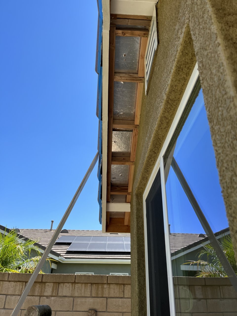

    Grouted, painted, installed baseboards, and closed in the eaves.IMG_6073.jpgIMG_6079.jpg IMG_6080.jpg
