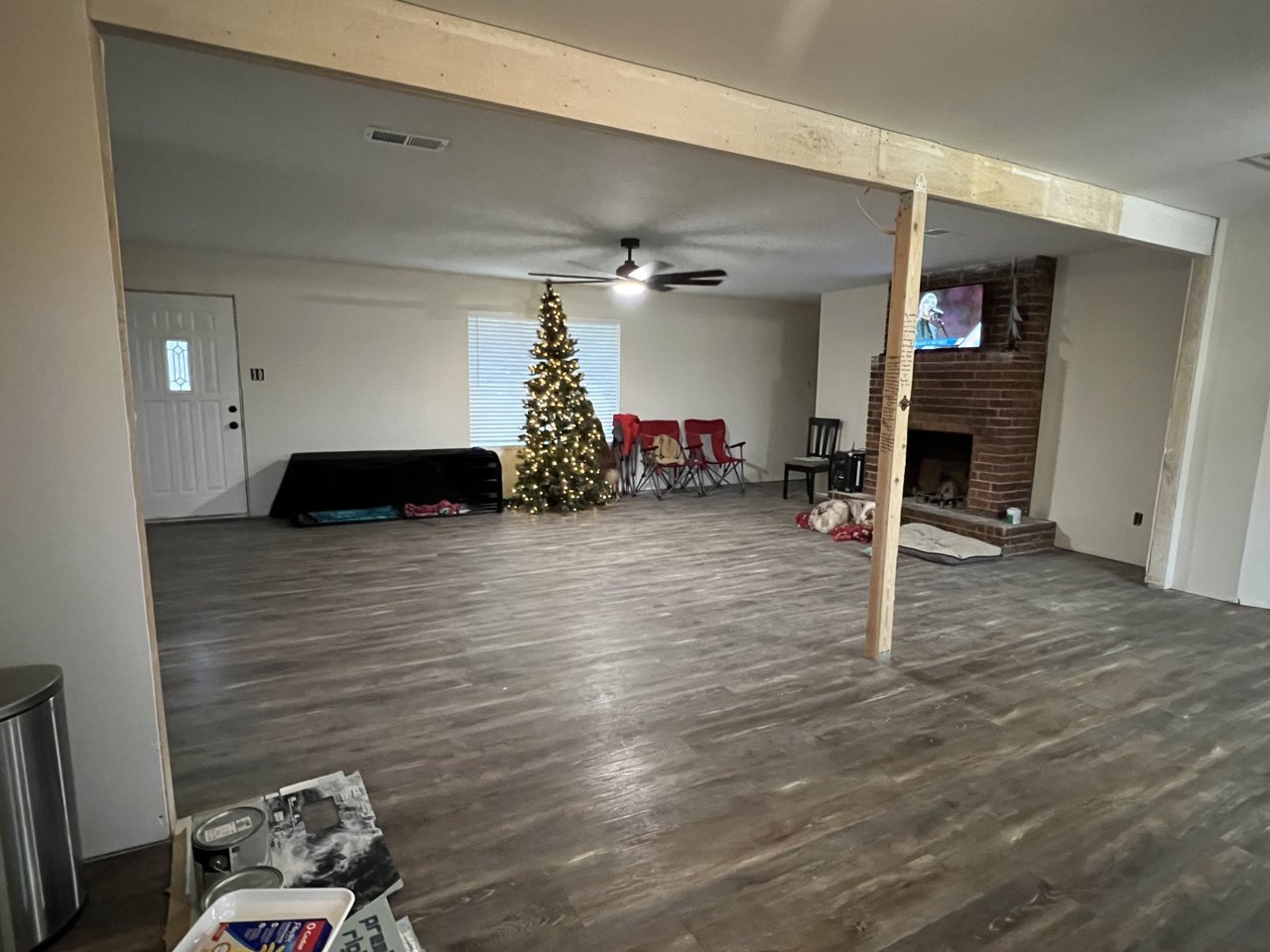

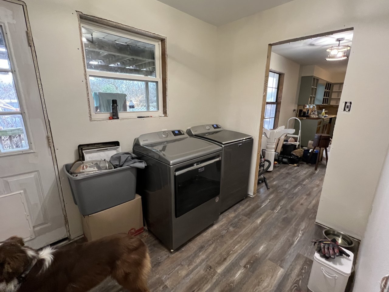

    Where to start. Installed the LVP flooring. Setup the laundry area. Painted the cabinets and doors. Installed the vent covers for the AC. Installed some of the door knobs. Cleaned out the garage so we could install the new opener. Discovered the opener is either a little weak sauce for the door, or the springs are getting lazy.

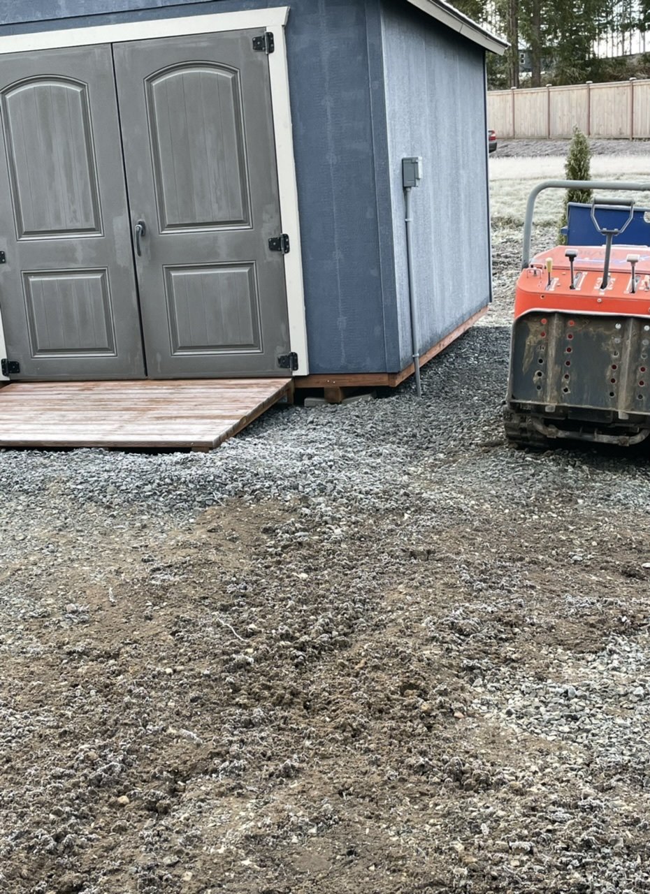

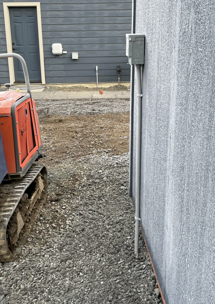

    Finished the routing of the conduit, added the 12/2 UF-B wire to the 3/4 conduit and assembled it all before adding the 90 degree sections. I did not have to pull the wire thru all the curve which would have been near impossible by myself. Got the trench buried. I installed a cutoff switch on the shed, as I read it’s required per code now. I have about 30 feet in the garage of the wire to do the final connection to the breaker box. It has to be a GFI breaker or socket connection per code if using UF-B wire. Glad I got it done as it was 24 degrees last night and everything is frozen solid.

    Yeah, that looks pretty damn cold.

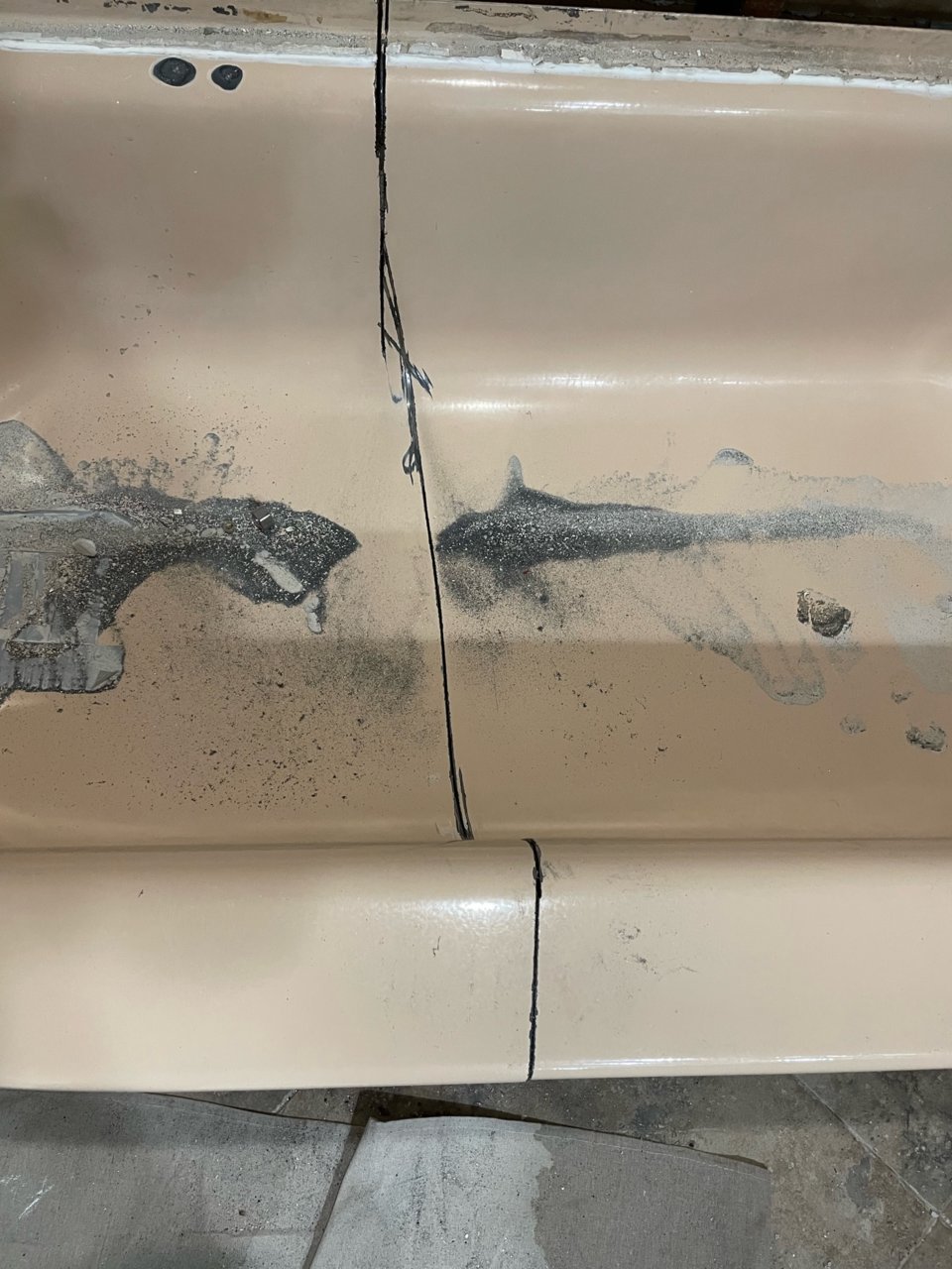

    Well, since the new roof and solar project’s done, I needed another project to work on. Hmmmm, never did like the color of the tub 02955307-D486-4BE9-B03D-1150CD7C19D4.jpg634194E5-9954-4E69-9DC4-FCA66D5F7143.jpg9147BC95-F21A-4A80-A2A4-18AC368B2175.jpg
    I haven’t tried tiling before and didn’t want to start now so tile guy starts Monday

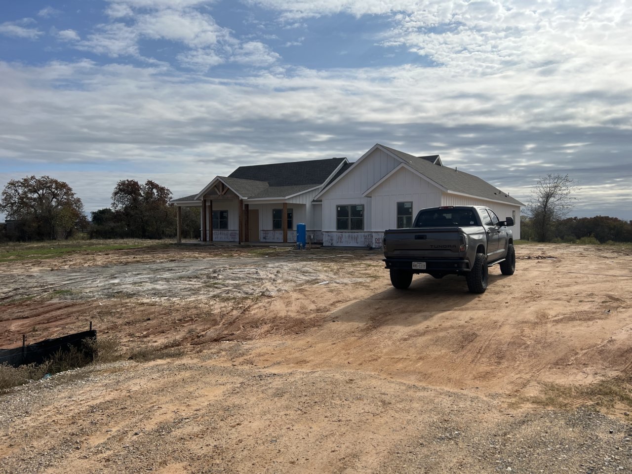

    House almost done

    what state ?
  29. Dec 18, 2022 at 6:33 AM
    #9899
    KNABORES
    KNABORES Sarcasm incoming
    Jan 1, 2020
    #40572
    14,286
    Arkansas
    Looks like Oklahoma. Or Kansas. Or west Texas.

    I’m in west Texas
